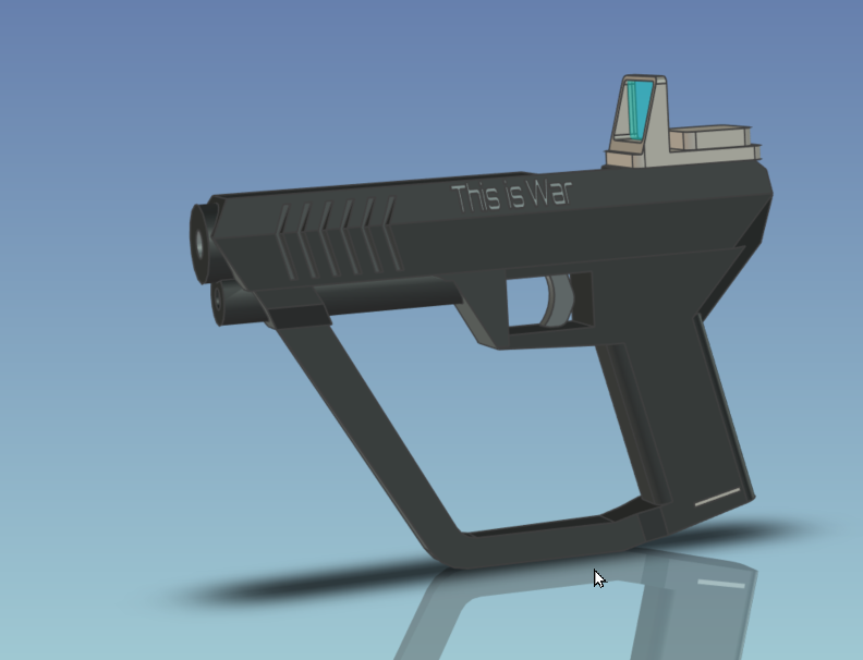

This is what I am thinking at the moment. The movie is set in present day and the name of the gun is a play on the movie title.
Not sure about the red dot indicator on the back. It takes away from the overall design. Besides, it has a laser built in below the barrel.

I like where you're going but I feel like this pistol is visually out of balance, if that makes any sense?
I'm curious how it'd look if you removed the underbarrel light and aligned the angles a bit. Eg. Match the angle of the trigger guard to the hand guard, and perhaps the magazine.

It's a bit better. Making the angle the same as the magazine did not work, made it way too bulky.
This works, or at least is more consistent.
I added a little bracket around the laser.

TBH, if the movie is set tin the present day then what you've designed looks like a 1970s vision of a futuristic gun... IMO. Which may be what you're looking for.
Personally, I would look to a more contemporary firearm. For example, the Chiappa Rhino 60DS has a cool brutish look. Otherwise, consider looking through the imfdb for inspiration. Start with the pistol and revolver pages.

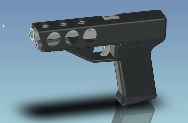

Ouch! But I get what you are saying. The Rhino is a good looking gun and I like the idea behind it as well.
I had designed this, similar only in the sense that it is full of holes.
I am beginning to think that I am unconsciously constrained by the fact that it needs to be 3D printed, so I am looking for smooth surfaces, easy to prep and finish. But then, I have always been a fan of smooth slick designs.
