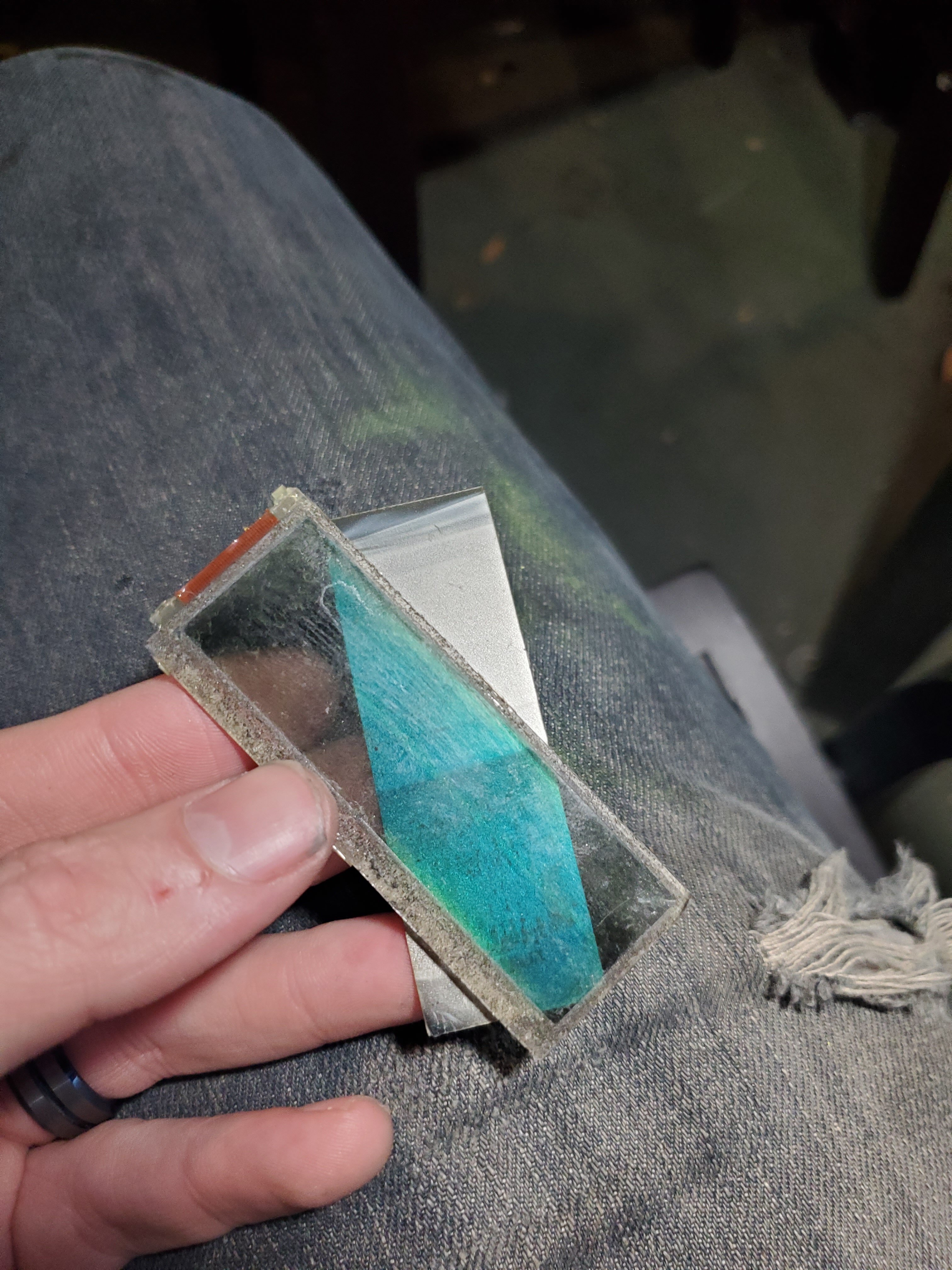

First I decided that I wanted my pager to look like it was actually getting a page. To do this I split the LCD
By slowly heating then peeling off the backing. Once completed I added the water slide paper to the reflective backing.
After this I put it all together and finished the build.
The key to getting that florescent yellow is first a base coat of white. The krylon paint simply runs if you don't do that first.
Once dry then apply a few coats of the yellow.
After that simple toss it all back together and add the LCD we created earlier. And here are the final results, I honestly was not sure this would work and was very surprised at how much it looks like the display is actually getting a page.
