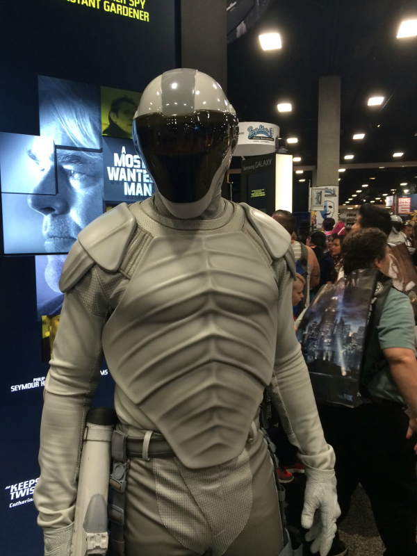

I recently have decided to (at least attempt to) make a Peacekeeper outfit for the Mocking Jay part 2 premier at my local theater (sometime in November). Peacekeepers-armored.jpg_1406175007.jpgthe-hunger-games-catching-fire-trailer-screenshot-capitol-peacekeepers.jpgcfstill9d11katpeacekeepers.jpg
I am planning to make this out of EVA foam and craft foam. I am pretty new to these but from the amount of experience I have with these materials, I think this will come together rather well.
Any tips, or even better reference photos will be very helpful!

Im so glad I found this! My gf and I are planning a hunger games couples cosplay for Baltimore comic con in sept. I just drafted out a template for the chest plate. I plan on using EVA foam as well. I was also thinking about buying worbla and wrapping the chest in it to get the ribbed effect. But i may just use eva after seeing this! Its looking good! Im not on these forums much or twitter do you have an instagram you post this to or maybe facebook?
I don't know if you're going a different direction for the chestplate, or if you would want a tip, but for the more organic look of the ridges, one thing you could try is something like what Durkness shows here:
https://www.youtube.com/watch?v=b47ZV534lZo
And you would do kind of a valley-mountain-valley cut to make it pucker up where each line is. Kinda like -
Don't know if that would help, if you want to test it out. I do like the look of the direction you're going, though, with the strips.

I've been messing around with that technique and it looks like it could turn out nicely!

That does look pretty nice. Will save you on the cost of Worbla. I bet it'll be tough adjusting for the shortening of the length, though, since it's basically like an accordion folding up.
Redarm, were you going to sand down the edges of the foam strips on your chest piece to round them out, or leave them with hard edges? The hard edged look actually gives a pretty cool sci-fi armored look.
CollinE83, that's an awesome idea! Thanks for the link. I would try it out, but I'm already slacking on my work. The ribs (as I call them) for the chest piece (and probably the back as well) I left the bottom half hard-edged and I took a dremel to angle the top half, I wanted something with a curve.
Harding29, that's awesome! I would love to see your progress, I made a Facebook page today (spur of the moment, but it's up) "Redarm Props" for lack of a better title.
I appreciate the input and tips, it helps me out since I couldn't find anything on a peacekeeper costume.
Harding29, if you do the valley-mountain-valley thing, just measure out a length of foam, then after you make the ridge, measure how long your piece of foam is, that should tell you how much you'll have to compensate for. At least that's how I would do it.
