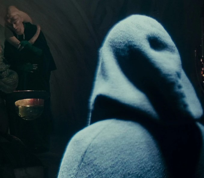

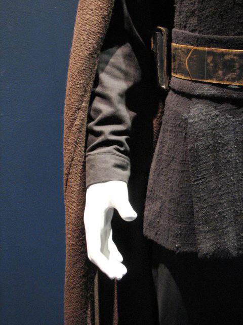

The other issue with bias cut is that it takes up much, much more fabric. Given that Mark Hamill and Colin Skeaping are about average height it's not like they needed to cut on the bias in order to get the width necessary if the bolt was too narrow. The cloaks were cut along the grain and the angle of where the two front halves meet the back are angled, but this isn't necessarily the same as a bias cut. Bias cuts wrap around the body tightly, draping close. As mentioned earlier this cloak also doesn't have a "spine" seam running up the center back the way Obi-Wan's robe and all the Prequel Era Jedi Robes do. There are two front panels, one back panel, and the hood has a front facing cut into the hem about 5 inches deep. This was also used for the Emperor's hood in ROTJ. All the hems are blind so they don't show. The inside of the cloak body seams are also French seams (like the Prequel Era Robes) to hide the raw edges of the material on the inside. Otherwise you'd see them serged and that's not the case. In the photo below (credit to Kay Dee's references) you can see the french seam/ flat felled seam.
As far as how much material is necessary that will depend mostly on your height but for my personal cloaks I use about 8 yards or so. I'm 6 ft. 2". Keep in mind that the side seams of the front halves that attach to the one piece back don't fall exactly at the sides of the body like you'd see the side seams on a pair of pants. They sit farther back on the shoulders as indicated in this screencap from the movie. This means the shoulder portion of the back is cut a bit narrower and the front panels are cut a bit wider on the shoulder portion. I custom made my pattern from scratch. You could certainly use those existing patterns linked above by PoopaPapaPalps and I think they would give you a good base to work off of but you're going to have to modify them.

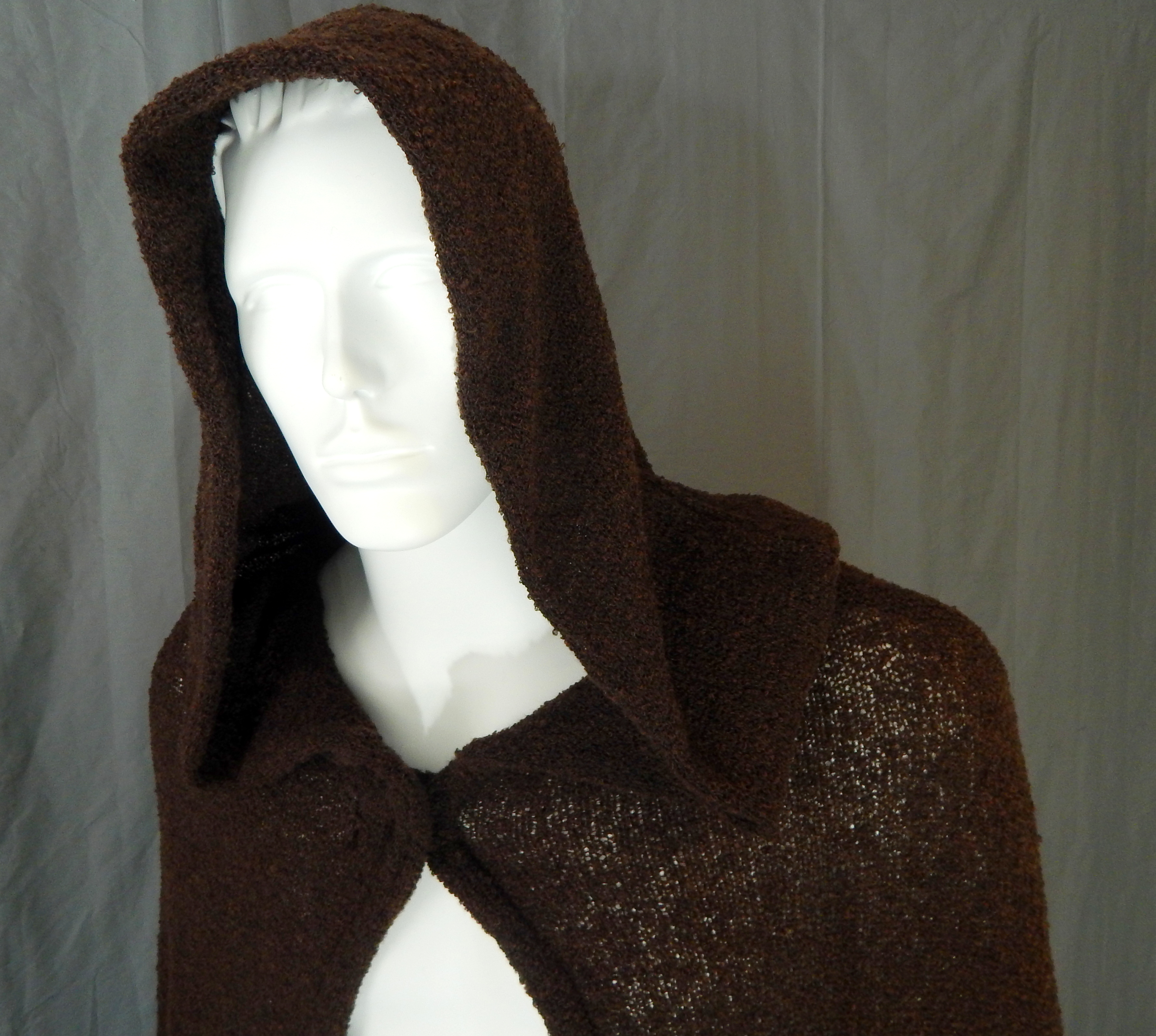

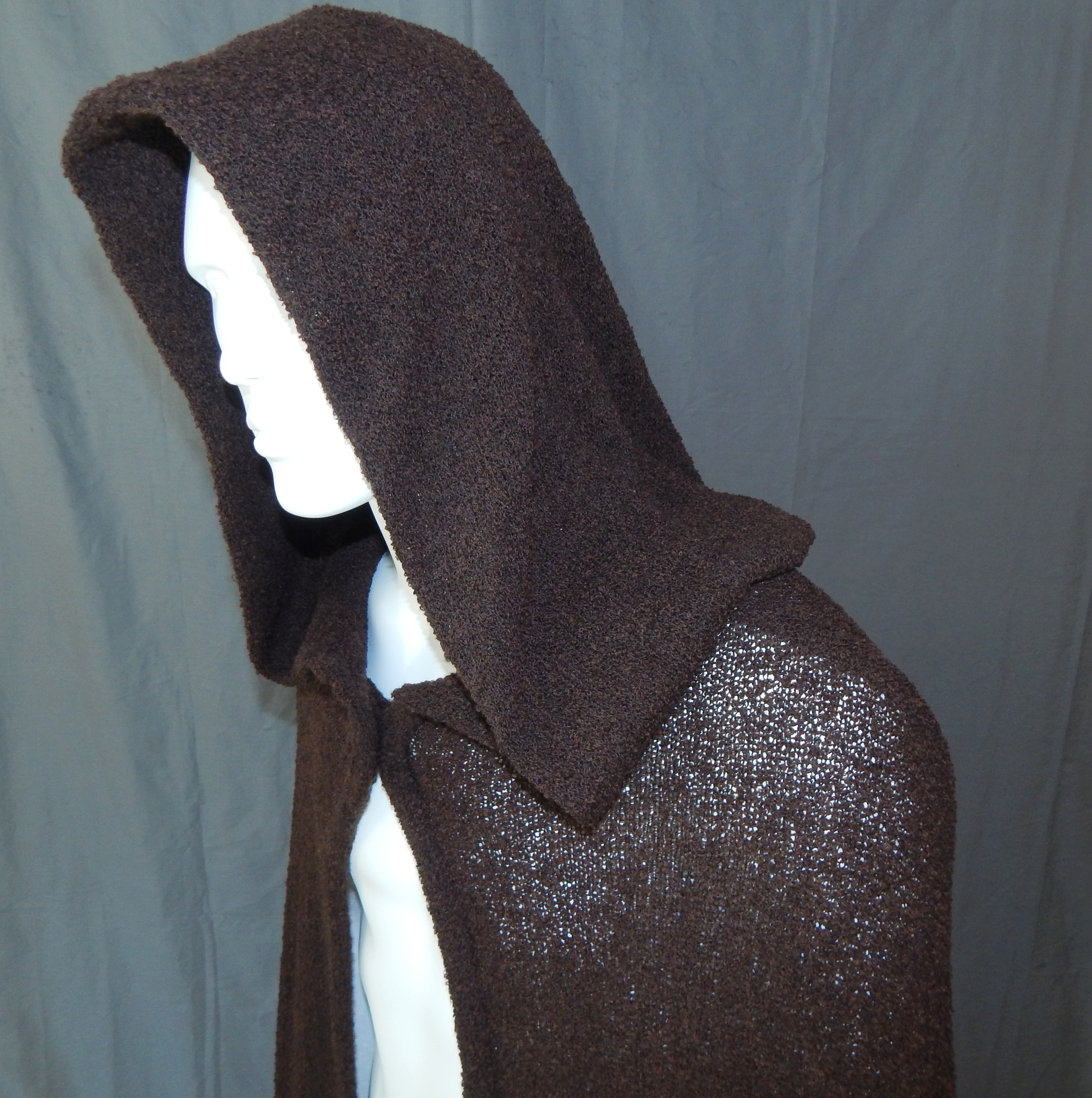

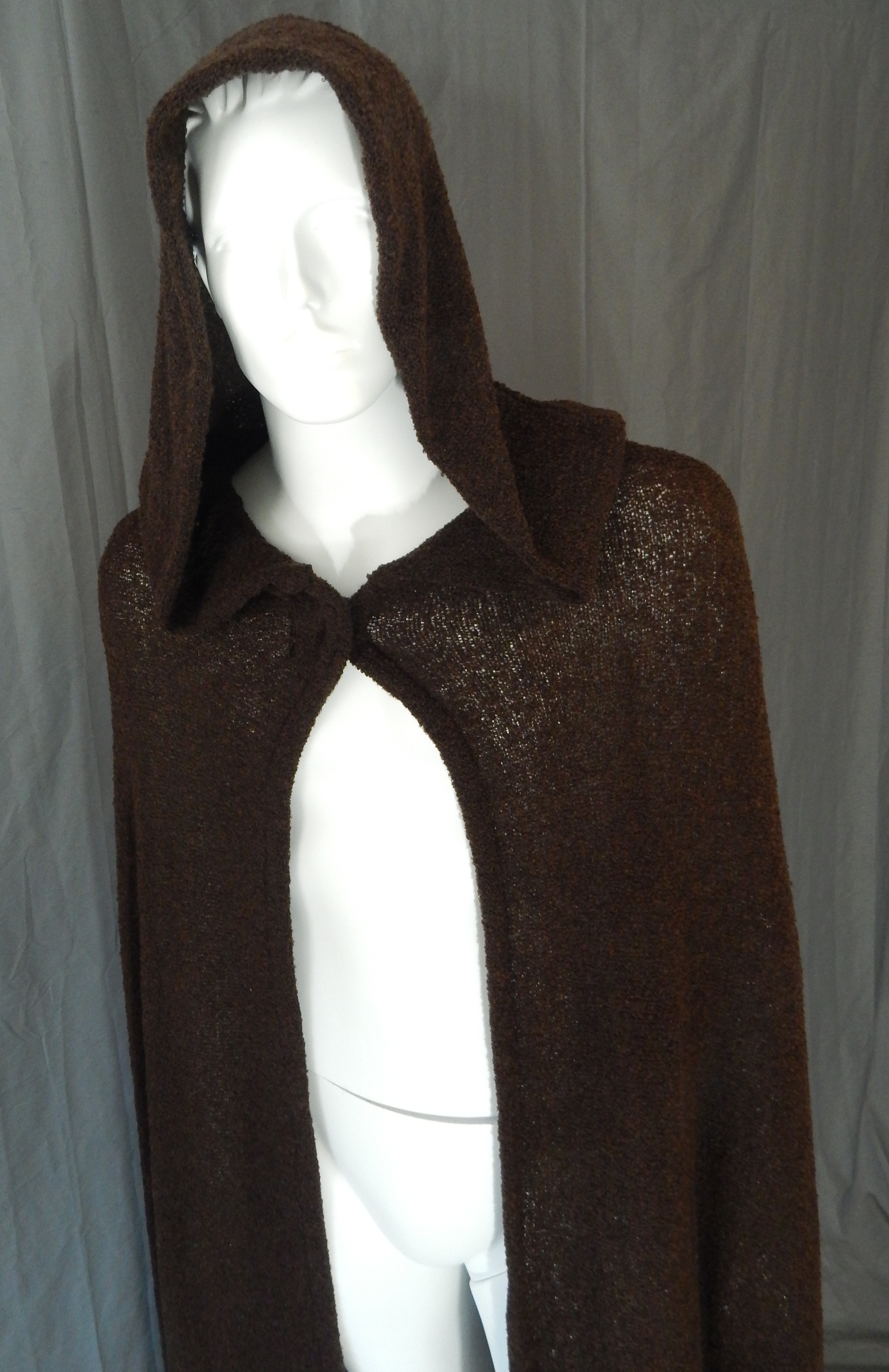

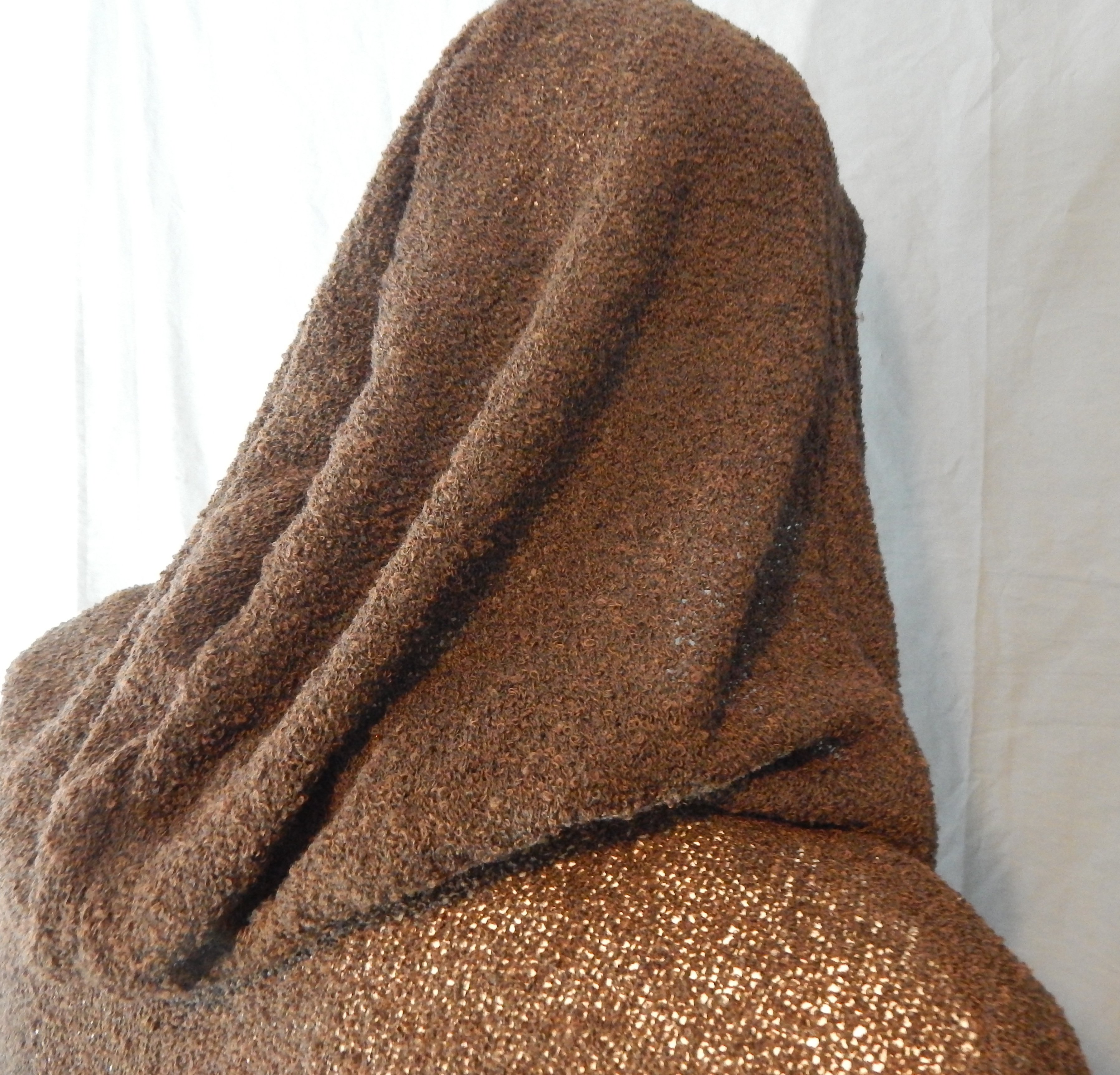

The following images are of the cloak I made for Adam Savage and due to the width of the fabric I had to make it with the center seam up the back in order to get the drape wide enough. There was no way around it. At the time I made this I thought there were two versions of the hood. One with center seam (which is what I made for Adam) and the other without. It was later revealed (with better reference images) that there was one version which had a center seam.
View attachment 1696793View attachment 1696794View attachment 1696795View attachment 1696796

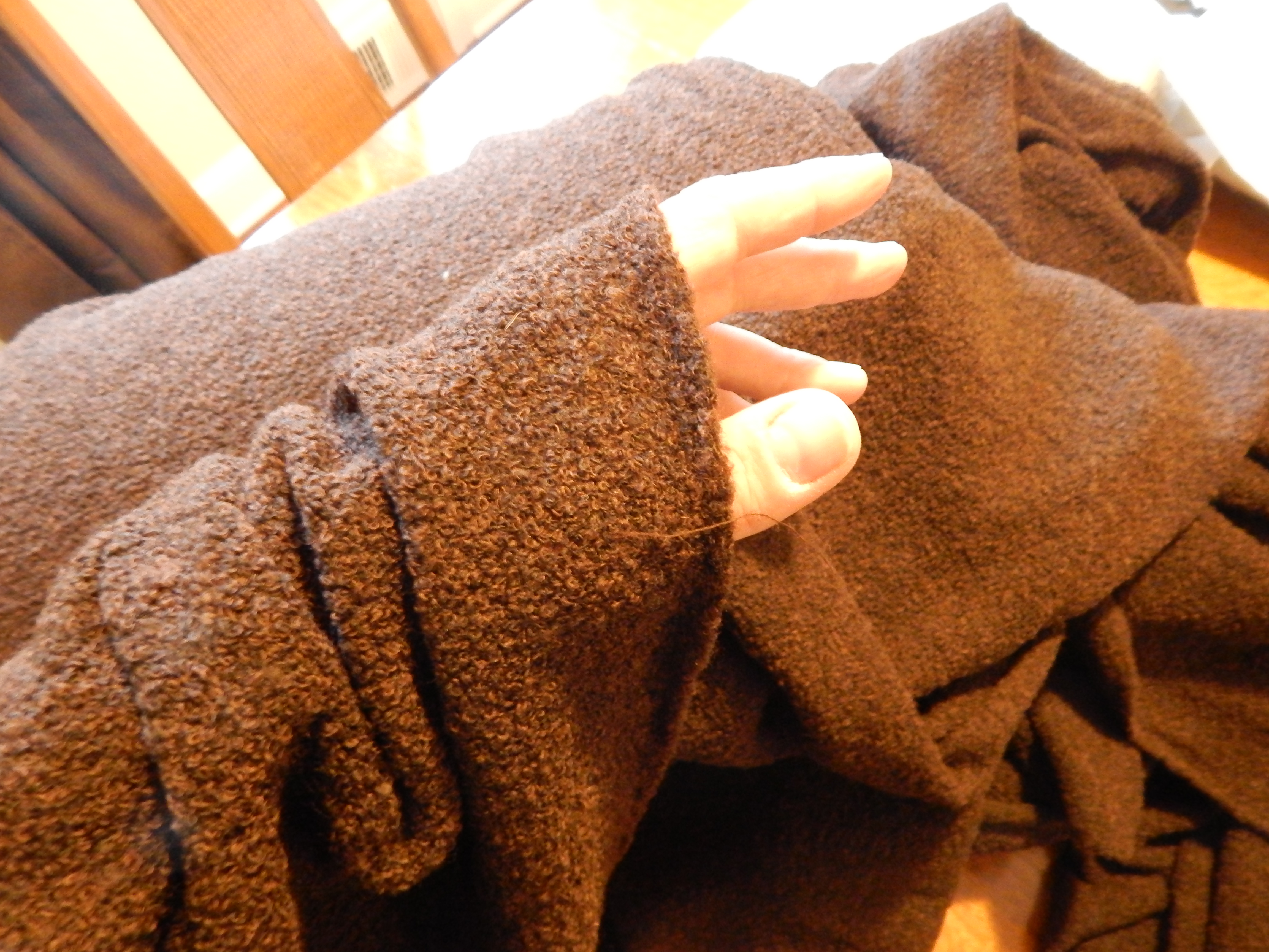

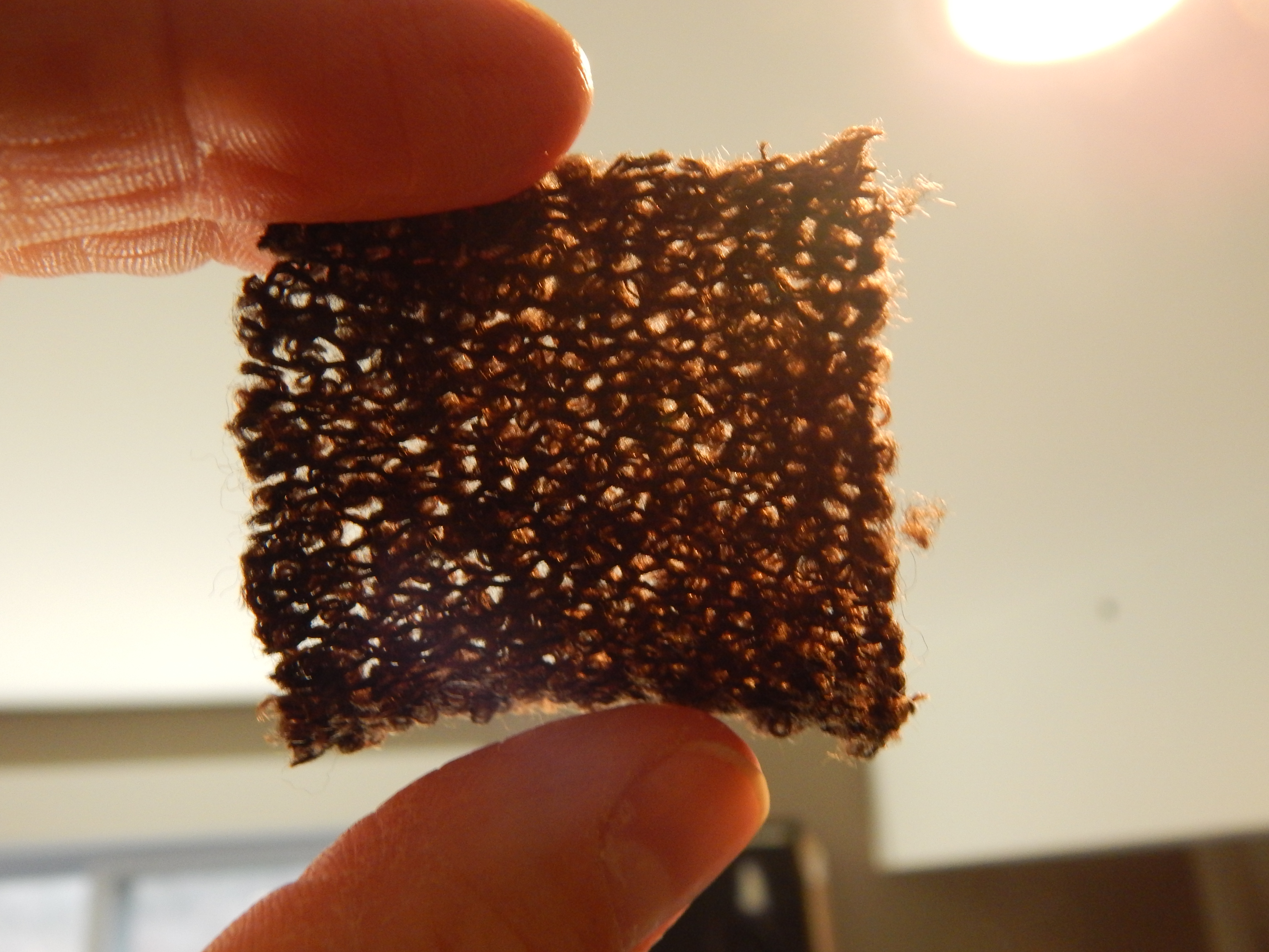

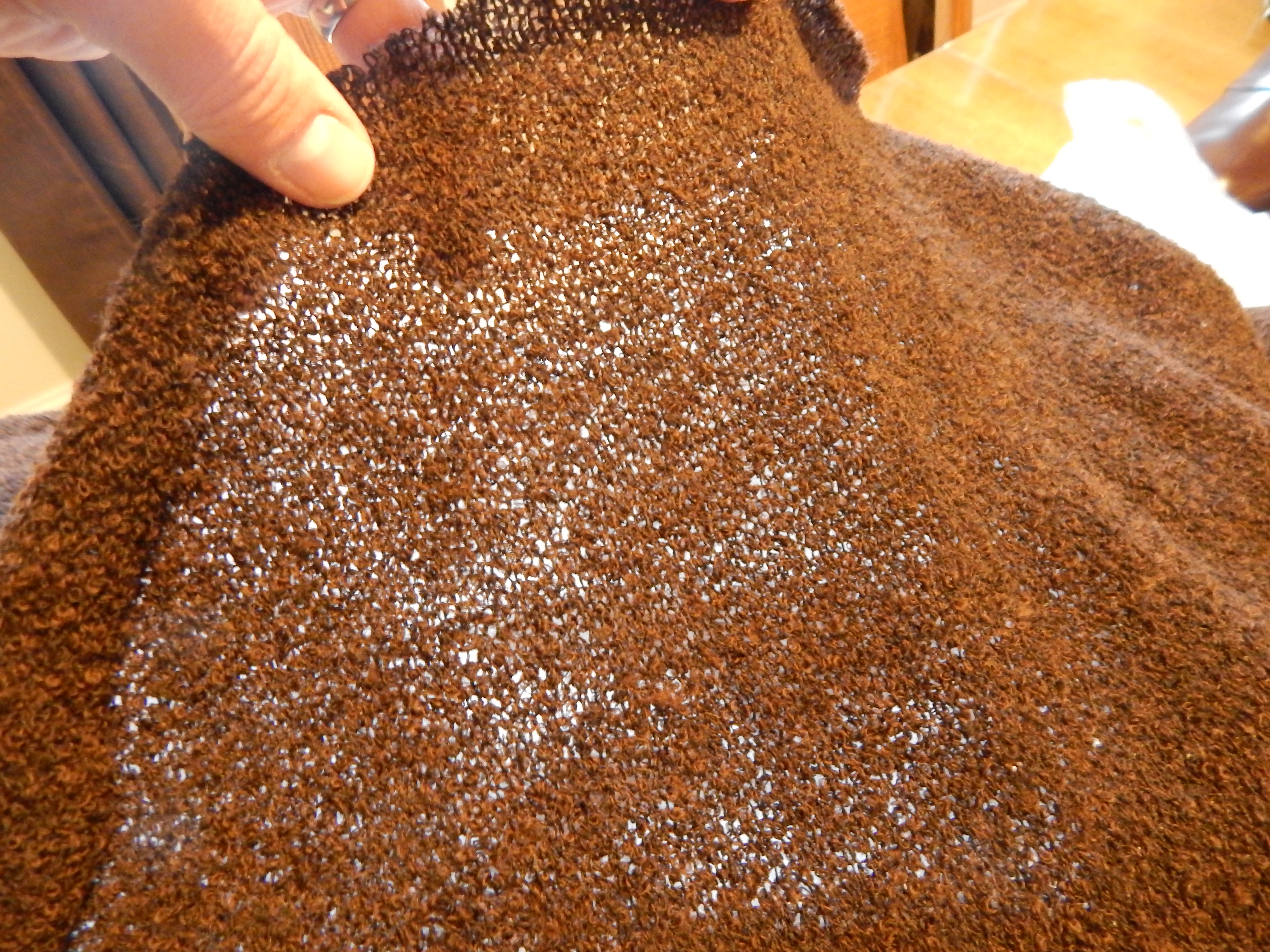

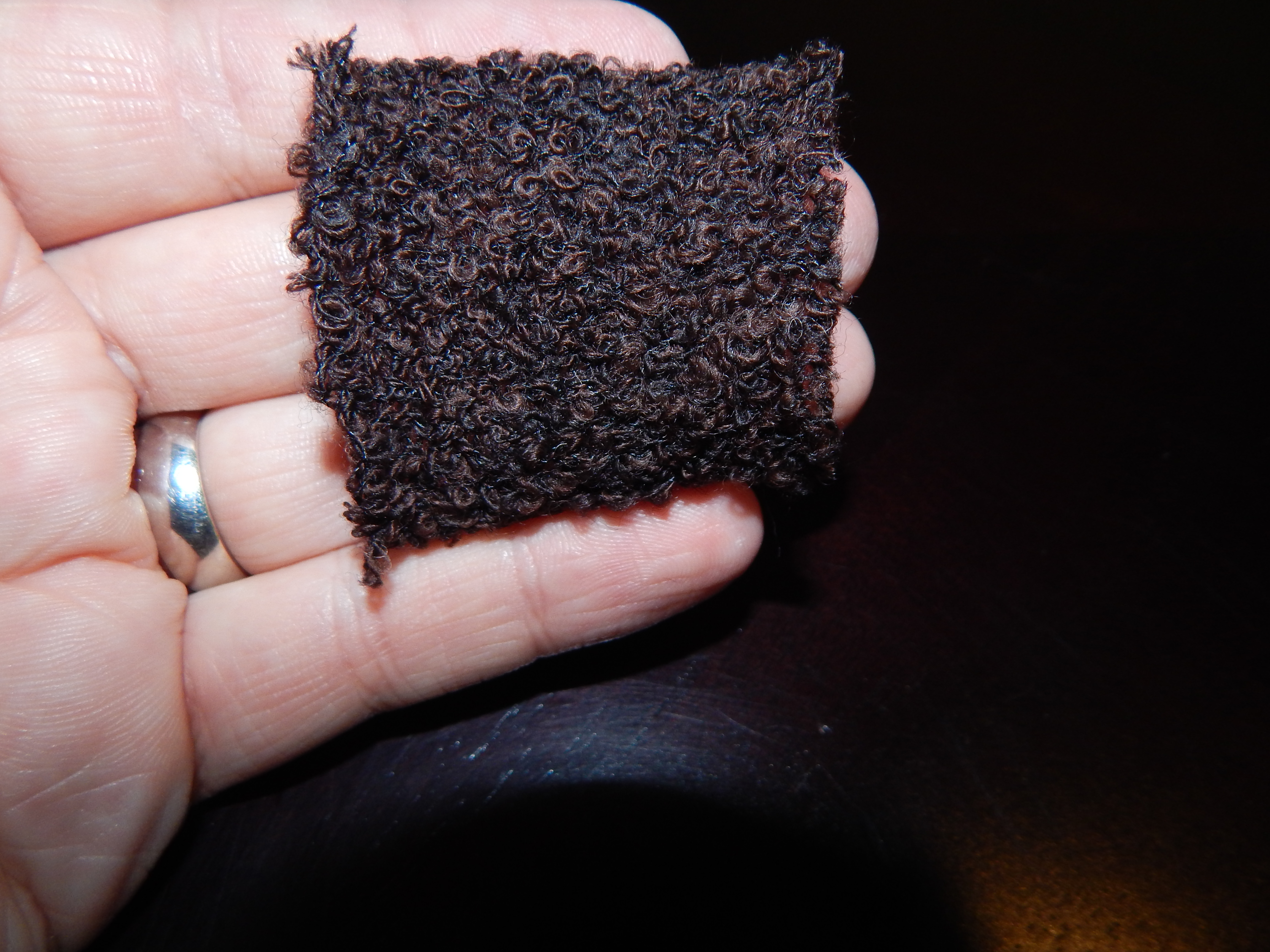

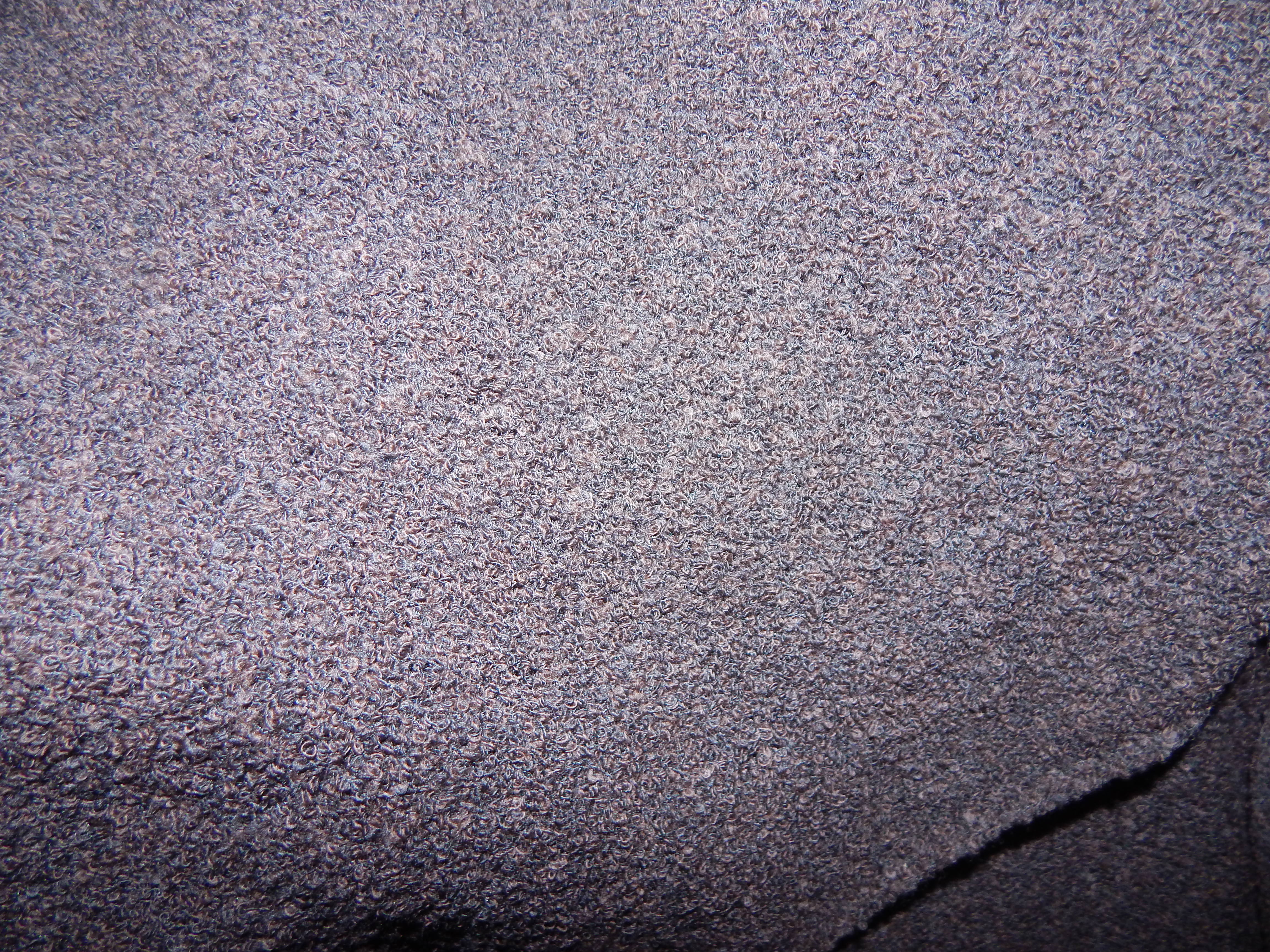

Here are some shots of the material up close:
View attachment 1696800View attachment 1696801View attachment 1696802View attachment 1696803View attachment 1696804

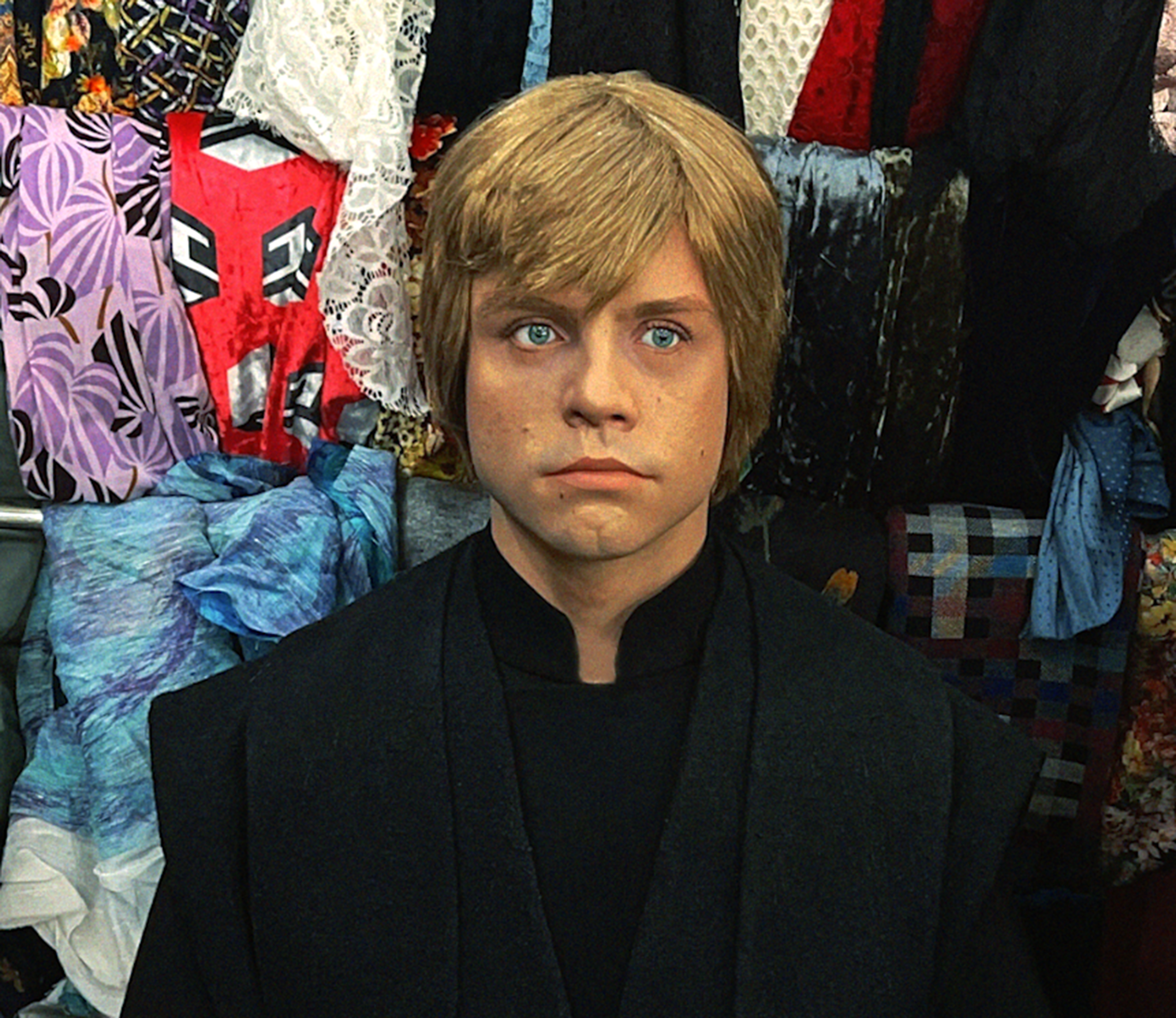

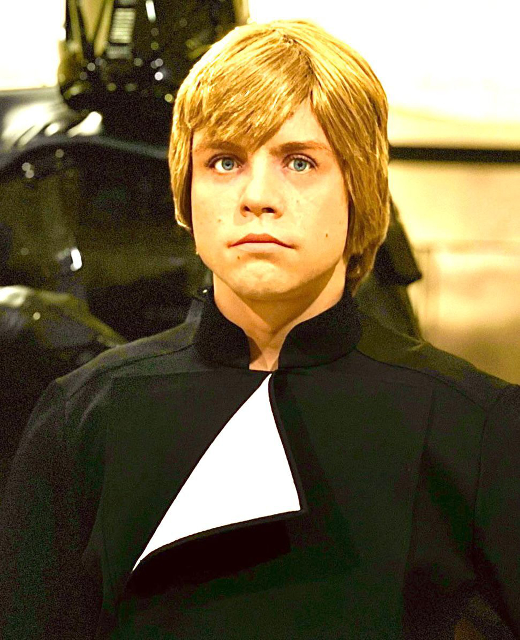

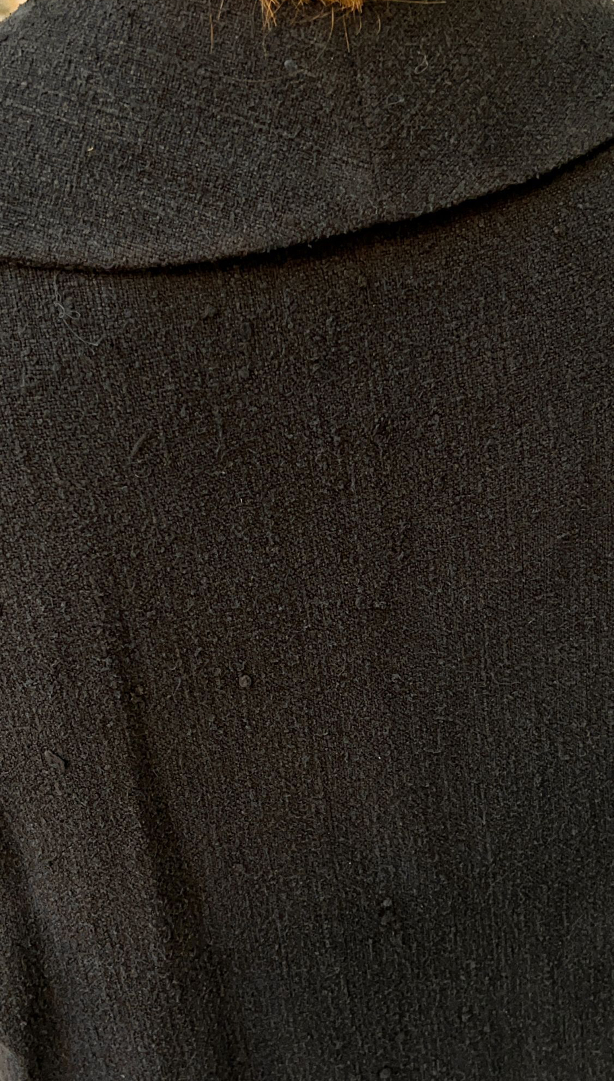

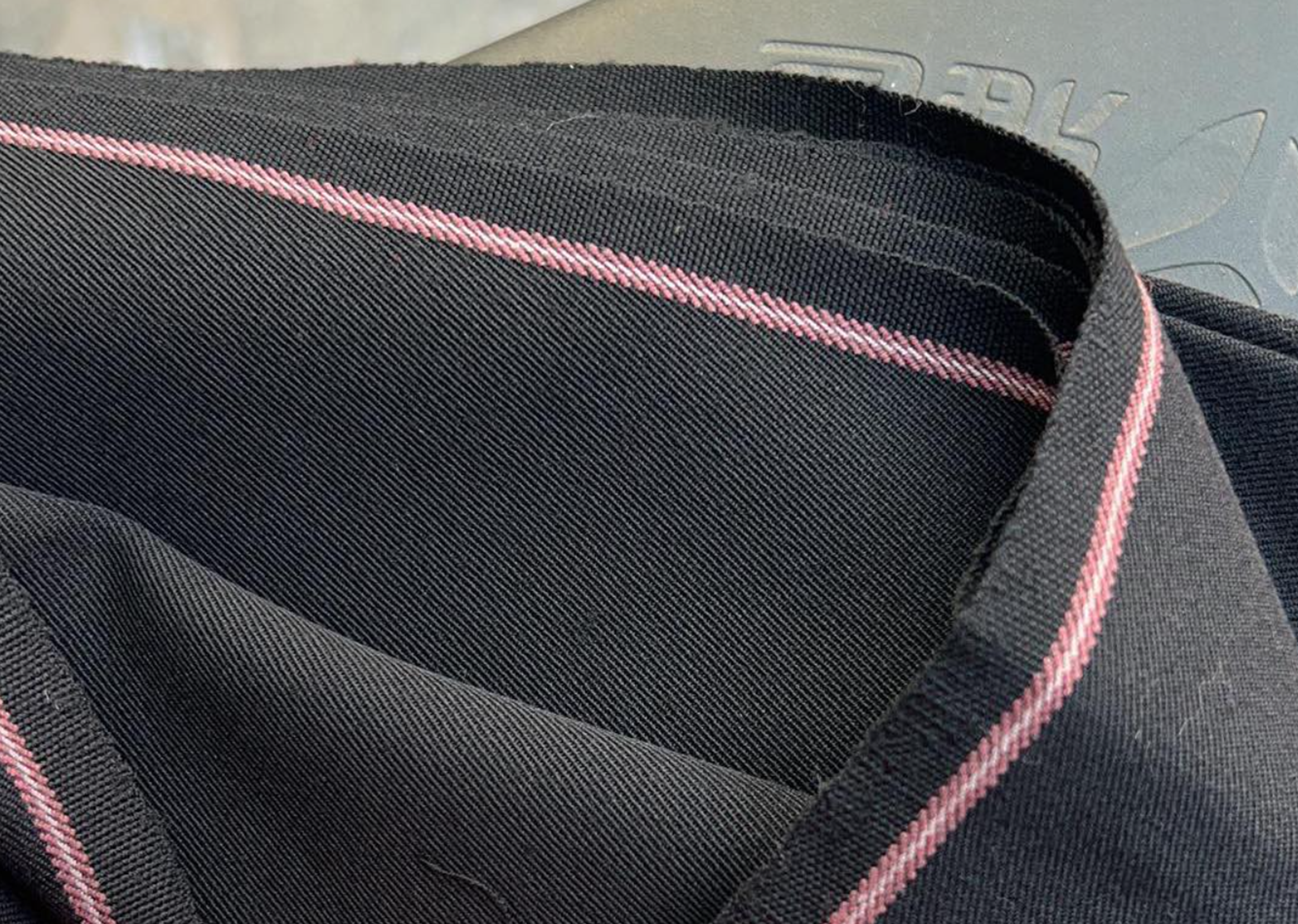

Thank you for these pictures, I don't think it's a coincidence that I searched the internet a few weeks ago for the right fabric discussion place for Luke's cloak and unfortunately had no luck. So the cloak I have not been making. So I recently wanted to finish this Luke on the 40th anniversary of ROTJ as soon as possible.

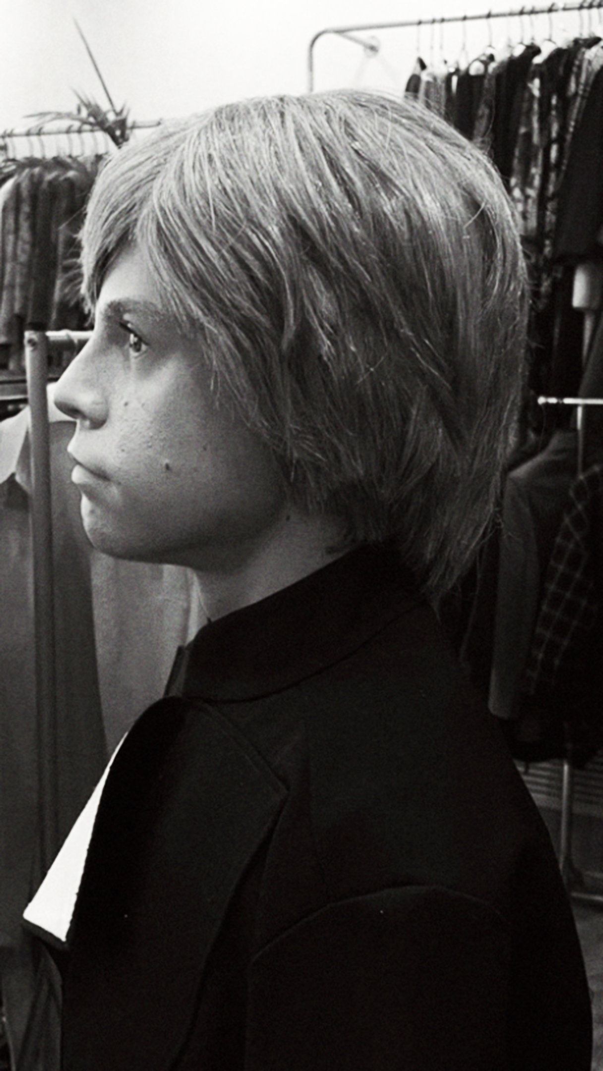

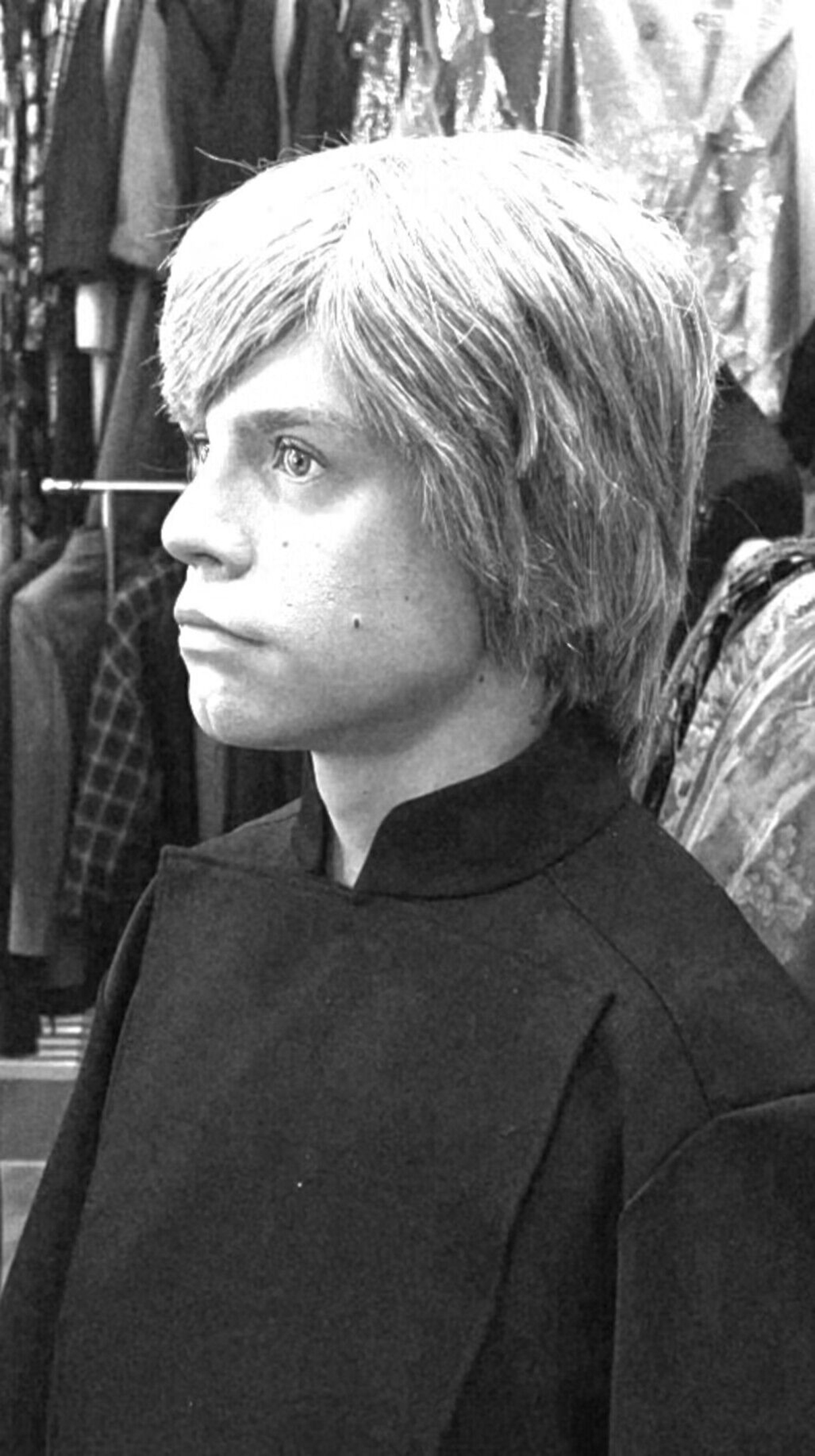

Due to my region, I did take the road less traveled, bought the right vintage fabric, and made a shirt and pants and vest, and am making it a reality step by step. Thank you again for the image of the cape fabric.(y)
This is the current progress of ROTJ Luke.

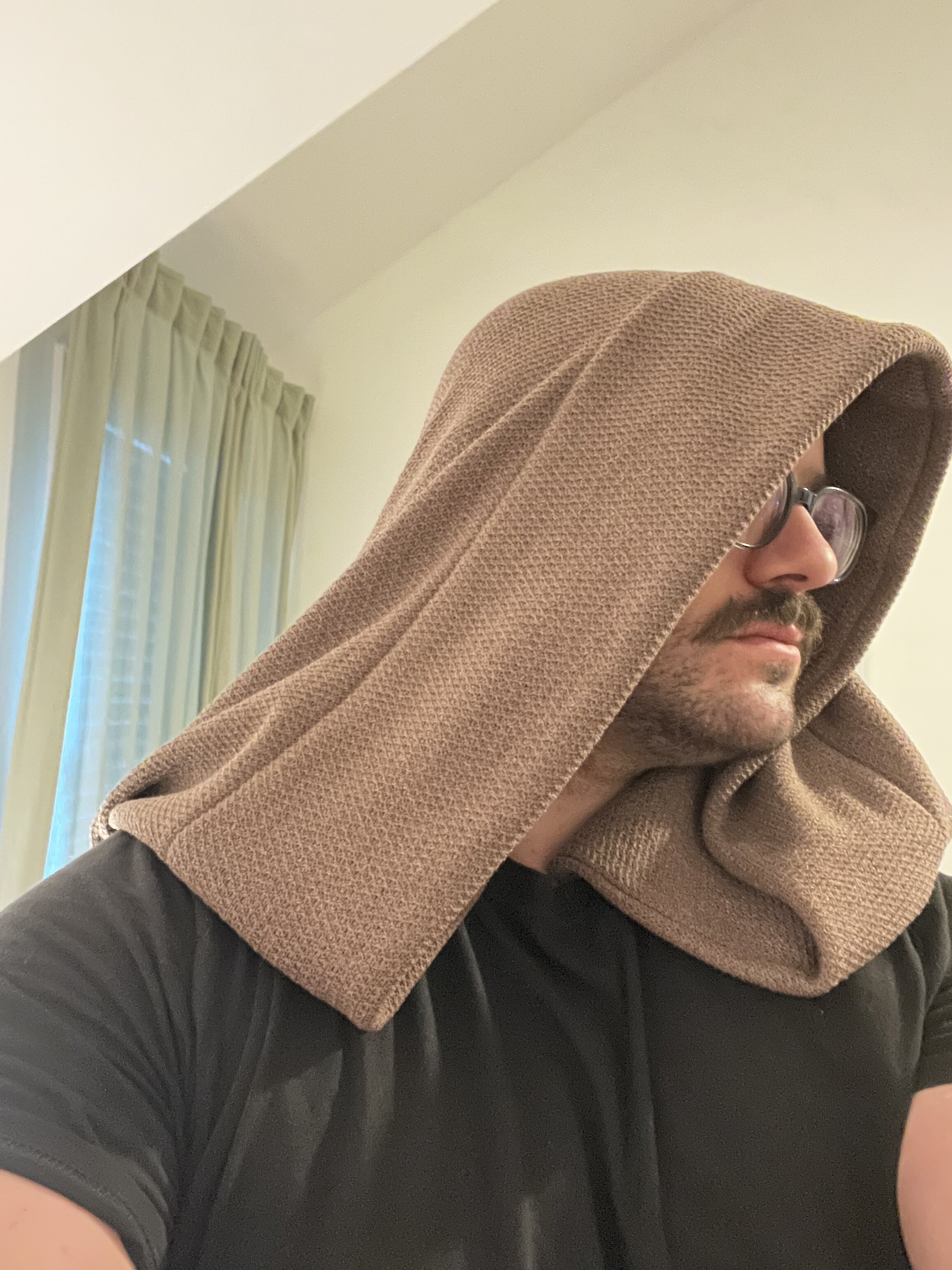

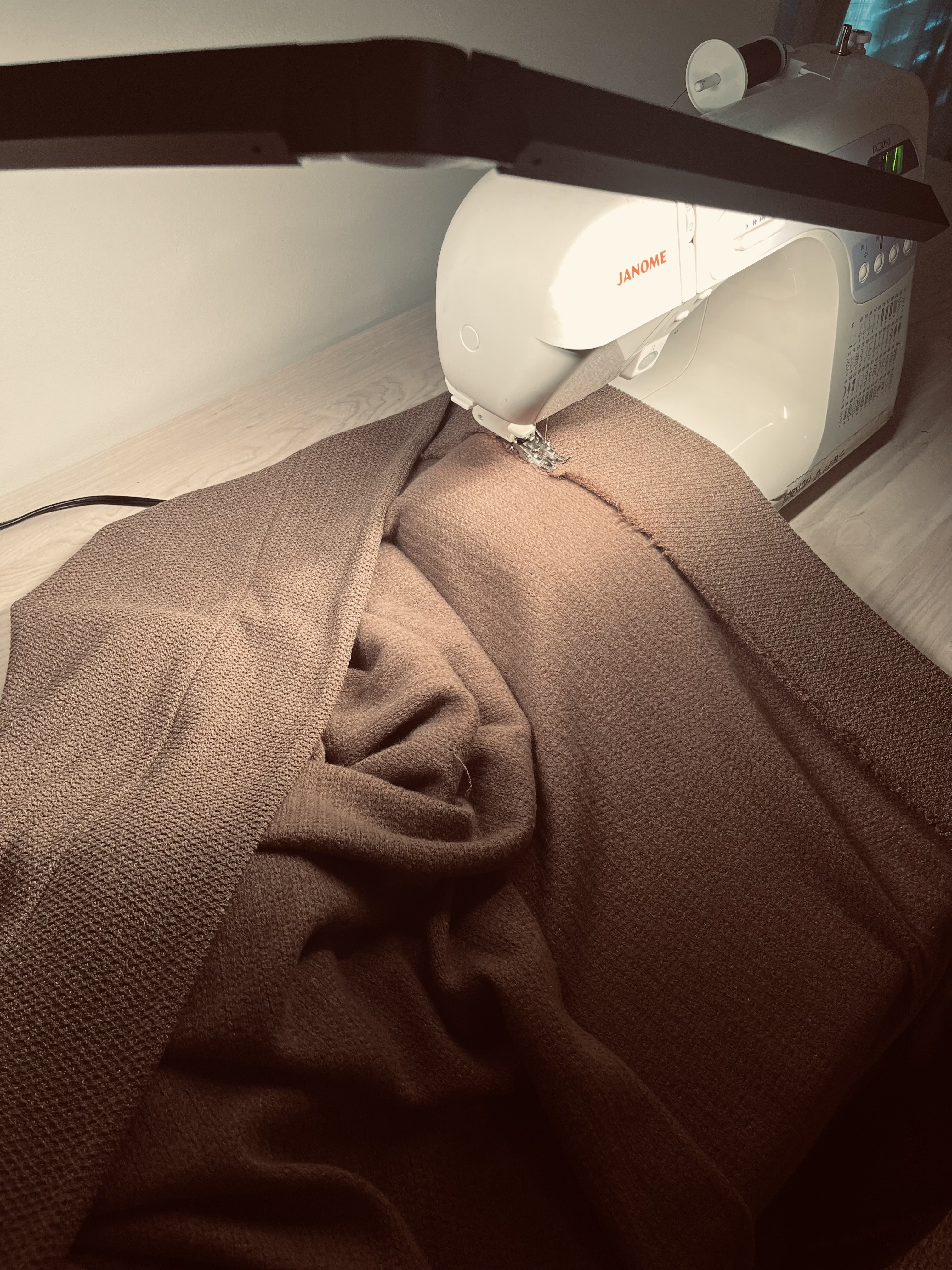

Having fun prototyping my pattern with some similar weight (polyester woven) vintage fabric.
View attachment 1759031View attachment 1759032
Pardon my likeness: I’m a bit more “Tobias fünke” from Halloween at the moment than Luke Skywalker :lol:
Gosh, great effort for prototyping - i have had some similar fabric - a wool blend, but not remotely as delicate as what was likely used in ROTJ and tried to assemble a circular cape... i got the impression, and would love to hear your opinion, that a full circle may be too much material when compared to full length behind the scenes photography of mark hamill and the costume exhibition pictures...it seems you are using a full circle, too and have the back piece as a half circle? in ROTJ, the seam between back piece and front pieces runs behind his shoulders, so it gives this clean monk like silhouette, and i think they used a different pattern on the mandalorian cape...which appears to have more volume...
what do you think, should it be a 7/8 circle, 3/4, or a 2/3?
I’ve not done much more on this pattern test, but that was three equal panels cut at approximately 60°.
Good stretch along the bias of the fabric is pretty important to get more coverage and create the stretched front attachment we see on the original.
TheBOBF cape definitely used a stiffer material with more coverage to get around the front of the the chest, but I can’t quite comment on that pattern. (I really disliked it actually)
