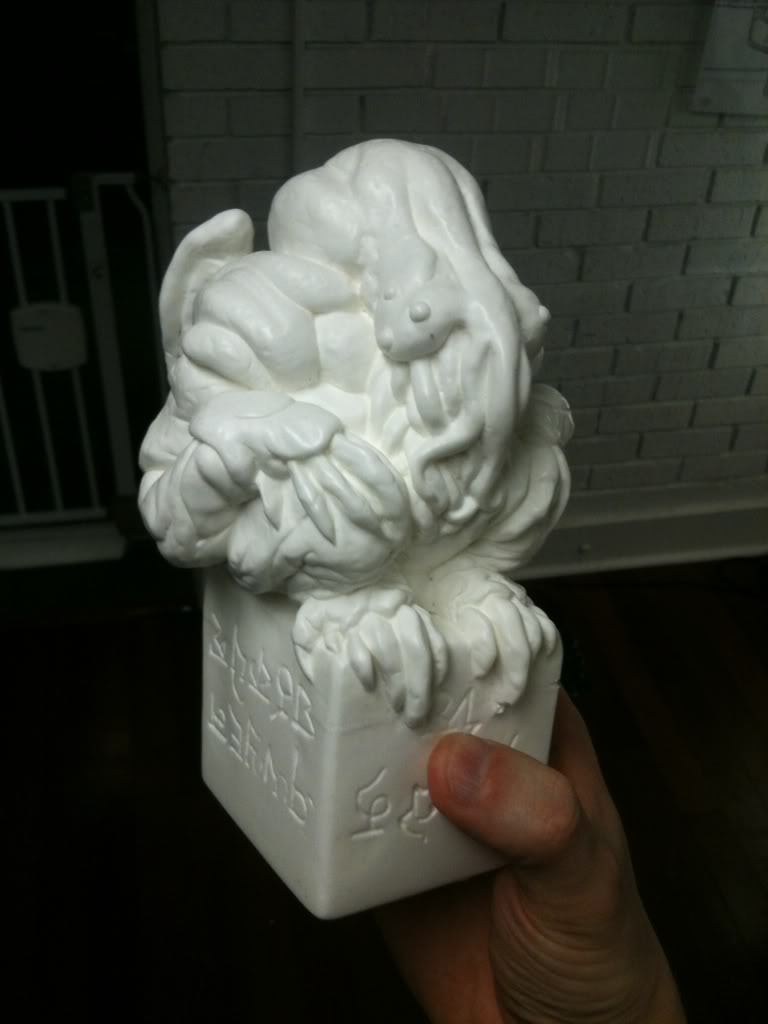

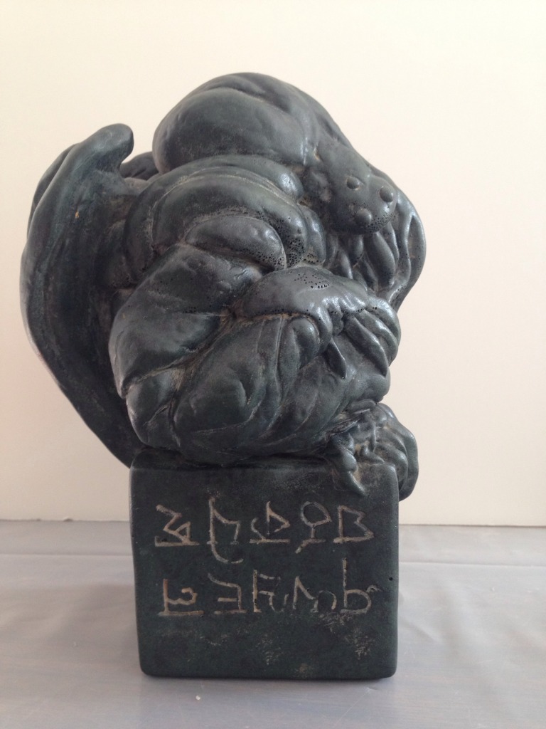

I'm trying to mold and cast an 8 inch tall statue and have been running into some problems and would love the forum's experience and knowledge on how best to approach it correctly.

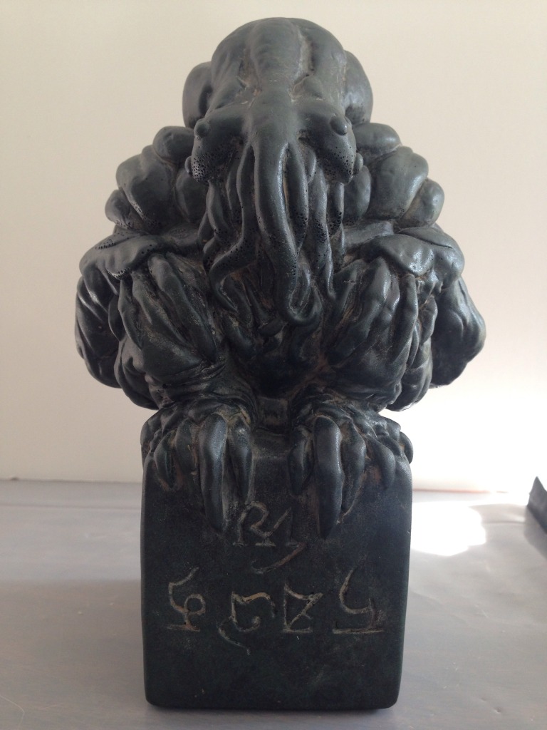

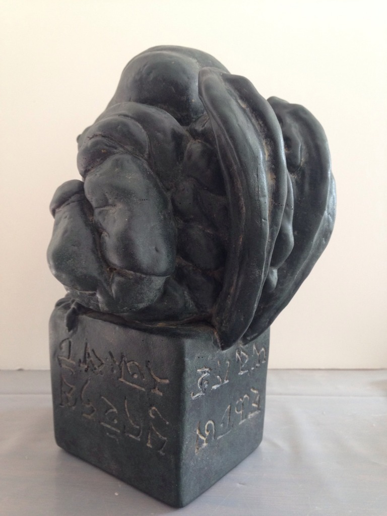

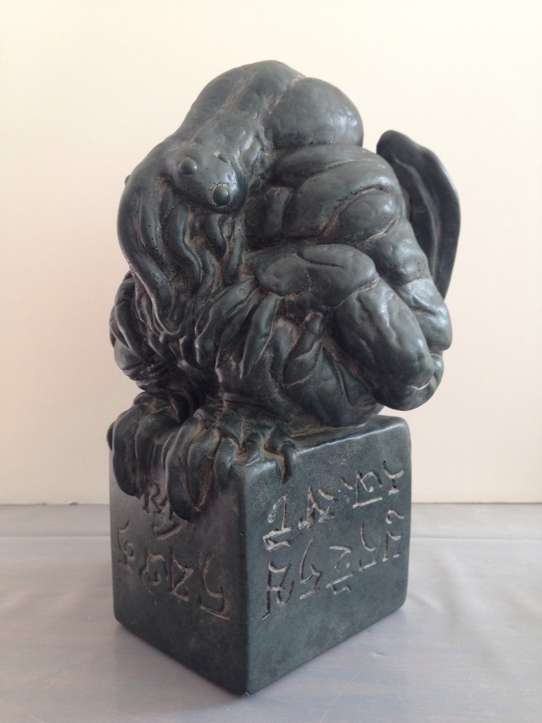

The sculpture in question-
01D619DF-FF29-4407-8BCE-7B1AE05AA47F-2065-000001975DE1346A_zps49d93215.jpgD3806BA3-DD0F-4AA9-9635-A35B3FF4D370-2065-000001957E76CDAF_zps5bab50b8.jpg28188B2B-79FF-4AF9-B5C6-F50163603E78-2065-0000019577E13841_zps2234d81a.jpg3D948BC3-15FD-43DF-808B-33D569656AB4-2065-0000019570C18F15_zps8fa1273c.jpg5EF16AC9-D686-49F5-9F43-FF6B9ECD9AC5-2065-0000019568BE6F10_zps78859fc7.jpg9EADB3FF-65BA-4B2B-A992-0BAB1B02F020-2065-0000019561367C33_zps6b3a6433.jpg

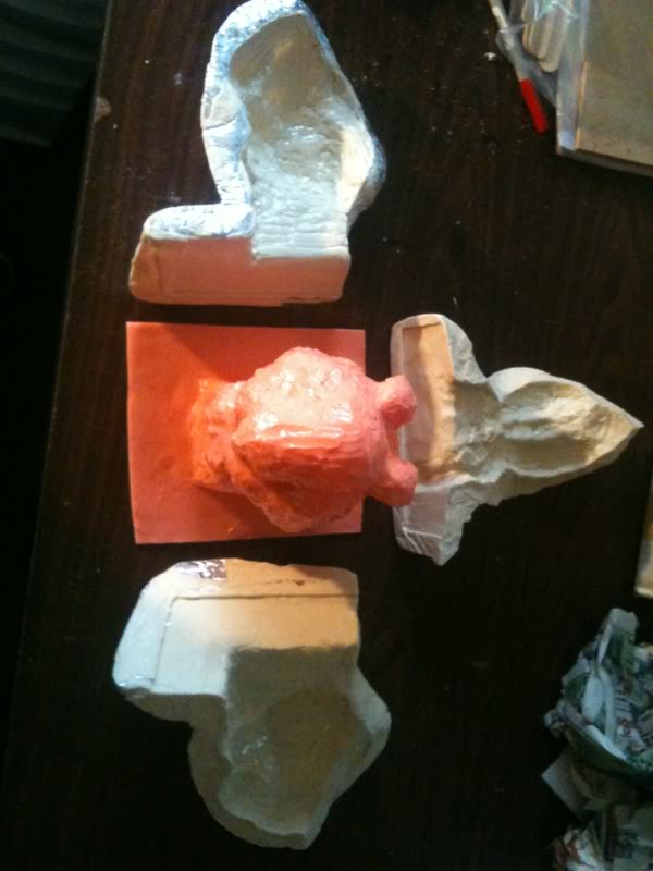

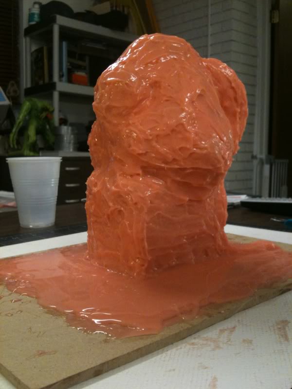

Brush on mold with Rebound 25 with Plasti Paste mother mold. The silicone mold is simply slit up the back. Yes, I used the brush-on starter kit. My first mold!
Not bad! I did get a little too excited and started slitting the rubber before making the mother mold. Dumb, I know, but it lined back up okay.

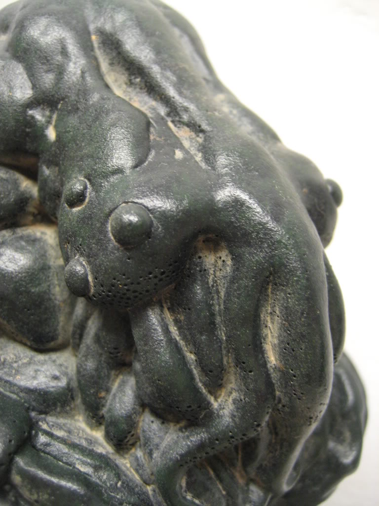

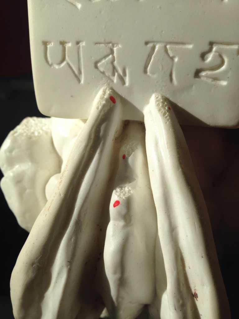

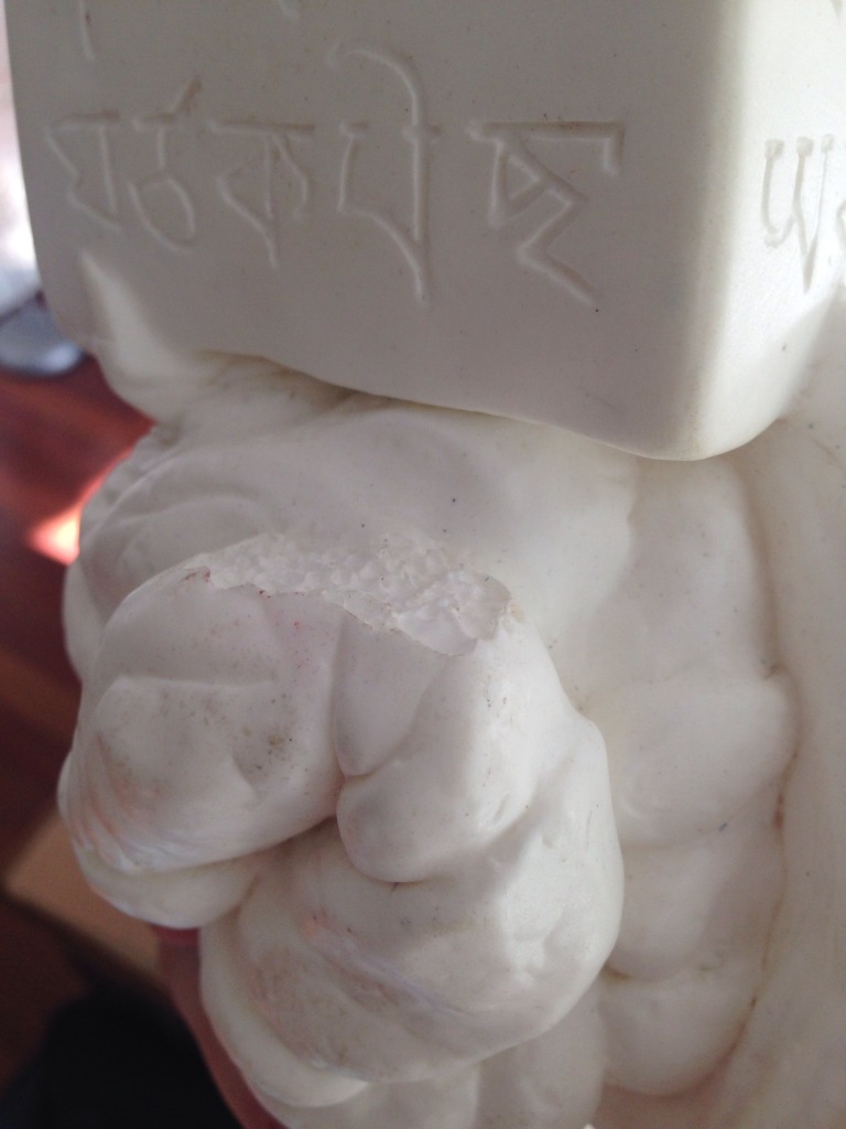

As exciting as it was to get a big chunk of resin in the shape of my sculpture there were problems. Mainly bubbles.
There were a couple crevices in the silicone mold that caught a couple bubbles during the molding process but a pointy file can pop those out without too much trouble. Not bad but not perfect.
The main issue was bubbles in the resin casting itself. This statue has a bunch of pockets and crevices for bubbles to get stuck. The worst area was his (it's?) elbows and a couple spines on the back. Big undercuts.
CAEDBF3A-65DB-4048-8D34-9F35138E71BB-2049-000001929E8D0112_zpse7bd2dd7.jpgC7167489-515F-42F2-8867-FE18563B45F1-2049-000001900B5151E6_zps6e8dacc0.jpg
To fix this, I started to fill the mold halfway and tilt the mold in an attempt to "burp" the trapped bubbles in the elbows and then fill the rest. It sorta worked a but It was hard to tell if I had got them out or not during the pour. Inconsistent results.

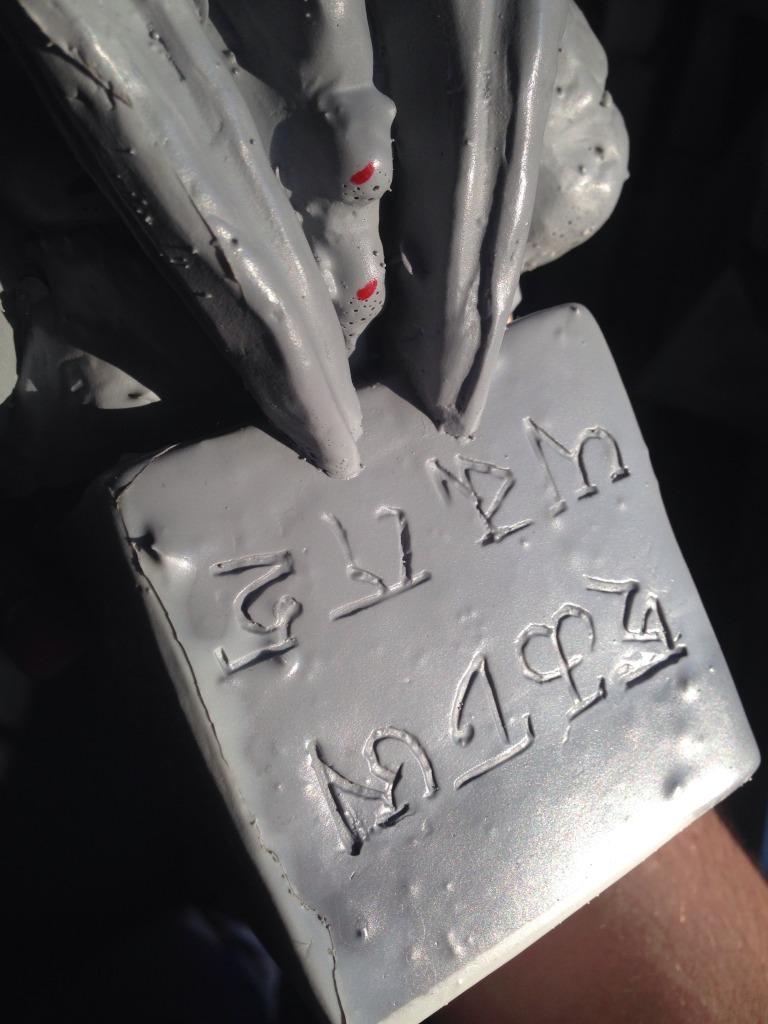

I was also getting bubbles in his face and other places that weren't too badly undercut. Just bubbles that wanted to stick to the surface.
The best trick I've found so far was using talcum powder as a release agent. It did a pretty good job of keeping most of the surface bubbles off. Still not perfect though. Again Inconsistent results.

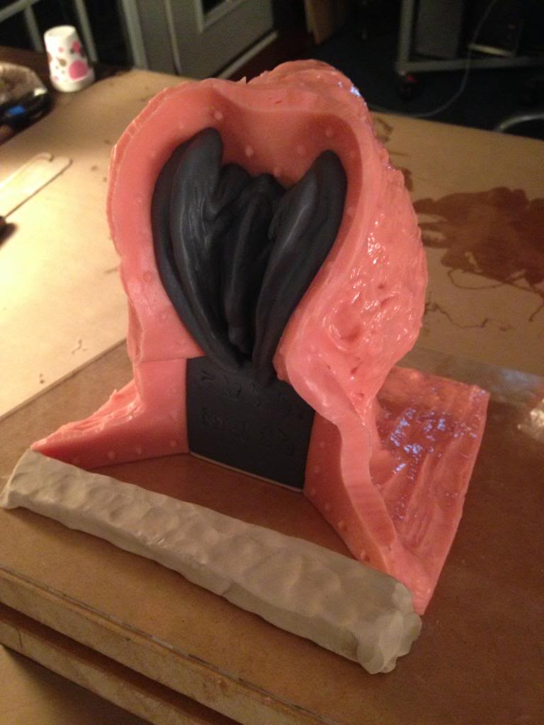

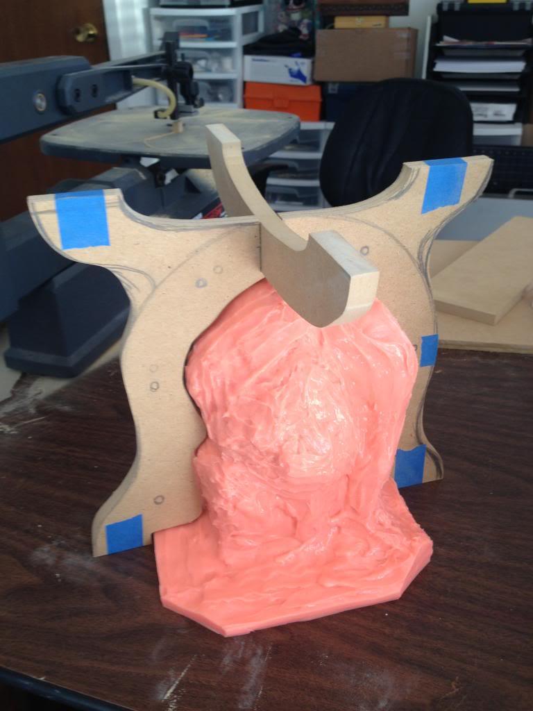

I decided to remake the mold. This time I'd make it a 2 Part mold, try to not get bubbles in the mold itself and I'd put vents in for the elbows.

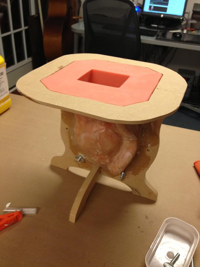

Again Rebound 25 was used and a fiberglass mothermold was built with an MDF frame. I thought the built-in stand was a pretty clever idea.
The elbow vents were made with two wires that ran from the elbows to the top of the mold. I figured I could just snap them off and pull them out with needlenose pliers after each casting. Sadly I think the wire I used was too thin and no helpful venting occured.
Also for some reason I ended up with more bubbles in my silicone mold than the first time. I may have gotten sloppy and impatient from this being the second time doing the same subject. Not sure.
I was also a bit dissapointed with my seam line. The flash was a little more pronounced than with my single slit version before. Nothing terrible but surprising since I figured the slit method was inferior.

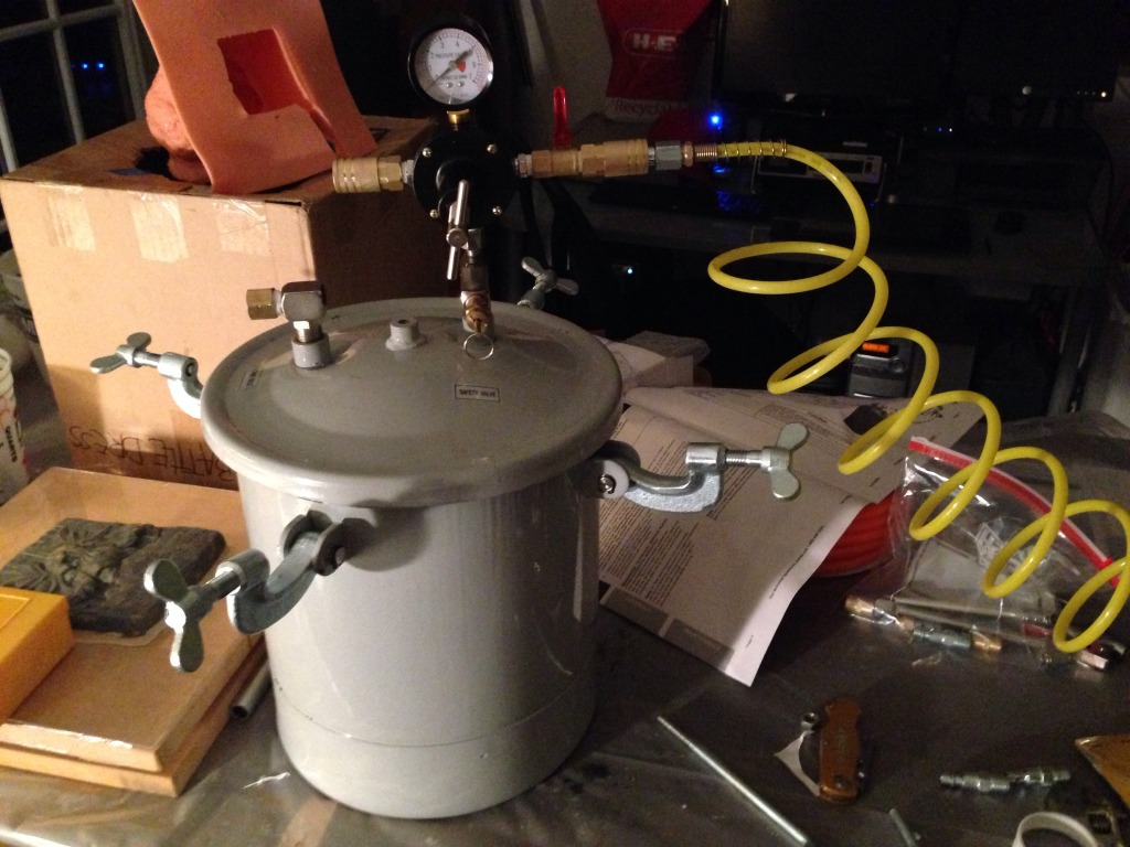

I was now desperate to get consistent good castings so I made a pressure pot.

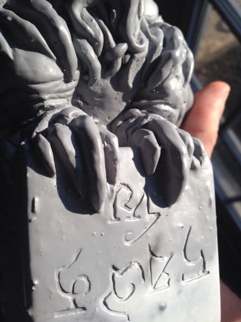

I cut down the base of my original brush-on mold to fit and made a quick casting only to realize the vital importance of a bubble free mold when doing pressure casting.
26CED667-9F19-4B08-AE41-545D31AD4D6A-2109-000001AC1513DF49_zps7b1e33a9.jpg 74E15CB7-6581-4129-A9F0-802ABD7CCCD1-2109-000001AC1B6683FD_zpsdc6d4e00.jpg
Every subsurface bubble in the rubber expanded and made a lump in the resin. In many places the pressure actually popped the trapped bubble and pulled the resin inside creating hundreds of little resin pebbles forever stuck in the mold. It would be super fascinating if it wasn't so heart breaking.
I will say that the pressure did shrink the giant bubbles in the elbows to a much managable size though. Still not enough though.

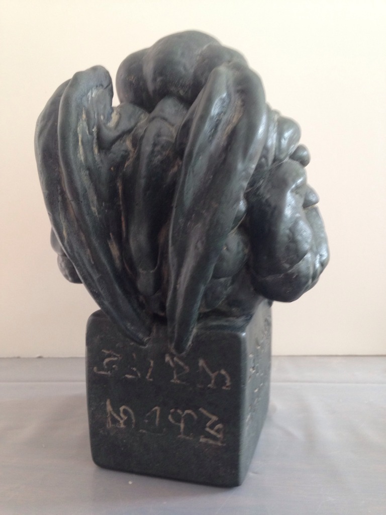

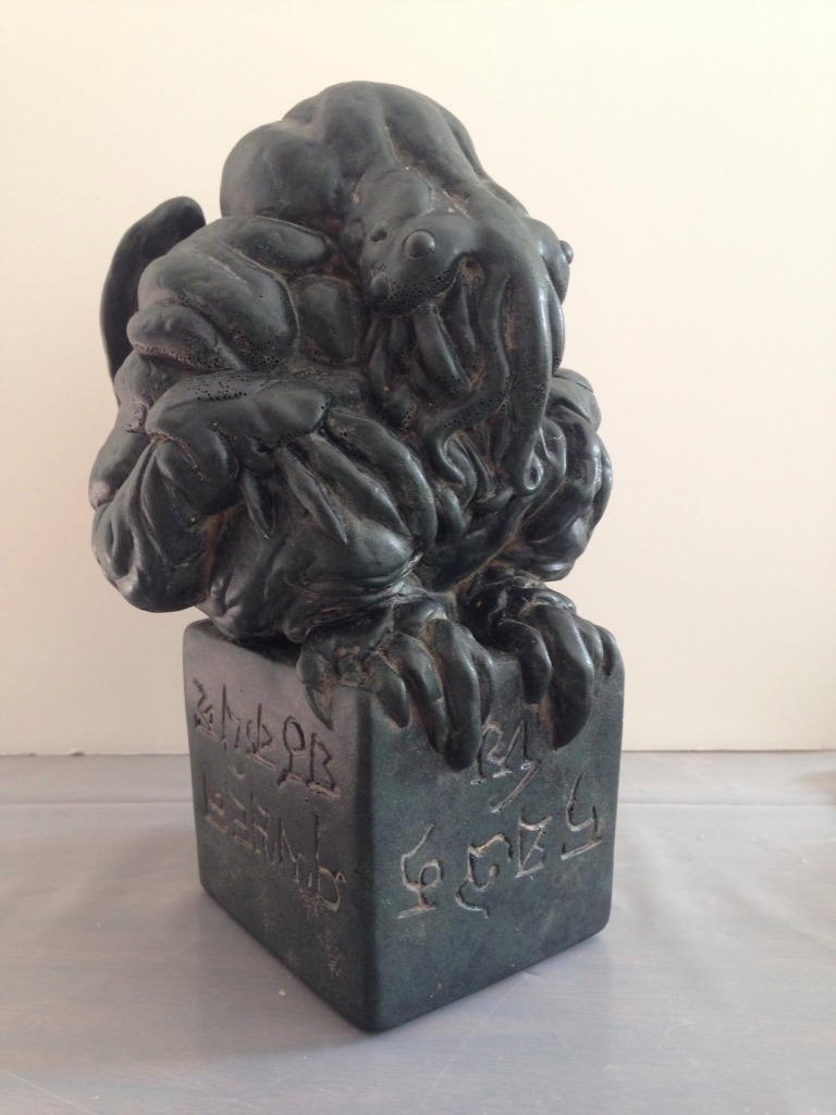

I just wanted to update you guys with how things went.
I went ahead and created a third brush on mold using the techniques that worked best from my other two molds.
My first two silicone layers were very carefully dabbed in trying to avoid any trapped bubble in the deep tight crevices. The results were pretty clean. Only a few that that create resin bubbles that pop out very easily.
I cut a slit in the back instead of doing a two part mold and the results are really nice. The seam is almost completely invisible after casting.
And concerning casting I went with people's suggestions here and slushed two thin layers of resin into mold before filling the cavity and the results are very good! The undercuts pose no problem anymore although it is a bit of work to get a casting poured up.
