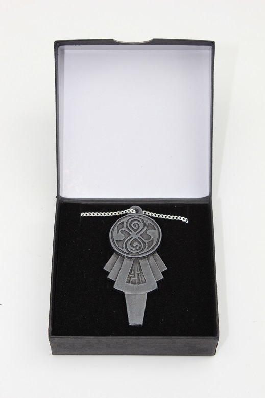

Some years after I made the duplicate for the client, I made another as a gift for someone special.
