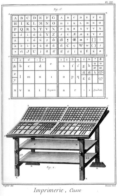

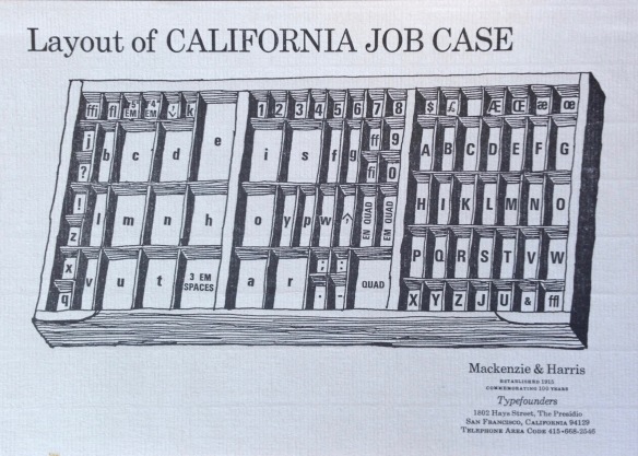

Probably because it is a ridiculous number of extra letters, or special type that allows for placement of the accent marks.
It's been a long, long time since high school French, but here it goes! I think there are 15 letters that have accent marks, (Of which there are 5), so for upper case and lower, there are now 30 more letters that you need multiples of.
Add to that the typesetters were likely trained with a specific layout for the type case, (Likely California Job Case), and French type case layouts are way different. The type was usually organized in a way that made for efficient typesetting, so any variation would cause a huge slowdown as the printer searched for the next letter. Far easier to just hand paint the accents!!
Especially if you have "The Perfect Font", but for some reasons, the accents are missing.... I've done that with digital fonts!
This is an 19th century French type case, followed by a typical California Job case layout.
What's crazy is how similar the layouts are.
