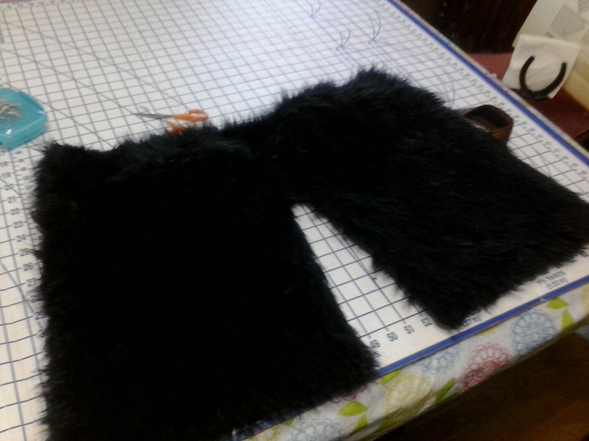

Fuzzy butt rug!! (or fur kama, whatever)
I'm pretty proud of how this one turned out. Those leg straps are awesome and don't actually impede movement too much....but they're a pain to make.
The kama actually zips in the front with a baby zipper (a whole 2 inches of zipper) that is hidden by the codplate when mounted. I'm especially happy with the pockets (non game actuate, but hey, pockets are pockets at cons) I've added and the fur edging on the kama. If you look closely at the game armor, you can see the fur around the edge of the kama is running a different direction then the rest of the fur, and I've managed to do that with my kama by adding an extra row of fur around the edges. It sadly does not show up well in pictures :p...but hey, I know it's there!! It actually sits just below my hip bones and slightly above the groin - for some reason, the game designers decided to elongate the torso armor to reach down past the navel, so this sits pretty low.

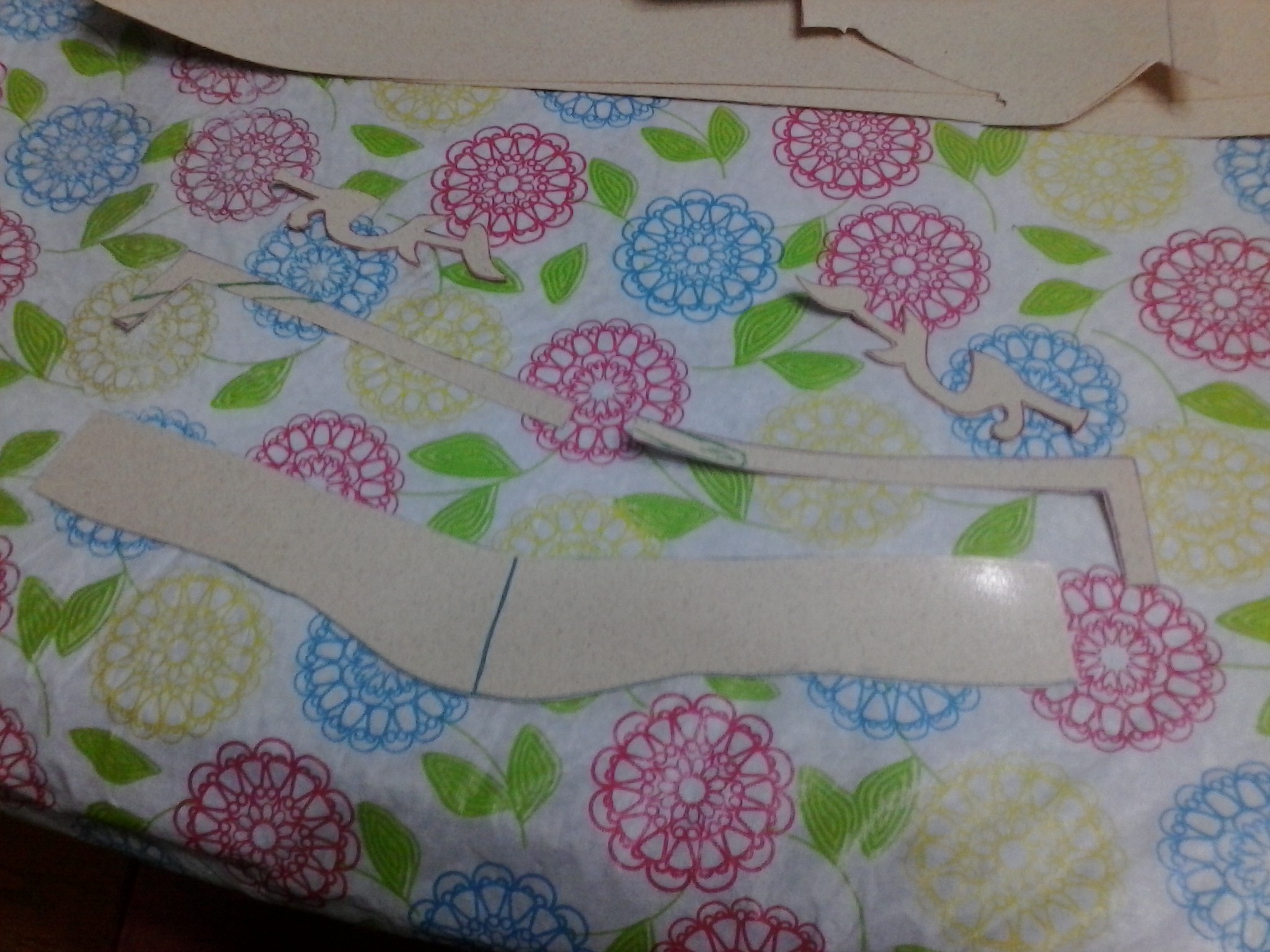

Basic layout of the sleeves.
IMG_20160712_171525.jpg in process.
finished thingies!

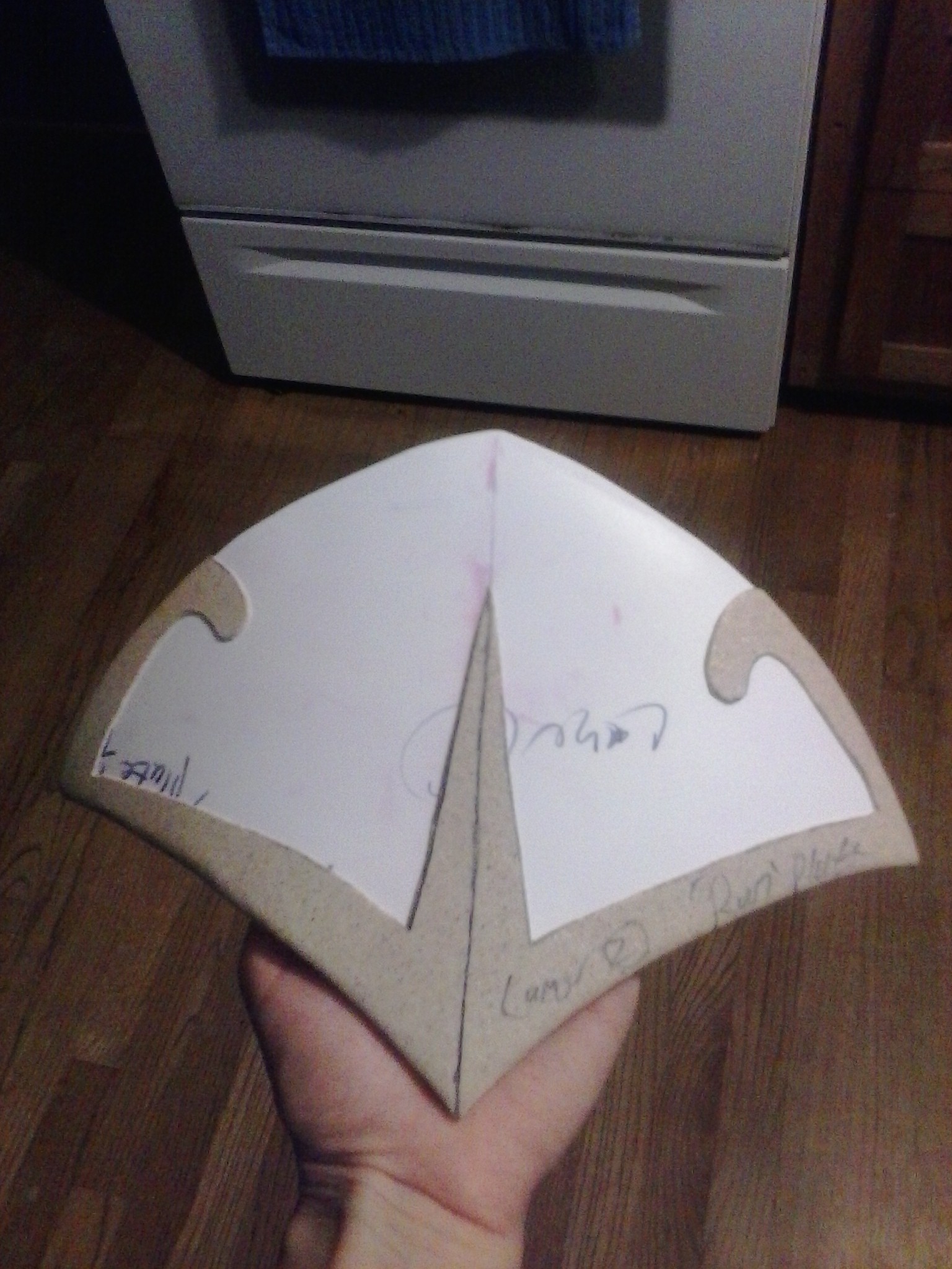

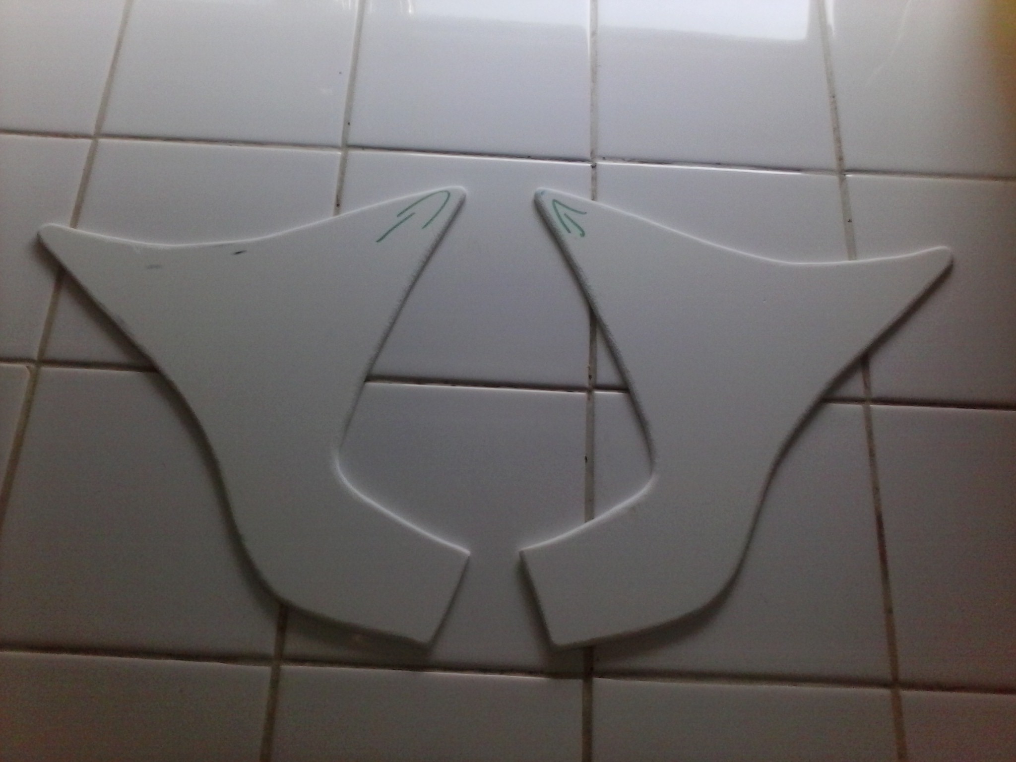

Cut bitty boot plates! Still a lot to go on them, but they've been put on hold for a week or so while I work on torso armor. I'm very happy with the crisp lines on them though.

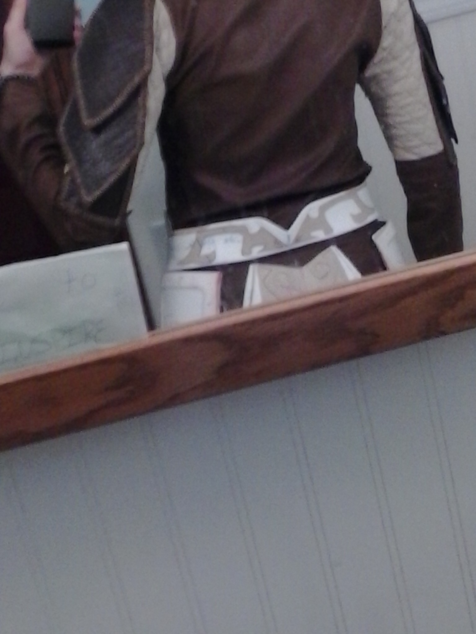

Alright, here we go. Butt plate thing.
The Terraflex got a little stretched out when I affixed it...(ok, actually it got stuck to the pan I use to heat things), but the great thing about Terraflex is that you can mold it while it's hot. So I squished it back together and hid the damage with battle damage. It's a cute little plate.
This silly plate is like, the bridge between the codplate and the belly plates.

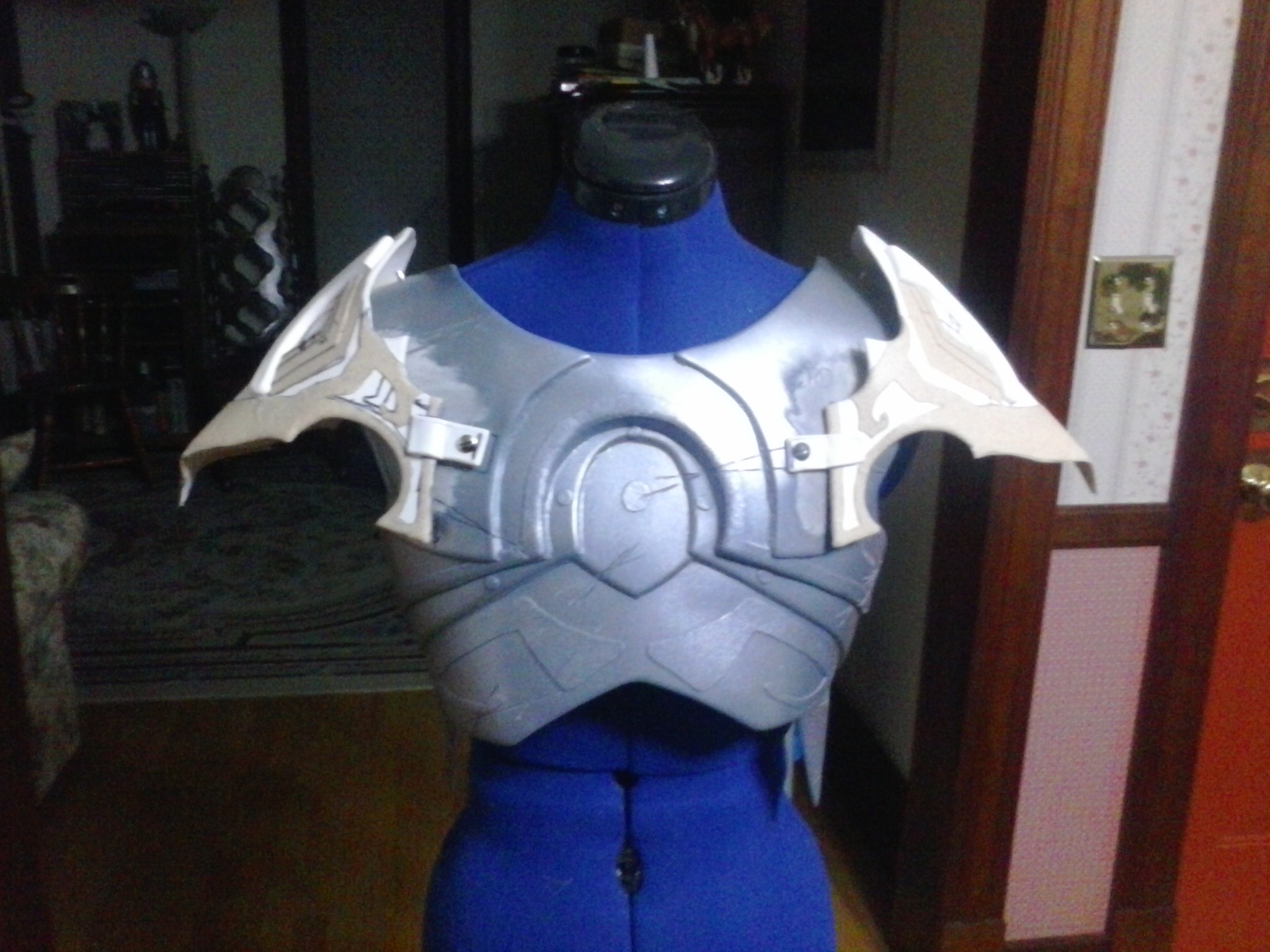

I think the next thing I worked on was the chest plate(s). This is a pretty complex piece and gave me a fair amount of stress while I was building it, but I think it turned out really well.
Step 1: Pretty simple. Cut and shaped the center piece and the bottom layer. Attached and bondo'd.
Step 2: Attached 3rd later to the stop of the other two and bondo'd. There ended up being a lot of extra lines for spacing on this plate then there needed to be, but they all got covered with paint.
Step 4: Shaped and attached top layer of chest plates/start of shoulder plates. We ended up filling the big gap there with expanding foam, and then I bondo'd over it to make it sturdy and secure.
Step 5: Terraflex details were added....They actually helped with the whole look of the plate a LOT!
Step 6: Add Authentic Nord penguin duct tape!! (No, ok, I kid) Added the finally layer to the chest plate, which shape over the shoulders and attach to the backplate.
You can also see the bondo in the big crack on this picture.
I did add the "fangs" that go down off the bottom of the chest plate and overlap with the waist plates, but I do not have good photos of those. Sorry!
