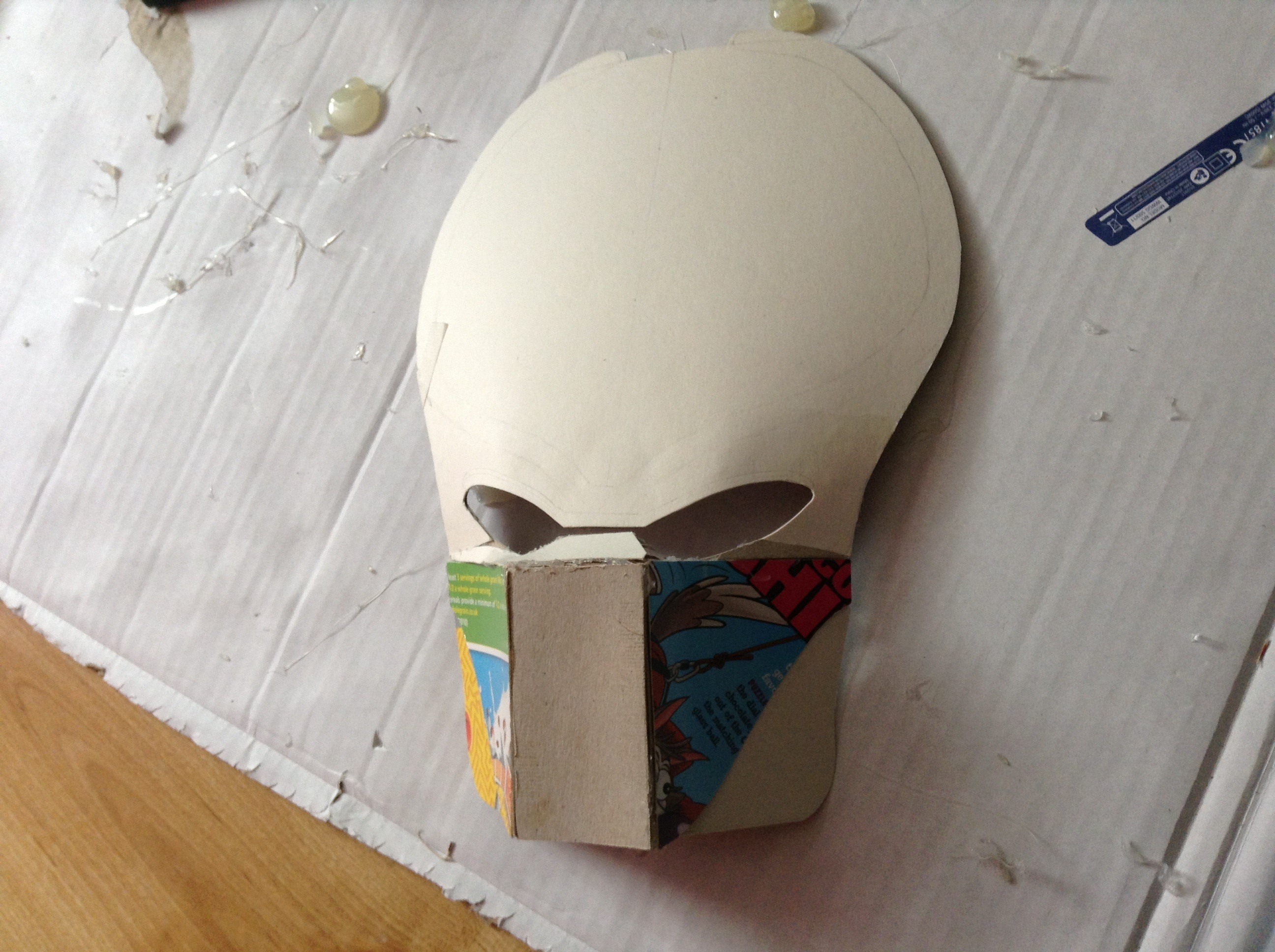

I saw a few cardboard predator bio helmets on the net, so I decided to have a go at my own, boy did the cardboard assembly take longer than I expected, It took me a day of cutting and glueing to get the helmet to a level I was happy with.
The helmet is my take on the p1, at the moment the edges are kinda sharp, but hopefully when I get the filler on the curves will be nice and smooth. Please feel free to give me pointers as I am here to learn, thanks.

Lone predator said:
Any ideas on what filler I should use?
On my cardboard and posterboard masks, I've always used either: (1) fiberglass resin, without the fiberglass cloth--one or two layers on the outside, and 4-5 layers on the inside, or (2) plain cotton muslin cloth layered on the inside with Elmers glue, and a couple coats of watered-down Elmers on the outside.
I've got some fibreglass resin and cloth that I never got round to using, this is a perfect opportunity to use it. Trouble is I don't have a respirator, and that's probably gonna cost me around £20, that's gonna delay my progress...

That's why I like using cotton cloth and Elmers glue---it's nontoxic, cheap, and I can get it anywhere.
