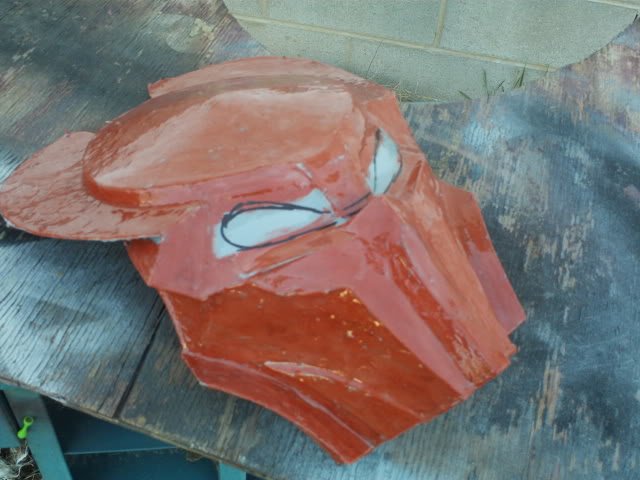

sand the red glazing putty down smooth with sandpaper and next i coated the helmet in 2 part epoxy.
the epoxy soaks into the putty and primer and hardens to a shell.at this point the helmet is hard as if it was made of resin.
once the epoxy was dry i threw on some sandable primer.the lumps in the fiberglass are still there and since i want this to look "organic" like most bios im gonna leave it that way.
im going to leave this to dry tonight,tomorrow i will sand the helmet and using a belt sander smoothen all the edges where the fiberglass ran.

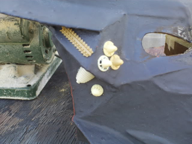

i then added some small resin greeblies to make the tri-laser and more for fun.i also added some hose to the other side.

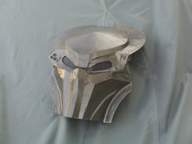

after that i painted the helmet wityh silver "hammered" paint
and as that dried,i mist on grayish brown hammered paint.i mist on more silver on top of that and the 2 colors mixed well to produce a mettalic like colored finish

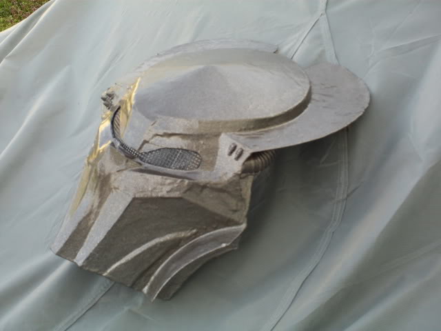

once that was dry i took a small peice of plastic mesh and mist silver onto it to make it look metalic also
hot glued that in and im done
heres the finished product,its hard to build a helmet with only 1 reference photo.but it was a fun little project anyway.
