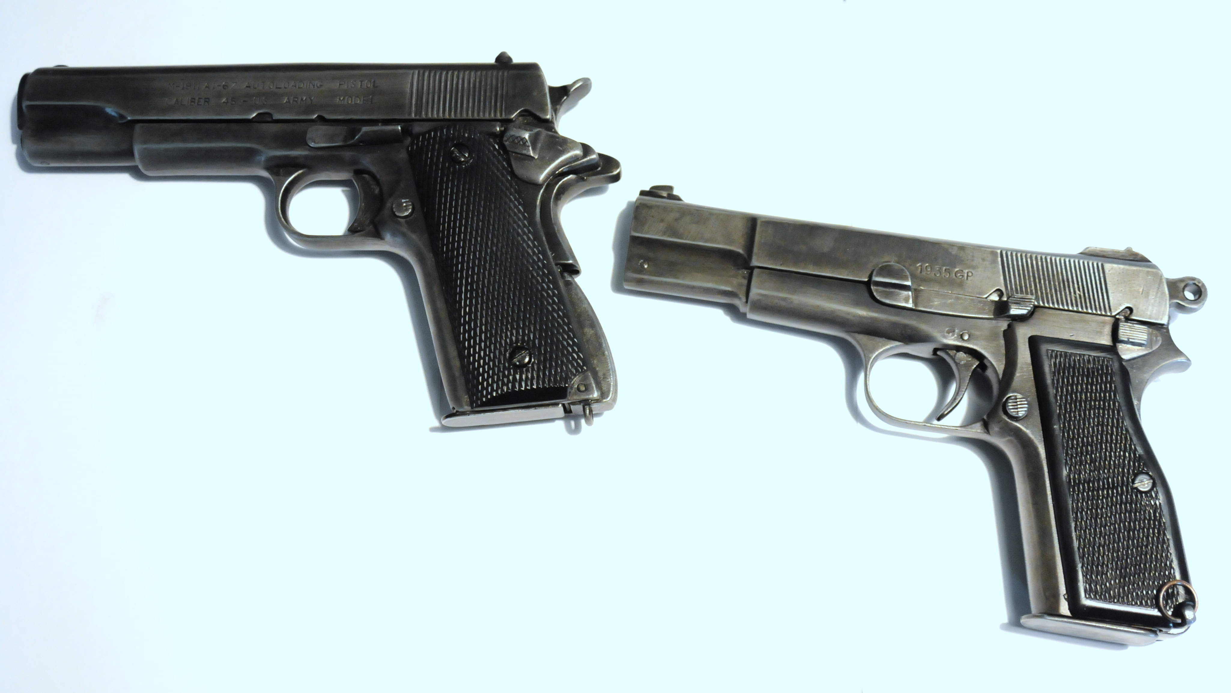

You can use BlueWonder with spectacular results but the downside is that its not the most robust finish so it won't take the kind of beating a traditional blue would tolerate.
This is a DENIX Colt 1911 showing the blue finish but the magazine isn't Denix, its a genuine Colt part.
Regards
MARK
