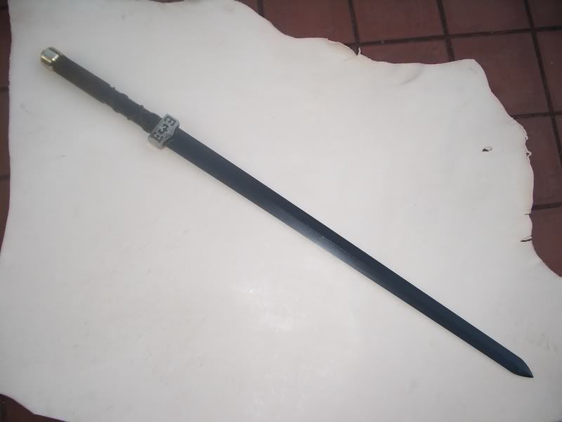

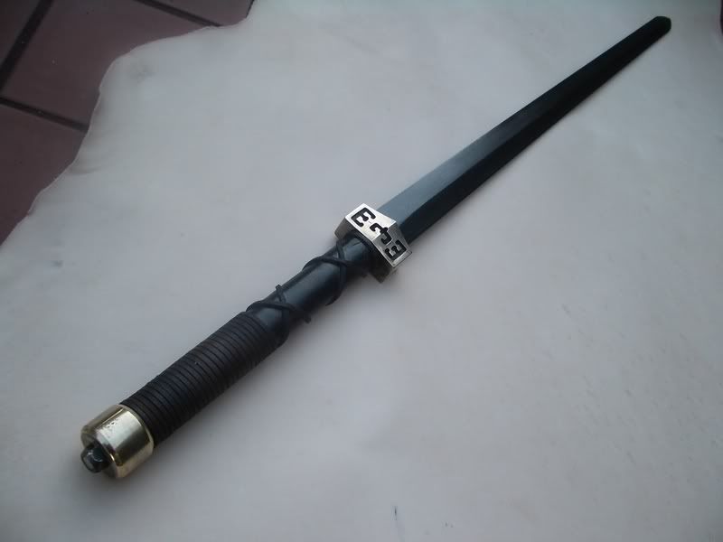

As an example, here is blade that I made where the customer wanted the blade blue. So this is blued steel. Props to those who know what blade this is :)
