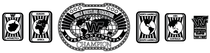

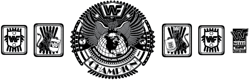

Anyway, below is more pics of some of the belts I have done as well as a few pics of the art files that make belts.
