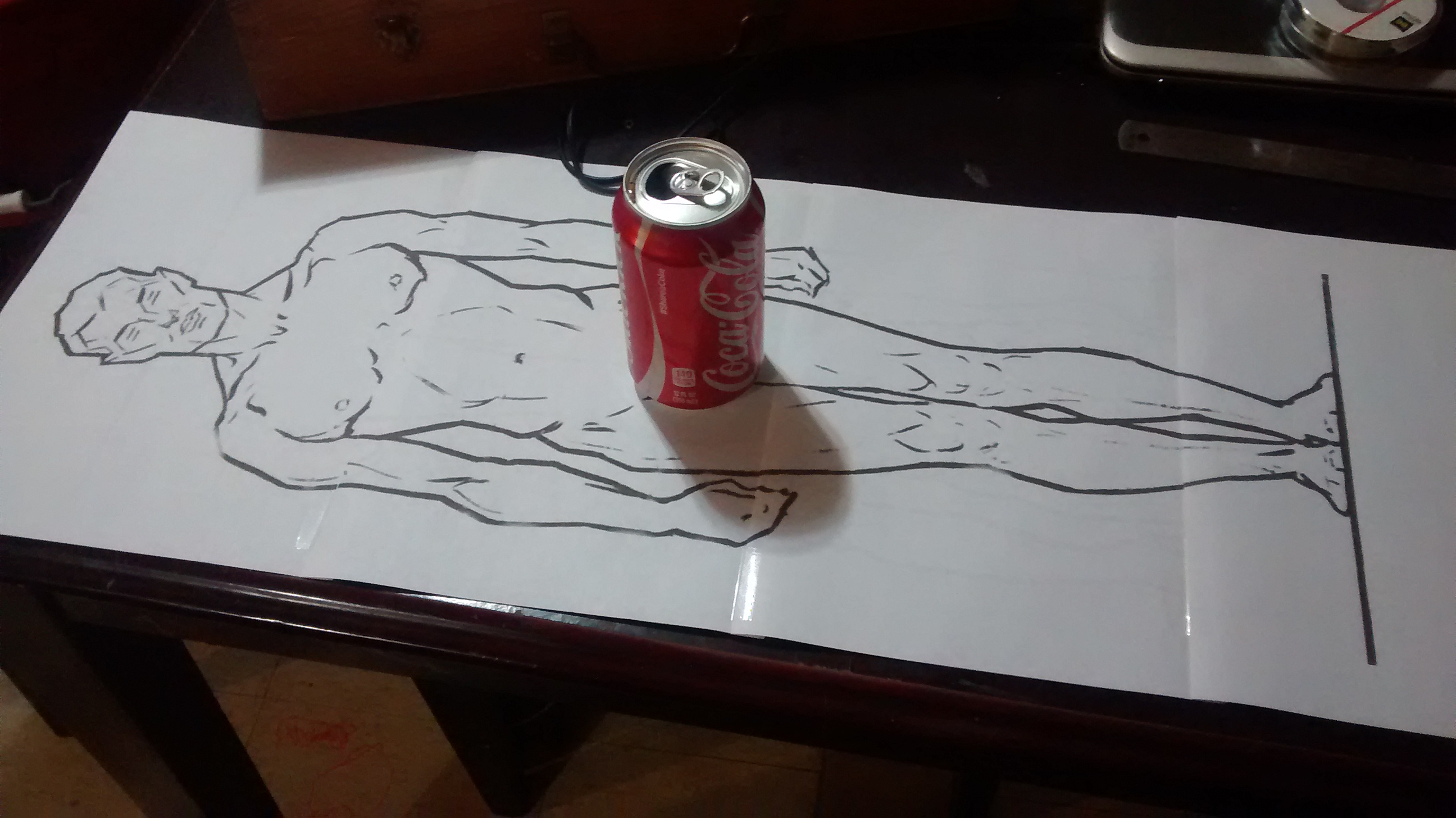

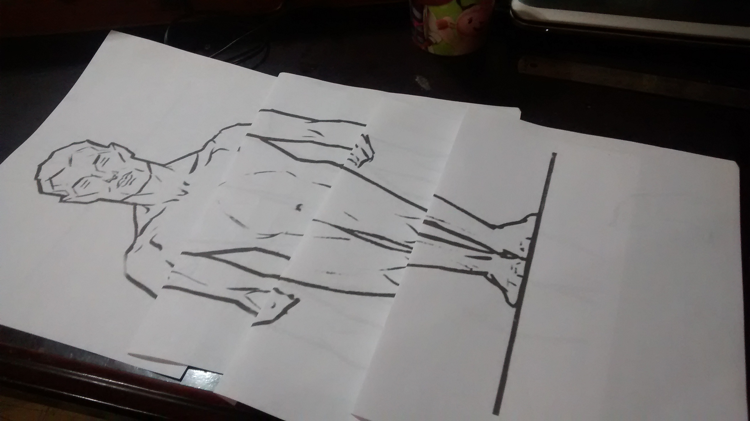

    OK, so I'll be able to go to the copy shop tomorrow to get a blow up of the iron man suite mark 7, but I went ahead and printed out a base figure to scale to begin my armature. So here is a shot of it with today's paper and a couple other shots. I am going to sculpt this armor in the same manner a ball jointed doll is sculpted, using a paper clay and a cardboard armature. I know that sounds flimsy, but it isn't. It will be quite stable when it has cured. I can't swear he'll be jointed, I am just using the same technique. And the paper clay will allow me to get a very crisp surface detail. If you need a shot of the completed armature with a current paper, let me know. I intend to post lots of progress pics along the way, anyway. when I get home from work tomorrow I will be able to spend some time on it, and then post some more pics Tuesday. I have class tomorrow evening from six to nine so I don't expect to be up for much when I get home tomorrow night.

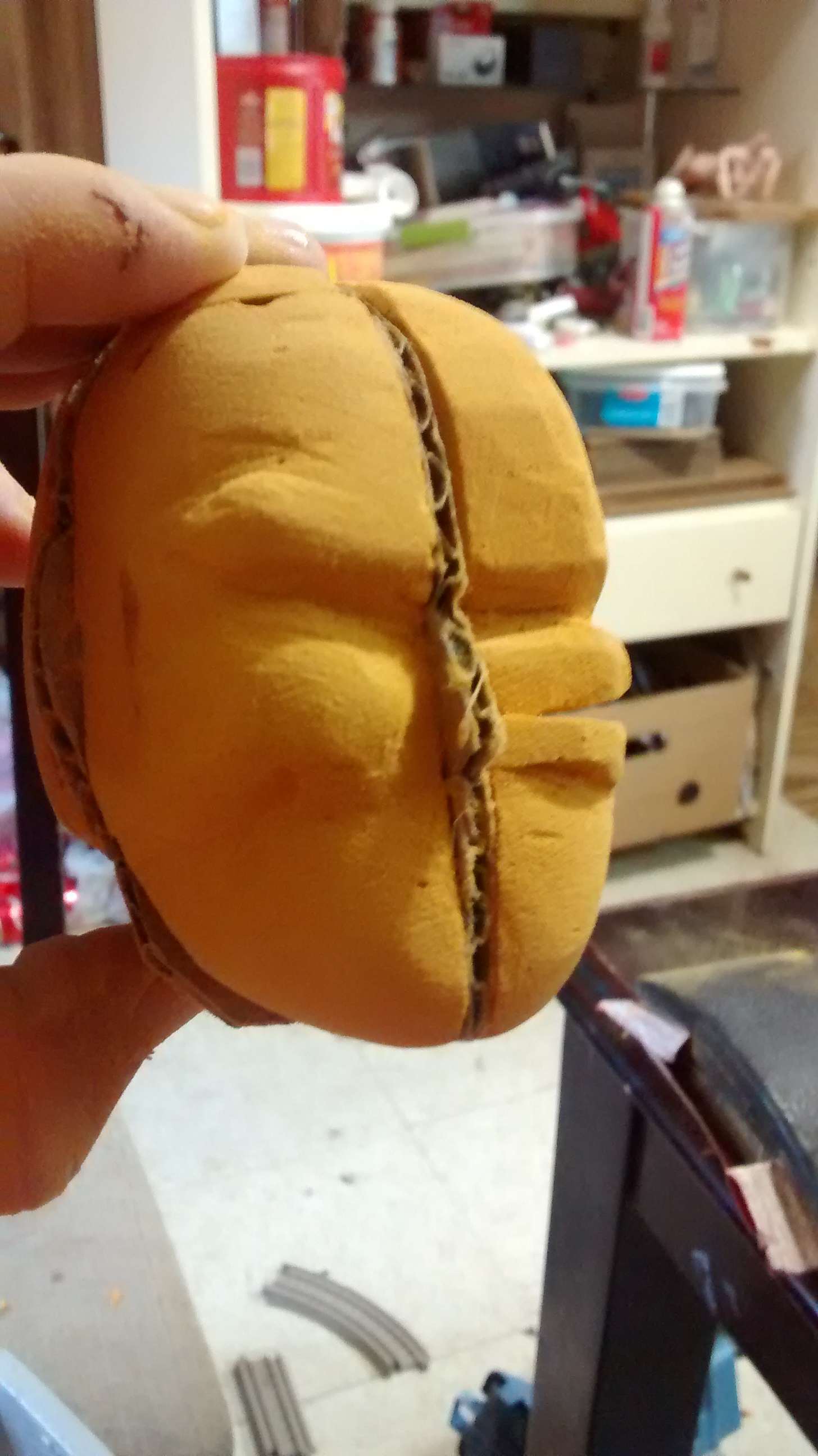

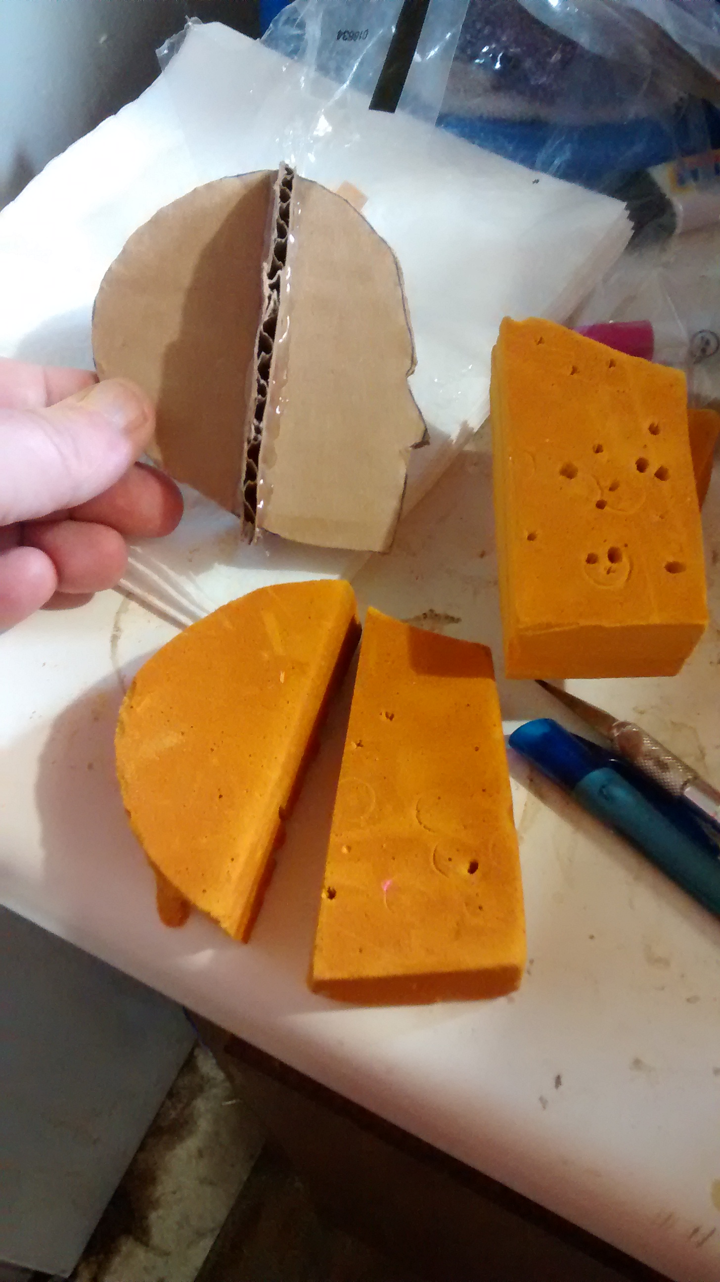

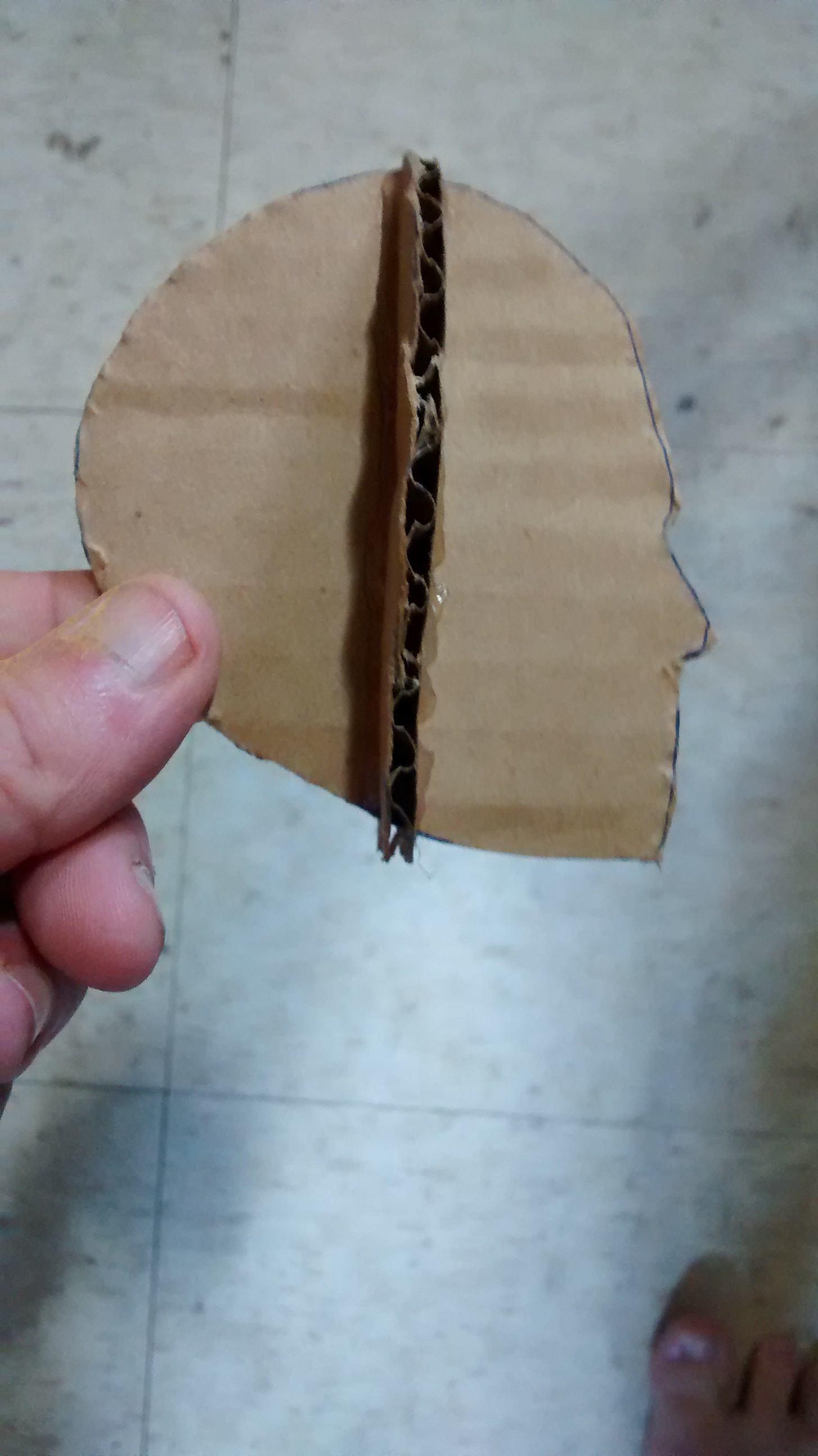

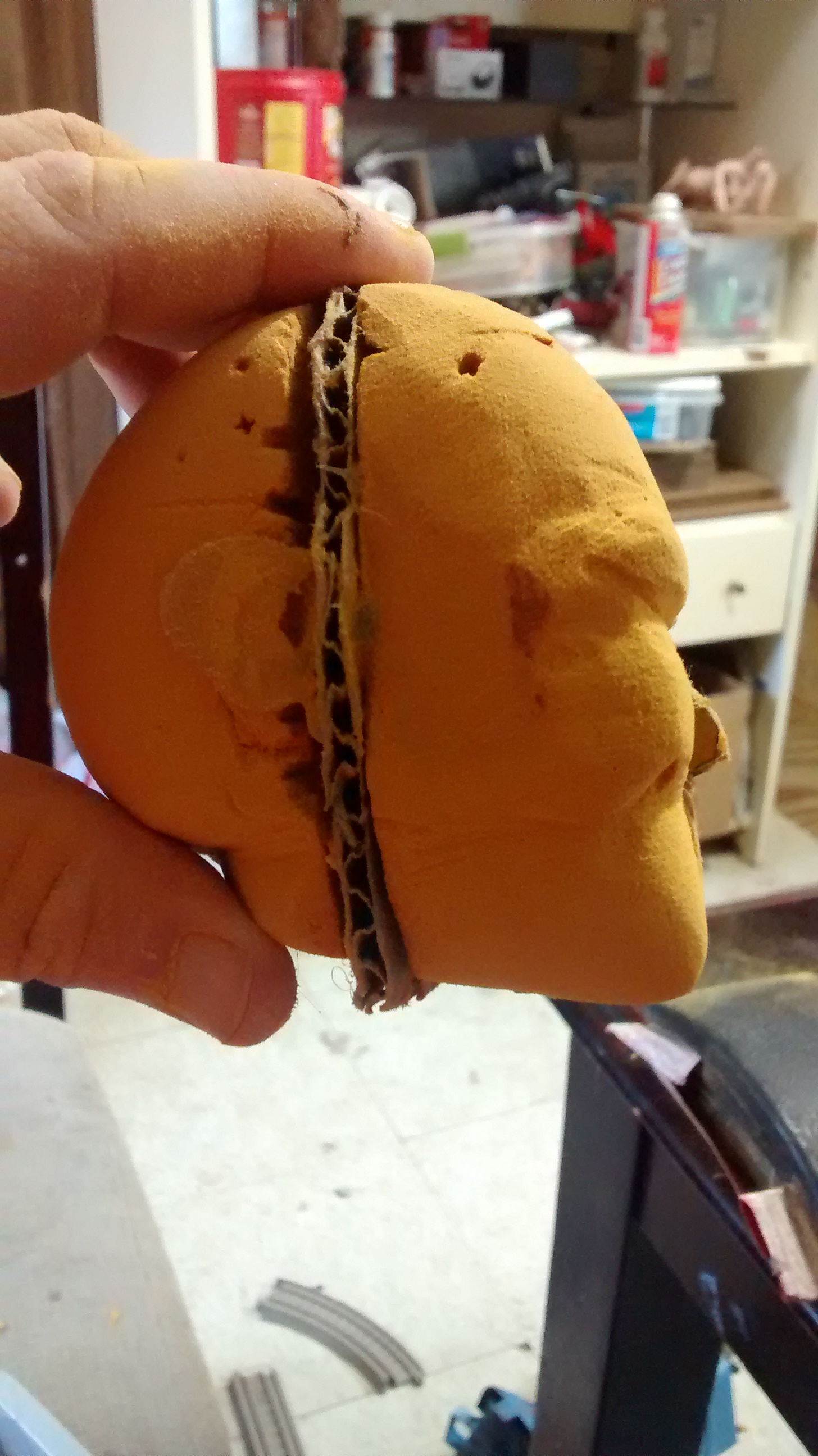

    I decided to start with the head and torso because they are the easiest to marry. I have never used paper clay before, so I did a lot of studying and chose materials for a base structure. Being poor, I used cardboard. Then I hot glued some balsa foam I had left over from another project onto the frame and sanded it down to make a pretty little head to sculpt the helmet around-
    IMG_20150818_131247846.jpg IMG_20150818_131306092.jpg IMG_20150818_143456000.jpg IMG_20150818_143501012.jpg

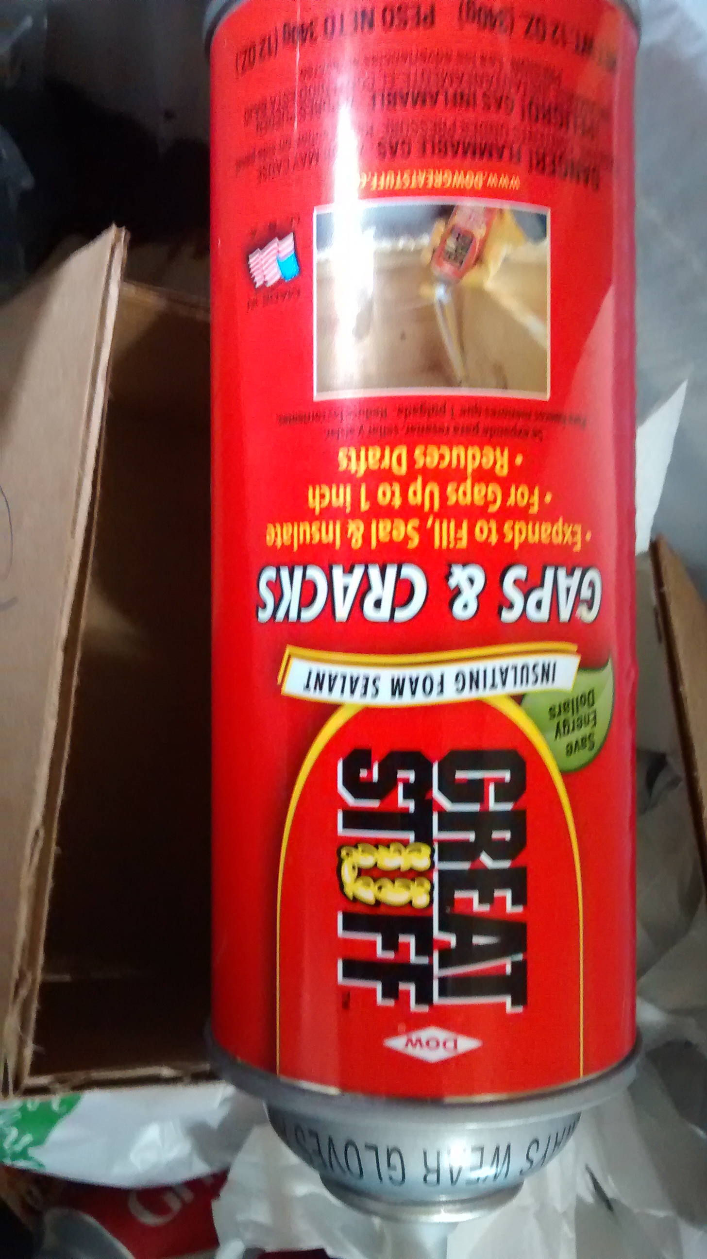

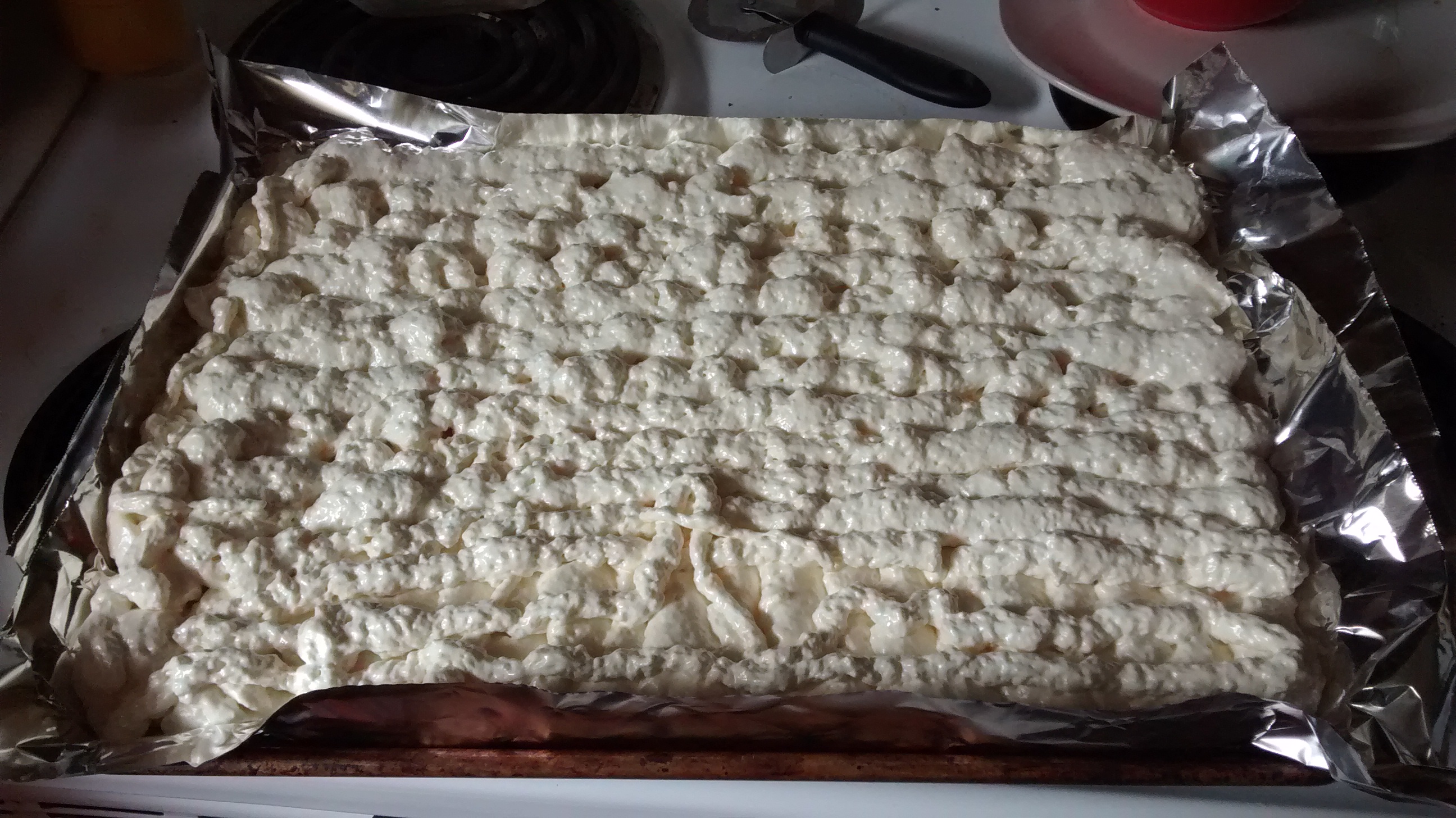

    The substance you see on the torso is actually a gap filling foam from Home Depot, (cause I'm poor). I lined a cookie sheet with aluminum foil and sprayed the foam out into a continuous layer. Then flipped it over, removed the foil and allowed it to cure before using a bread knife to cut out what I needed to glue to a cardboard silhouette of the torso. I was actually kind of proud of myself for being creative. (My first attempt at a base structure was just cardboard blocks, but it was a pain in the butt, so I abandoned that idea). The foam is easier to tweek, too.

    Well this is interesting.
    Never heard of anyone basically, making their own foam....
    Usually people buy a few couple-inch-thick sheets, glue them together, and start sanding it down.
    Or to use like, a mannequin, and use modelling clay.
    This is (i believe) a unique idea.
    Mabey you could make a scaled suit out of Paper (.PDOs and what-not), then just inject the insides with the sprayfoam.
    Would that save any time/money ?
  8. Cadeus
    Cadeus Sr Member
    Trophy Points:
    1,355
    I have the means to do so. At 1/3 scale I could take any of the pdo's I have and scale them down, but I feel that it violates the spirit of the contest. I mean to use the foam as a base, only. pepakura is more like model building than sculpting, and I have great respect for both. I pepped a full scale Iron Man helmet a few years ago and it wasn't easy. I did decide to use monster clay over the foam for the helmet... I just couldn't get the paper clay to cooperate well. It took too long to cure. thanks for looking! :)
    PS- I don't mean to be unique... I am just poor. poor people find ways to get by. I think it is just "survival", but thank-you. more often than not I wish I had the means to use more appropriate materials. The results are far easier to produce.

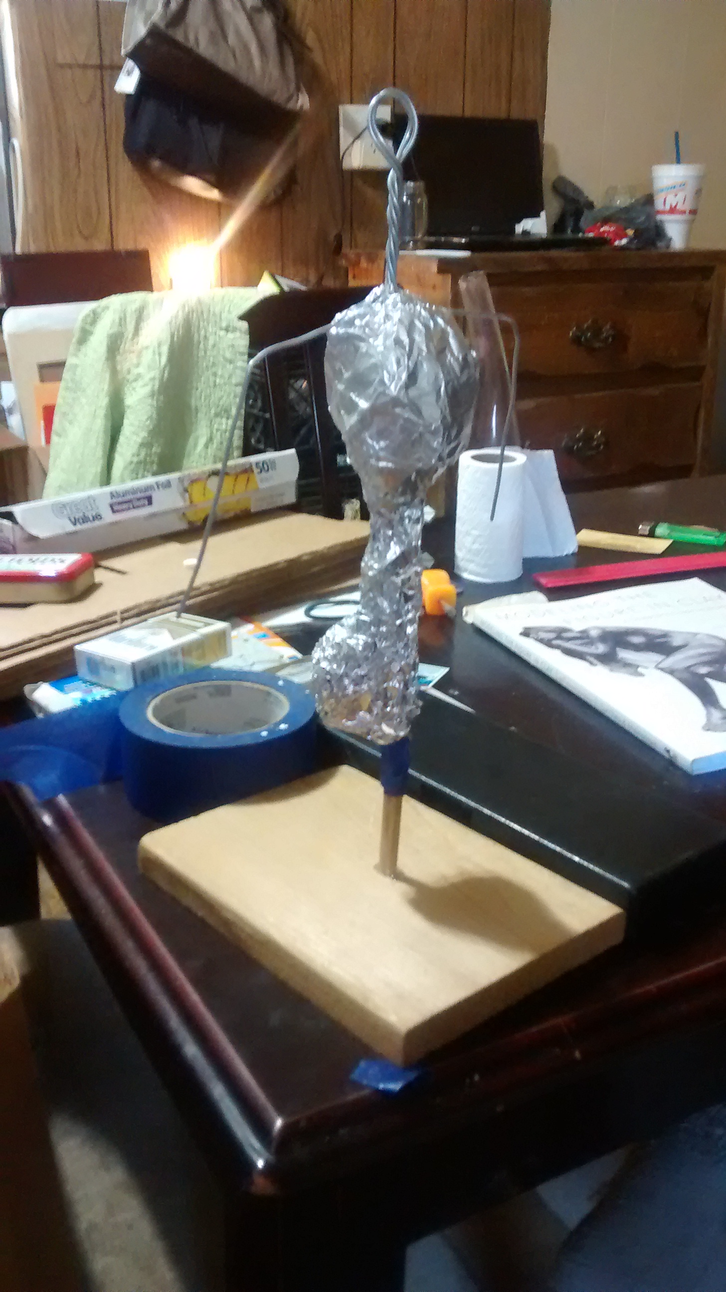

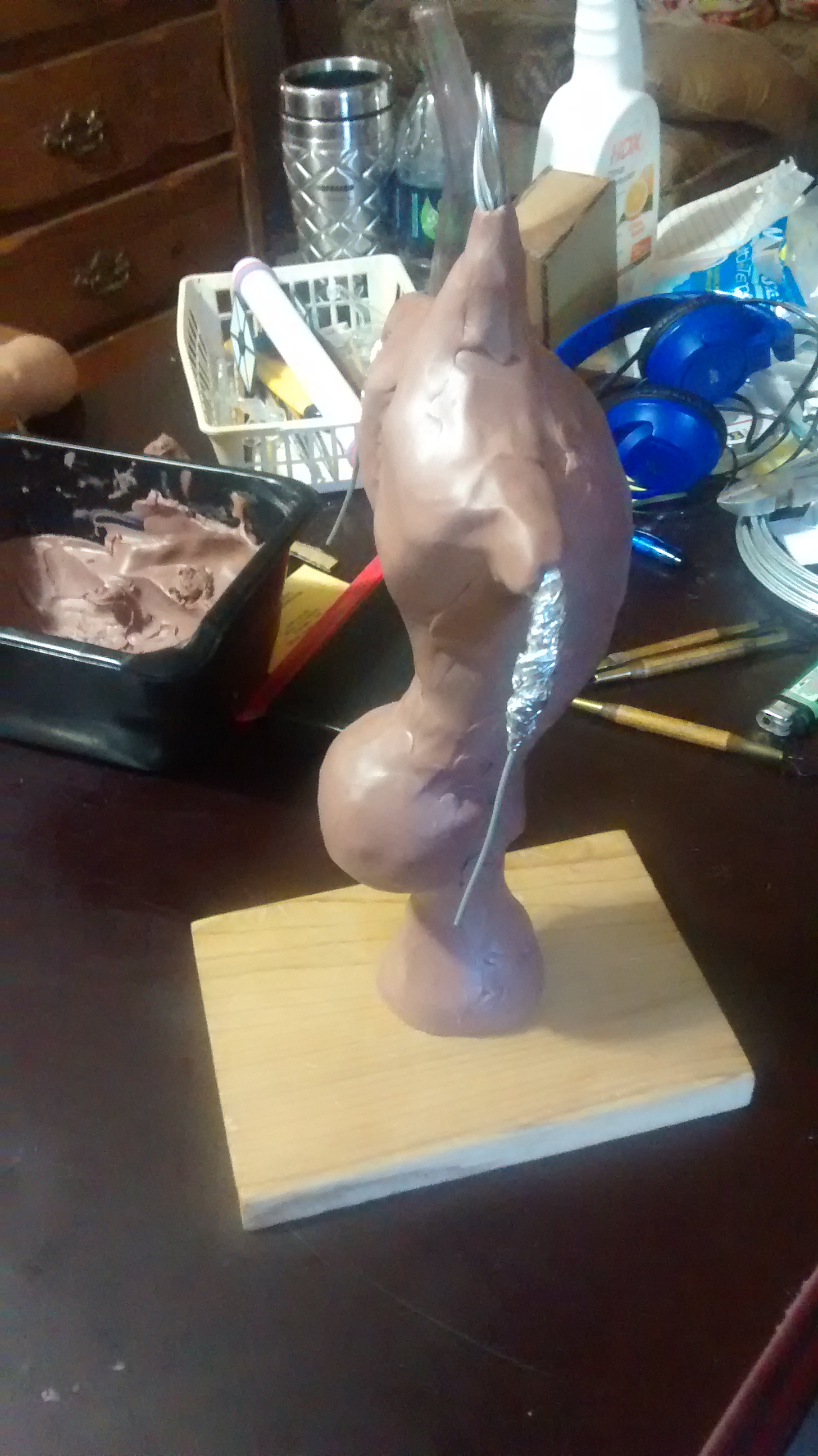

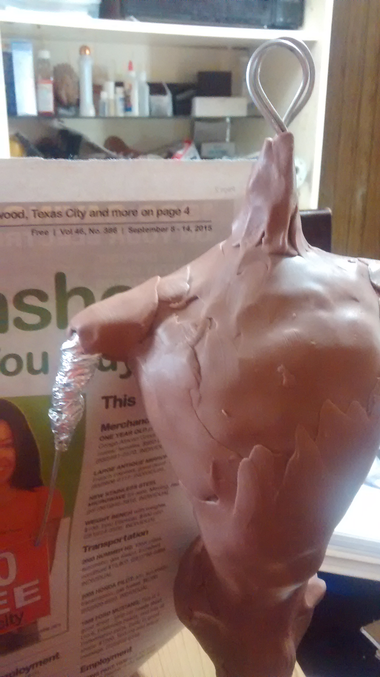

    Hello, again! I promised an update and here it is. I must first admit that my sculpting skills are worse than I thought they were. I had a really hard time getting the geometry right. The materials I used were unfamiliar to me... it was just a disappointment from the start. And sculpting a geometric figure seemed more like carving to me, which I suck at. So my model has transformed into something more organic, which I am much more comfortable with. Instead of a geometric armor from the movie, I have decided to use a model I found on the net for a more organic take on the Iron Man suite. It is a design the original artist composed from a suite from the Iron Man comics. Apparently this suite of armor was inside Tony's bones and oozed out of his skin to form the protective armor. Fair warning: THE FOLLOWING IMAGE IS NOT MINE. And, out of respect for this artist's amazing tallent, I will not attempt to re-create the image exactly. I have simply been inspired by it to create my own interpretation of this amazing armor. OK, blah, blah blah.... sorry to write so much. Here it is:
    OK, so I had to make a new armature, and then start skinning it in monster clay. I took a few pics which anyone here could agree this is only about an hour and a half's work. I don't have a paper with today"s date, so while I let the clay cool, and I am going to go grab a green-sheet. That way no-one can say I just substituted a finished piece. I am not being a prude. I just want to maintain the integrity of this contest which has become so fragile. So, here is me going in a different direction.
    IMG_20150913_140450306.jpg IMG_20150913_151342447.jpg IMG_20150913_151650392.jpg
    If there are any objections to this, speak now or forever hold your piece...
    *UPDATE*
    Here is a shot of this weeks Greensheet with the armature

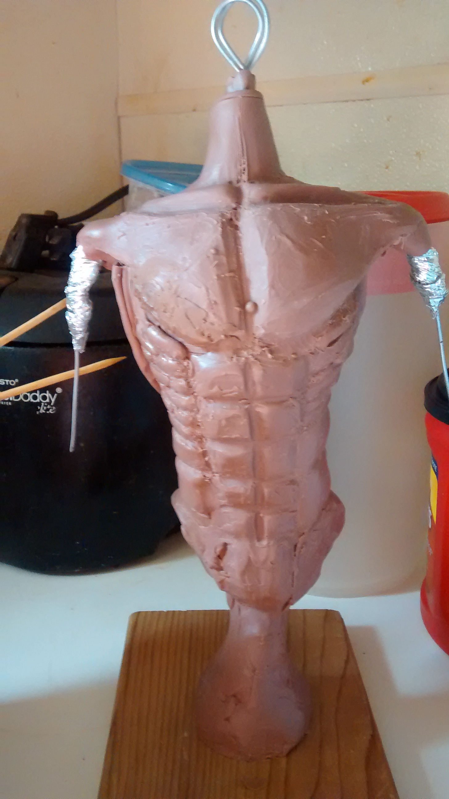

    Hey guys. I am struggling really hard to get this finished by the deadline. But I have had some problems in my life... my daughter had a heart cath procedure Friday to repair a hole in her heart. They went in thrue her femoral artery in her leg up into her heart. The procedure revealed a lot more damage... and now she is going to have to have open heart surgery to repair all the damage... on top of everything they also found a blood clot caused by the catheter they have to remove. The surgery is scheduled for Monday, and she is on blood thinners. I am just a nervous wreck cause I have to work, and I haven't been able to get up to the hospital to see her in two days. My wife is with her, and I am watching my son when I am not at work. It's just chaos. So anyway, here is where he's at now. We'll see what I can do with him before the deadline. Thanks for looking.

    So sorry to hear that, Cadeus. Sending good thoughts your way.
    The sculpture looks to be on the right track!
