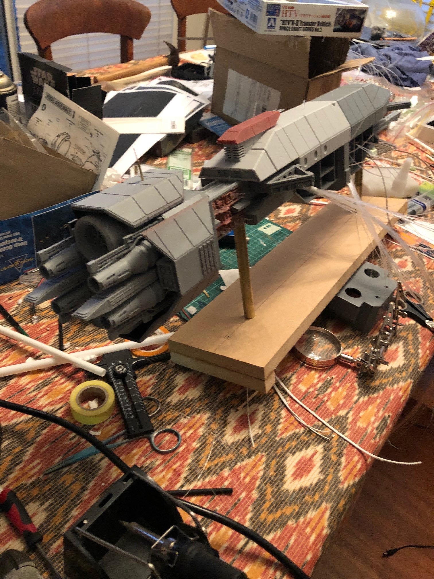

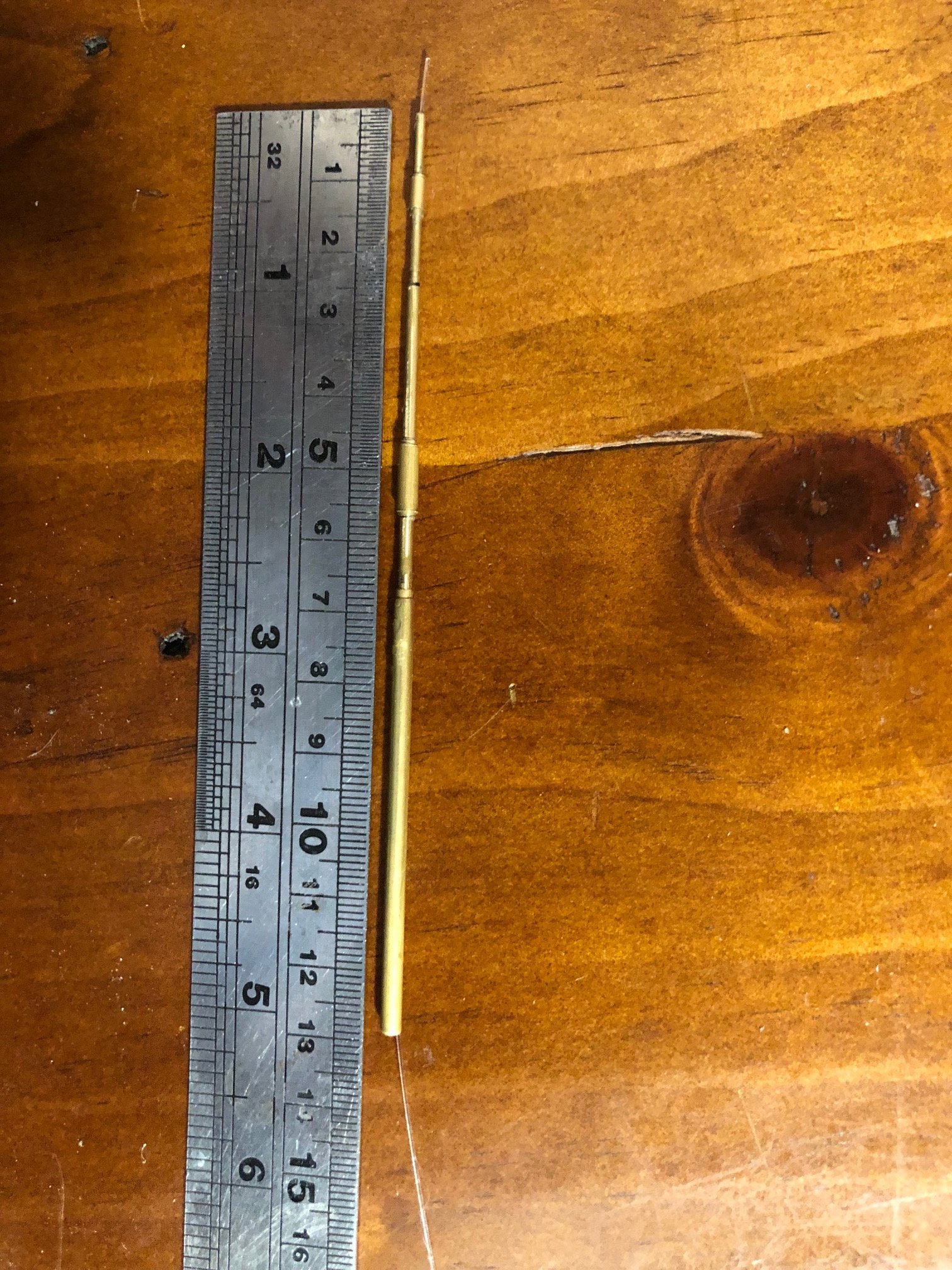

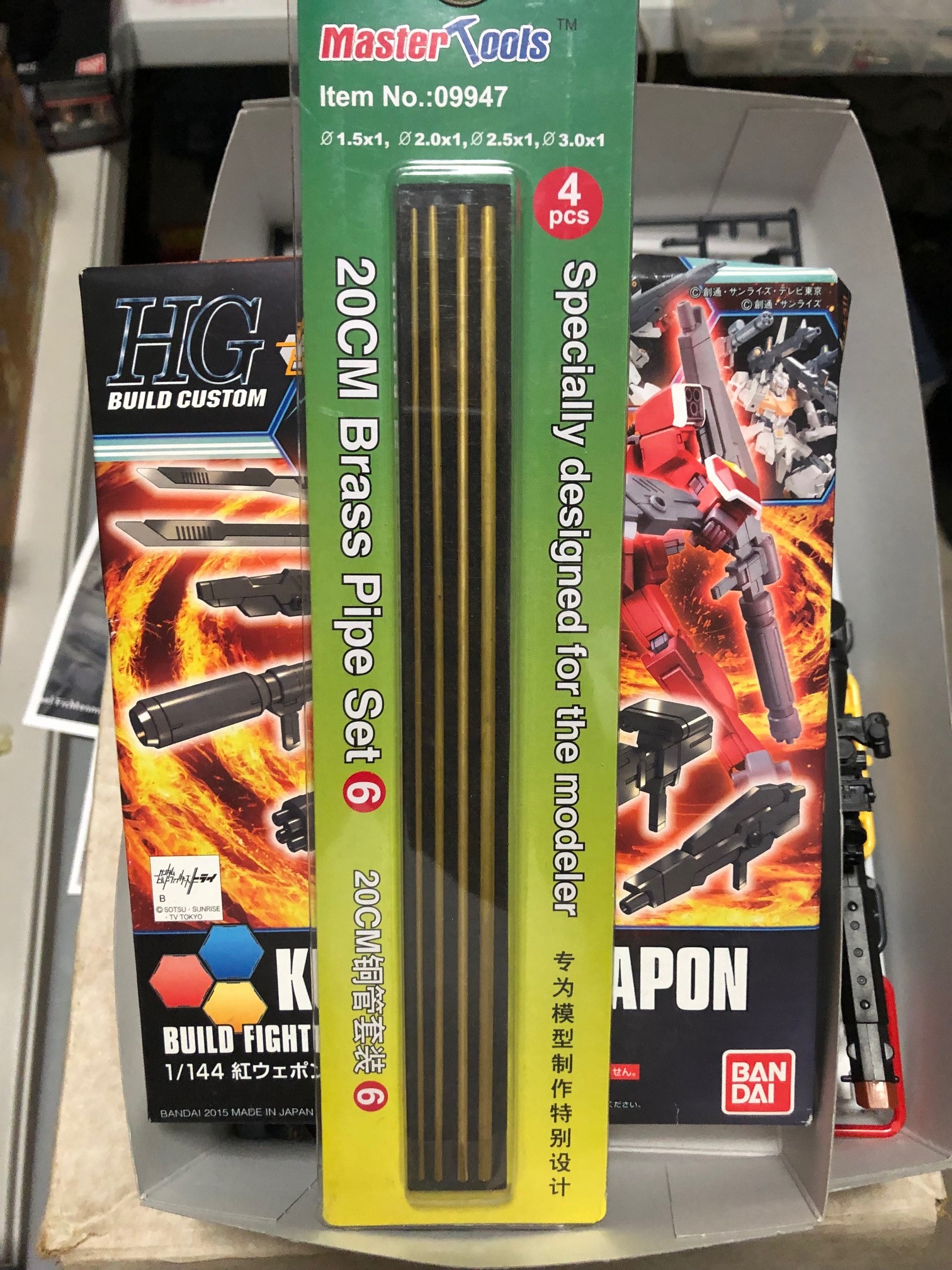

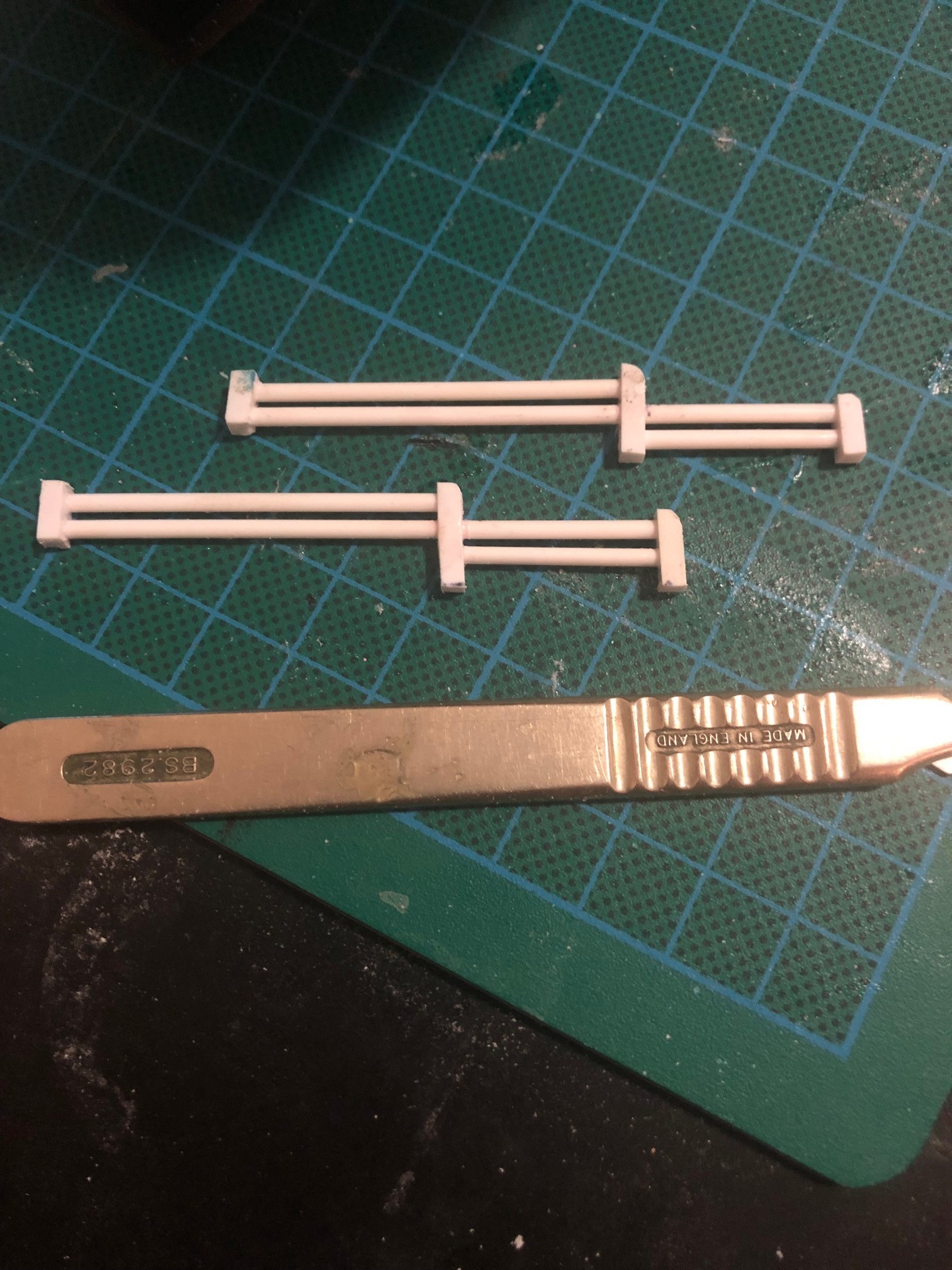

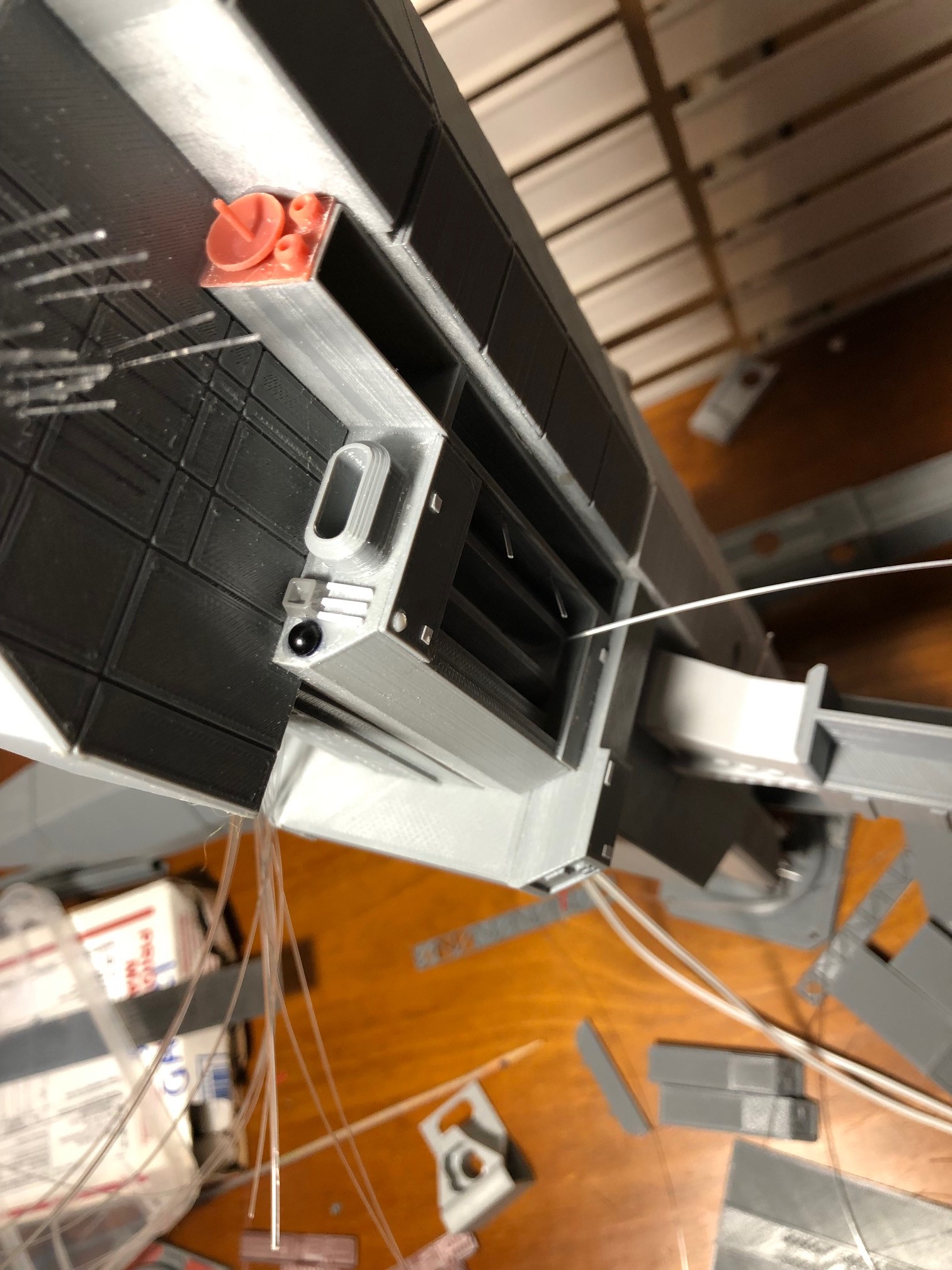

Made two antennas on the weekend for the two ships I am making. I used the Master Tools brass tube set No.6 , I then added a 0.5mm fiber optic strand down the center to give the little white dot to the end of it.
The set has enough brass to make 2 and have lots left over for the next model.
I will take another photo with a ruler against it so you can see the size and positioning of the smaller tubes.

View attachment 1036461View attachment 1036462
[/QUOTE
Here is the aerial with the ruler next to for size. Plus I have now added the 0.5mm fiber optic strand for light on the end.

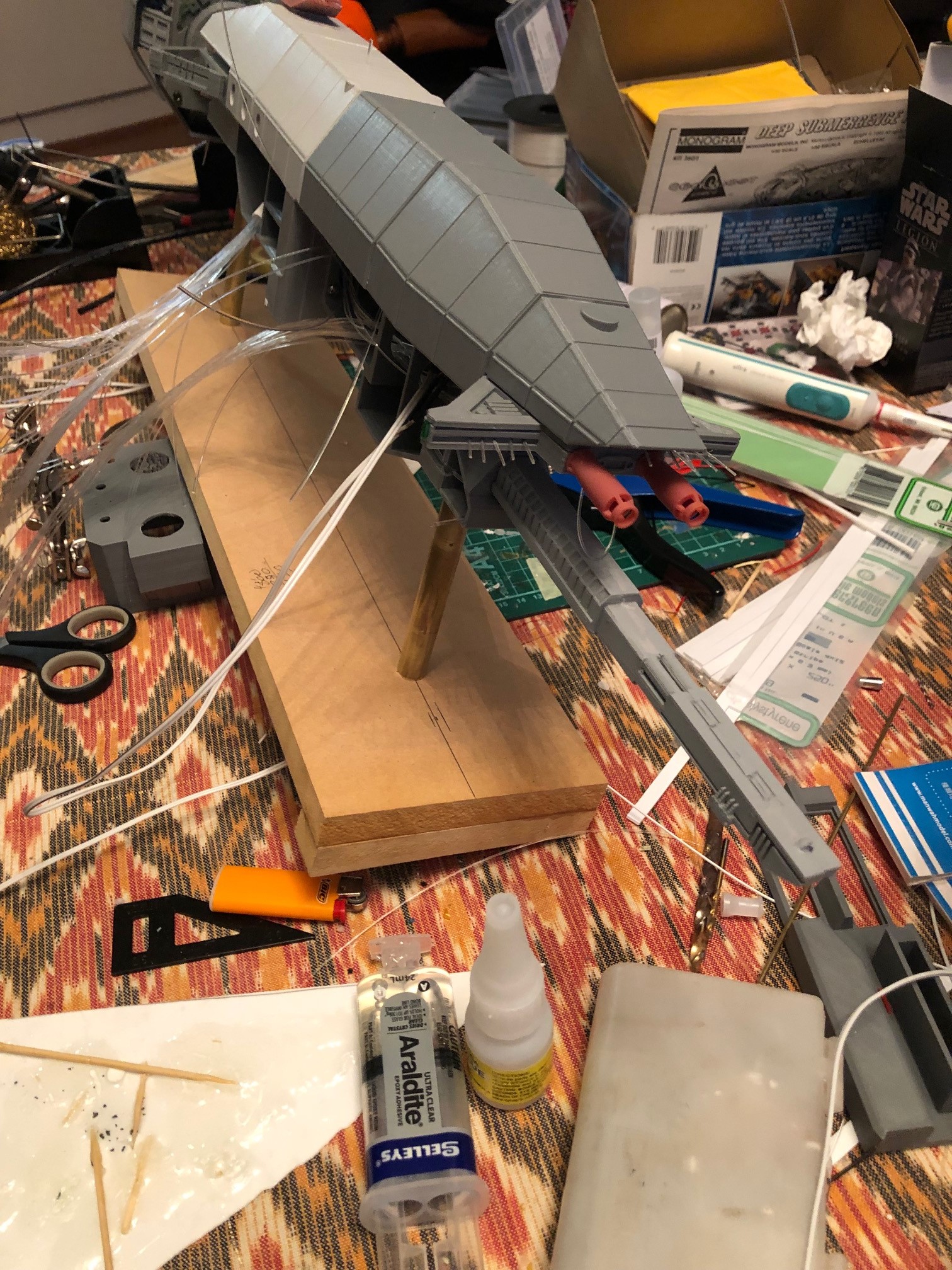

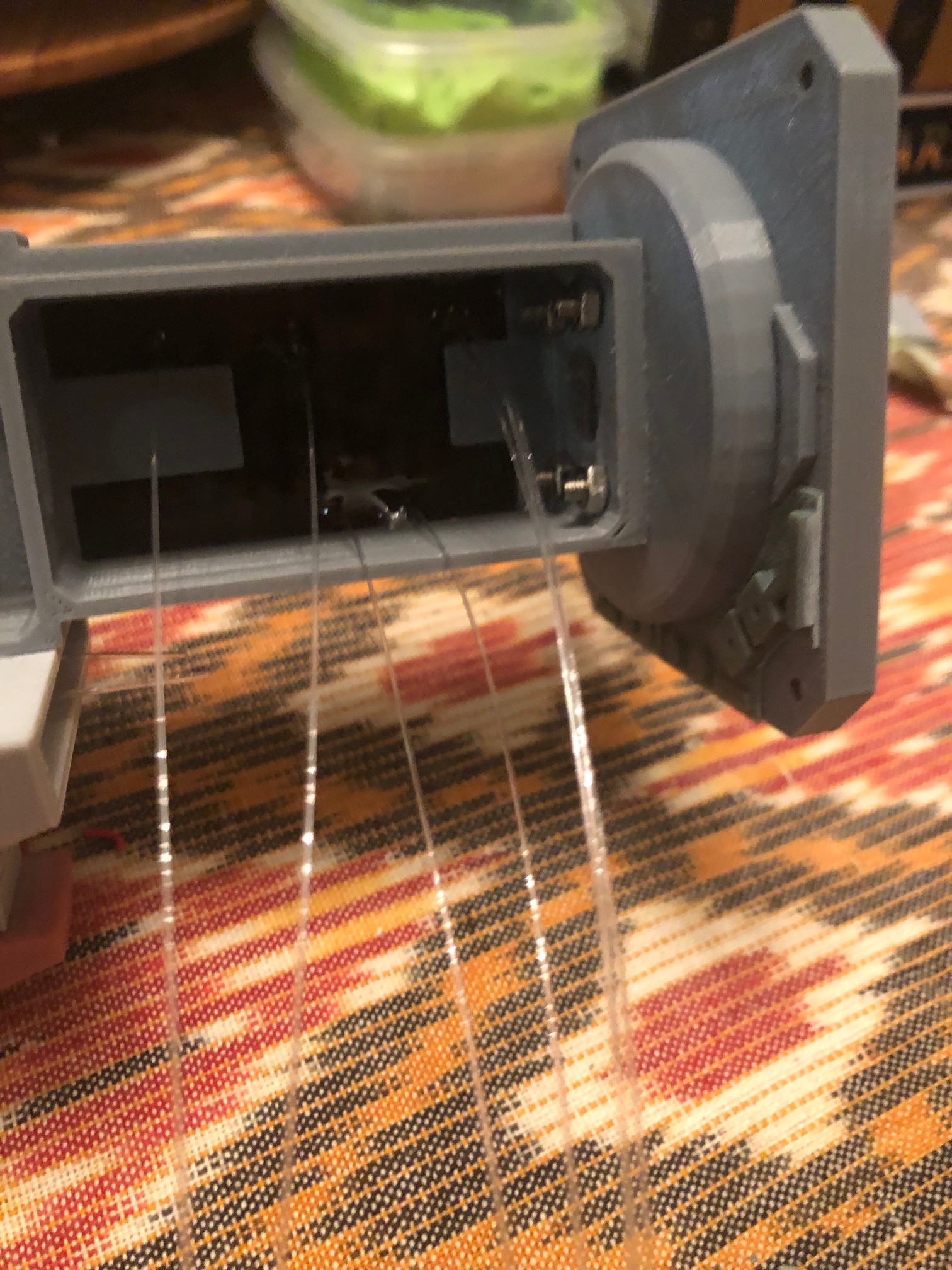

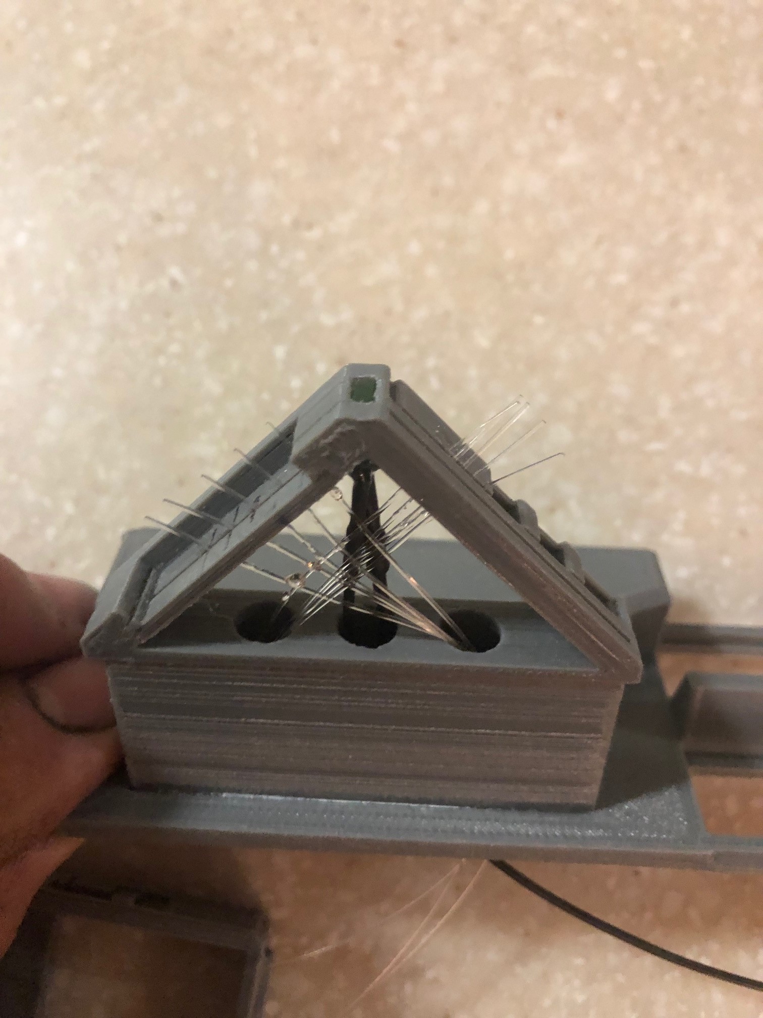

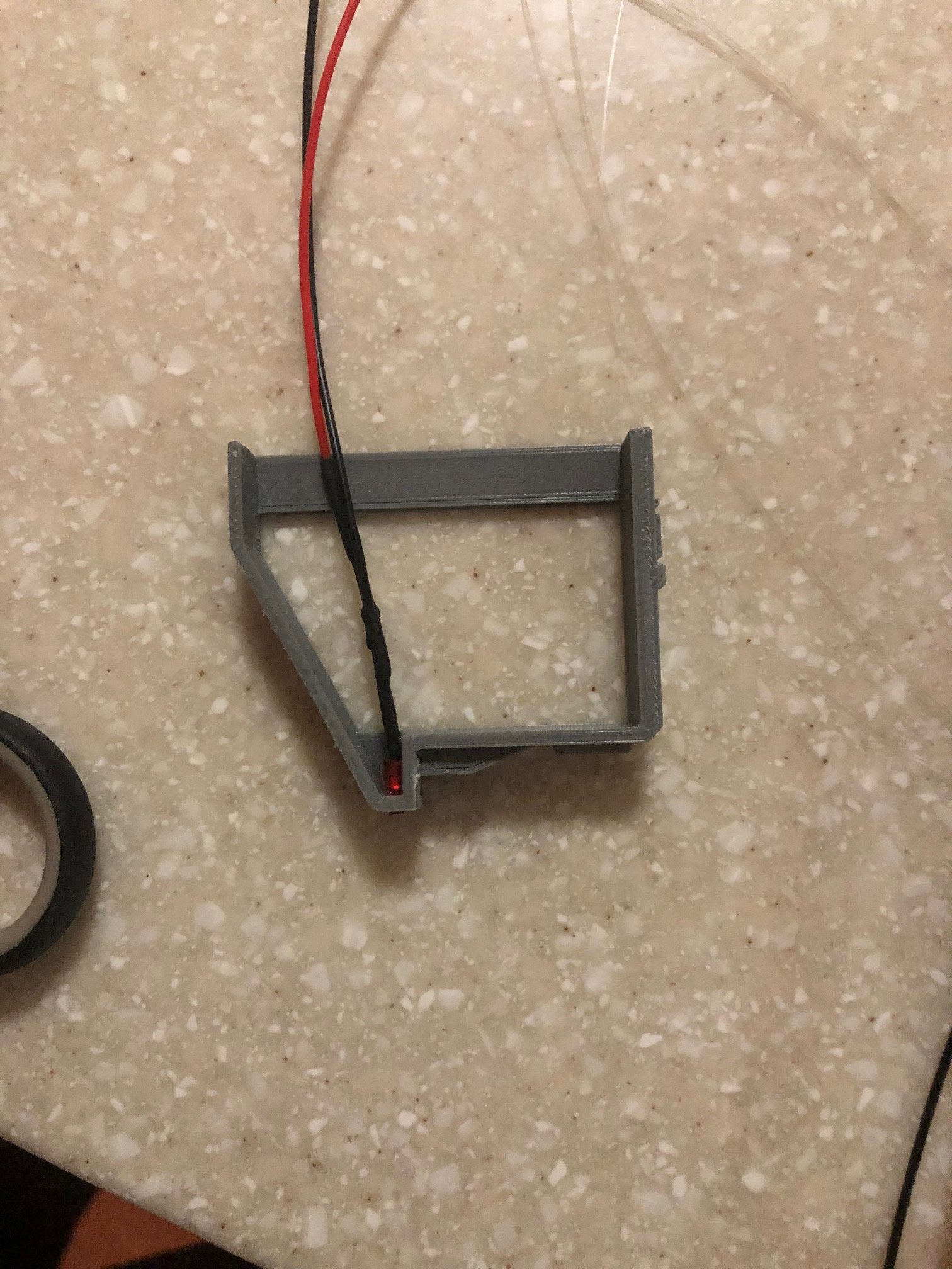

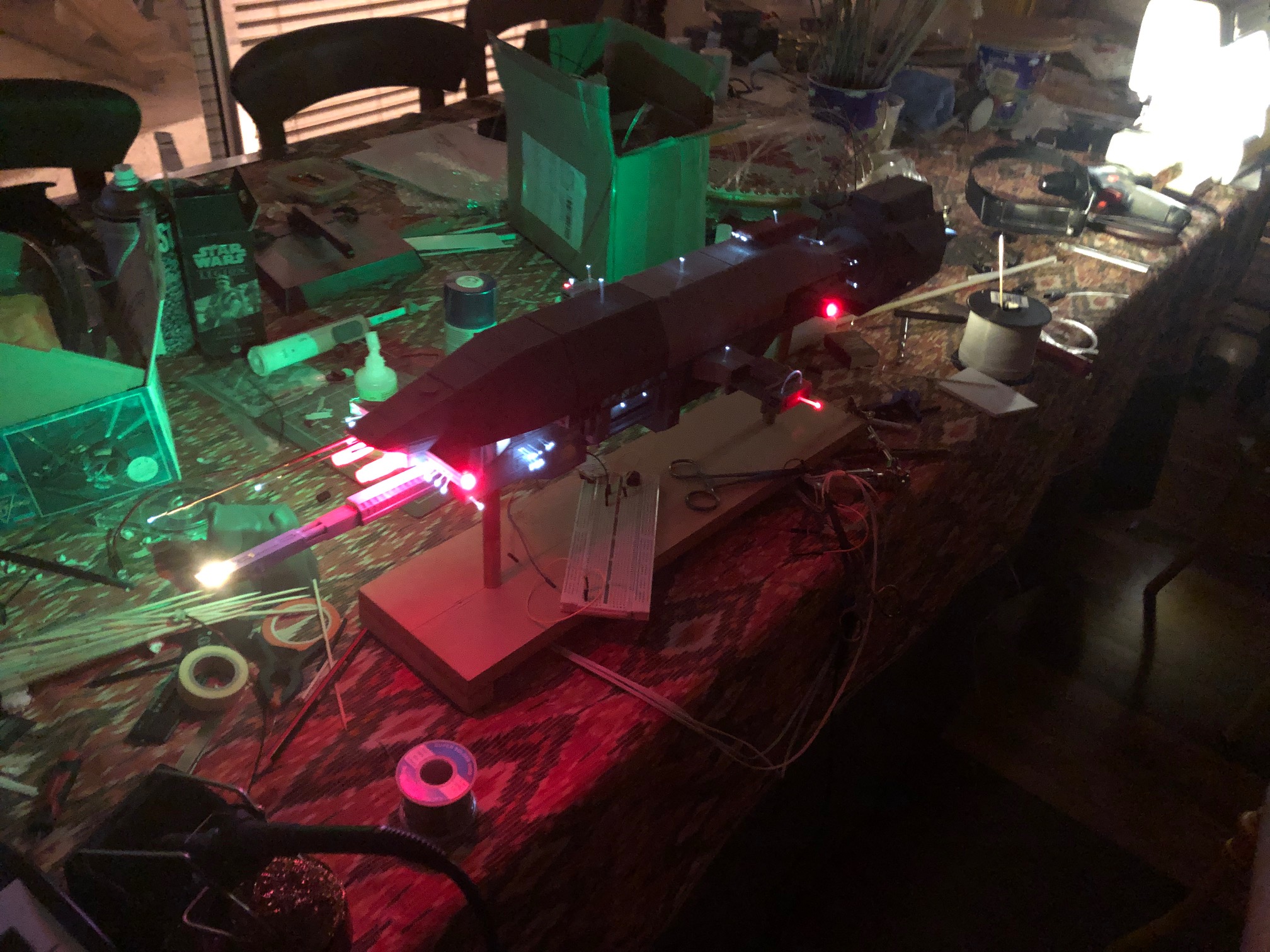

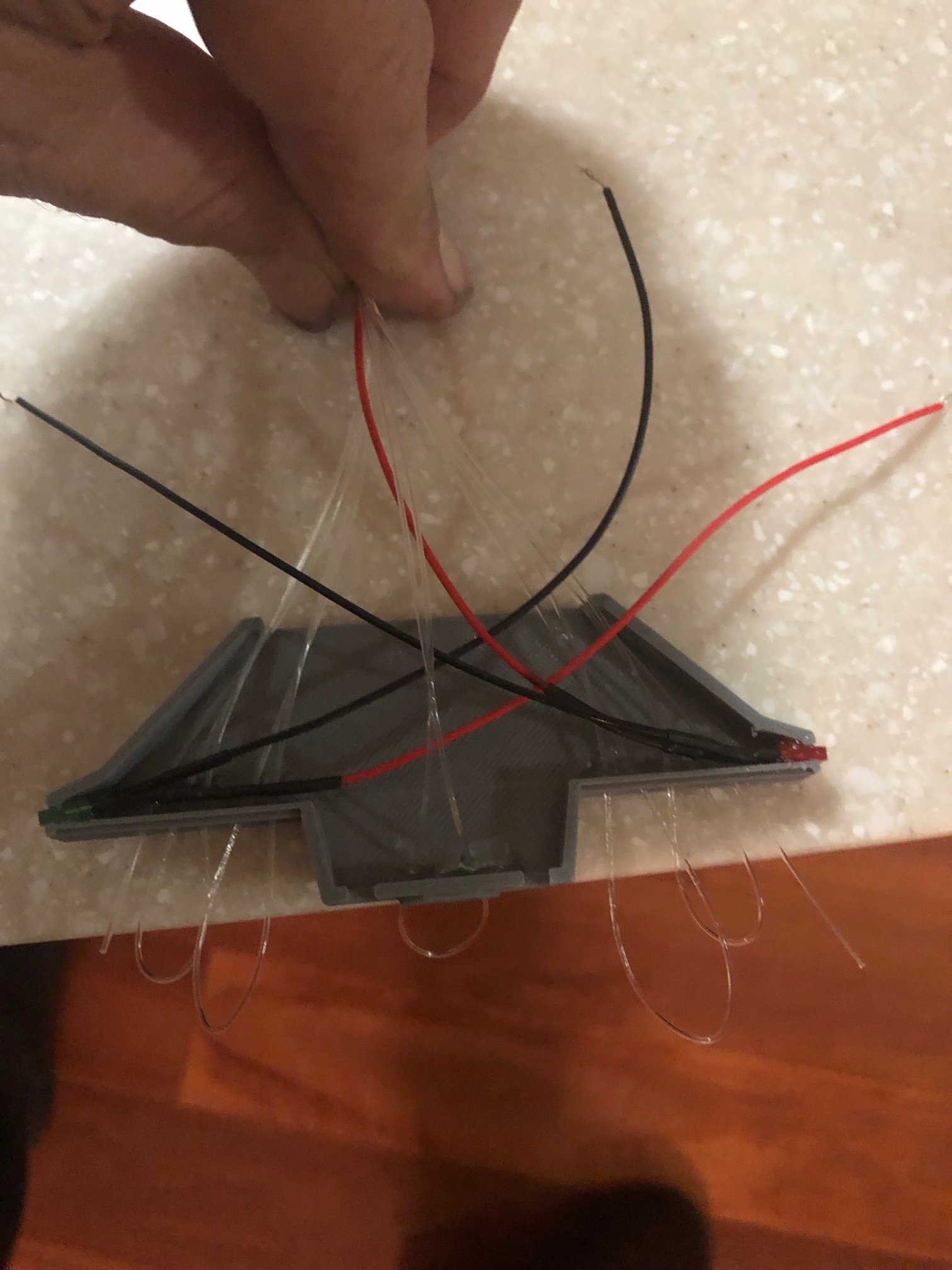

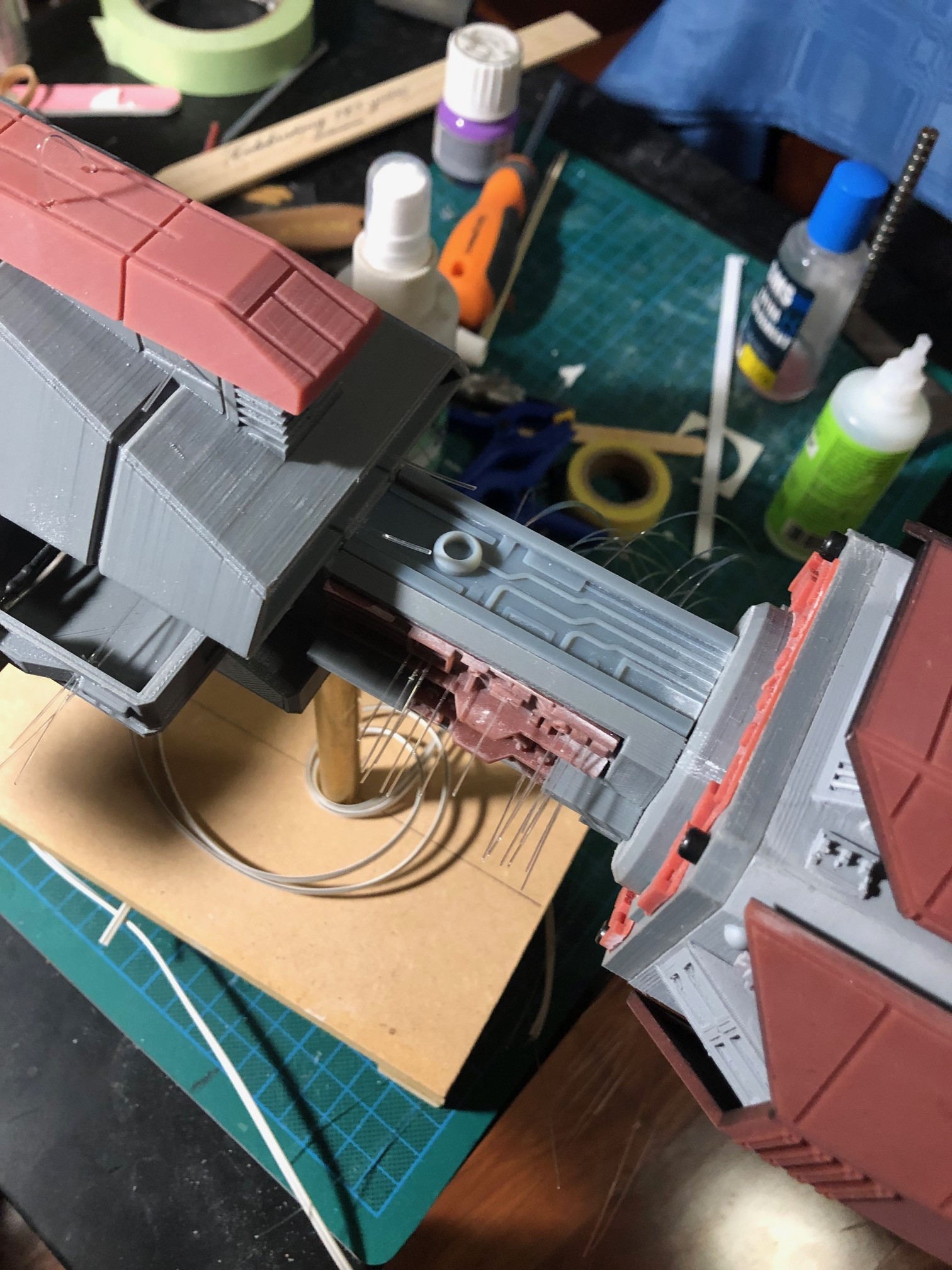

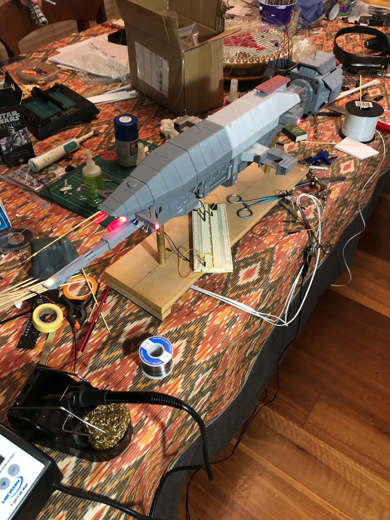

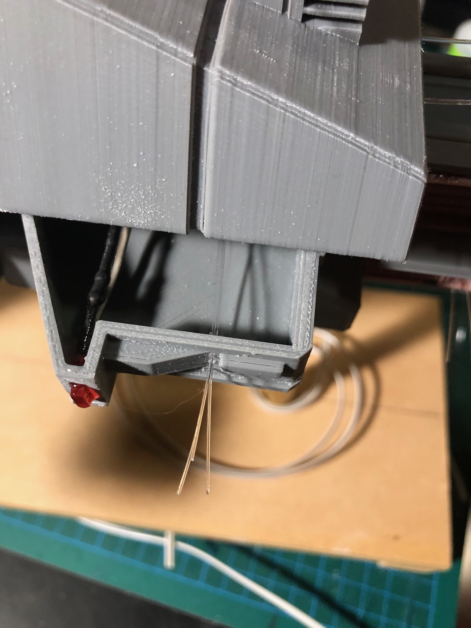

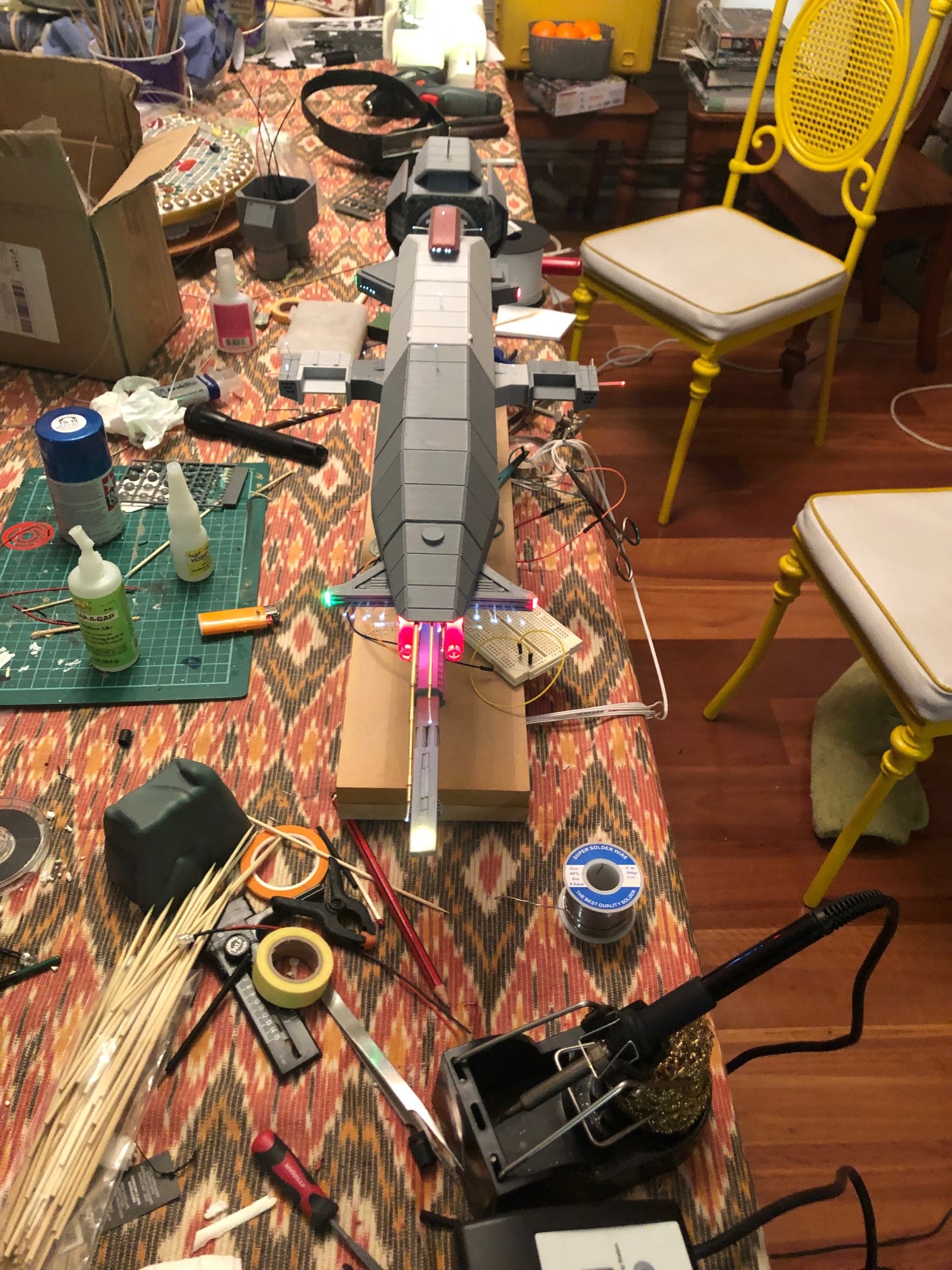

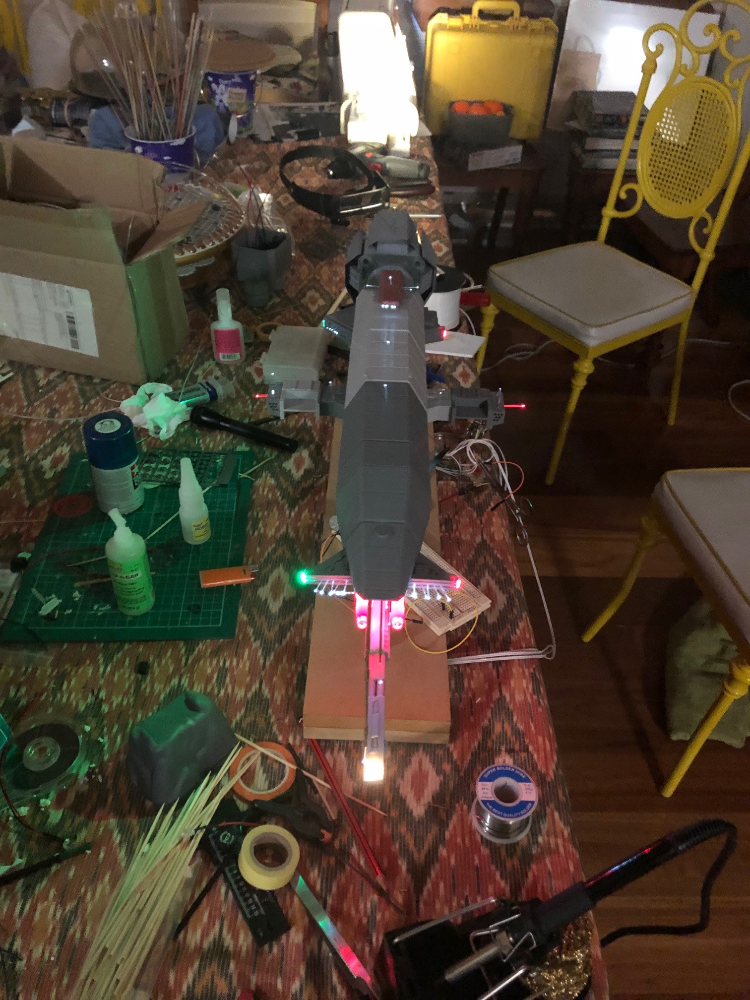

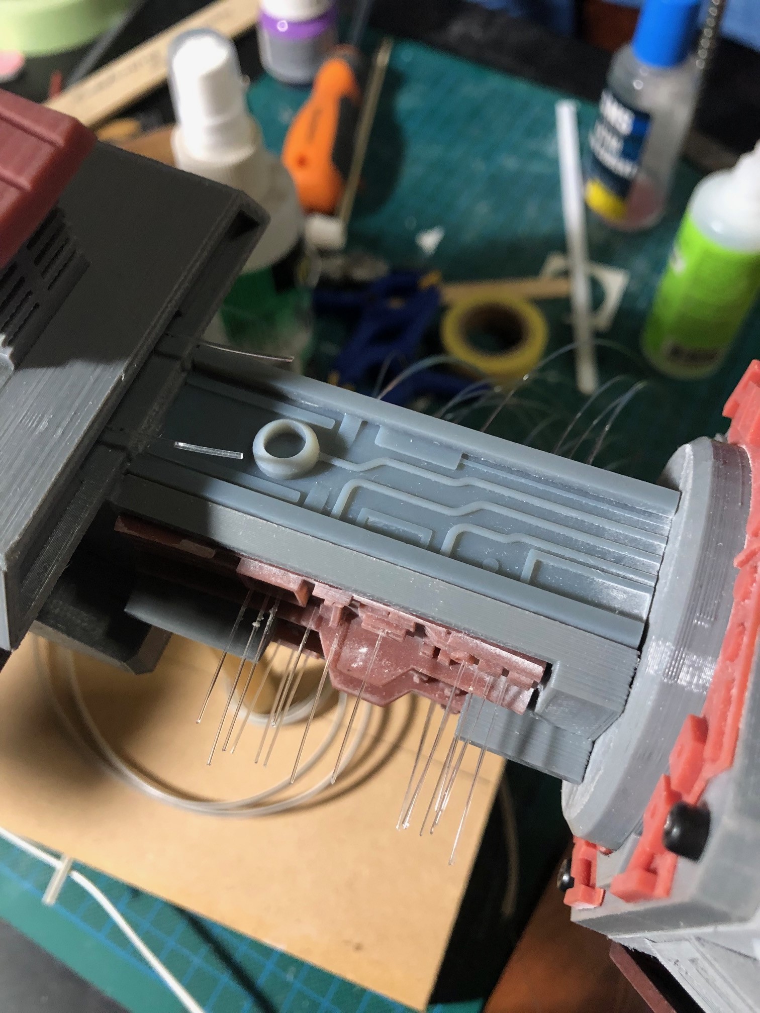

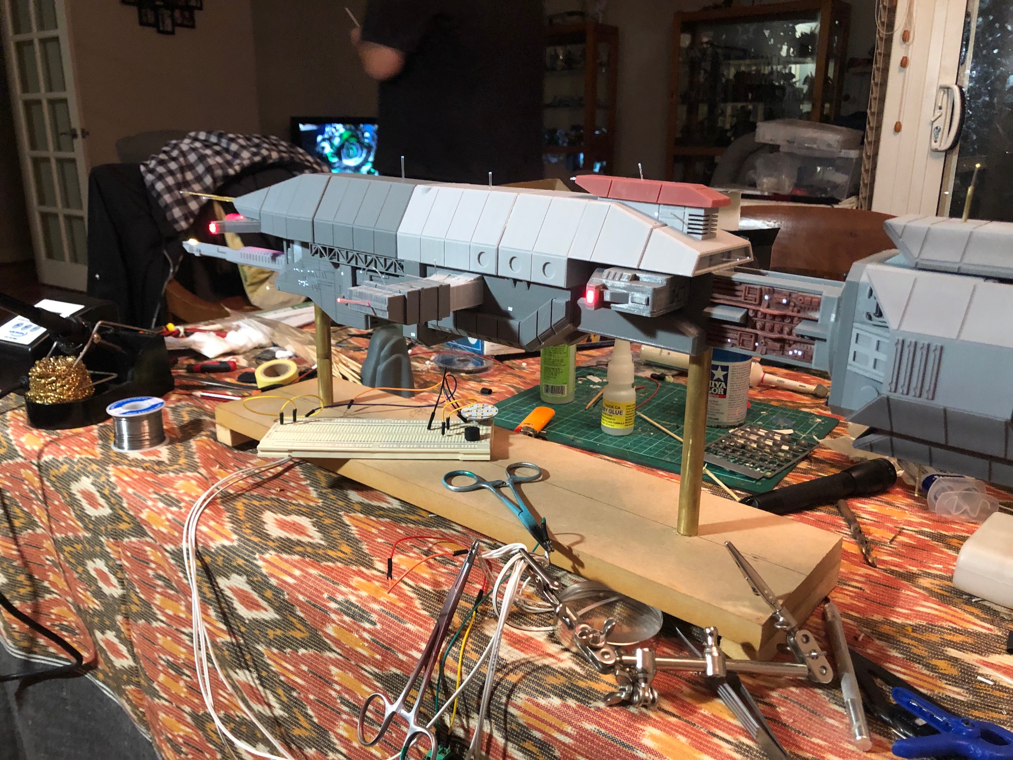

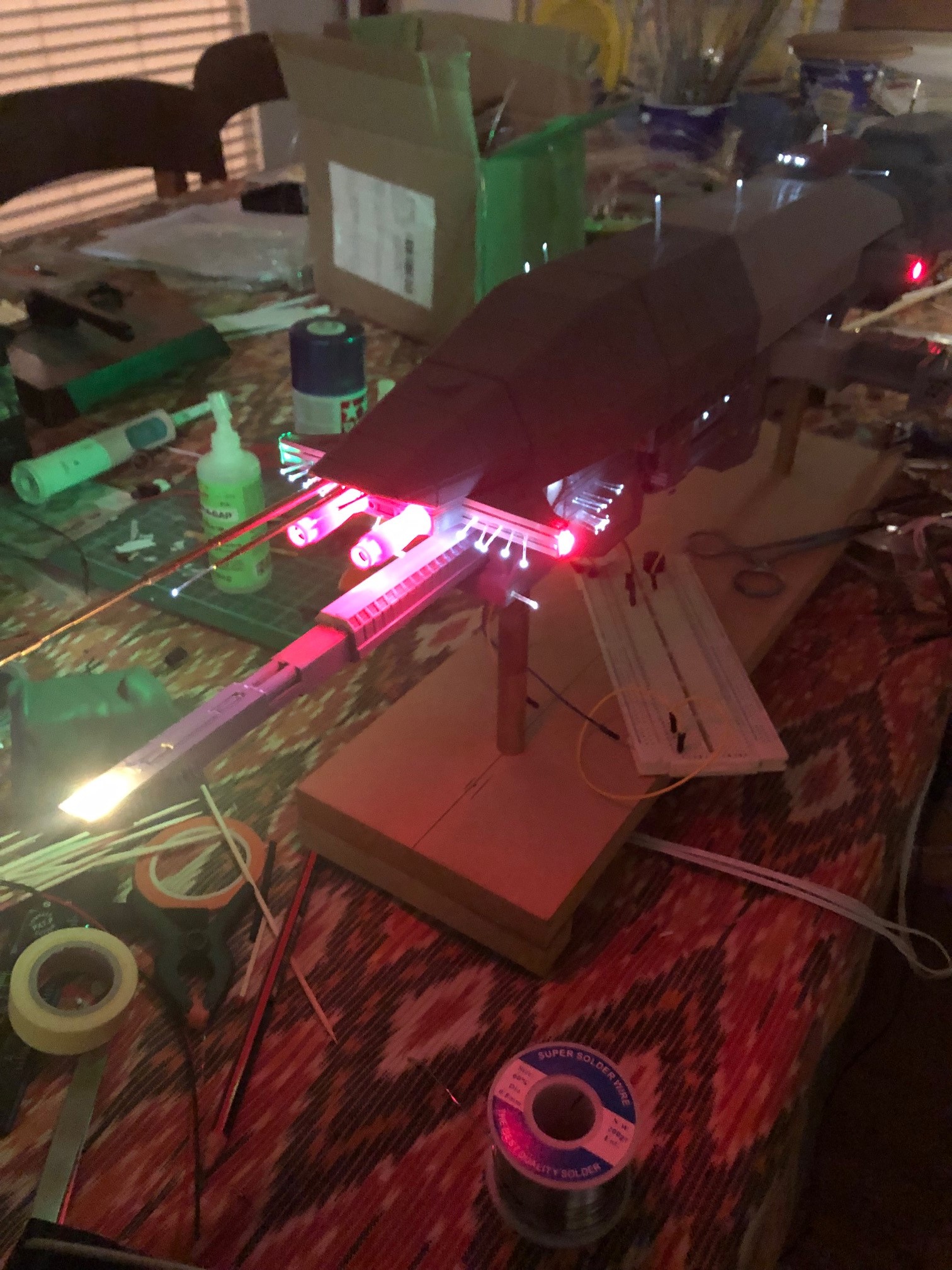

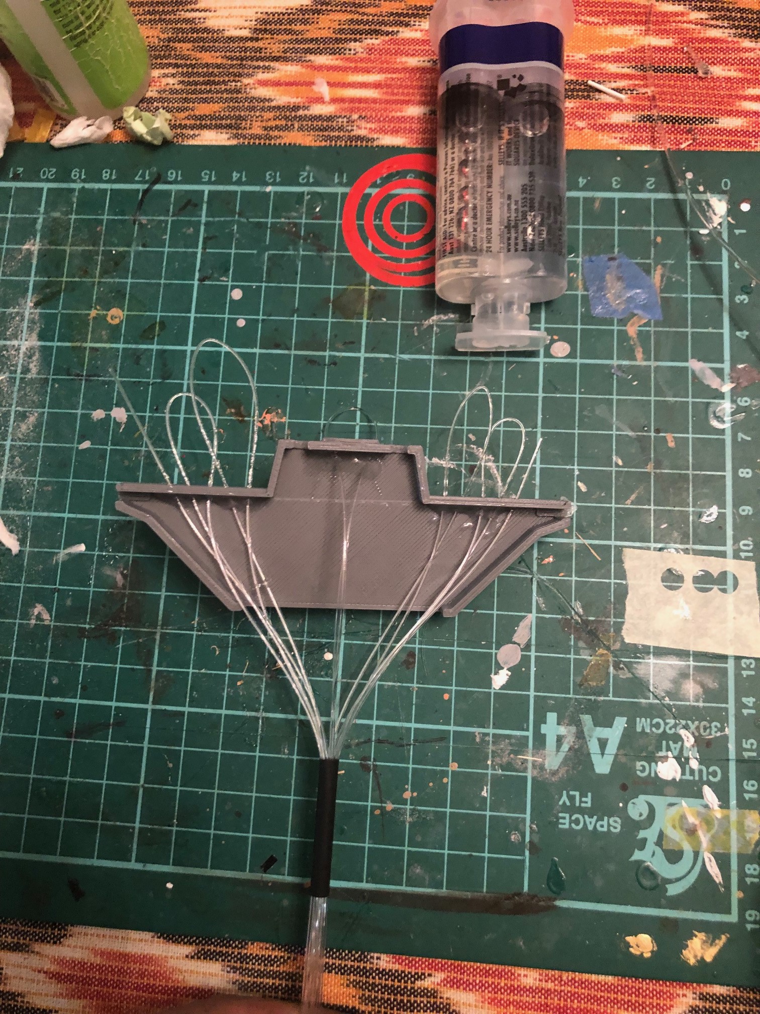

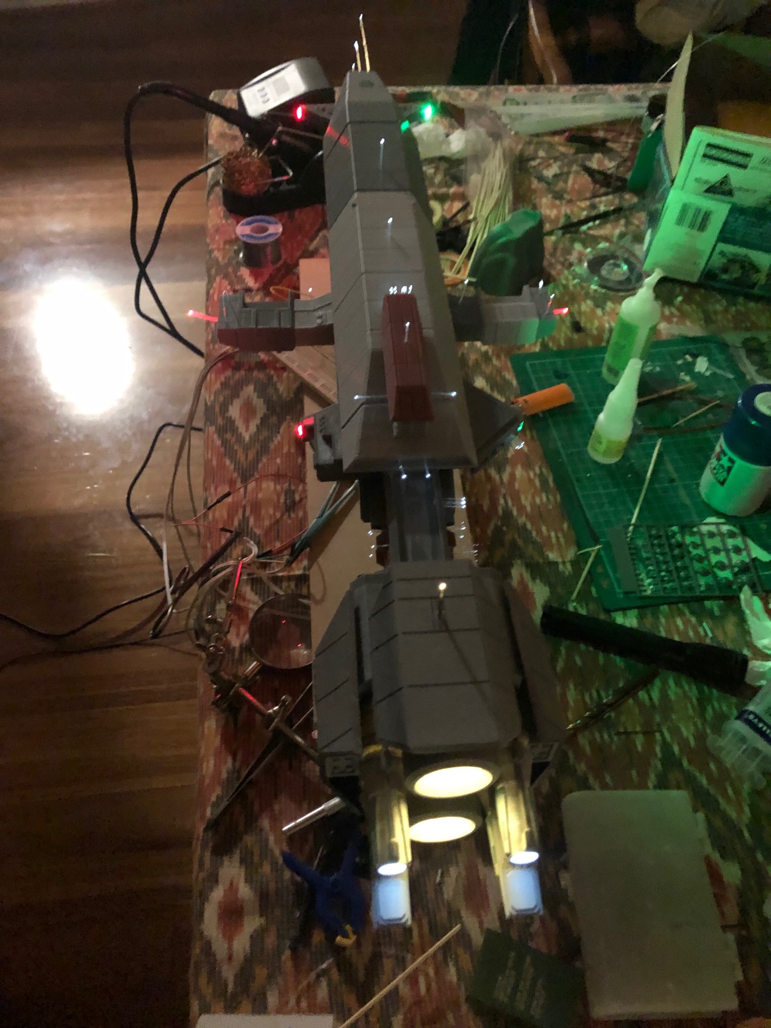

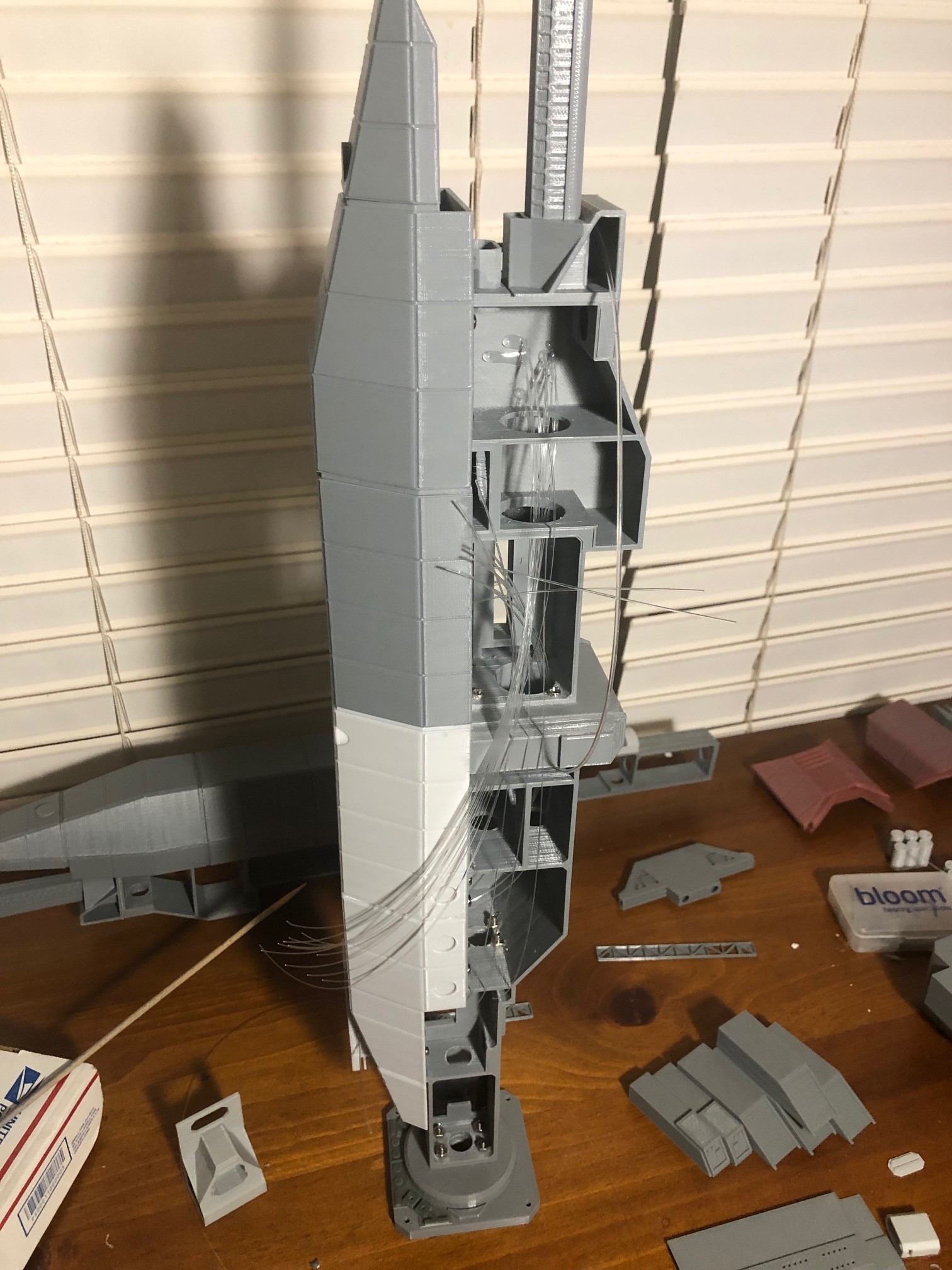

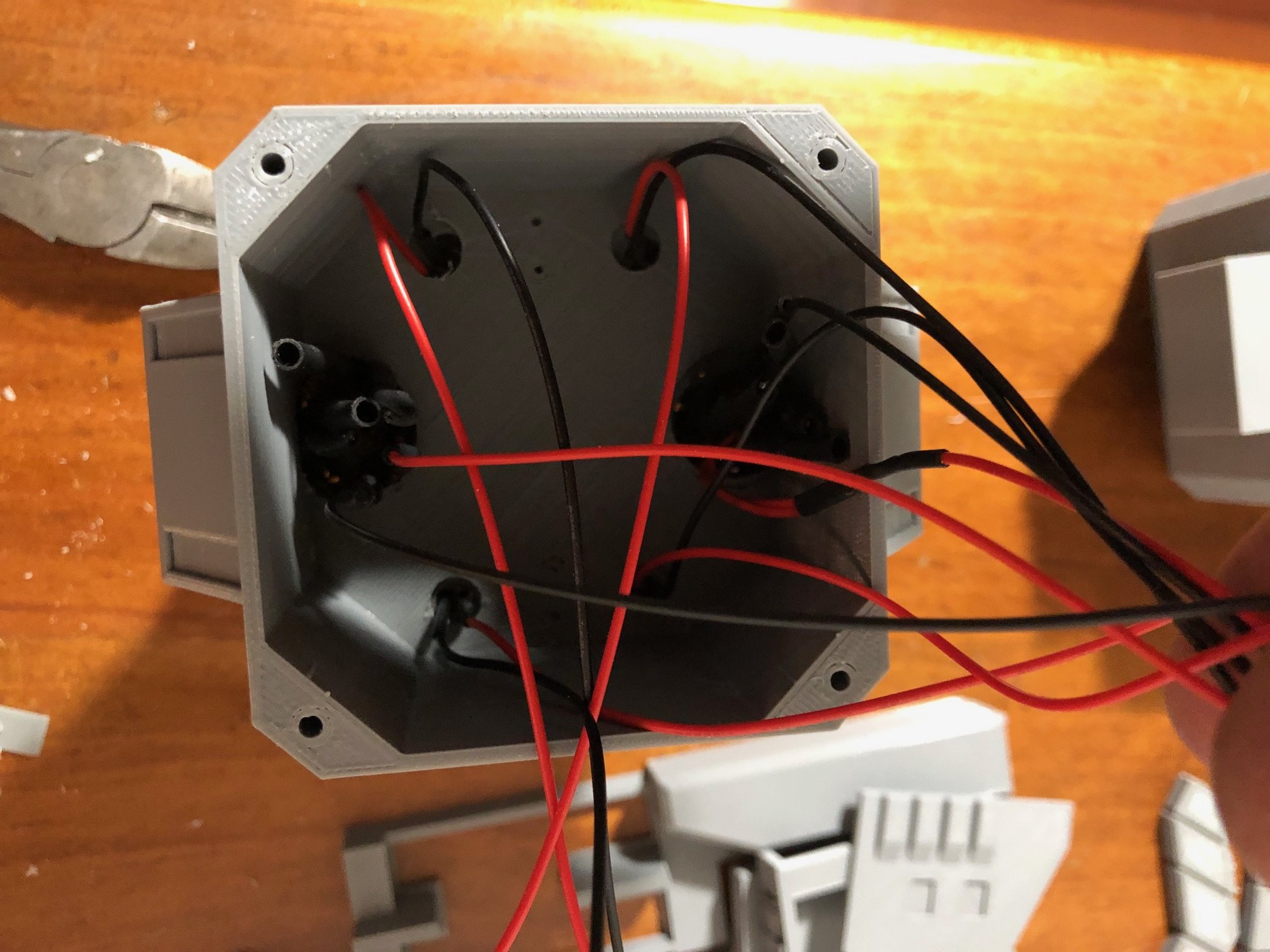

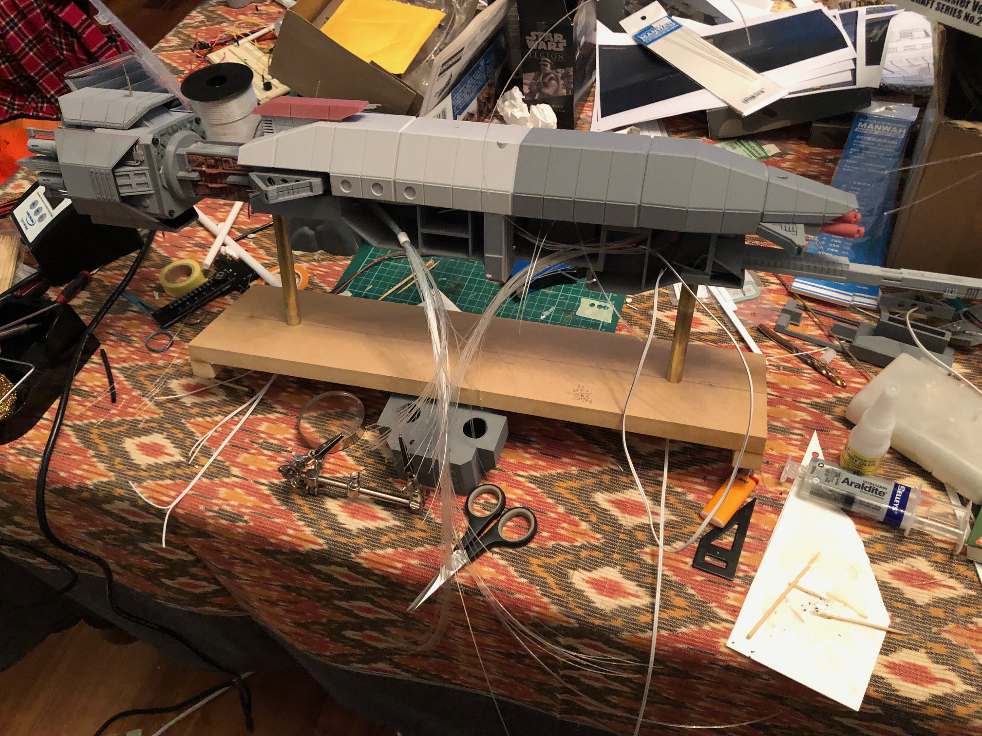

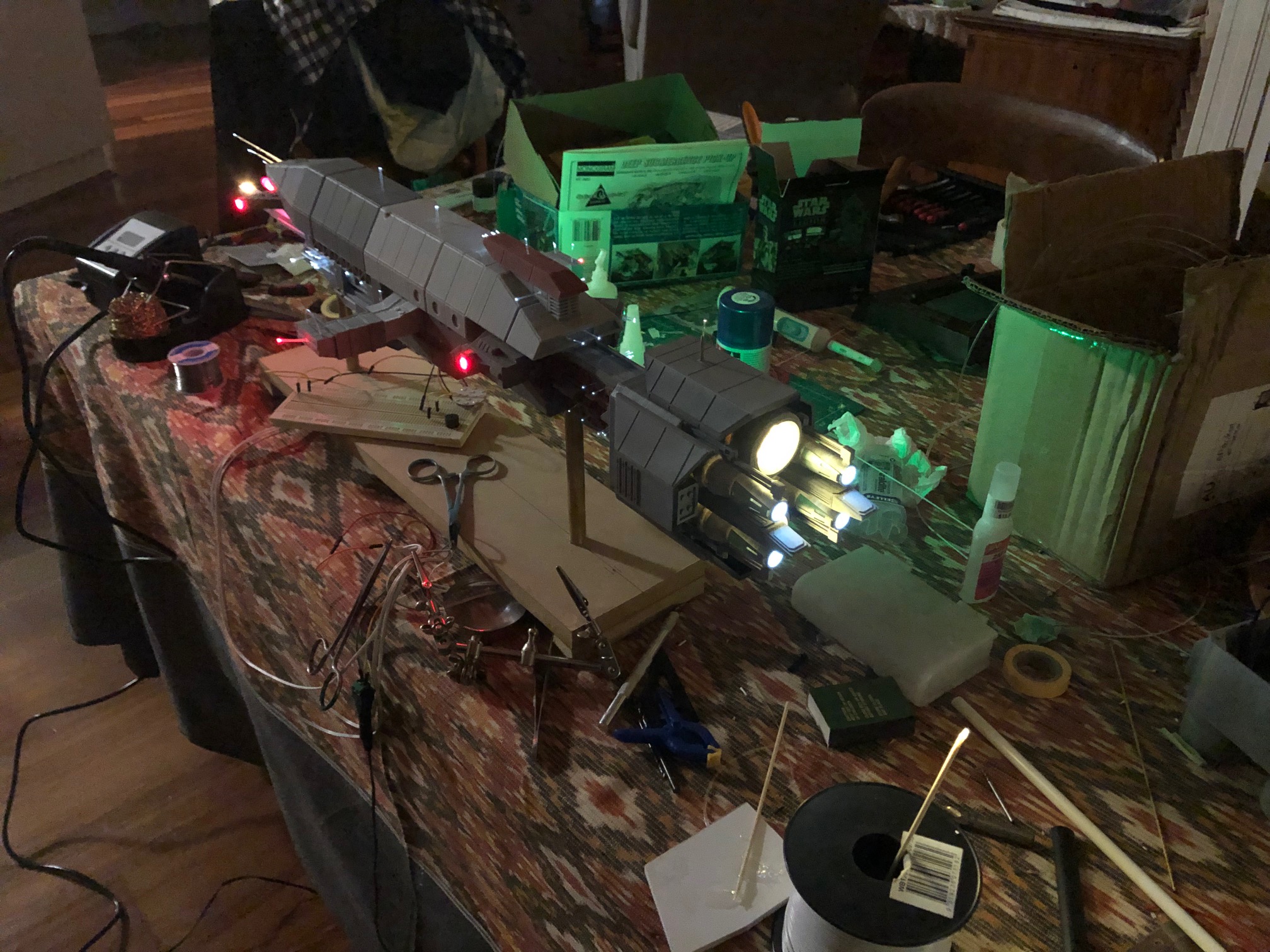

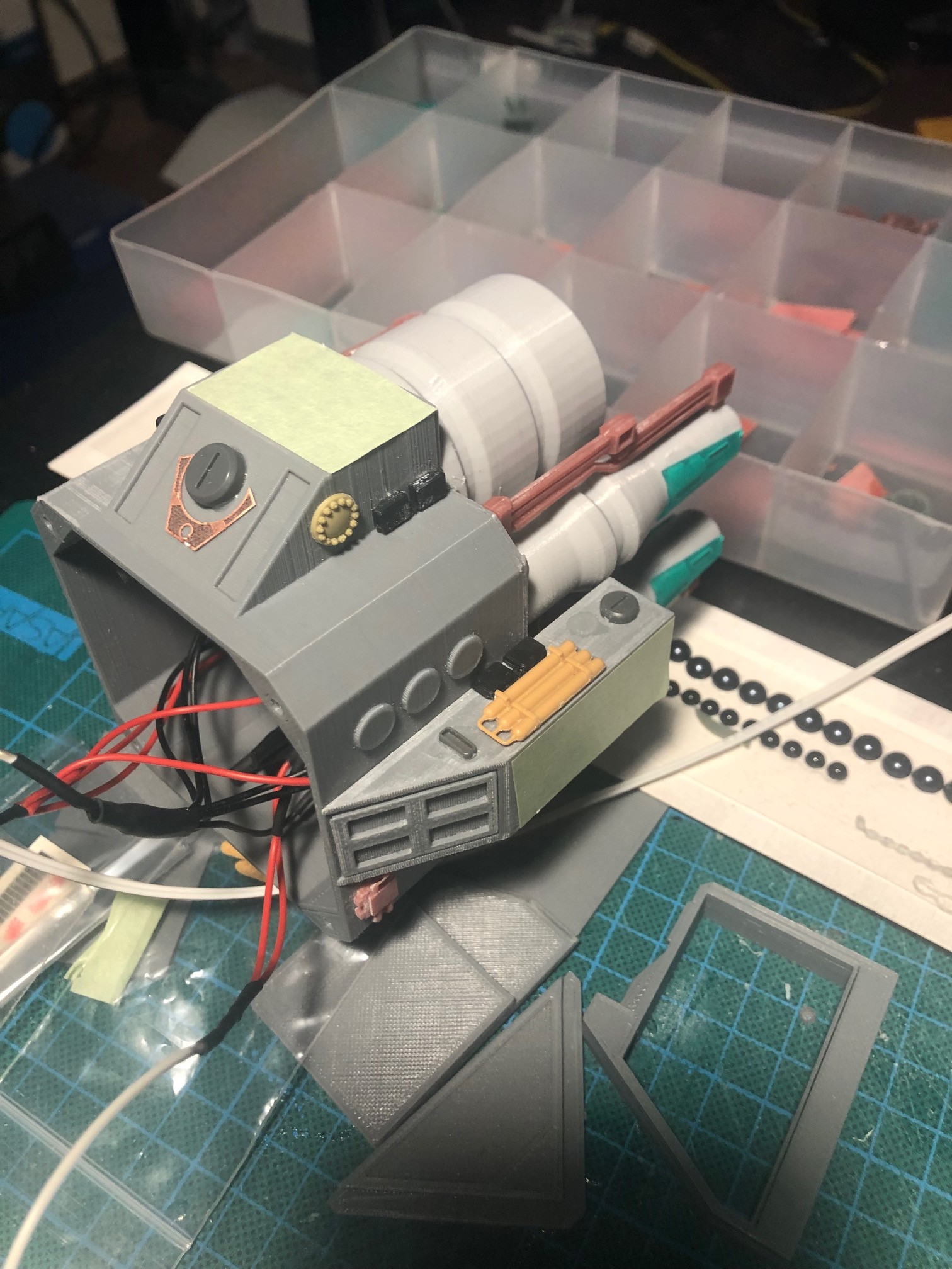

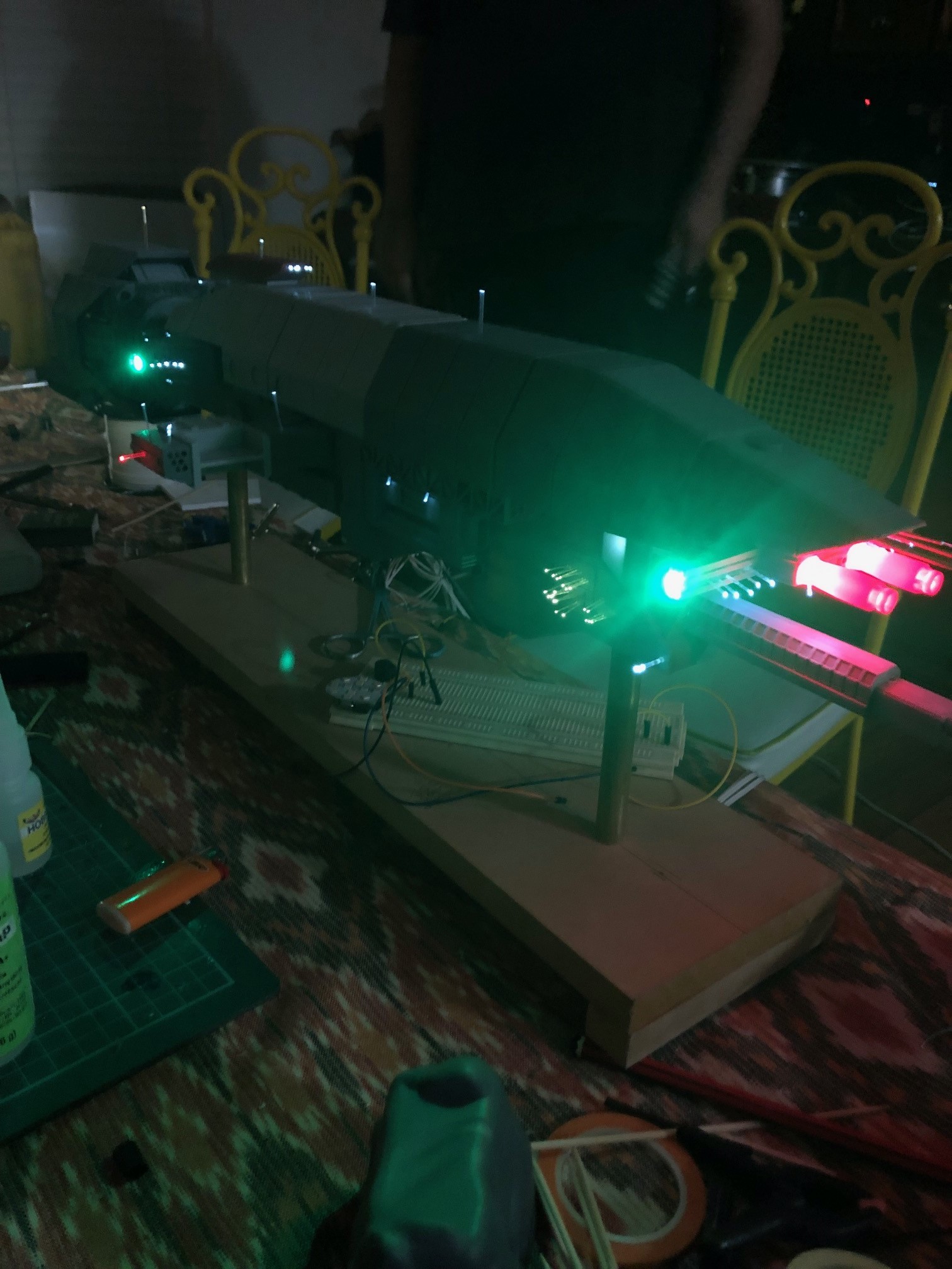

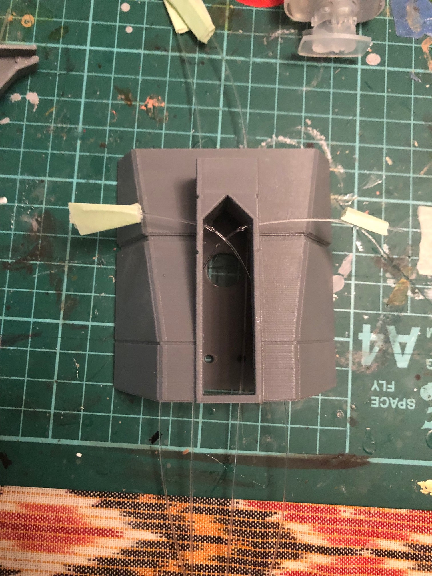

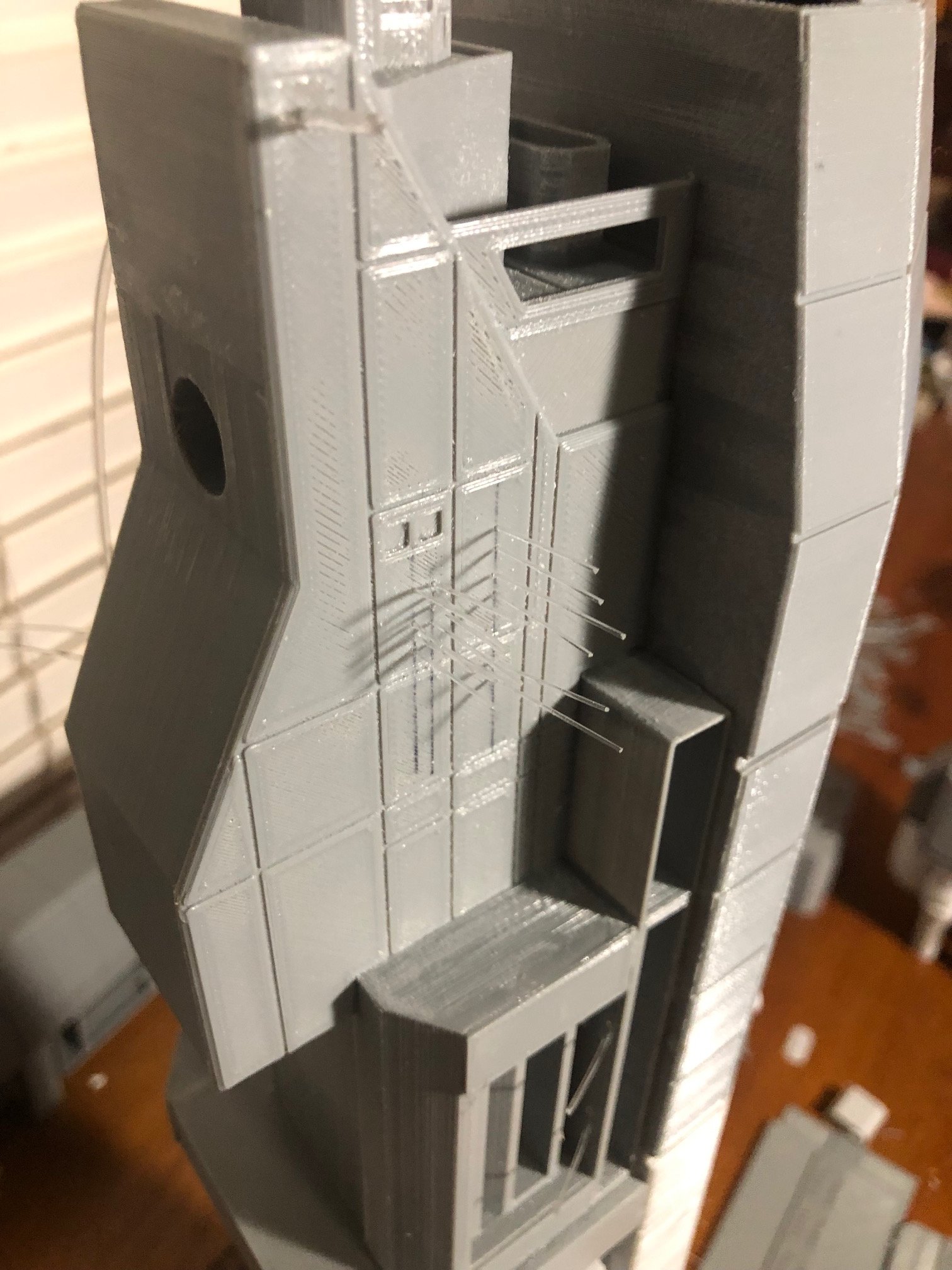

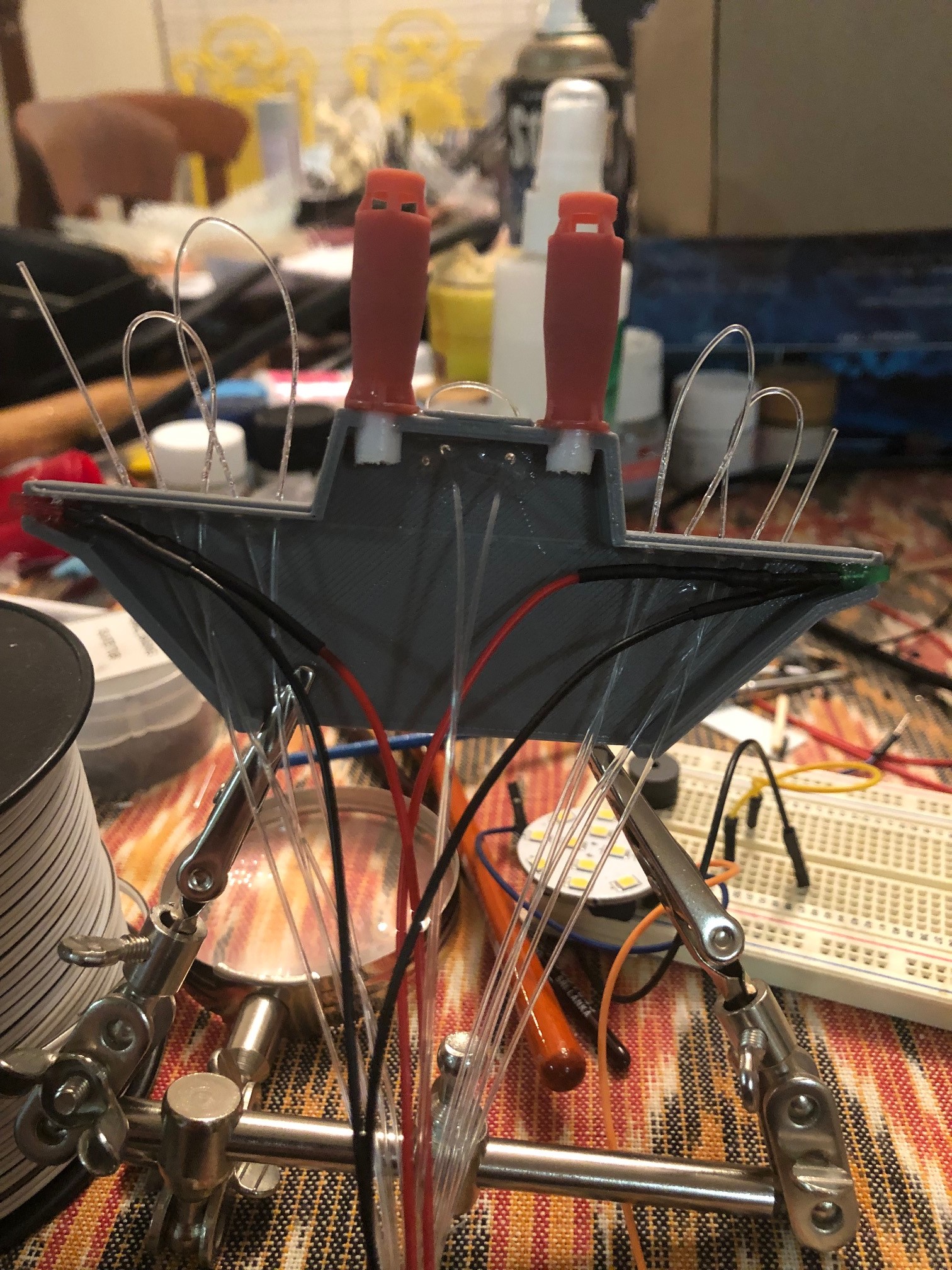

Fiber optic time. Now adding fiber optic strands to give the model points of lights like windows and navigational lights.
IMG_5362.jpgIMG_5363.jpgIMG_5364.jpgIMG_5371.jpgIMG_5373.jpgIMG_5374.jpgIMG_5375.jpgIMG_5376.jpgIMG_5377.jpgIMG_5378.jpgIMG_5380.jpgIMG_5381.jpg
I used 0.5 0.75 and 1mm fibers.
Muzza

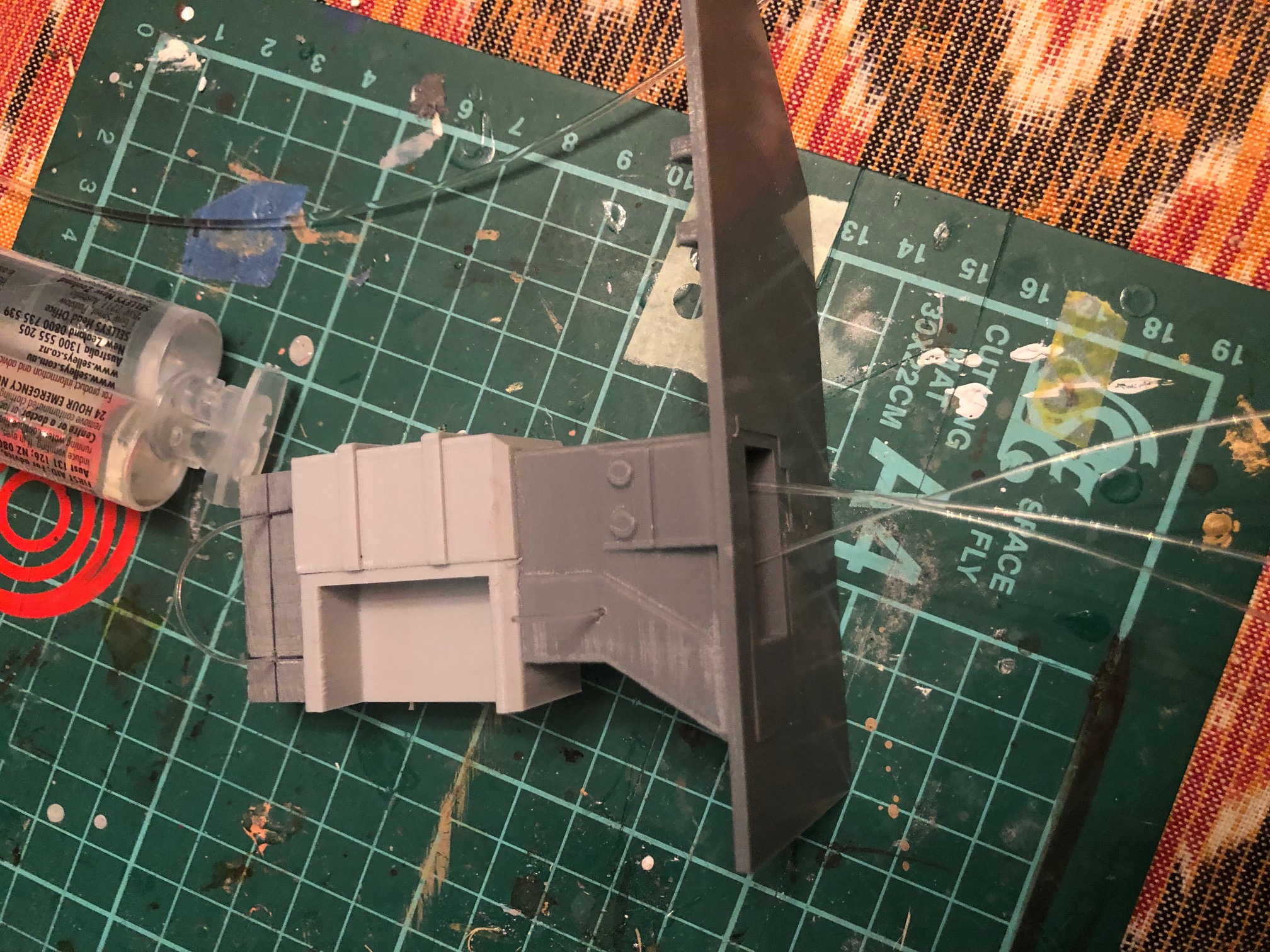

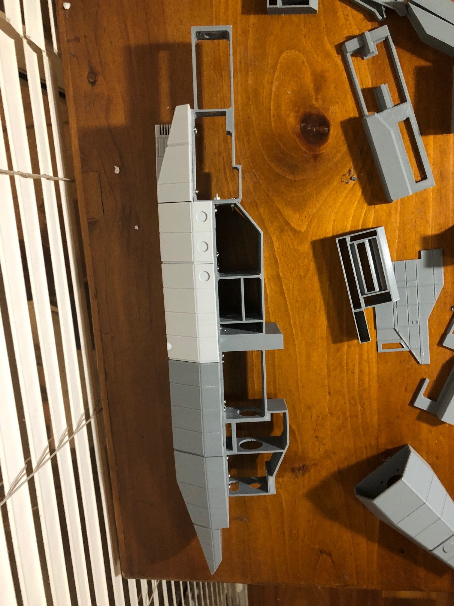

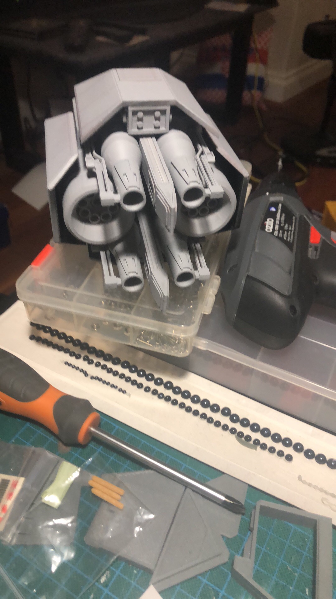

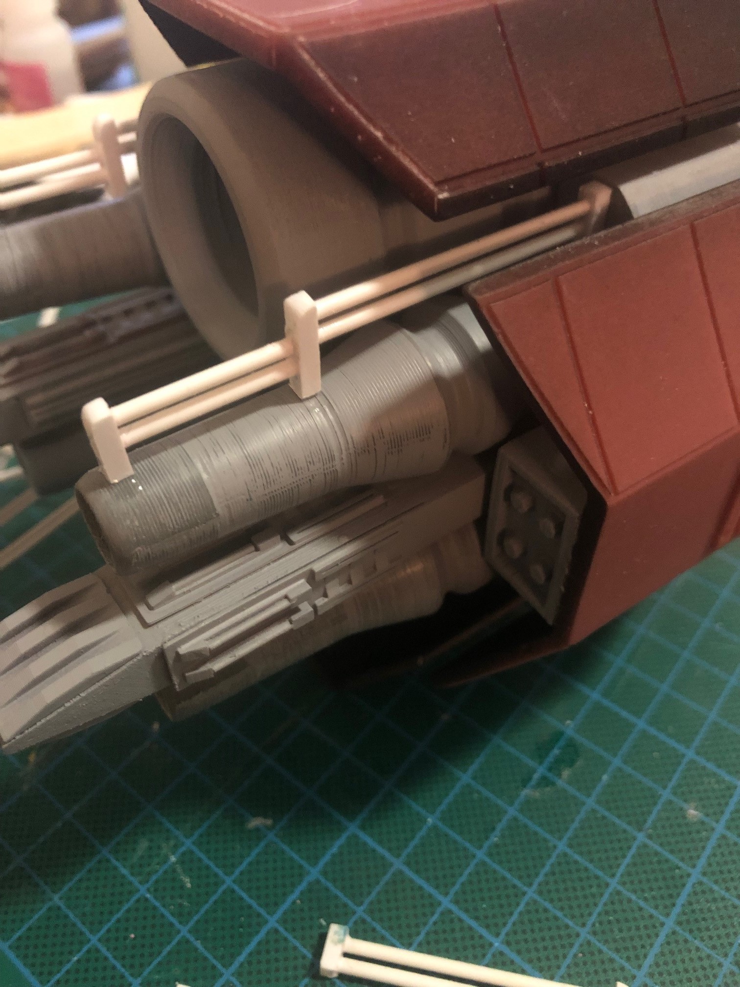

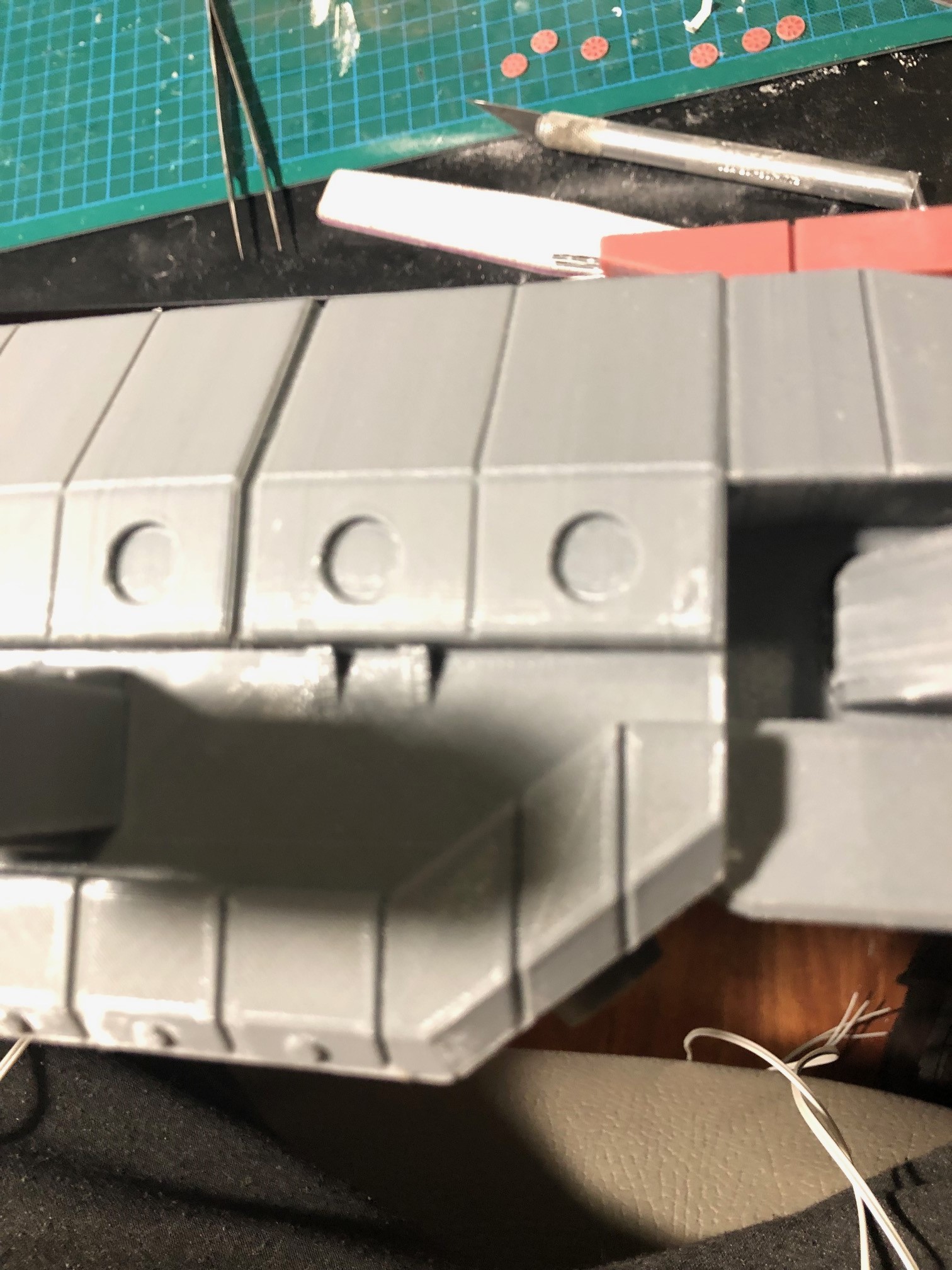

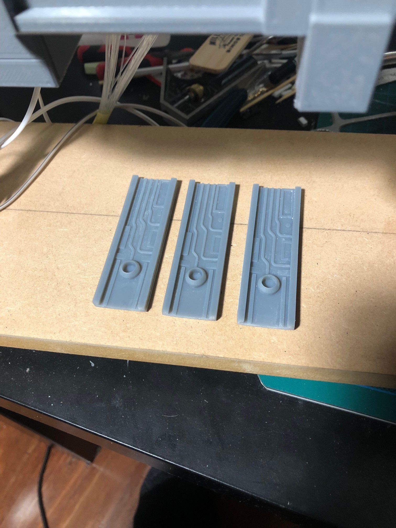

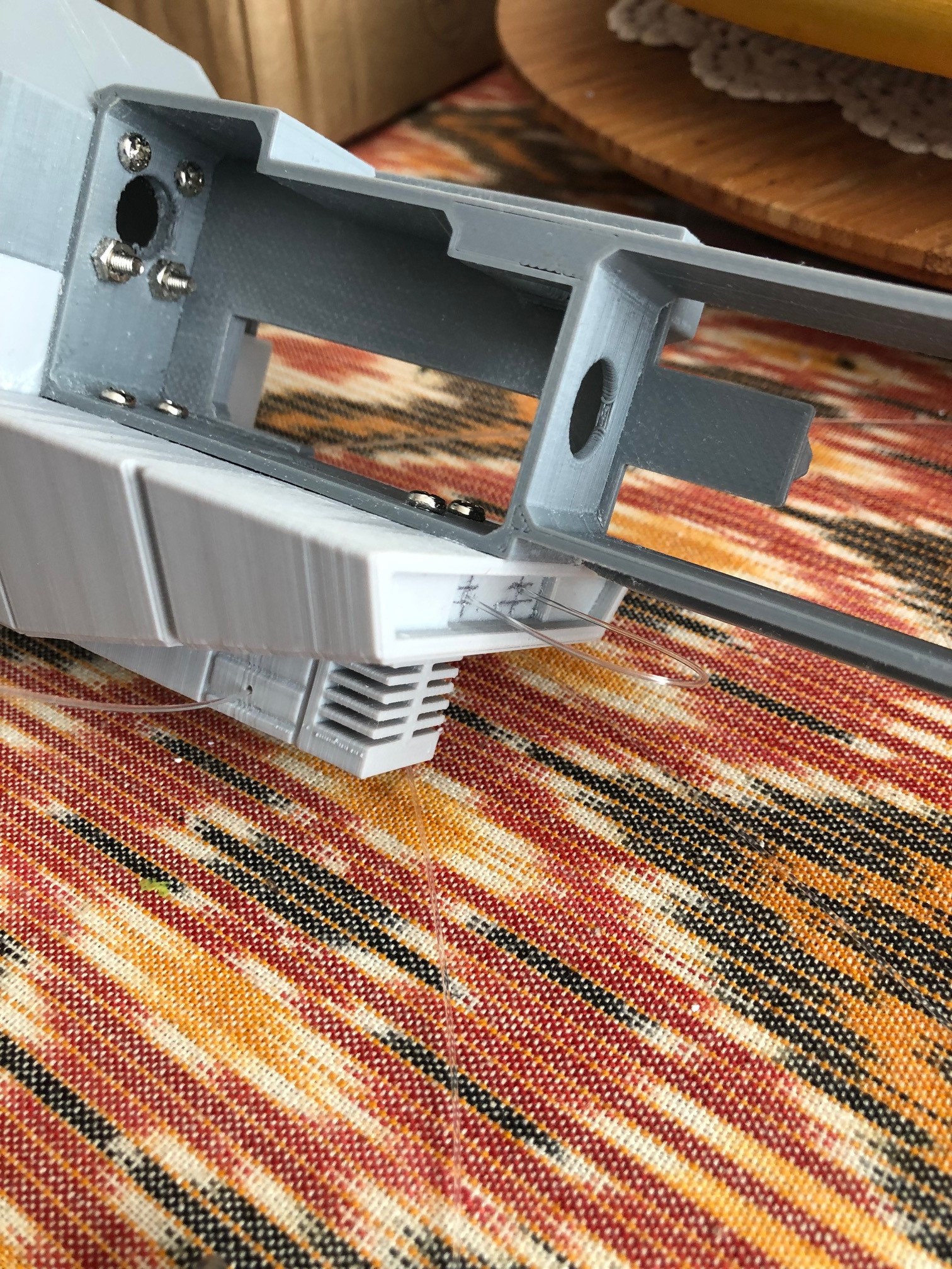

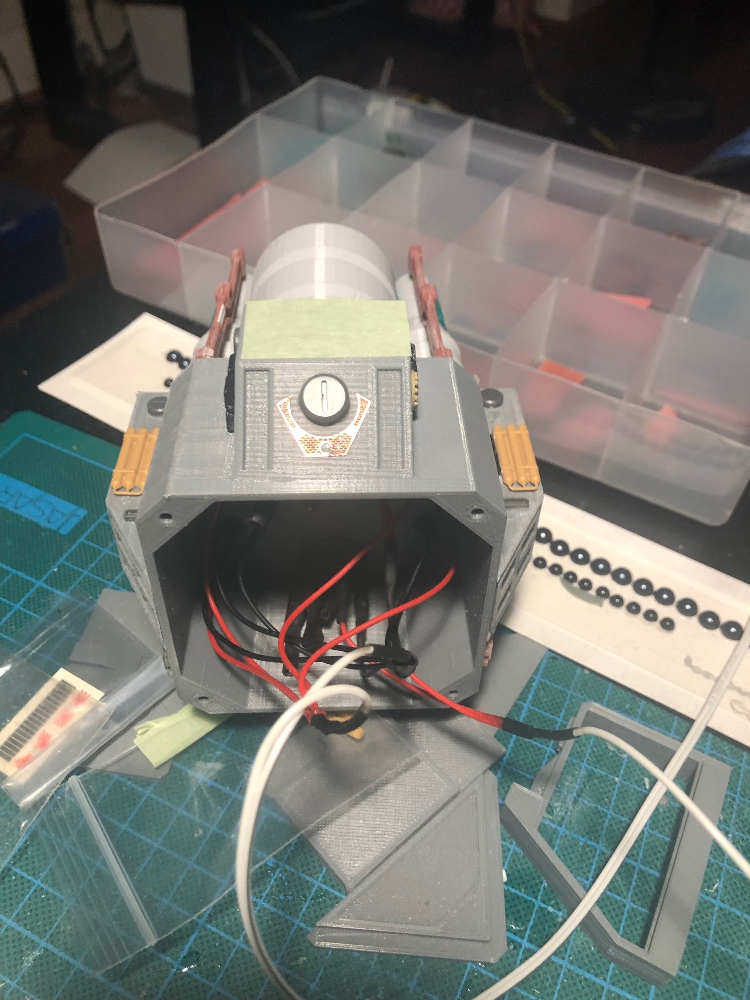

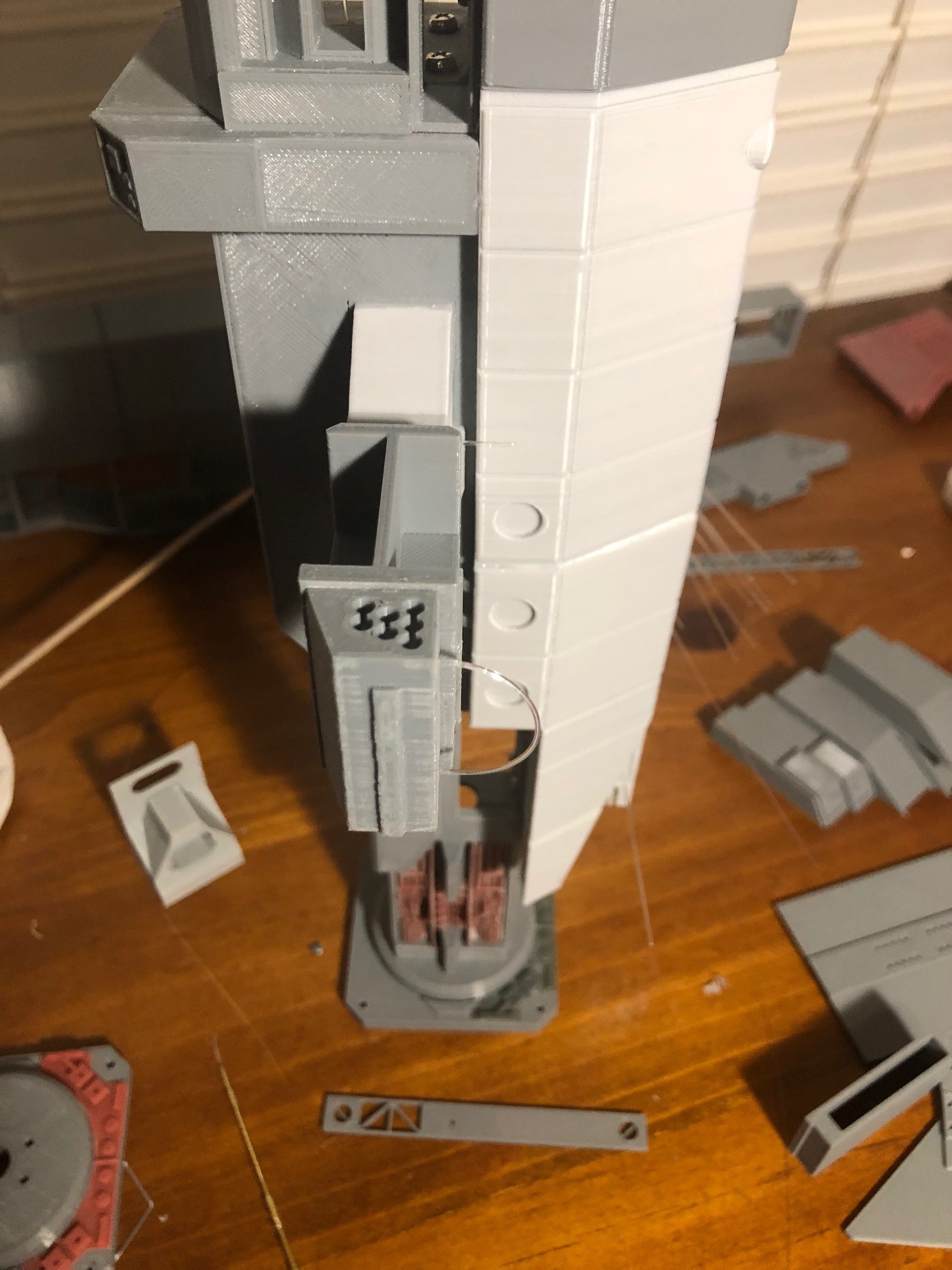

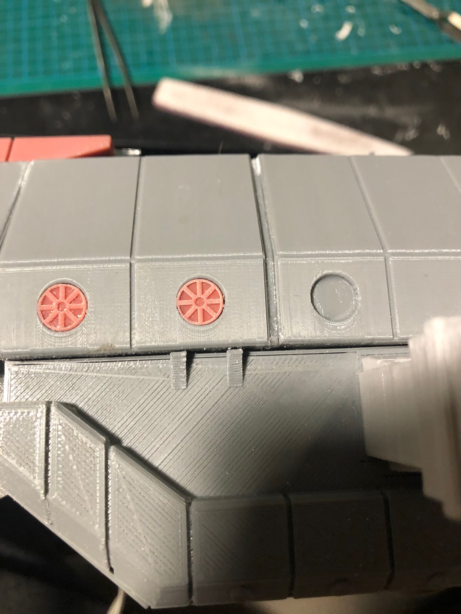

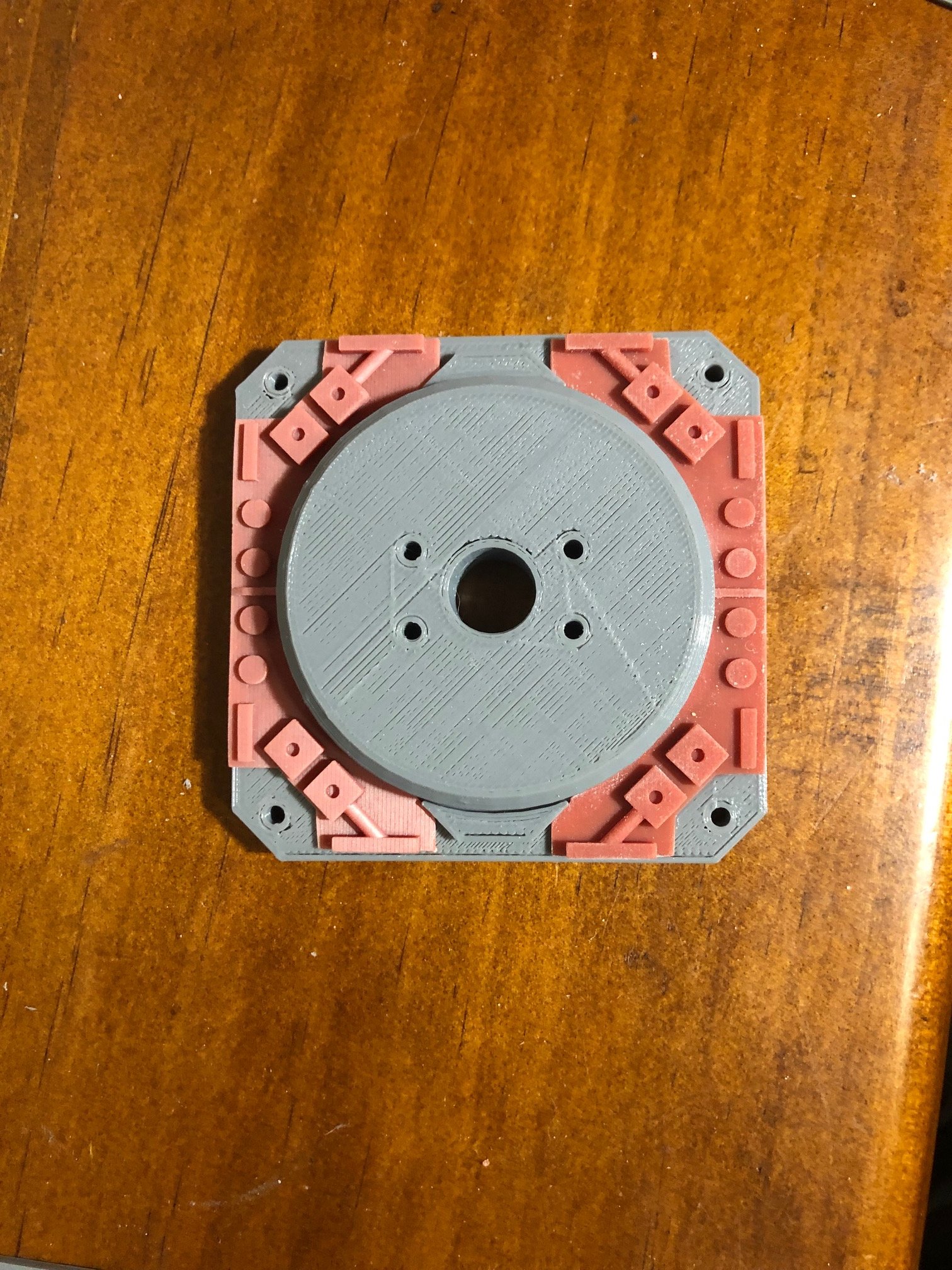

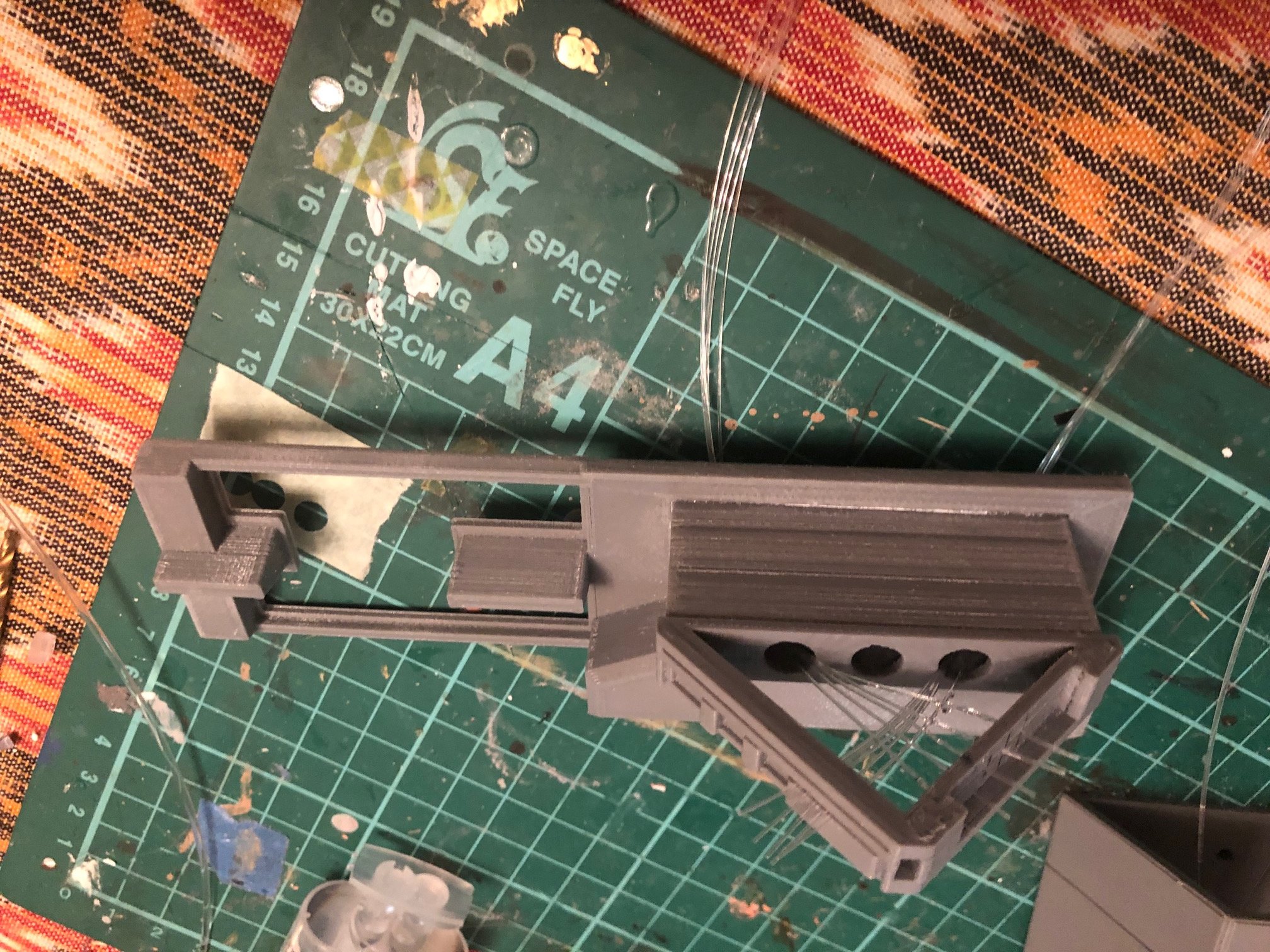

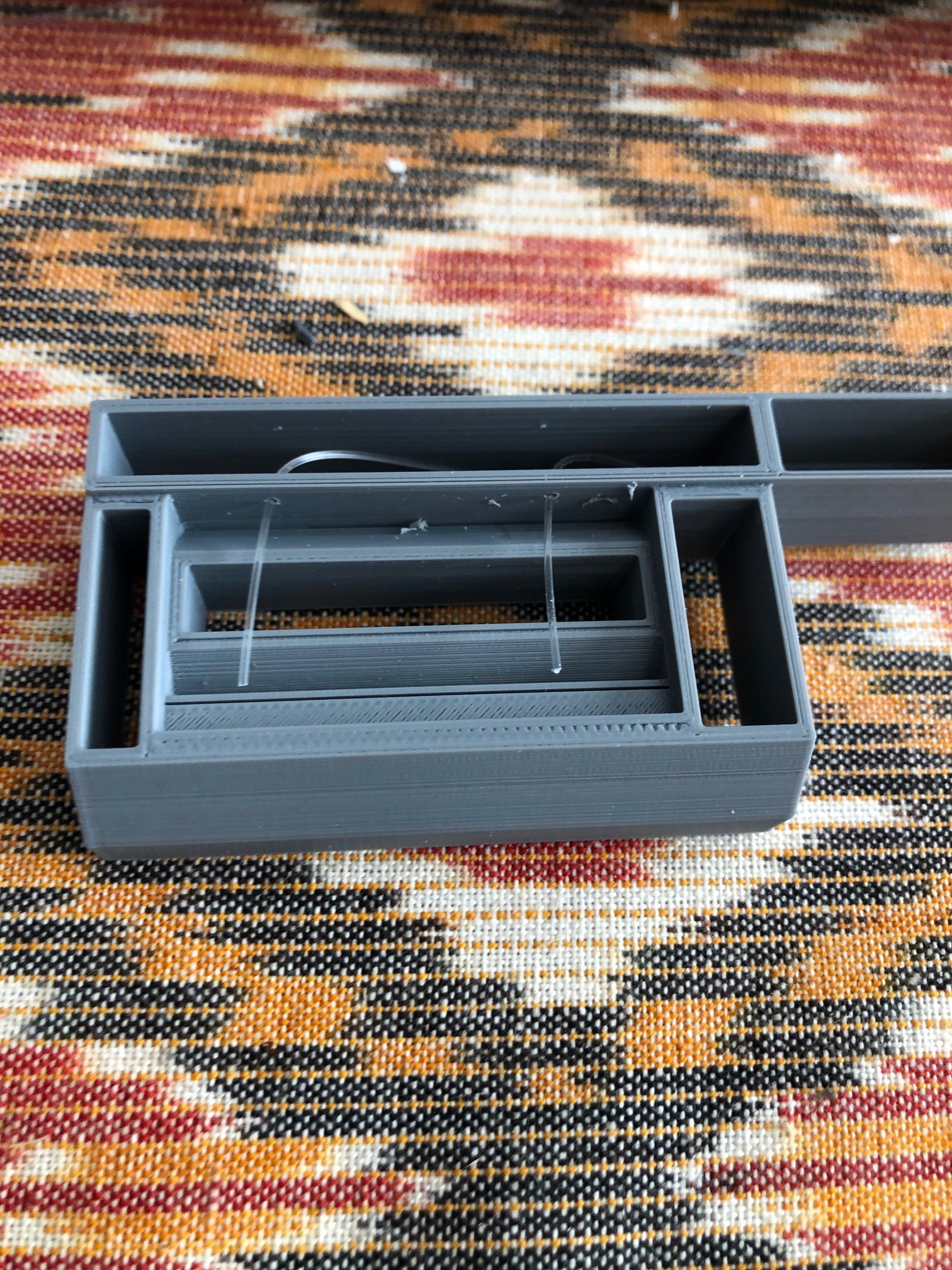

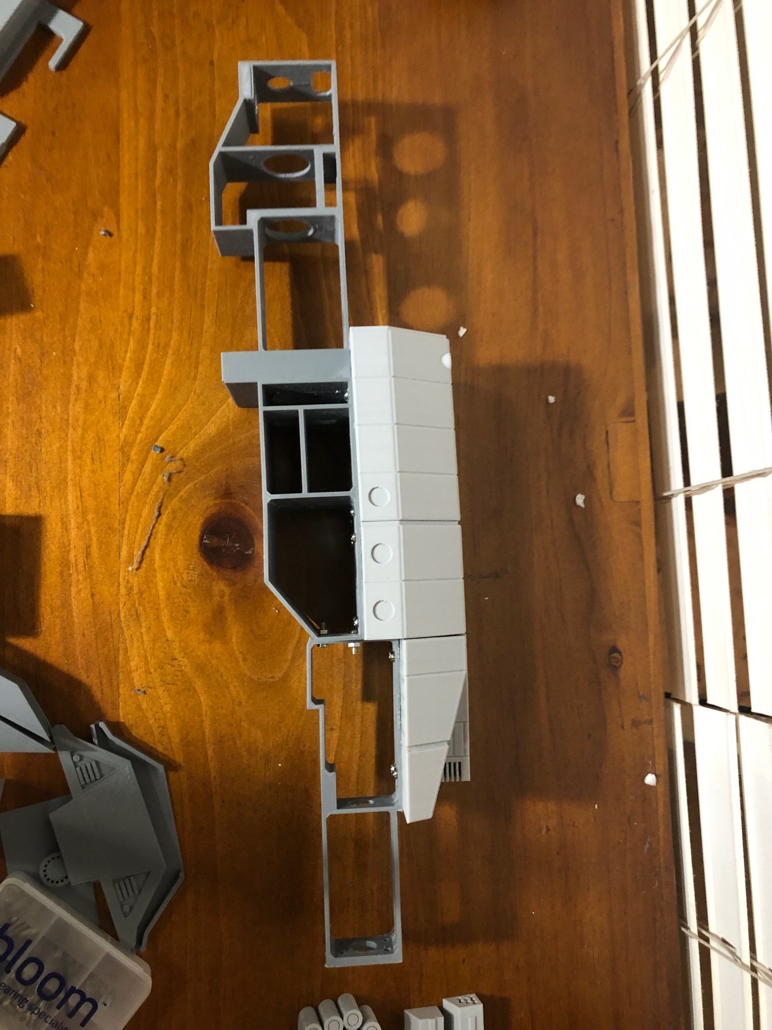

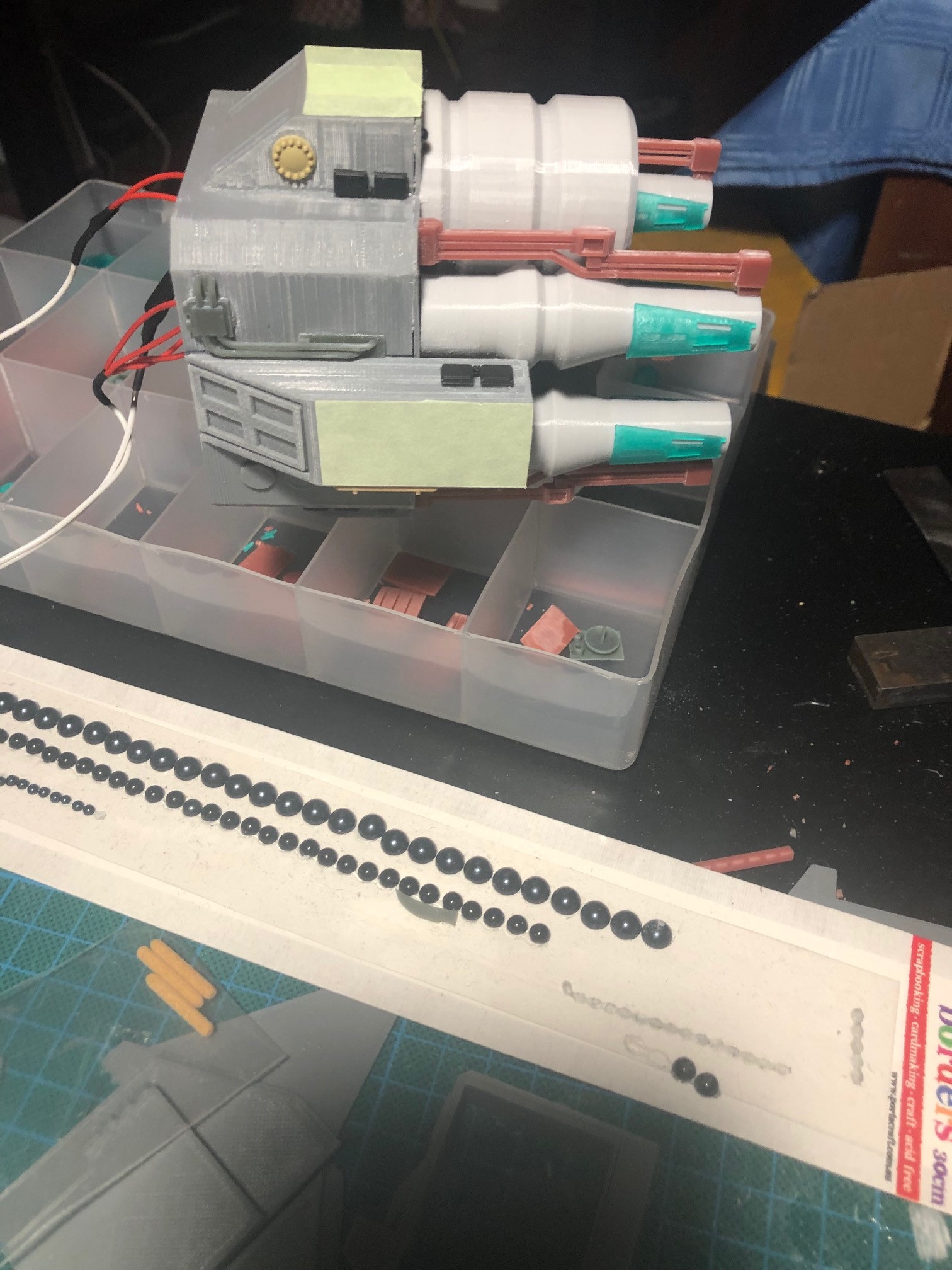

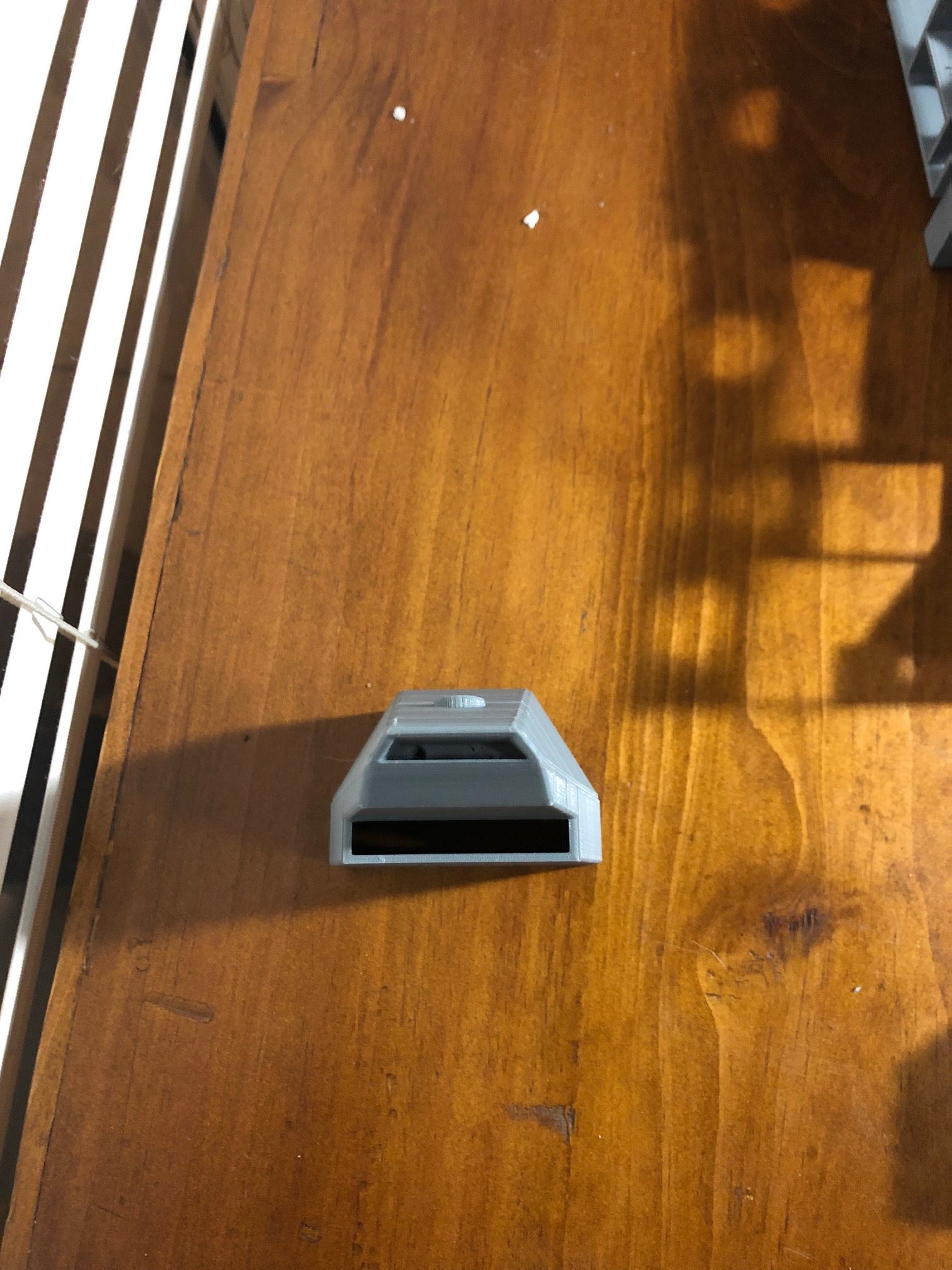

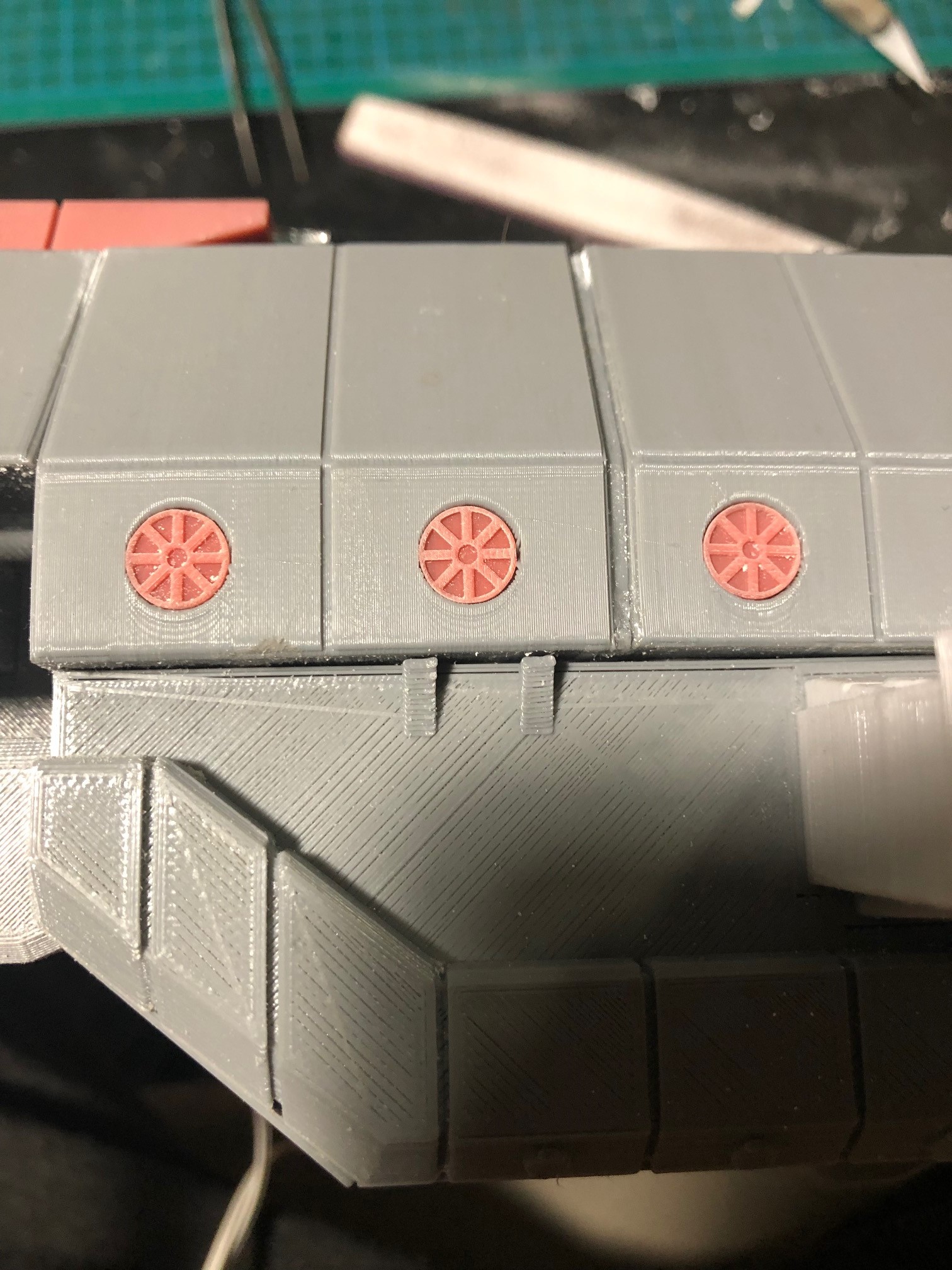

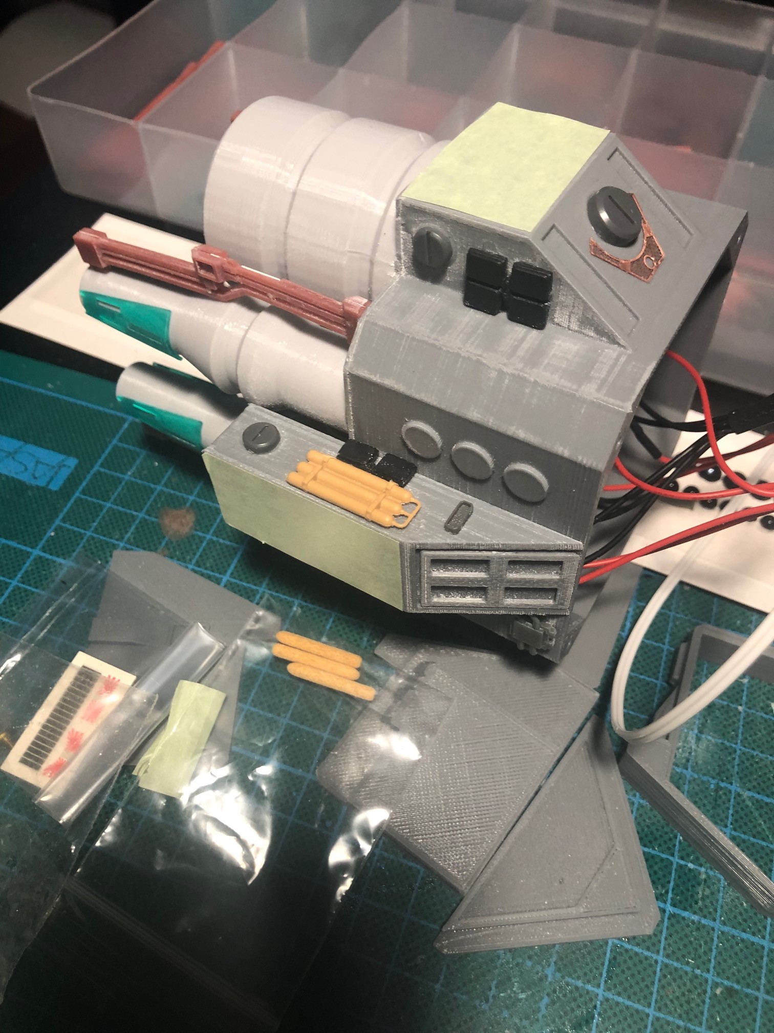

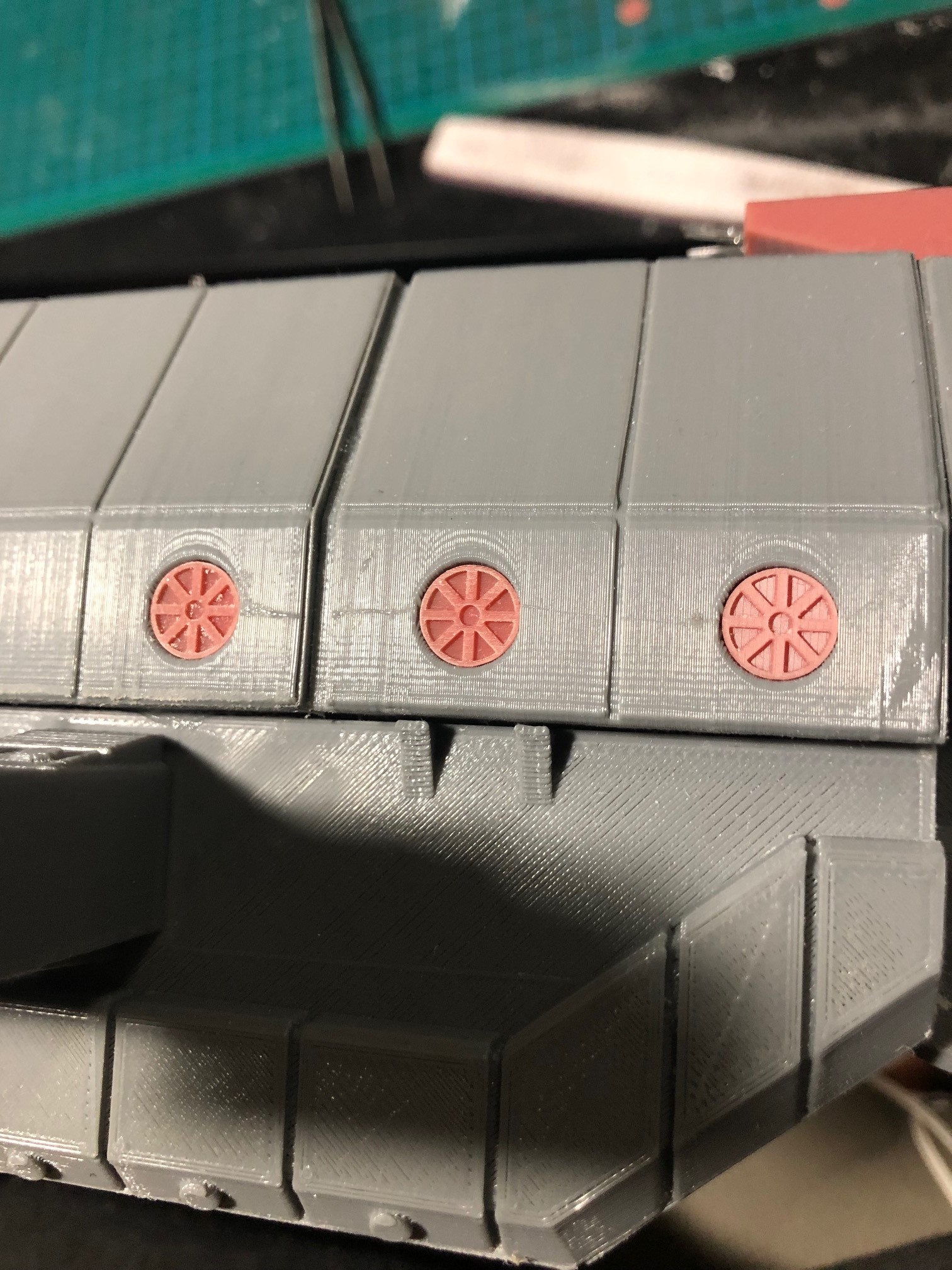

Here are a few more detail pieces to be added to the Warlock,

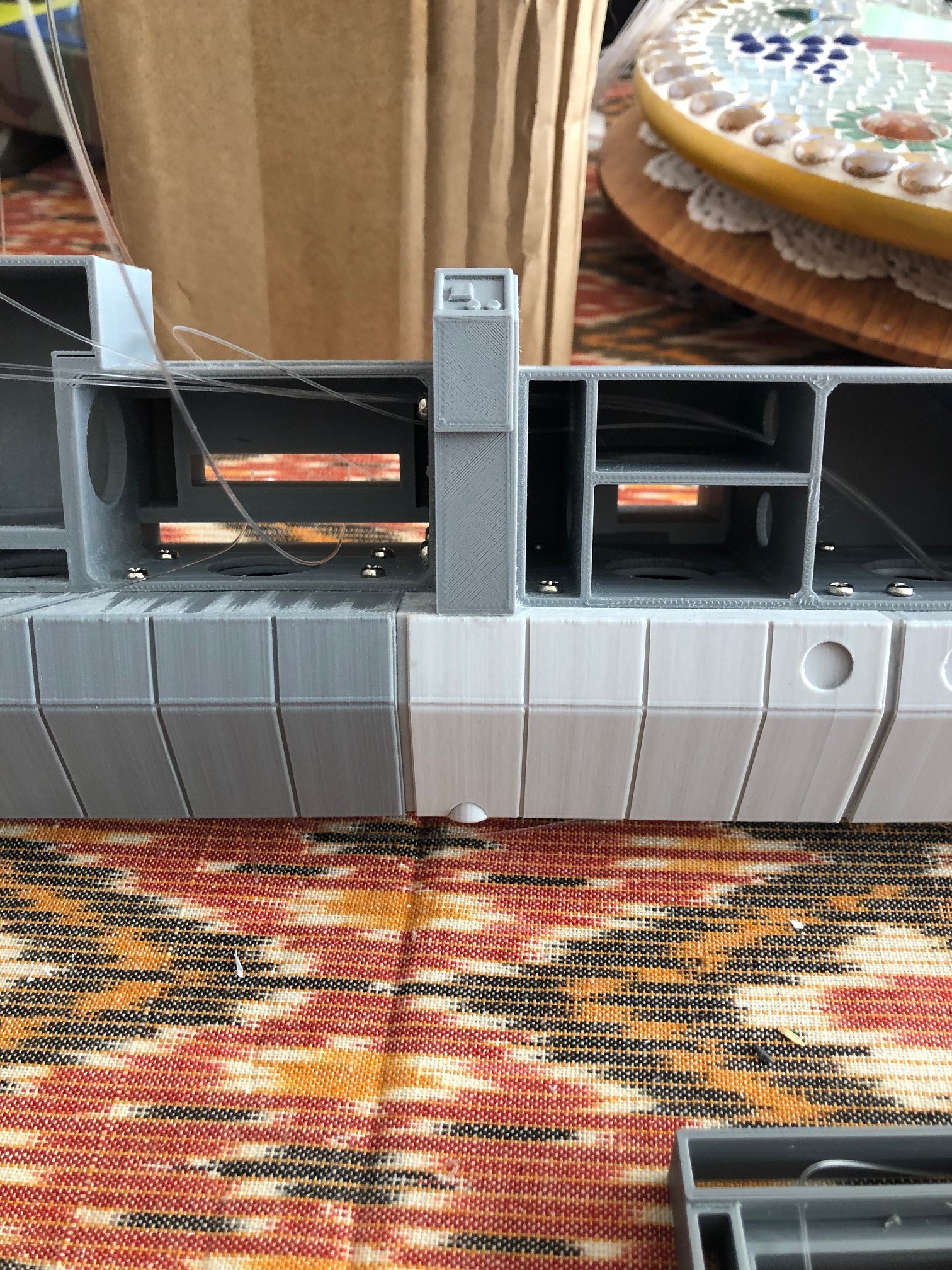

Plus adding a few fiber optics to the side of the ship adding a few windows.
