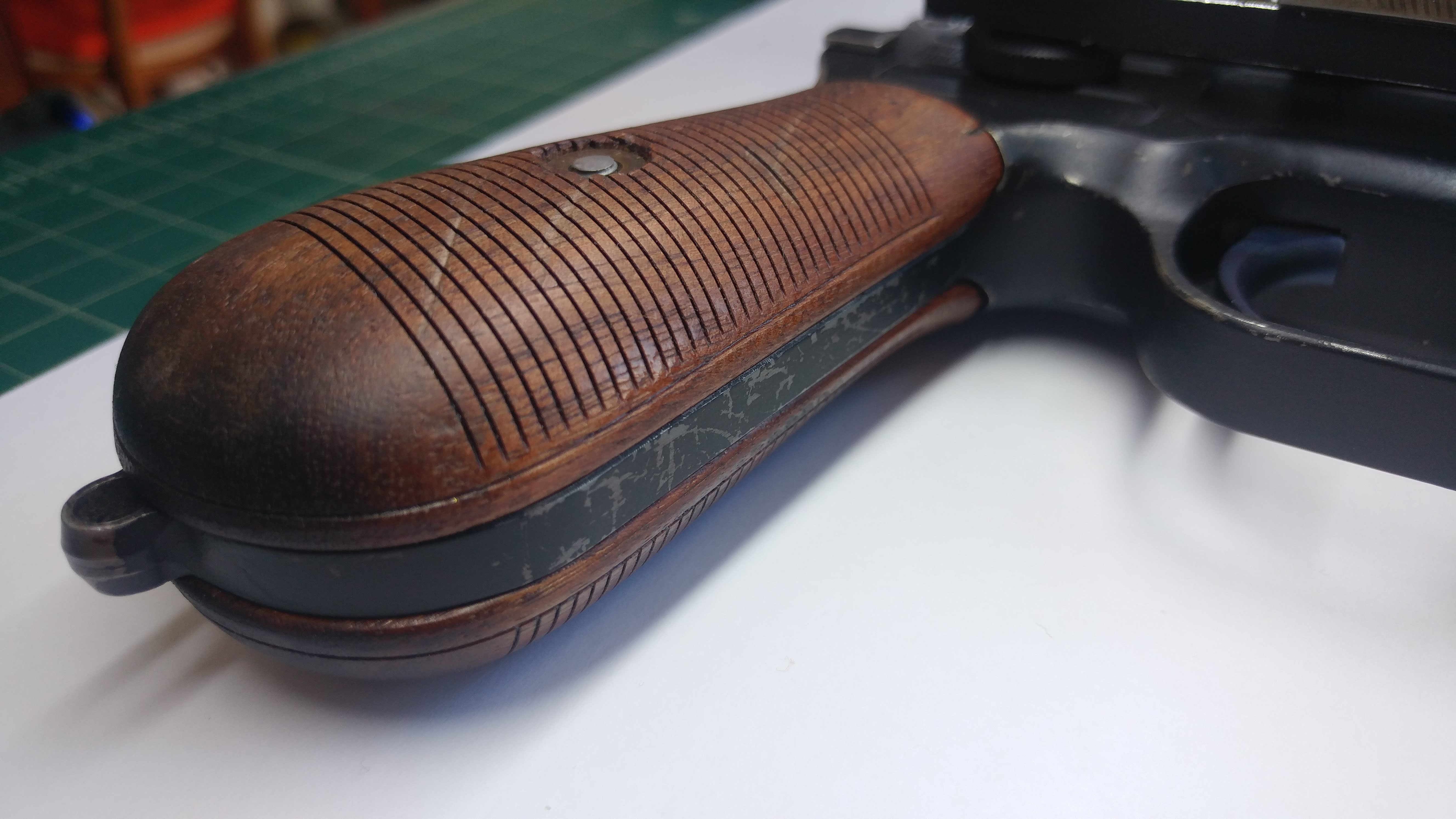

- The grips will always be a work in progress. I plan on continuing to handle and very lightly oil/weather these until they are dark dark, like the real deal. I spent a lot of time experimenting with the grips trying to obtain the proper hue/sheen, but they should only get better with age.

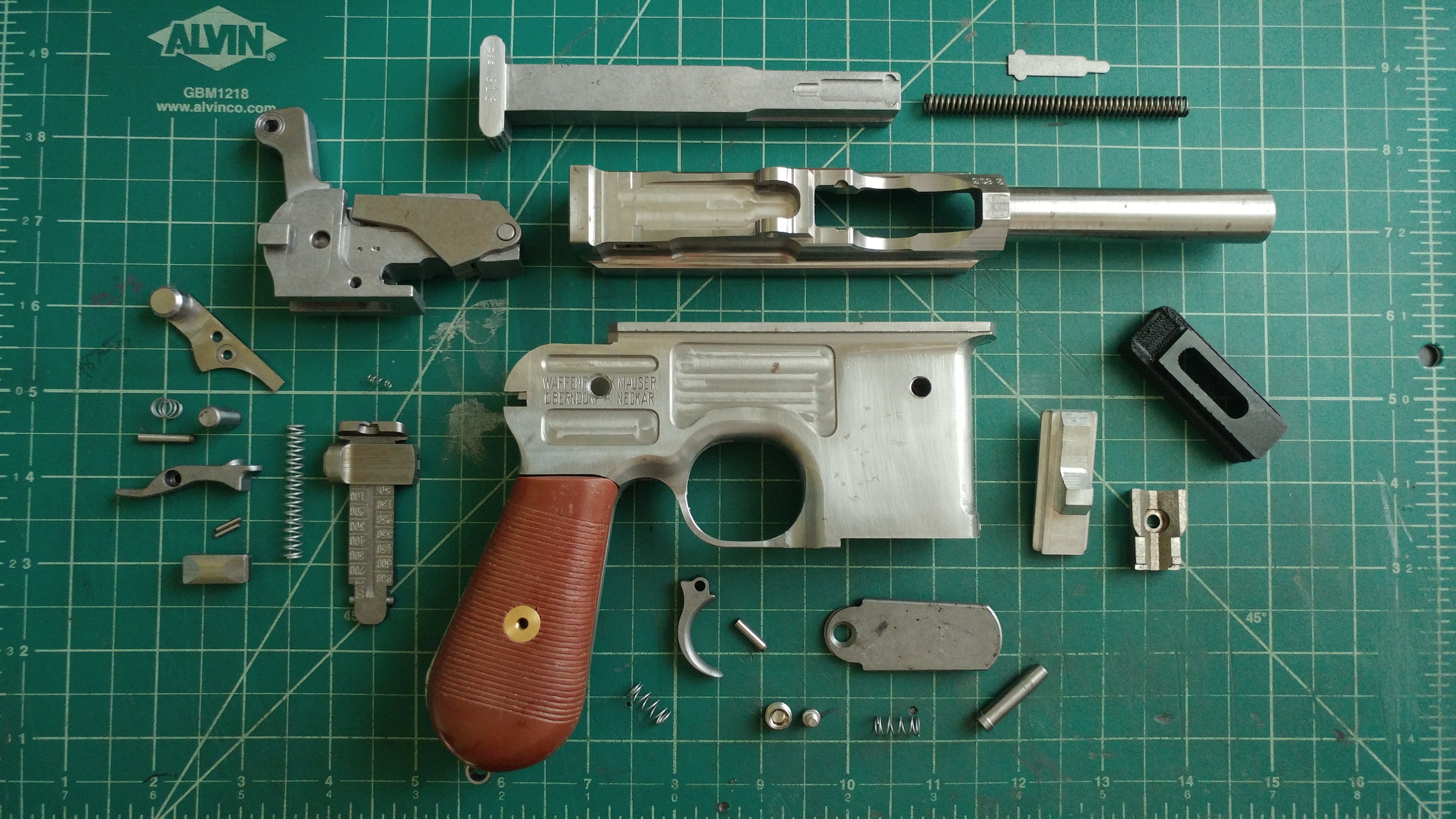

There was some surface rust on the steel pieces when it first arrived. No big deal, but this was sanded away carefully so as to not lose any detail
Off the bat there's some de-burring that needs to be done (see mag well details below for example) but it's a very finely machined piece of kit:
It's hard to tell from these photos, but I hit most of the sharp edges with needle files to mimic the hand-finished look of a real Mauser. I also did some careful sanding to remove most of the CNC machine lines from the flat surfaces of the steel, to further sell the hand-machined look. There are also some subtle lines to be blended on the trigger guard, mag well, etc. but I failed to photograph such small details:

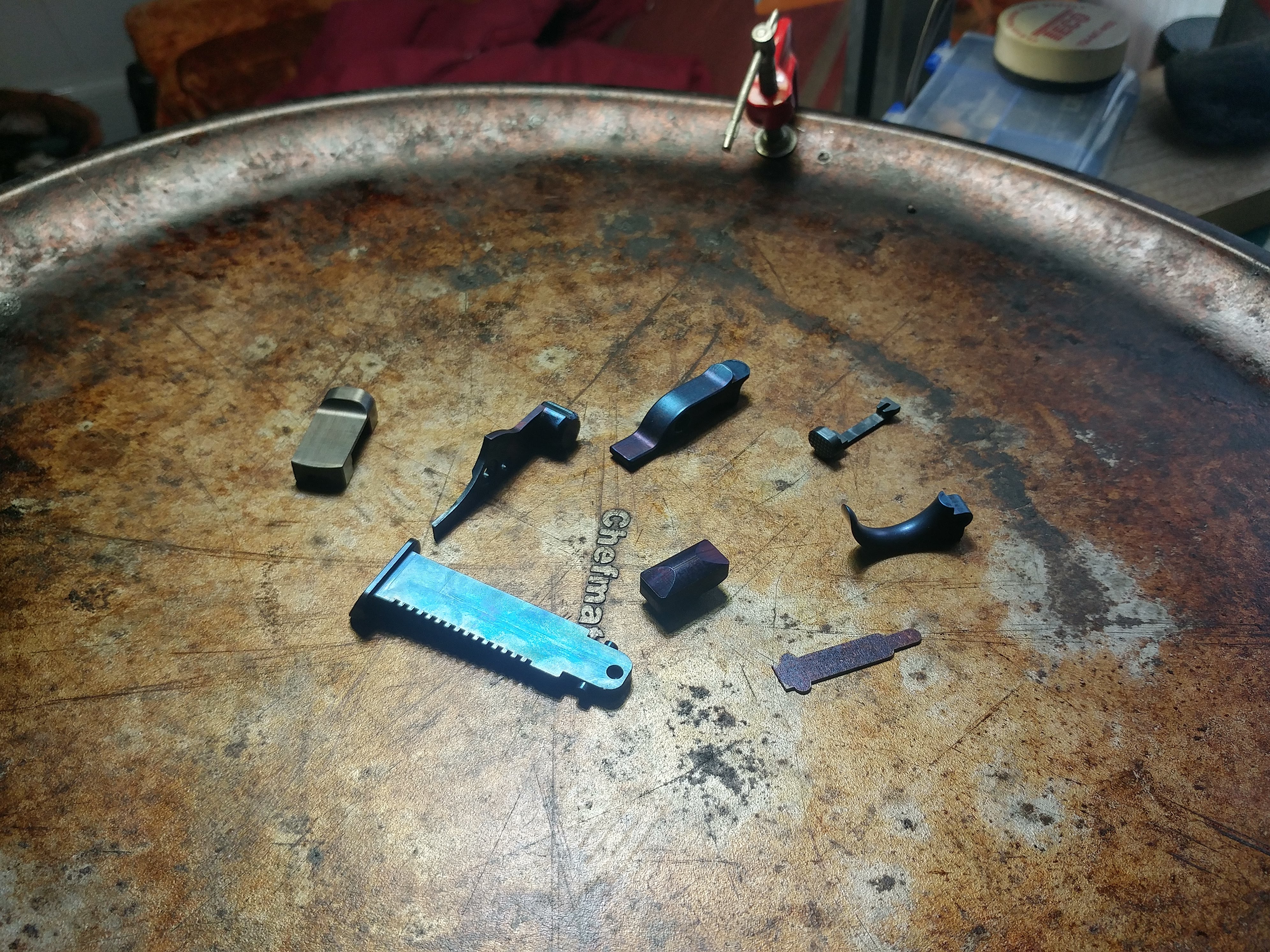

Super dark after a few treatments with Perma Blue and sealed with Barricade:
Fire bluing the appropriate parts (I've ended up re-doing a few of these that got taken too far on the first attempt):

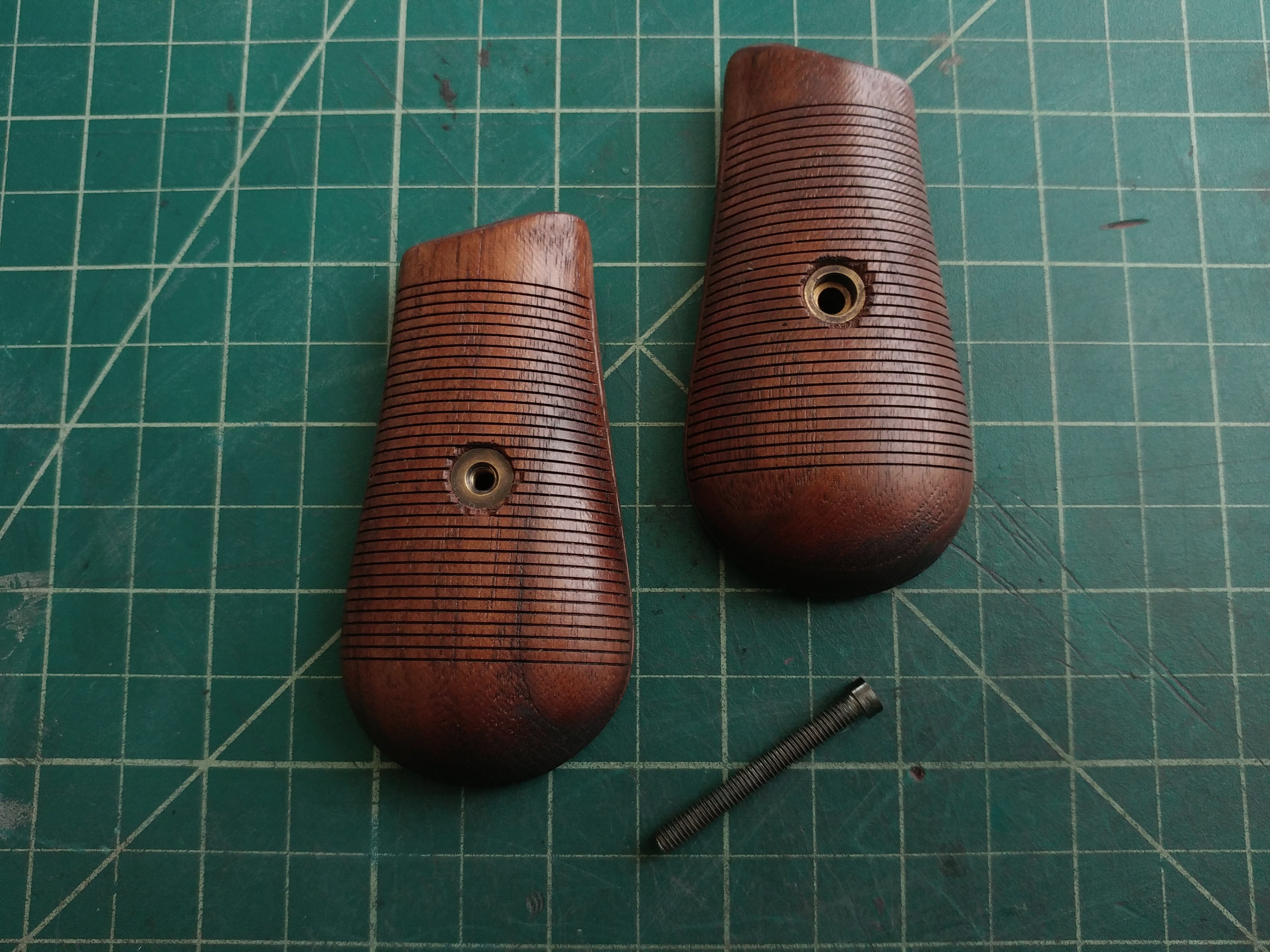

I replaced the stock grips with some of Field Marshall's walnut grips. It took three attempts to get these where I want them, but for me the winning combination seemed to be just a small bit of (heavily diluted) walnut stain, with many (thin!) coats of tru oil. I also very carefully sanded the grips beforehand to take away some of the CNC machine lines, take away a hint of sharpness, etc. There are many pitfalls to look out for when doing these if you want to achieve a nice finish. My advice ... don't apply too much stain or oil at a time or the wood can start to swell. Also, when you're sanding the raw wood, sand with the grain and don't use steel wool or anything that may change the color of the wood. The walnut is rather porous and will darken with steel wool dust, etc. Also, don't just glob the oil on ... apply sparingly and wipe most of it away, or you'll likely end up with a super glossy finish that doesn't look quite right. It should be built up slowly with time to soak in between coats. Otherwise, it all dries on the surface and you get an overly-glossy finish that lacks that intangible quality we're looking for.
I opted to purchase an extra screw and escutcheon set from Dave at DEC, because I believe that his are a bit more accurate to a real Mauser. His escutcheons are knurled, which I like, and a bit thicker as well. Because of this I had to do some careful counter-sinking and tedious pressure-fitting to get them to work:
Also, his screws come un-blued, which I like, because I was able to achieve a nice worn look. They're also a bit longer, allowing me to trim them to accurate length for an ANH Hero (protruding a bit from the escutcheon):
Weathered the screw and excutcheons with perma blue and brass black, respsectively:
Here's an earlier set of grips where I got over-zealous with the counter-sinking for the escutcheons.This is actually pretty faithful to how these grips wear in actuality, but not quite right for an ANH so I gave them a third try (pictured in initial post).

Can you breakdown the container and materials and process you used for the fire bluing?
The container is just a solid brass 3" pipe fitting filled with some scrap brass (mostly stripped out screws, etc.) The idea is to use something that won't leach heat away from the piece as you're bluing it. A bit over-engineered probably, as one could probably do well enough with just a brick or something. The screws do help by making many tiny points of contact vs. just a cold flat surface that would draw a lot of heat from one side of the work. I just heated them strategically with a small butane torch. There are a bunch of videos on youtube that could help with some of the finer techinques, or if you want a video specific to these Mauser parts, Scott has a great instructional video on his Patreon page. My main advice is that (like with most things) it's super easy to over-do it and take it too far.
Thanks! I was going to forego attempting it, but it seems real easy so I'm definitely gonna give it a shot.
