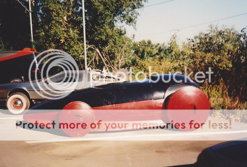

What would be a good method for me to scratch build this shape? I would like to brainstorm and spit ball some idea's around with you guys. I've never scratch built something of such complexity before. I'd really like to read your thoughts.
Here are a few pics to get us started.

id prob go with a lump of wood shaped to something close then a good layer of car body filler /bondo and sand it to shape , could use a thin sheet of styrene for the lower front peice
once its smooth use a scribing tool like a olfa and some dymo tape to make the detail lines on the body
looks pretty easy to scratch build compared to some stuff

work with what you like best
myself i dont like how putty sands , but others get on fine with it
i like the car filler as it dries fast , sands easy and has reasonble strentgh ..also easy to buy where ever you live

Complex? There's nothing to these shapes. High density urethane. Create a series of negative guides as checks for sections along the way. Your choice as to whether it becomes a vac-form master or you fill and refine and finish the foam itself.
