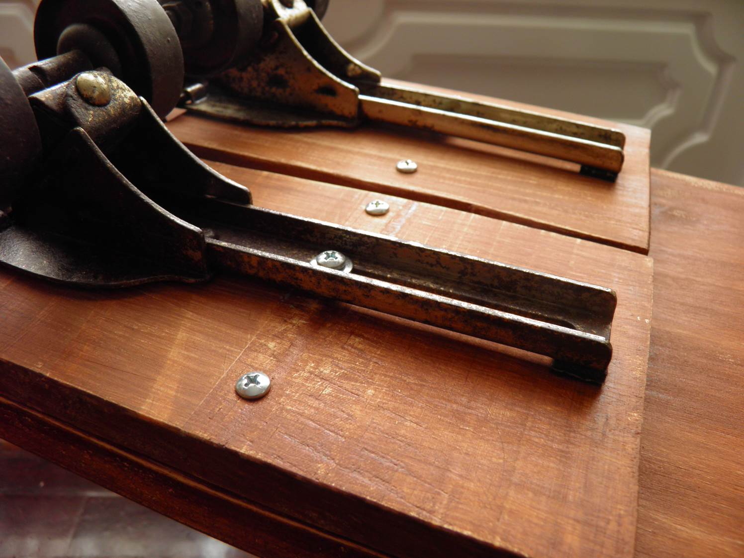

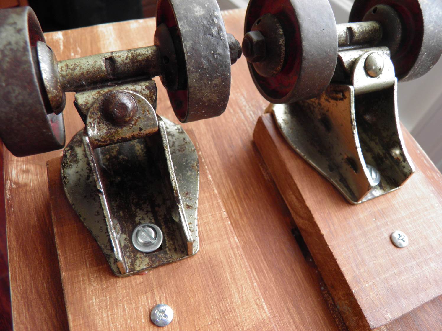

Here it is. Hope it helps.

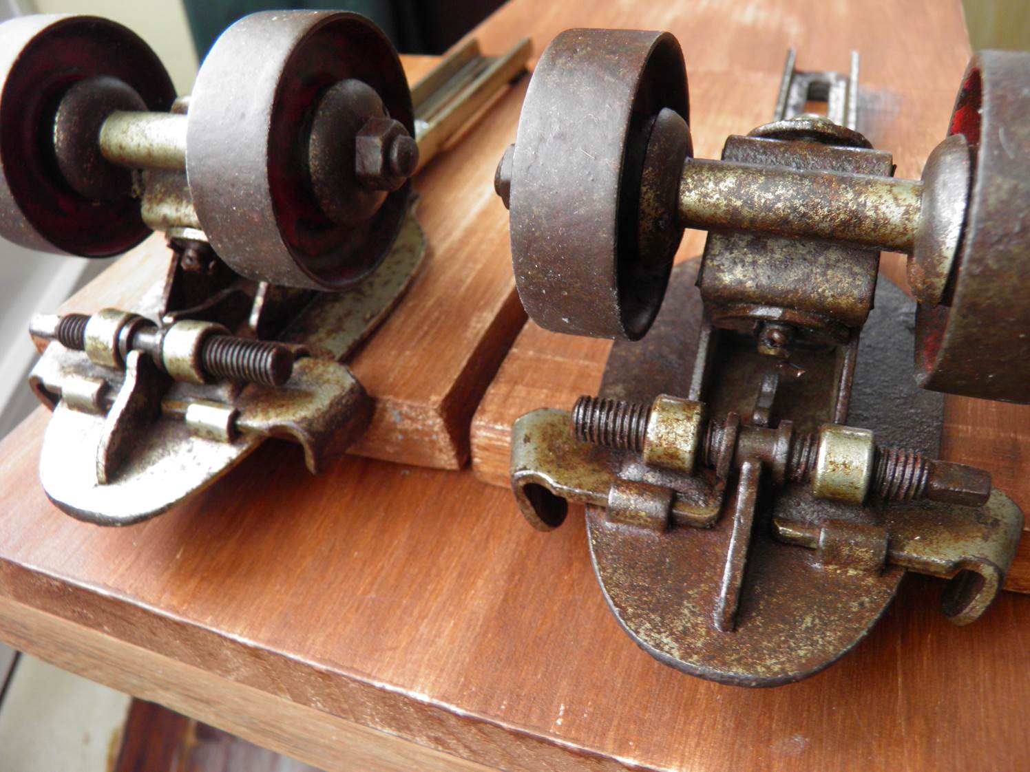

As you can se I decided to use one piece of wood roughly cuted for each skate

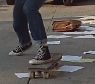

So it appears there could be more then 5 different boards used for filming, which is not surprising. I am almost positive at this point that most of them are plywood. Some screen grabs show just regular skateboard parts with a groove in a wide wheel to resemble the 4 wheels... Pretty cool.

I had known that they used different skateboards in the movie, but it's surprising me that there are so many of them. And I had never noticed that there are skateboards with regular skateboard parts. That's really cool. :)
Did they actually think, no one would ever notice all those differences? :lol
They had to use at least one with real skateboard trucks... the style with just roller skates bolted to a plank isn't steerable, except by lifting one end off the ground and pivoting!
I see an additional cheat in the 4th frame grab above (Capture6.jpg) -- there is some grip tape noticeable at the front. There might be more on the rest of the board but it's hard to tell. This may be the same board as in the 8th image (Capture2.jpg).

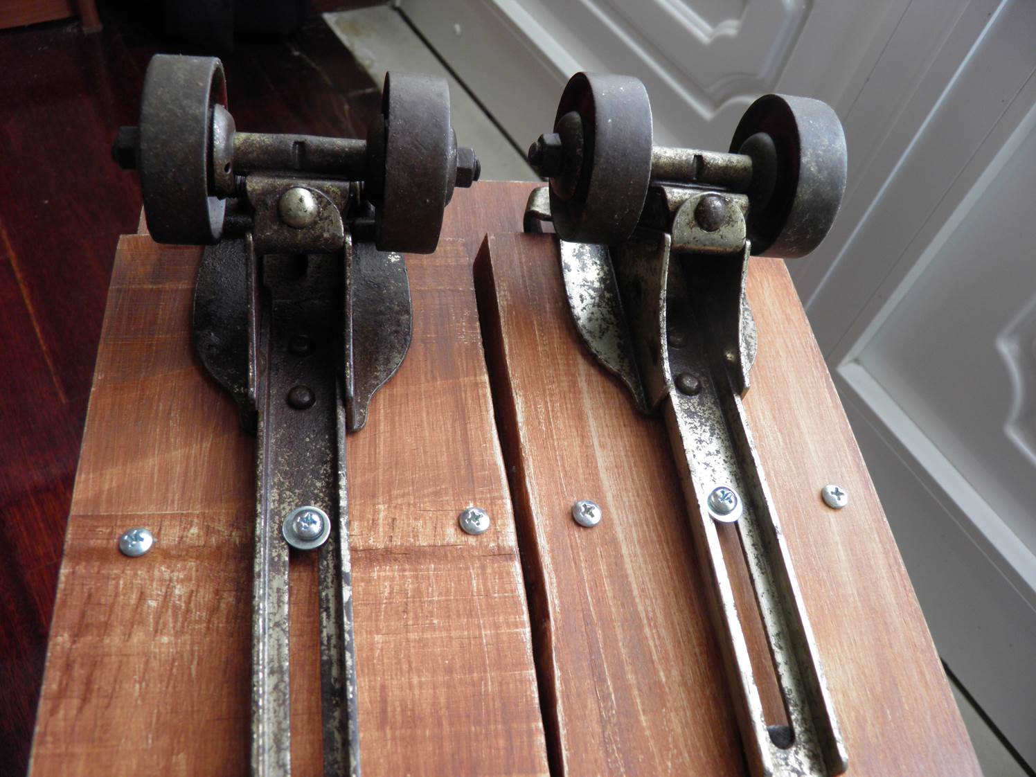

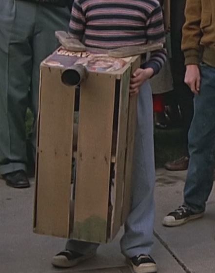

II came home on leave to find the crate I ordered a while ago. I guess the seller didn't know how to measure things because it has the exact right dimensions that it should. So I will use it for my project.

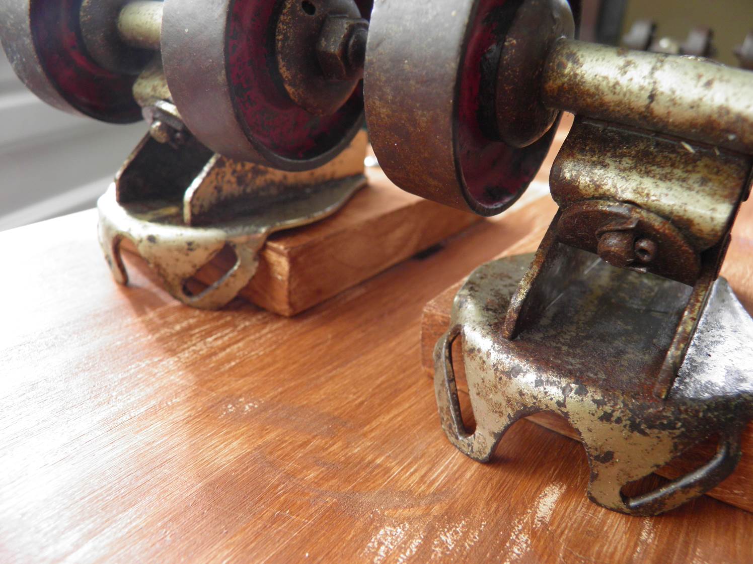

I've started removing the rust off of my wheels. wd40 and sand paper lol
ImIm thinking that the wooden squares on the bottom are 5.5 inches on all sides.
This is a we some build!! I have to put this together. I was wondering if there was any measurements available. Or anyone have any idea what skates to look for. This is great!! Great reference photos as well!
The board is 28.5 inches long and 8 inches wide. My measurement for the squares seems to be right because they look good on my board. The kick tail at the end is 3.5 inches long but that is the only measurement that was found for that. And the skates are Globe.
I also put the rectangle piece of wood in the front because its there when Marty first finds the kid. So it's the hero version. I calcuted that piece to be 7 inches long and 1 1/4 inches wide with 3/4 inch thick wood.
Also looking at still images I found that the edge of the square on the bottom lined up with the kicktail at the back which is 3.5 inches so i made the squares that distance from each end of the board. I put the rectangle piece 1/4 inch from the end. That was just a guess from stills. Another observation I saw was that nails were put in from the top attaching the squares to the board. One in each corner area. So 8 nails. My pieces are attached with wood glue right now to make putting in the nails and screws for the skates easier.

Also I think that at least a few boards were plywood. You can see the layers in this picture.
I didn't have a change to take a picture of my crate before I left for the airport but it has the Brave crate label on it. The next time I work on it which will unfortunately be about 7 months I will sand it to make the wood a little brighter as its a little dirty. I will also put the correct lettering on the planks.

yes at first glance i thought it was cedar. like barn board cedar. the first page has a bunch of great reference pics, and after you said you used plywood i took a greater look. sure enough it is plywood!! which i don't believe was around in 1955 ;) so I'm with you 100% that they used plywood. i have also been watching eBay for skates to my surprise some that look pretty close are very inexpensive. there are 2 or 3 pairs that have the same 2 groves in the bottom of the skate like the picture on the first page once i get back into the country I'm going to go hardcore and watch see if i can grab a pair
