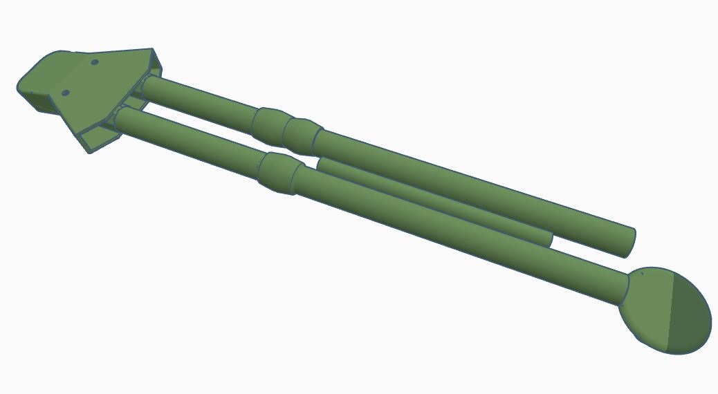

Back to designing again.

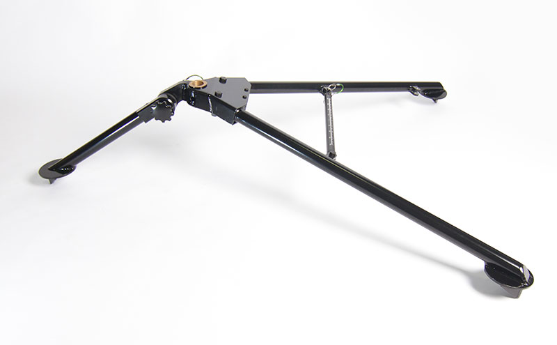

Below is the Mk123 Lightweight Tripod which was made out of aluminum and usually painted a gloss black.
The older M3 mount was very heavy and took longer to set up and take down.
My rendition is a bit different and displayed in an olive drab colour, similar to the old M3 mount.
Currently I'm segmenting the sections to fit on a 12" bed. I'm also designing the parts so that they will accommodate a 1/2" copper pipe, which should tremendously strengthen the structure. It will be able to be folded up. I still have to design the Traverse and Elevation Mechanism which sits on the Traverse Bar.
The whole thing is pretty big. about 1.4 metres long.

Make sure that you make that tripod fairly sturdy because SOP when firing an M2 from one of those tripods is to plant your feet against the two back facing legs of the tripod while sitting behind the gun itself. It, obviously, doesn't need to be able to withstand the recoil of a real M2 firing, but I would make sure that it's sturdy enough so that if you sit behind it with your feet up against the legs it doesn't just snap.
TazMan2000
I designed the M2 and M3s to accommodate a 1/2" copper pipe in the barrel and I was amazed at how strong it was. I'm doing the same here. Mind you this thing is designed to be a prop replica and won't have to withstand the rigors of combat. It still will be pretty strong. I'm thinking the weakest point will be the arm that holds the forward leg.

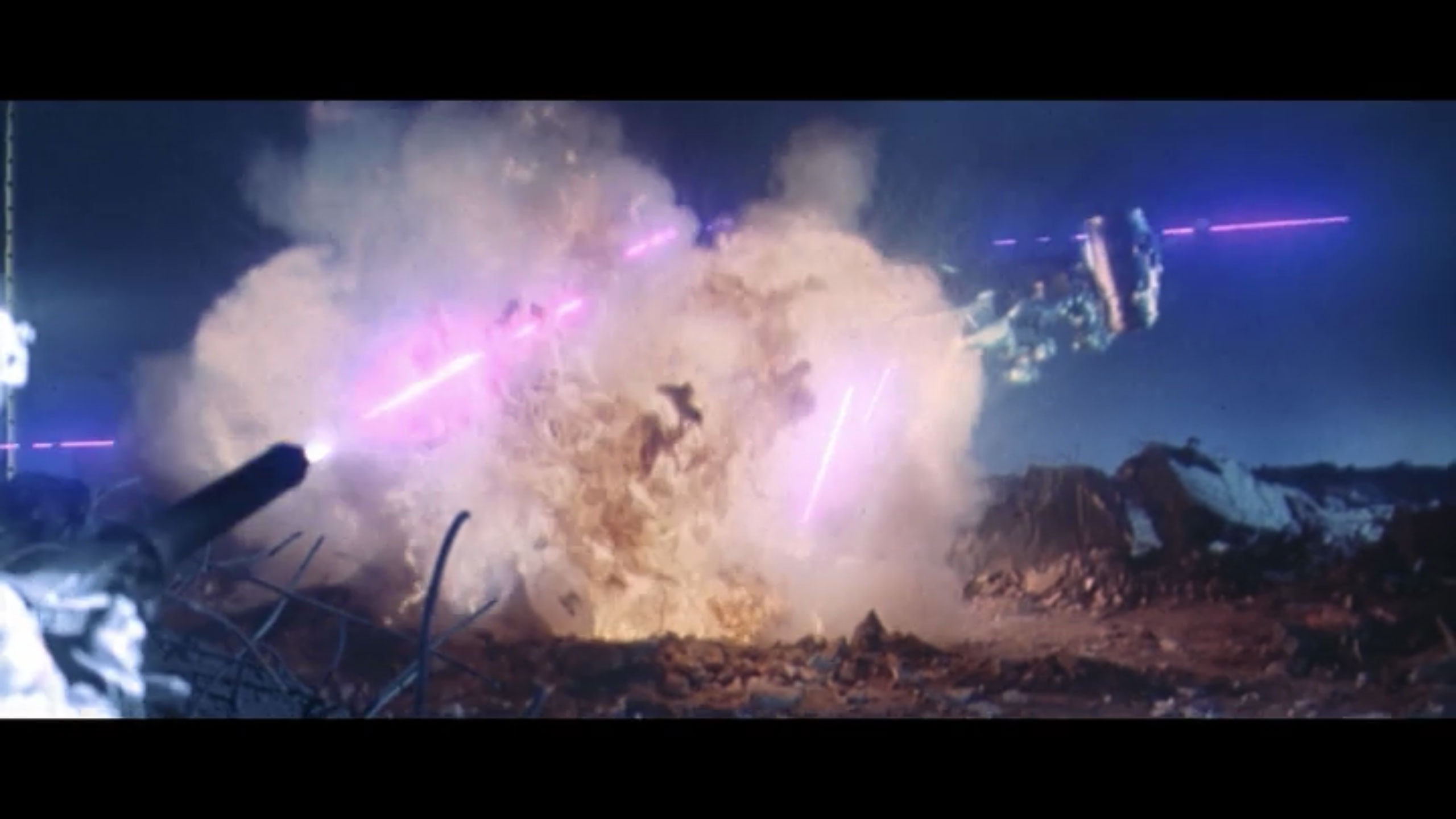

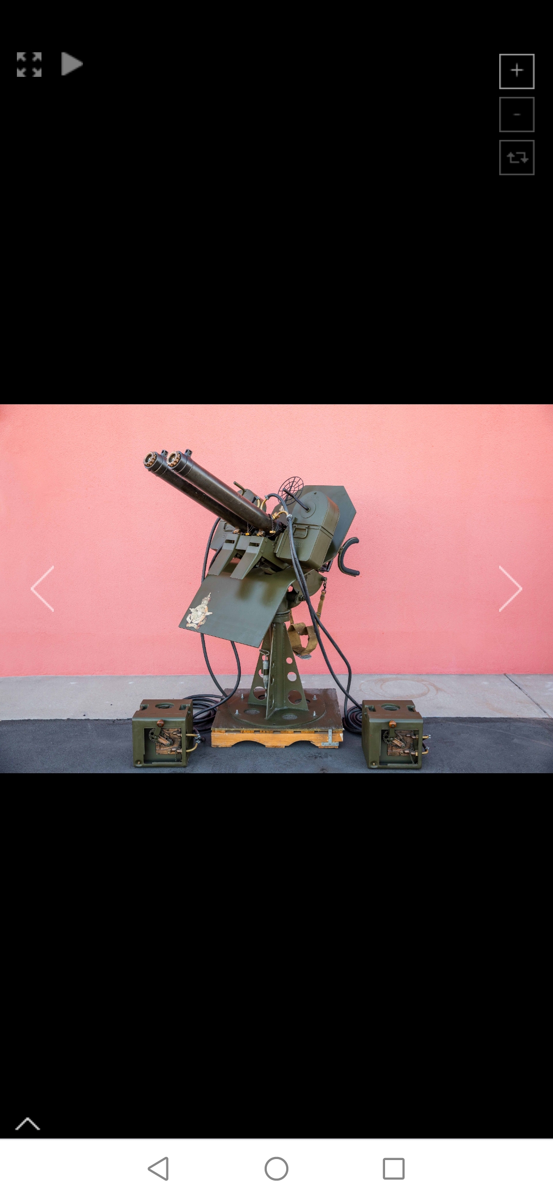

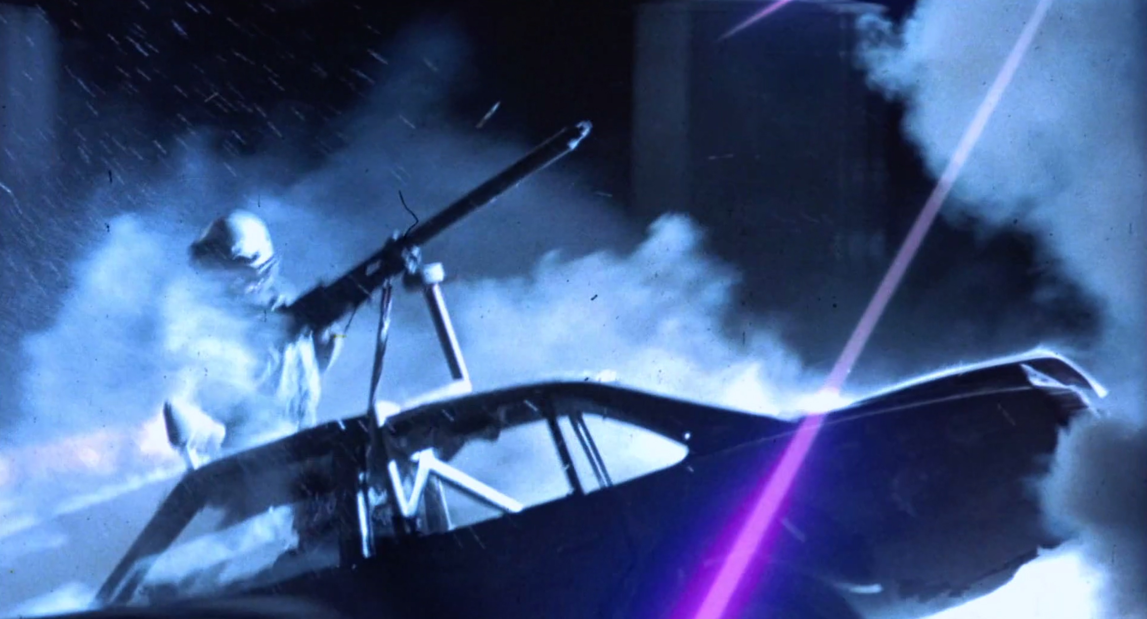

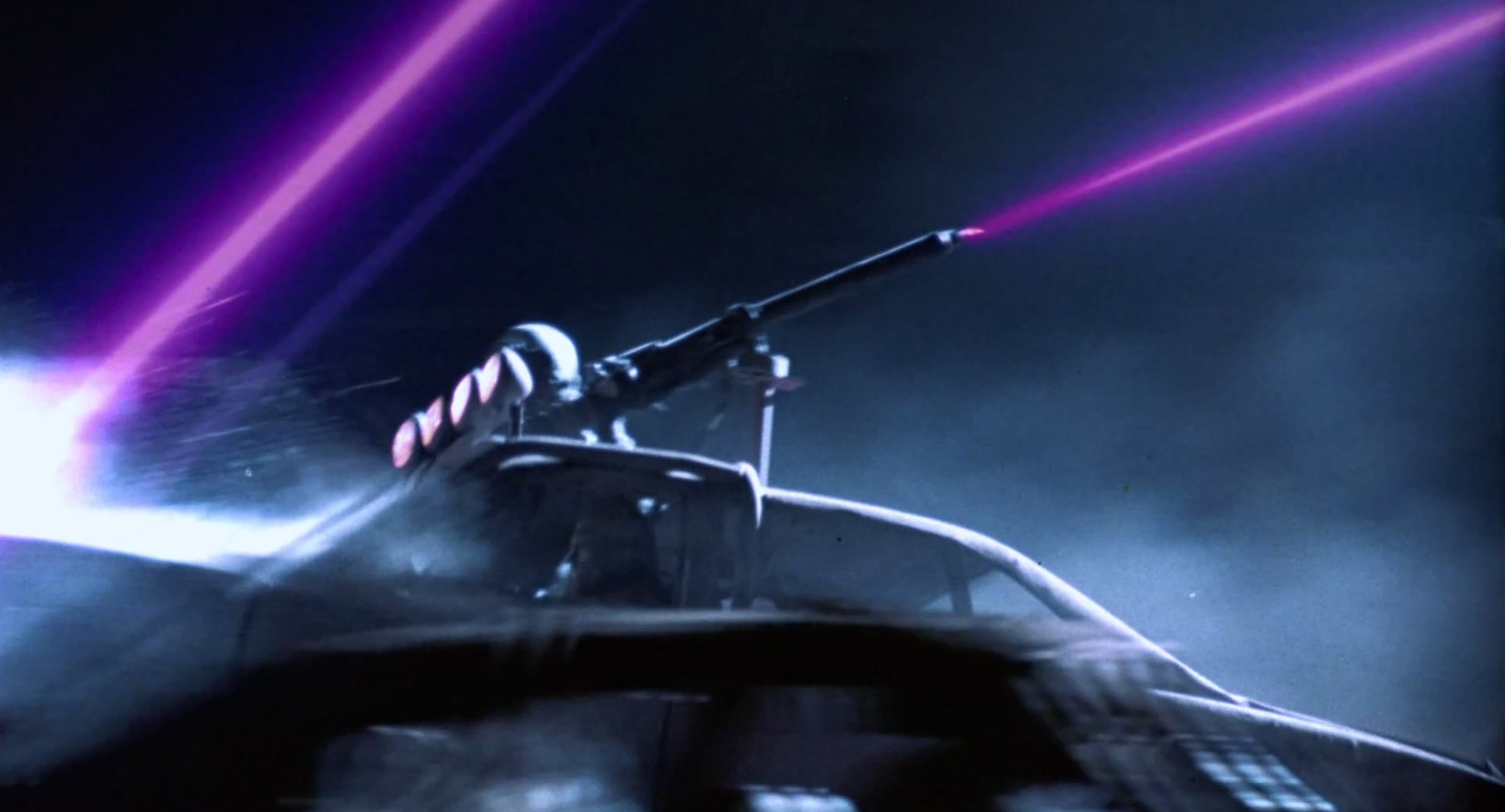

Just found this thread. The weapon Franco used was also seen mounted on the car Reese drove in the nightmare sequence and is also seen at the beginning of T2. It has a bowl shape down where the barrel meets the main gun, so none of the original barrel is seen on the gun.
TazMan2000
View attachment 1441157 View attachment 1441158 View attachment 1441159
View attachment 1441160 View attachment 1441161
Good eye. But I'm sure the original M2HB barrel was used, just no barrel support. I'm surprised there aren't more production images on the net.

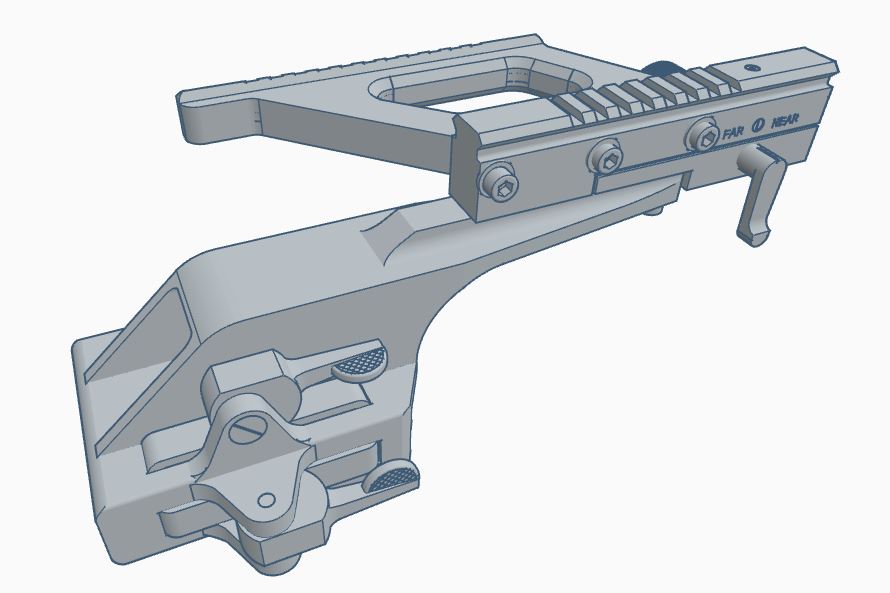

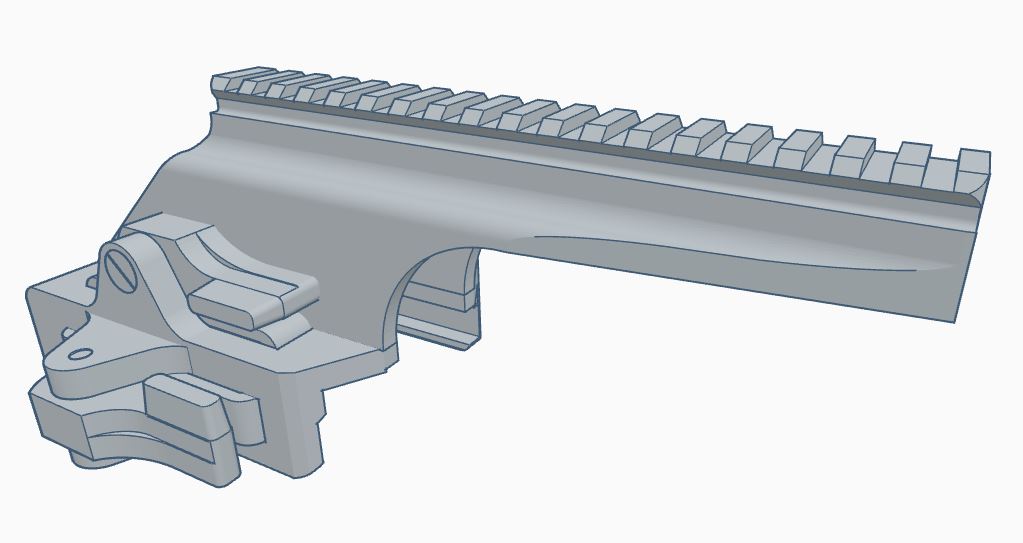

In a design phase now before I go into a printing phase. Now into sights and accessories.
Both are Picatinny type sight mounts. The one on the bottom is a newer style

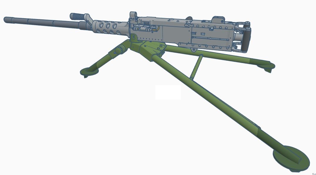

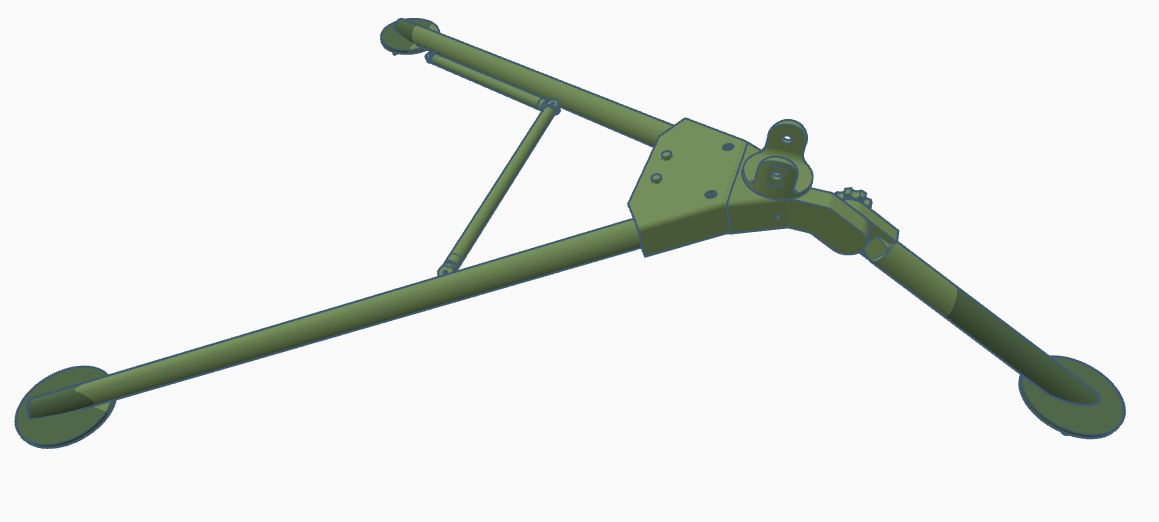

I should have checked before if the scale on the Mk123 was correct, but it seems to be.
In addition, I've decided to do the larger and more robust M3 Tripod. This one is going to be a bit more difficult since it will have extendable keyed legs and a sliding traverse bar. I don't believe that PLA will be anywhere strong enough for the front leg since. The real one has a steel 'U" welded on the end. If this is going to be able to bear any weight, I'm going to have to fabricate something out of aluminum.
The legs are 1.5 inches in diameter and about 4.6 feet long.

Oh yeah, I'm sure they just plopped the larger shroud with the bowl at the end on top of the actual barrel. Seems like a blank firing weapon in the movie.
