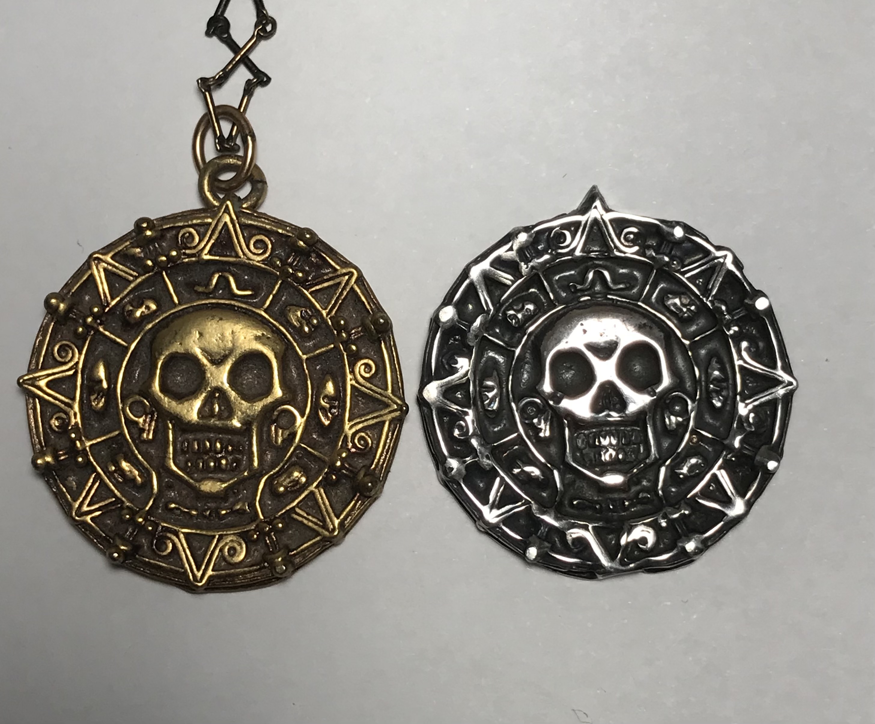

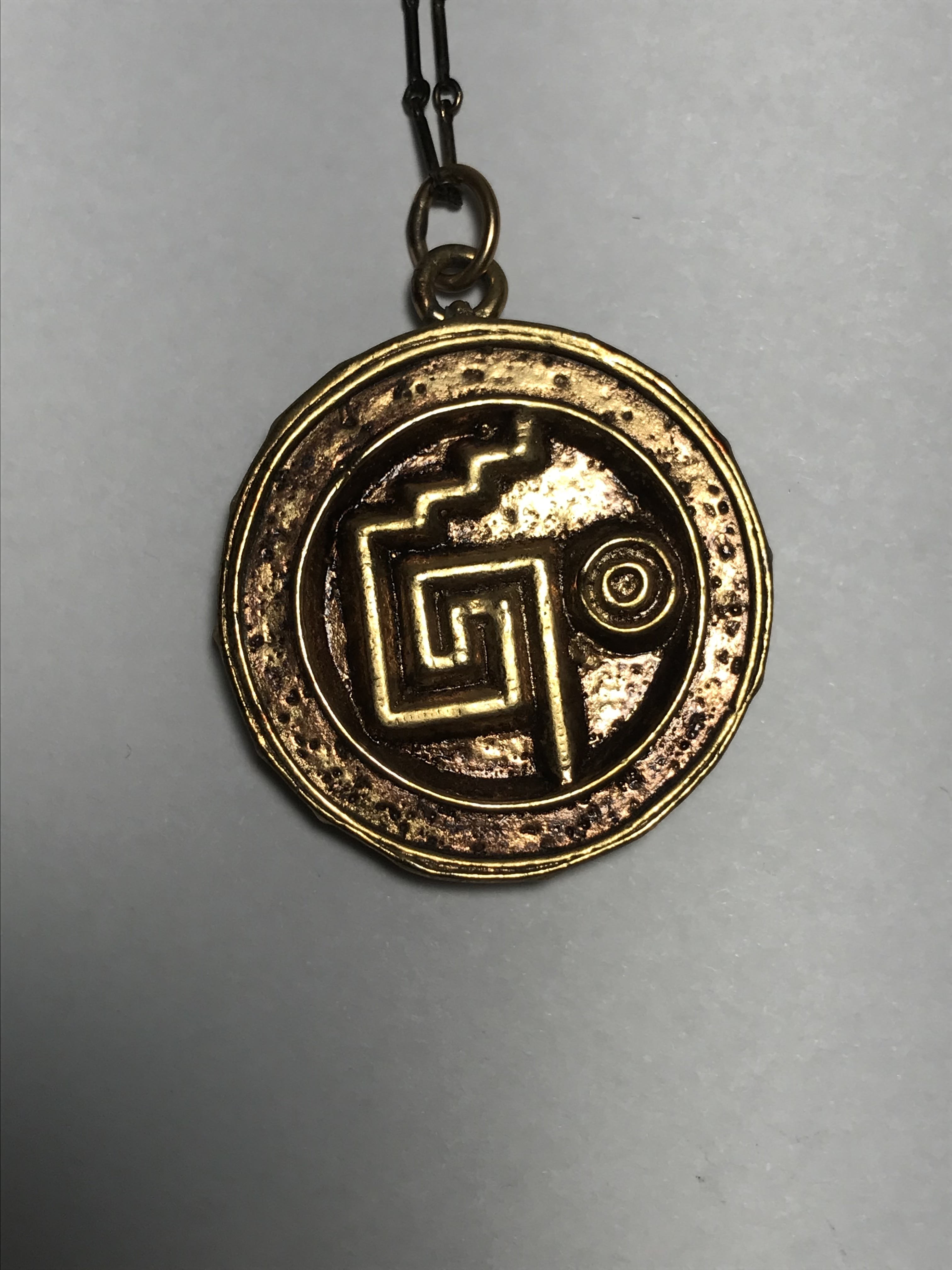

So, I have a "replica" of the medallion, but as far as I'm concerned, it's barely half of what it needs to be. I bought it at Disneyland a few years ago and while its not bad, its not at all accurate, which is what I am going for in every sense of the word with this prop.

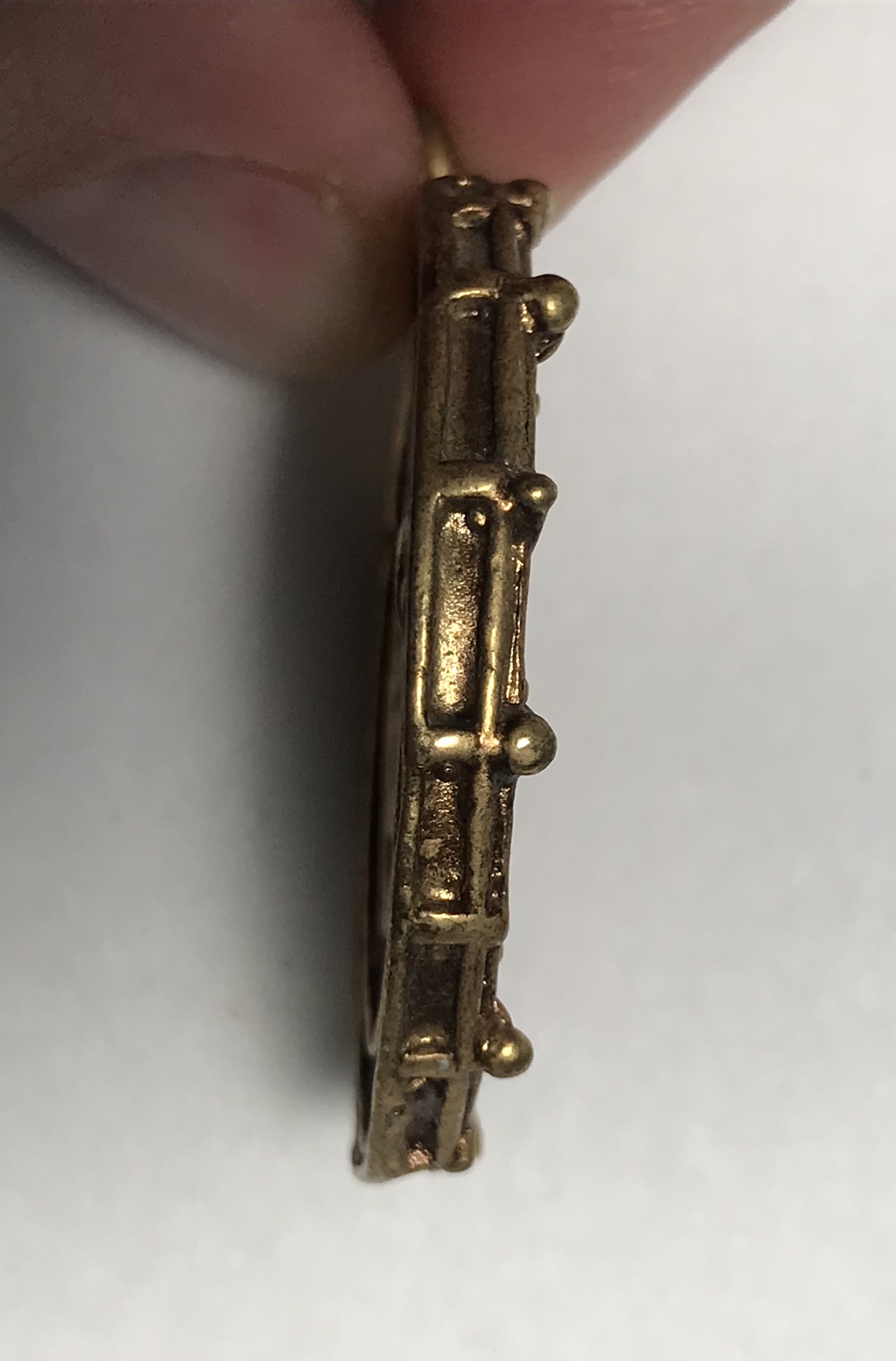

The front is crisp enough, but things like the eyes are a bit more round than the screen used one, the details around the skull look much more rounded than they should, the color is FAR too dark, the chain and chain attachment points are wrong all the way, and the back side is entirely missing. The Master Replicas one is much better, but I've been looking for one even better than that.
The lines and grooves are still a bit too undefined and the back feels lumpy and undetailed compared to the screen used one. The only thing I see here being great is the chain. Figuring that part out will be a pain, but that's part of the process, right? After loads of searching, I found someone here who found a 3 in 1 board game that came out along side At Worlds End, far after the Master Replicas medallion was released, that had a checkers game with metal cast pieces of the medallion in it. And let me tell you, they are GREAT in form. you can still find copies of this board game pack around on ebay, and for $50 or so, this is what I want to do. (pics below are the game piece coin gold plaited by RPF member TomVDJ) [Link to the RPF thread of his adventures of getting these gold plaited pieces into the hands of fellow fans: Interest - Pirates: Screen Accurate Gold Plated Aztec Gold Coin ]

(Comparing unplated piece, to gold plated piece, to Master Replicas at the bottom)

(edge of game piece)

(Gold plated piece compared to screen used prop in close up)

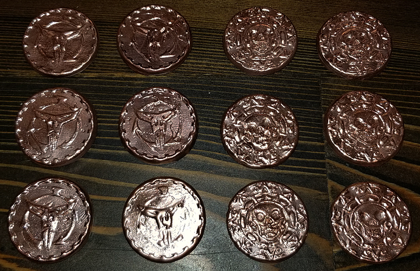

So, I also decided that I may want to make a few different versions of these. There is the basic coin version, the basic medallion version, and what I call the spinning coin version and the spinning medallion version. The "spinning" that I am referring to is two moments in the film where the gold is returned to it's place in the stone chest with the blood of the one who removed it covering the piece. (you can see a picture above on the last post that shows this) The spinning versions have two front sides, or in other words, a fully detailed skull design on both sides. I have to admit, I like this version better. It is only used in these two specific shots in the film, but I just think it's cooler, and I have no idea why. If I could, I would also LOVE to find what their fake blood mixture was and have that on there too.
This may be the nerdiest I've ever gotten about this prop, but I cant help but get giddy when I think about having a full set of coins like that. Only thing is, I'll have to figure out how to cut the back sides off of two game pieces and stick them together for molding. There's probably gonna be a lot of edge clean up too. I've also been considering selling some of these, as I want to fund more projects and I know there must be some people crazy enough to want these too. I have no idea what the price point would be though, but if it's this much work involving brass casting, gold plaiting, intricate custom chain making, and it's very accurate to the film, it might be nice to try and make a small bit to fund future projects. No solid ideas yet, though.

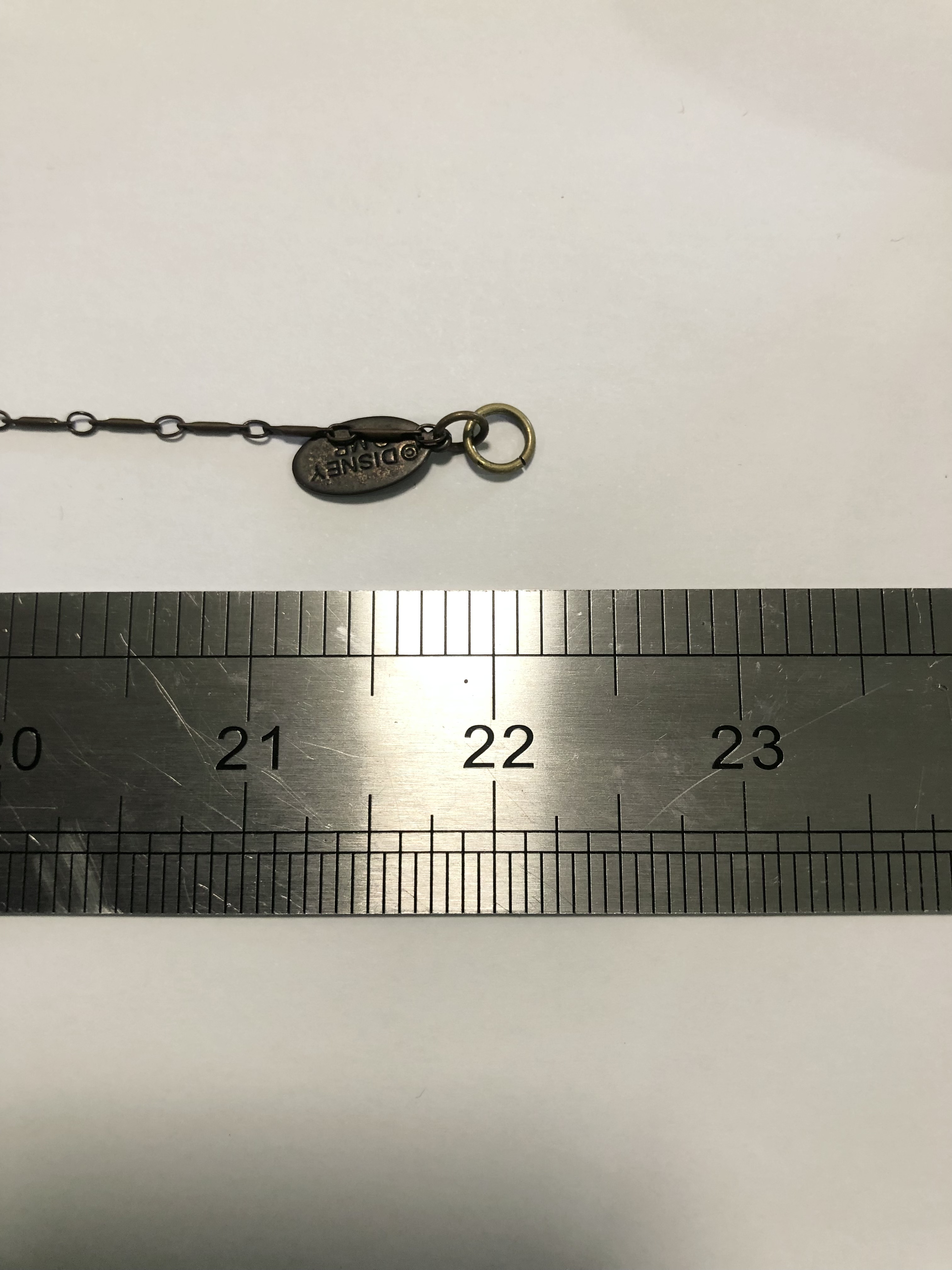

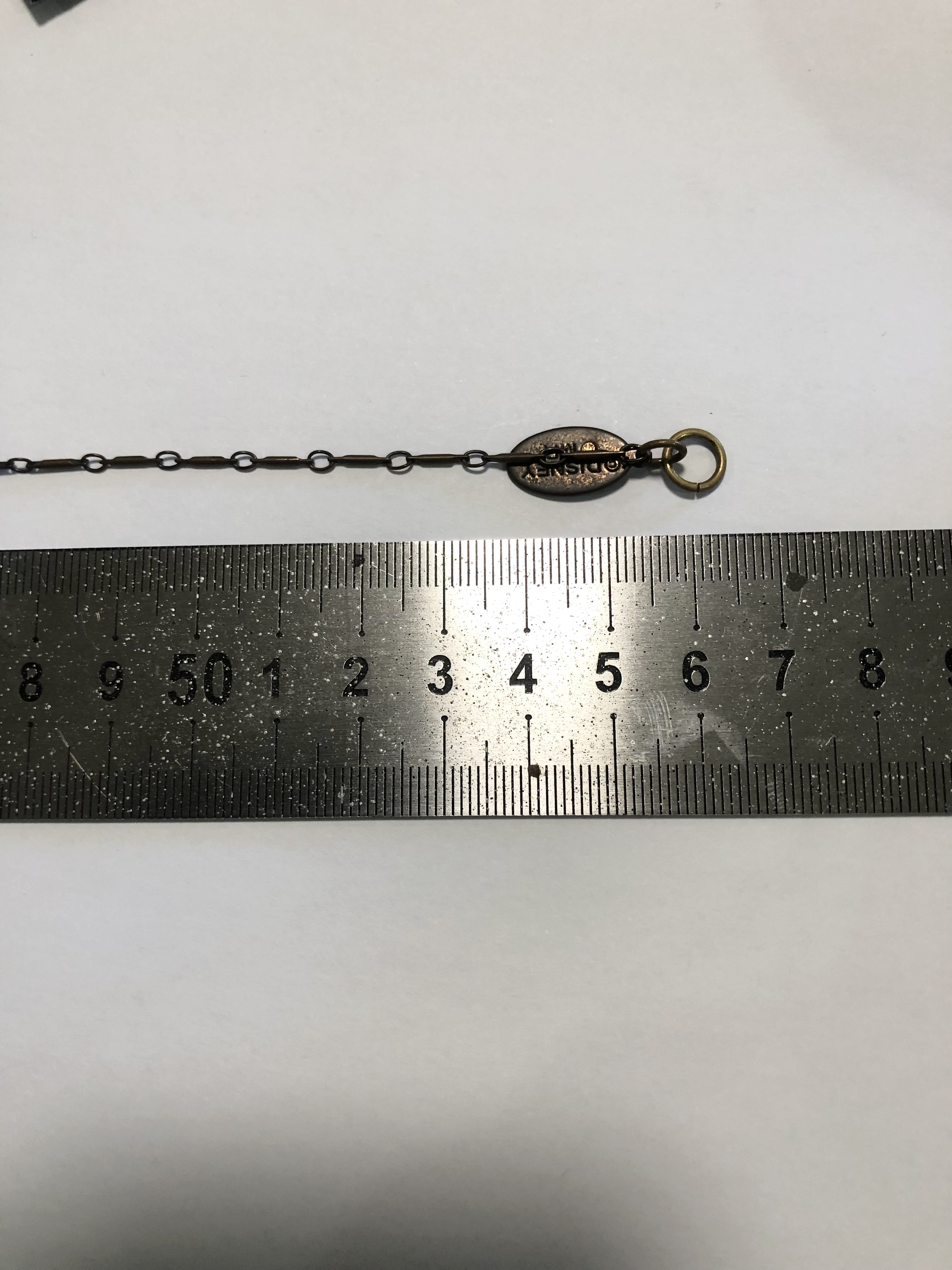

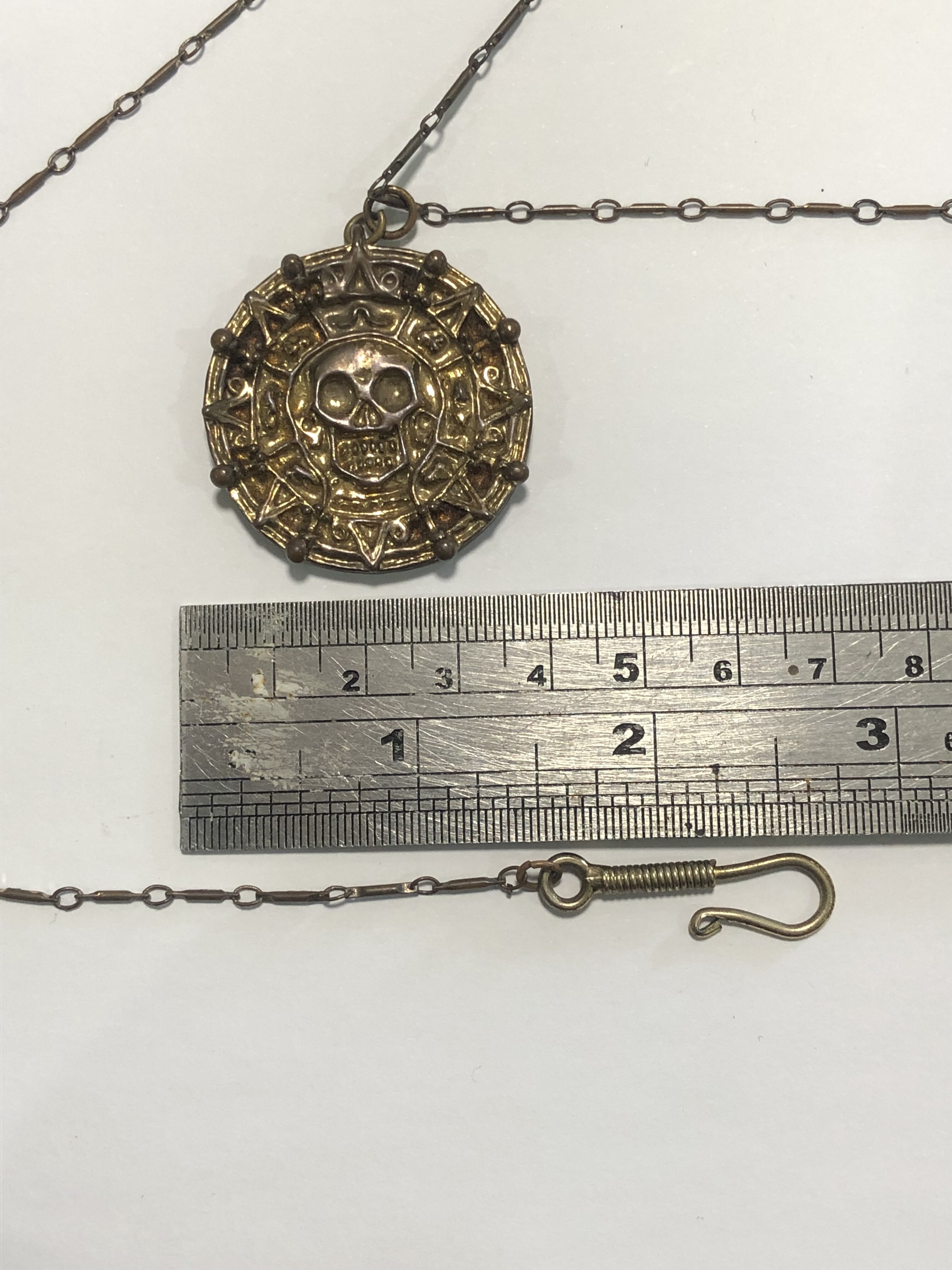

Cbstudios
willrhami ask and ye shall receive mate! Imperial and metric! Very VERY keen to see this project progress, as a Jack Sparrow cosplayer, anything Pirates is my jam!
Cbstudios
YESSSSS oh my gosh, this is so so helpful, thank you. I'll add this to my reference folder. Do you know the overall length of the chain?
I absolutely do! About 21” or 53cms excluding the hook! If you need any further measurements, don’t hesitate to hit me up!

willrhami
Member
So so helpful, thanks again! This'll be great, very excited! Hope this'll all work out, cause I NEED one of these things, if it does I need to make a fake drawer bottom to hide them in too, hahahaha!

So, thanks to the reference pictures of the Master Replicas medallion chain provided by Cbstudios, I was able to get the exact measurements and dimensions of the chain. I then spent like 3 hours trying to figure out how I would make it, using a thin brass rod, making curved indents on both sides and holes on each end to be connected by a basic chain loop, done who knows how many times. It sounded like hell. Then I literally looked up "brass bar jewelry chain" and found the exact one that would work for what I needed... Anyways, let me show you what I'm talking about.

I don't know about what other people think, but to me, this looks SPOT ON. The dimensions do perfectly match the chain on the Master Replicas one, which matches the screen used one very very well, which is great and leads me to believe this is a pretty good match, or maybe even an exact one, but I won't say that without any real evidence. To get a 25 foot roll of this chain it's $85, and if I am selling these, that's a good deal, that's enough for a solid run of medallions. But if I'm not, it's probably not a super swell idea to spend that much and only use like, 2 feet of it. The chan is gold plated, but I have no idea if that means it's real gold or that it's just gold like, but there is brass underneath, which I see as the important part.
I saw from a bunch of people saying that over the years their Master Replicas' chains are beginning to turn brown, which makes me think this is either a bad gold plate or just aging brass, and brass can be re polished, but I don't know if a gold plate can. (Something to look into) I'm personally ok with a re polish every 5-10 years, but I wouldn't want the browning to occur then touch it to a polishing wheel and see raw silver or bronze underneath. I would assume the production team used brass as a base for the coins so they could escape the riggers and cost of casting with real gold and if it chipped or scratched, it would still look correct underneath and still match the color a bit. I can only hope that's the same idea this chain follows. Anyway, moving on.
The clasp is a part that could potentially be a bit challenging, but seems somewhat straight forward, not a lot of hidden mechanisms or surprise skills needed, and would probably be hand made by me. (you can see the clasp in the Master Replicas' picture above) I would also potentially like to do a magnetic or friction fit clasp on one of the chains to be able to rip it off like we see several times throughout the movie. I personally think it would be super fun to have that on the spinning medallion version, as in that scene Barbosa rips it off Elizabeth's neck, and everything about that scene just gives me the goosebumps. The speech he gives about restoring the humanity of the crew, the way he rips the medallion off and puts it in her hand, the score building as that happens, and as he lifts her fingers and lets the medallion fall back into the chest we get that GREAT shot of it falling, it's iconic. Sorry, moving on. I also found the material I might want to cast the coins out of.

I was extremely lucky to have a friend in the prop industry that knew the original coin maker and sold a few from them close after release of the first movie. They were cast and aged like the screen used coin by the original maker. Some of the patina has rubbed off on the front of the coin over the years. The chain came from a guy here on the RPF 15+ years ago that did a limited run. I was also in jewelry school around the same time and in molding class I molded it and cast several sterling silver coins for some friends, what was neat was they ended up just about 1oz each in sterling silver! I only have one silver one left.

That chain you've found looks pretty spot on dude! I can confirm the chain on the MR piece is plated, and the plating on my coin and chain is breaking down hardcore, giving that aformentioned browning
Jeff
Wow, that’s an incredible piece of work, I’m super impressed. Very well done, thanks for sharing. It’s good to see what others have done with the same basic idea to see how I can build off that and learn from it. Thanks again!
