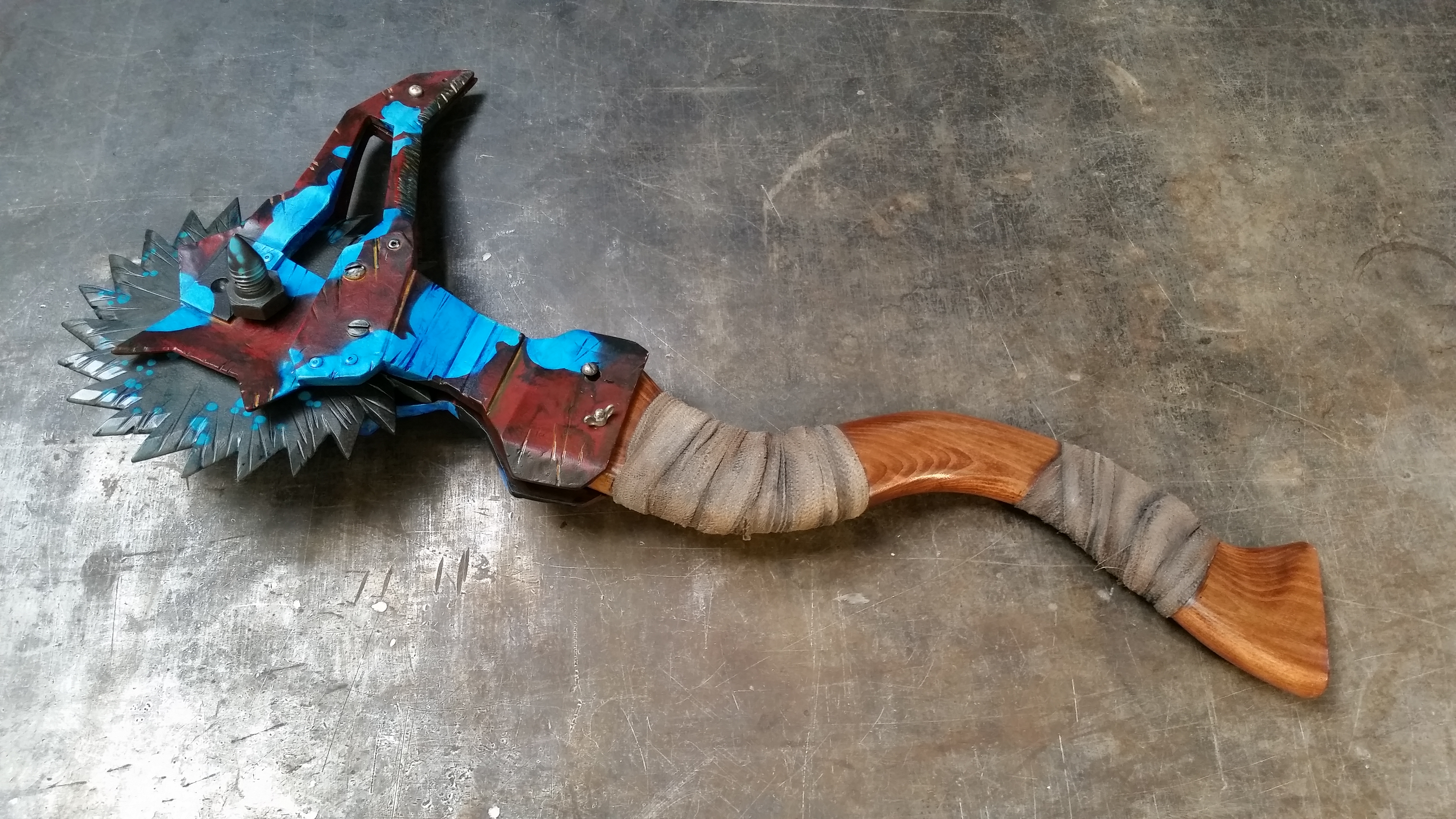

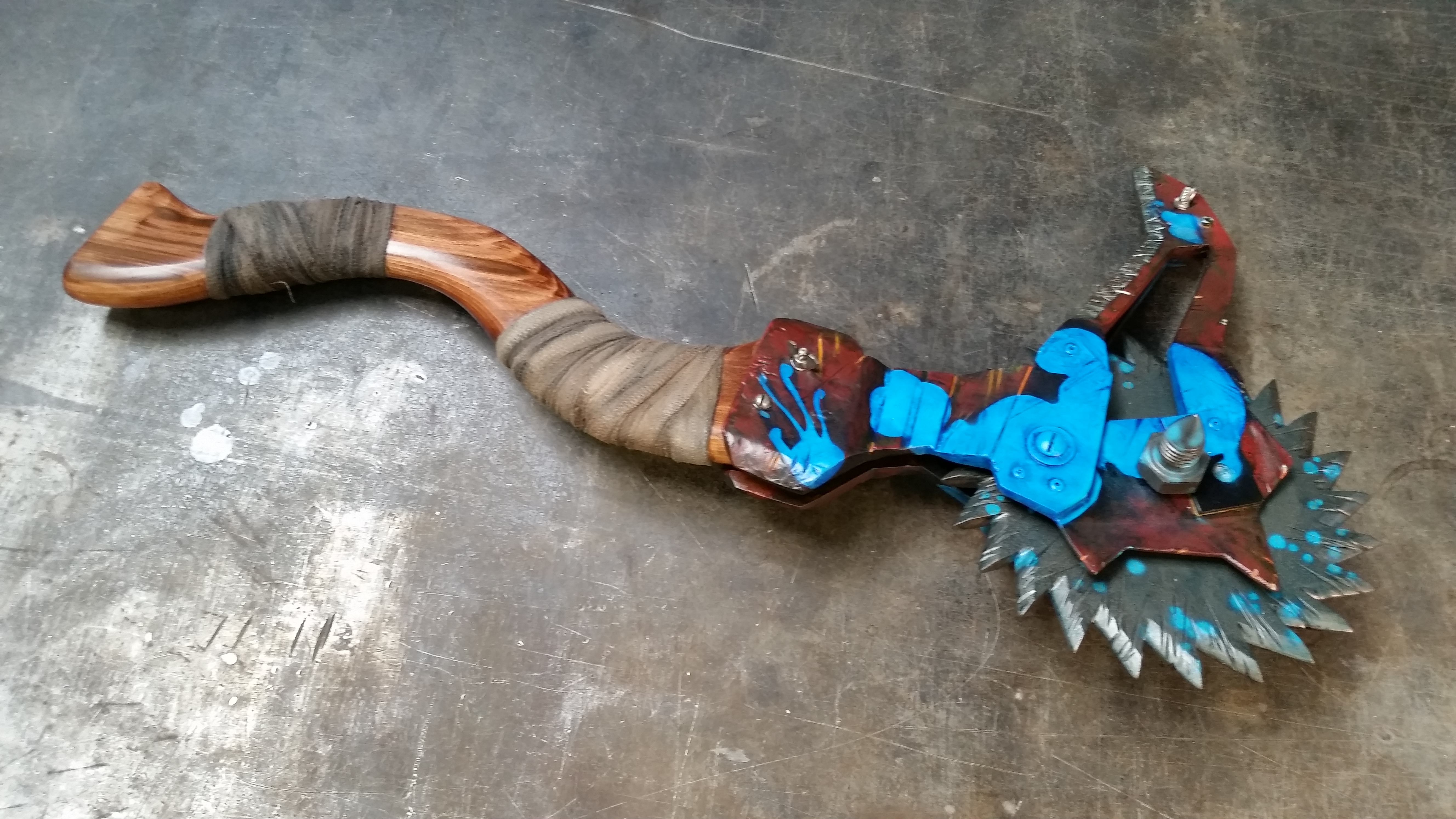

Here is a bit of a better write up on my final process:
I added the mismatched "toxic aqua" color splatterns with the aid of some frisket and delicate hands. In this photo I had barely applied the first layer of weathering to the new color.
After some extra detail sanding and shaping I gave the handles a nice coat of chestnut colored stain to bring out the natural beauty of the wood. I then topped that all off with two coats of matte clear lacquer and a top coat of Permalac matte.
The wrap detail is done with actual bandages adhered to the handle and weathered with a series of acrylic washes. This too gets another layer of clear lacquer to seal the deal. I made a repeatable template to add the splatter detail to the blade and hardware and weathered them accordingly. With all the little ends worked out I took some shots of the finished parts disassembled...
... and fully assembled before delivering unit 01 to my client.
The total length is around 28" (71 cm) and the weight is right at 5 lbs (2 kilo).
