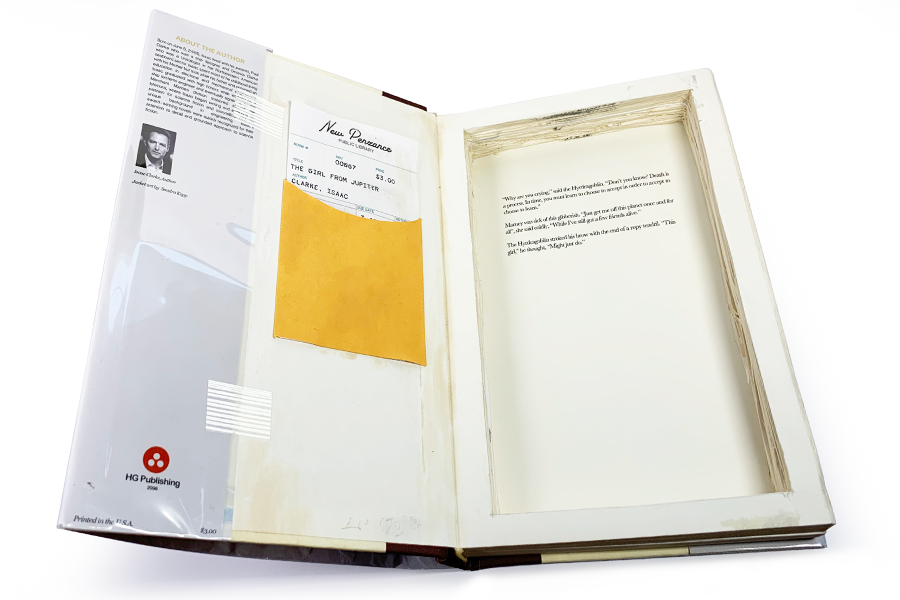

For the book itself I sacrificed a copy of "The last gunfight" by Jeff Guinn as it seemed to be a close match in size and color to the prop - which I immediately gutted (sorry Jeff) as my plan for this is to create a book box since I'm not about to write a novel.
Once the interior was hollowed out I clamped the book together and glued the interior and exterior pages together to form the box.
Once the glue was dry I glued in a page at the end with an excerpt from the book pulled from the deleted scene mentioned earlier.
I wrapped the spine in some burgundy fabric tape which covered the title of the original book and was also a better match on color to the screen-used prop. This stuff is really satisfying to work with.
With the structure of the book done I moved onto printing the cover. After a bit of trial and error I got a good fit.
The last step was adding some finishing details and some weathering. In the film the books are library books that Susie has kept so I included a library checkout card and some stickers to give it a bit more authenticity.
After some final assembly and weathering, it was done!
I had a lot of fun with this one - thanks for checking it out!

So trying to fill in the dates on the check out card - Do you know the fonts you used on those?
2 fonts, the first two dates are a font called Loma. The third date is Typewriter-regular.
I also ended up using the eraser tool to rough them up a little bit and make the numbers a little more inconsistent like they would have been if they were actually stamped.
