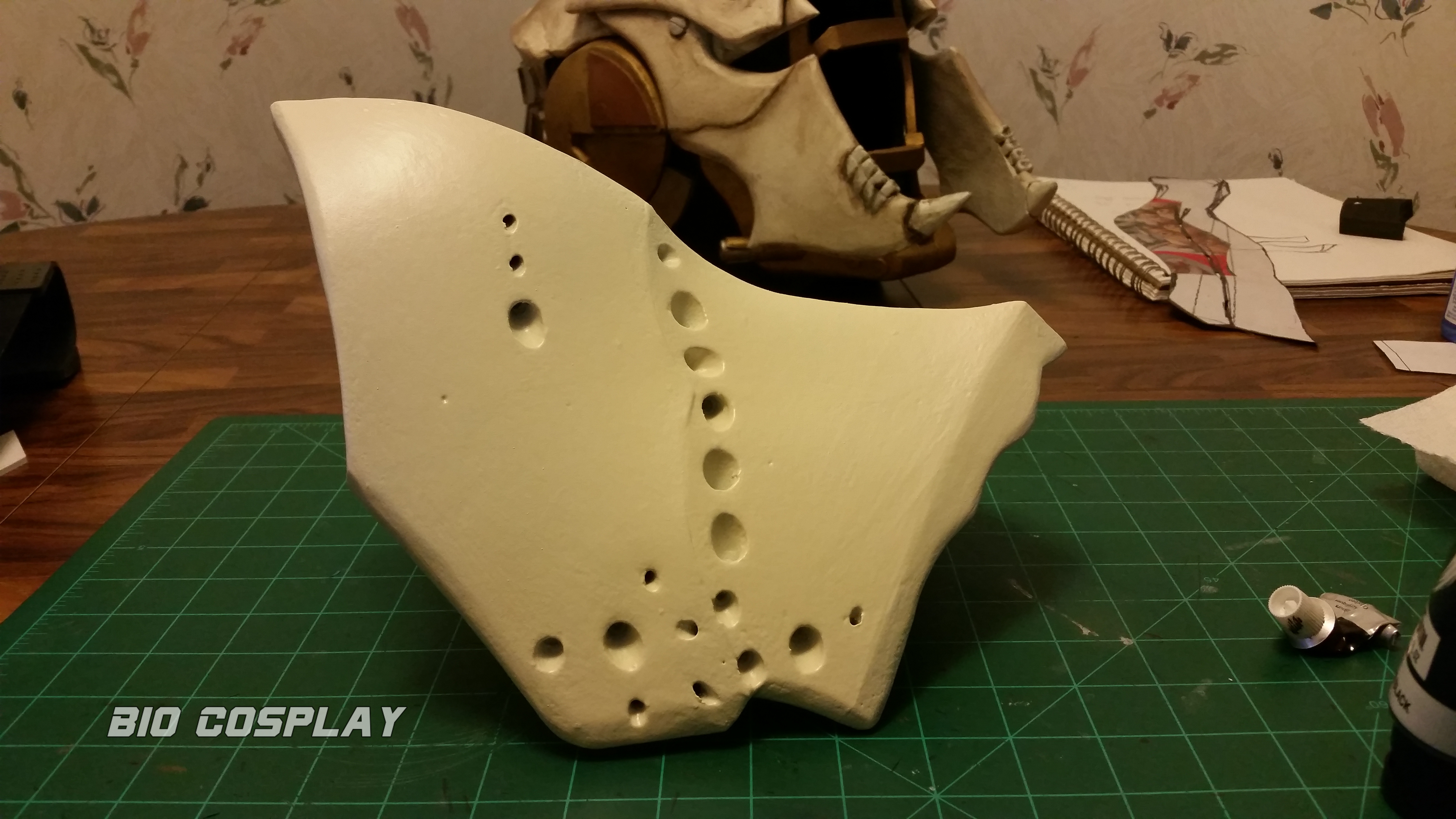

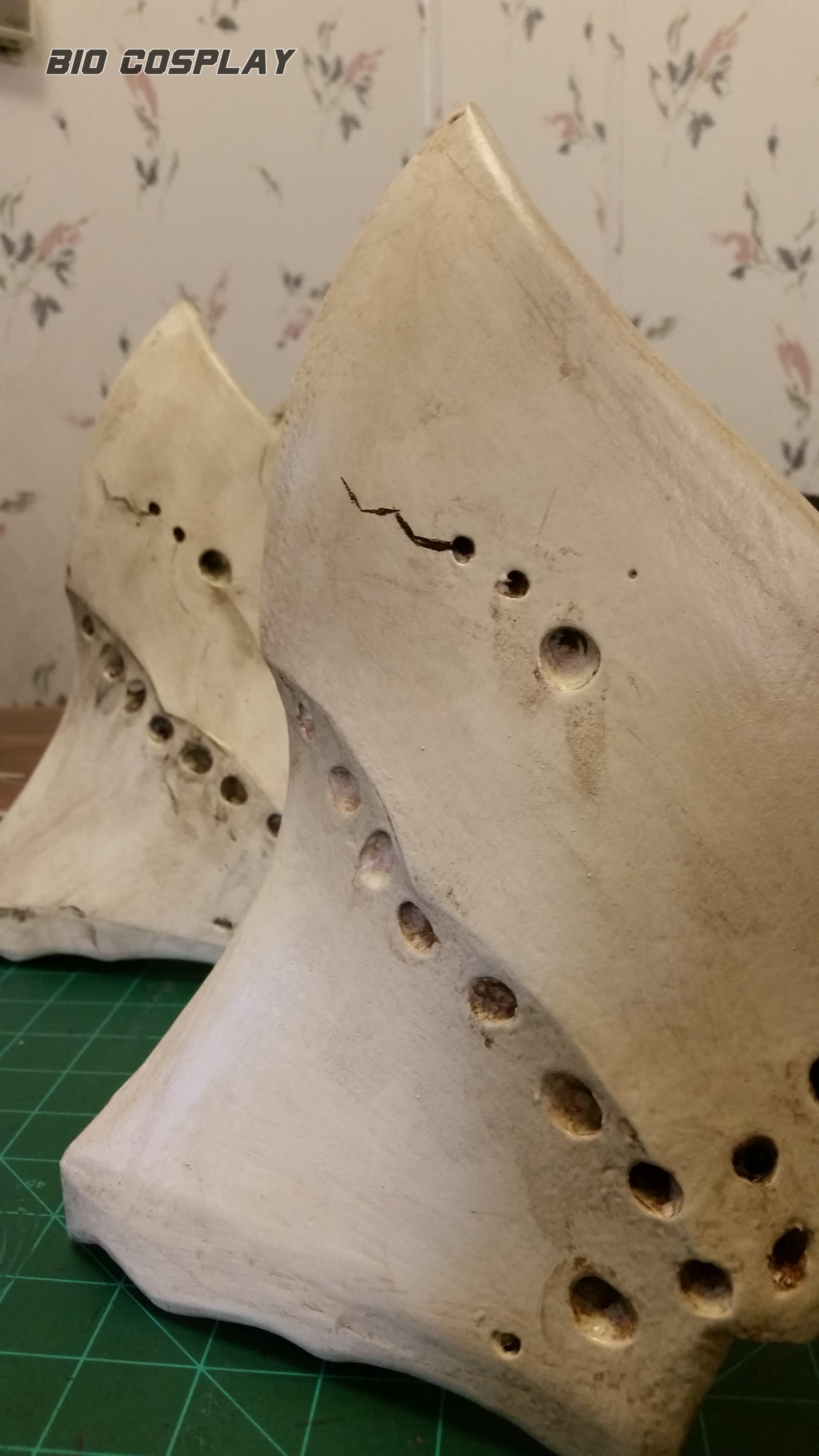

    To start out, I used a base coat of an off-white spray-paint (pic 1.) I believe the brand I used is Valspar? But any off white paint should do. 1-1 unpainted with watermark.jpg

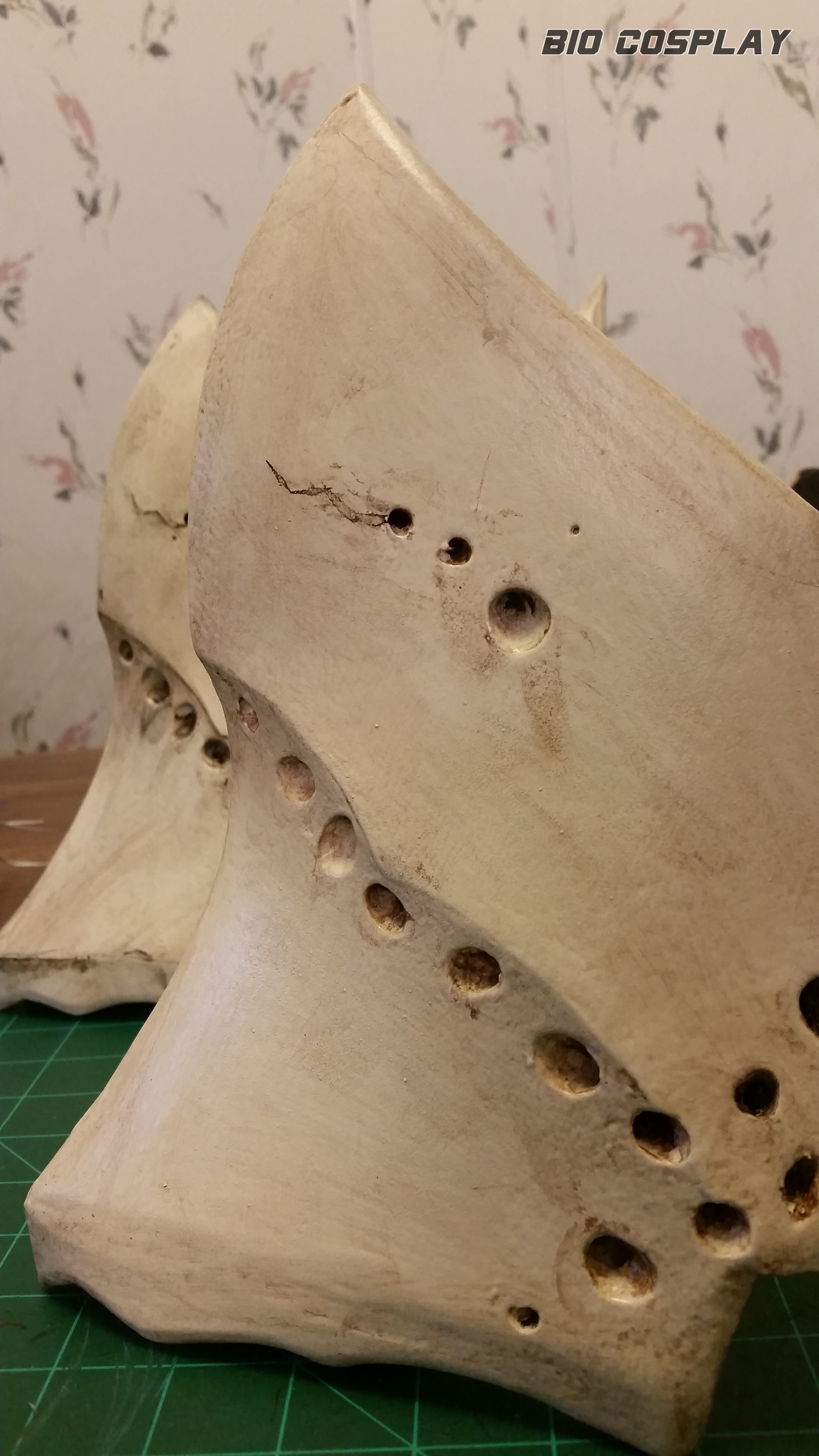

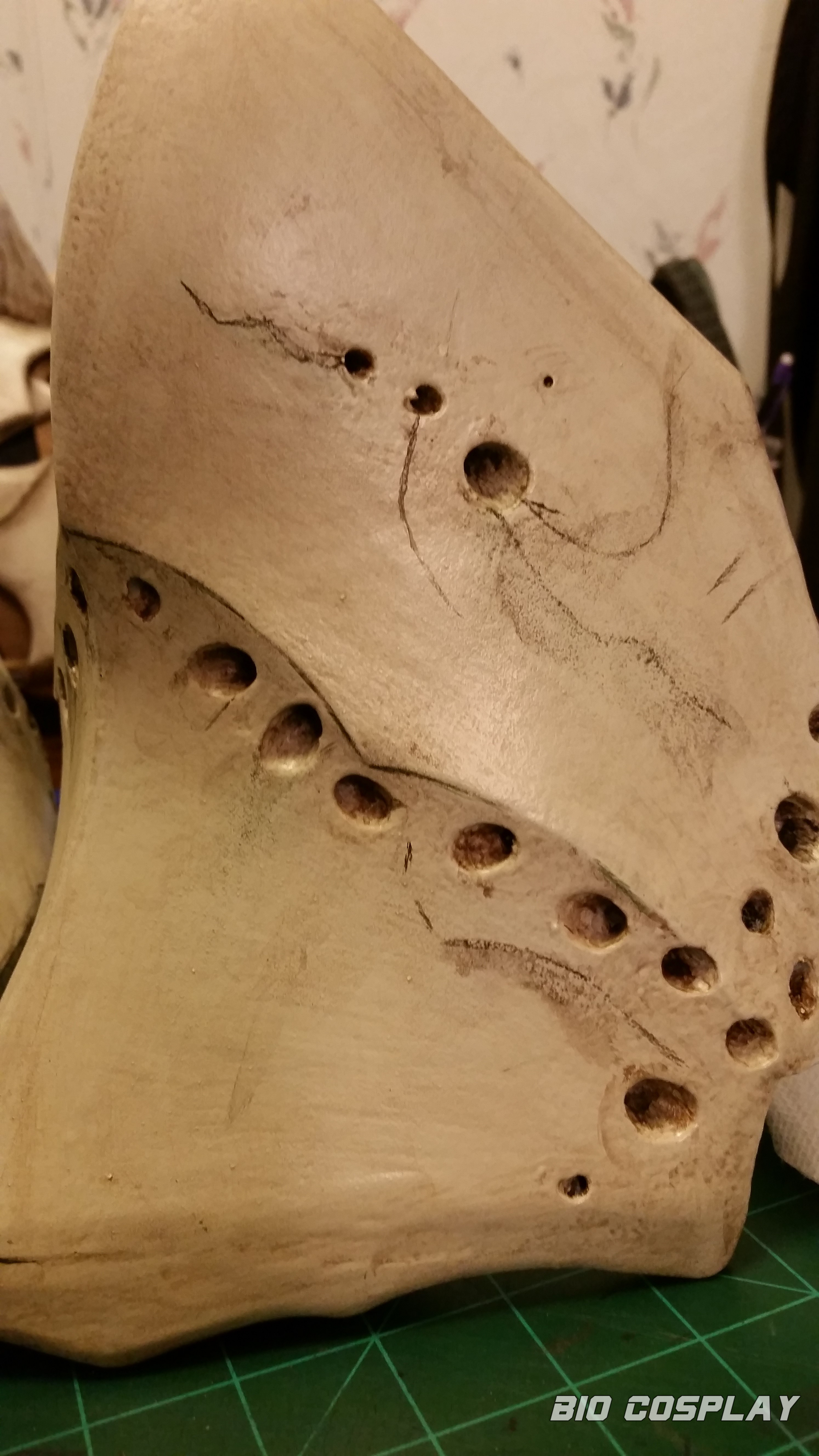

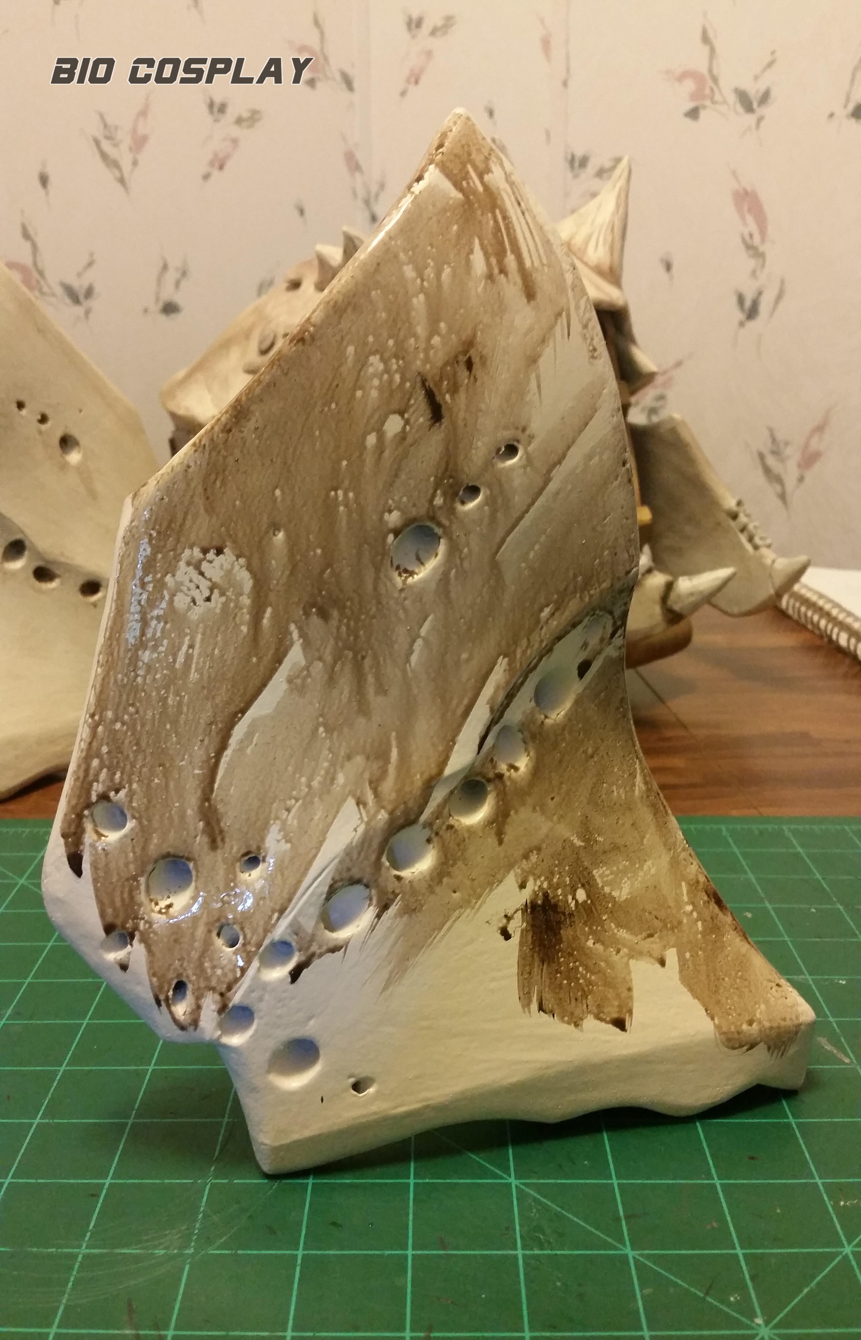

    Next I went over that with a brown wash (pic 2). To make my wash, I just mixed some brown and a little bit of black acrylic paint to get a dark muddy brown, then added water. This was brushed on and then wiped off with a paper towel. This just makes the white a little more brown and gives it a bit of depth (pic 3 and 4).
    1-2 brown wash with watermark.jpg 1-3 wash wiped off with watermark.jpg 1-4 wash vs clean comparrison with watermark.jpg

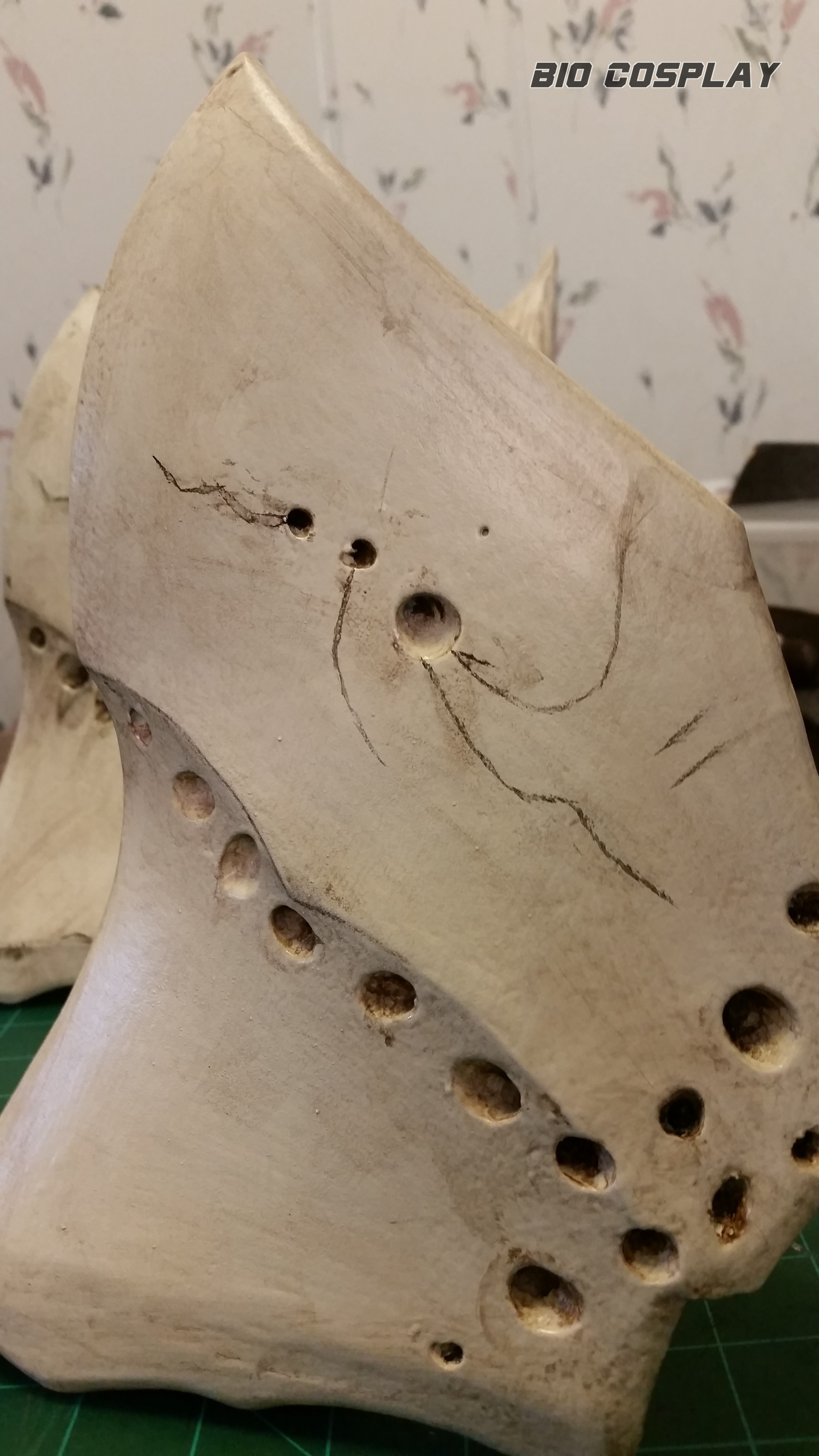

    Now it’s time to start on the details! For the details I use dark brown, light brown, and olive green acrylic. I just mixed brown/black/green/burnt sienna to get the shades I liked. I start by painting in detail lines with the dark brown. These lines are either cracks, edges, shaded sections. Paint on your detail line (pic 5), then wipe it off! Some of the paint should stick and look like a faded broken line (pic 6). Continue to paint your lines! (pic 7 and 8) Always reference pictures for what you’re trying to make, it helps.
    1-5 detailed painted on with watermark.jpg 1-6 detail line smudged off with watermark.jpg 1-7 more details with watermark.jpg 1-8 more details with watermark.jpg

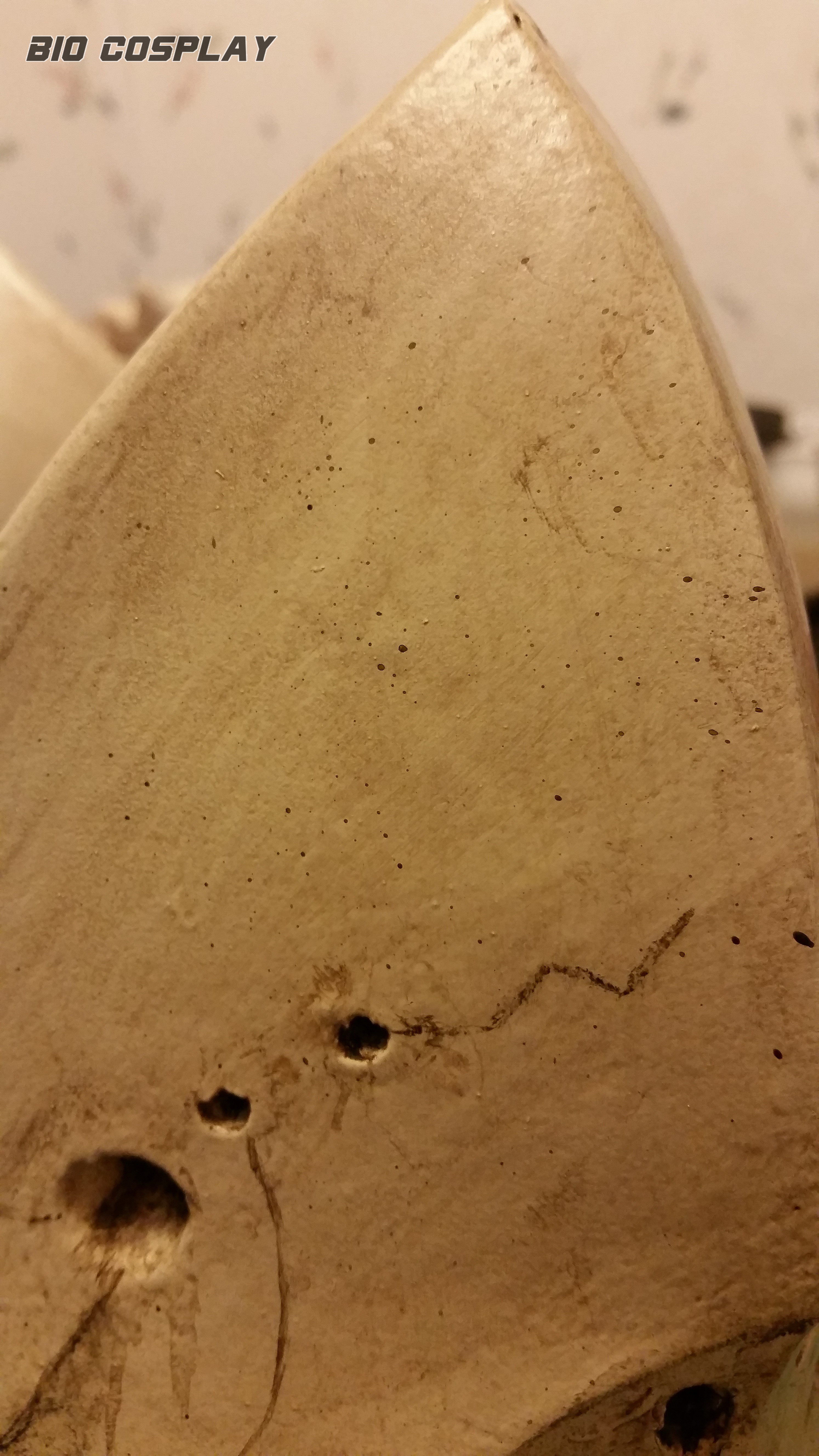

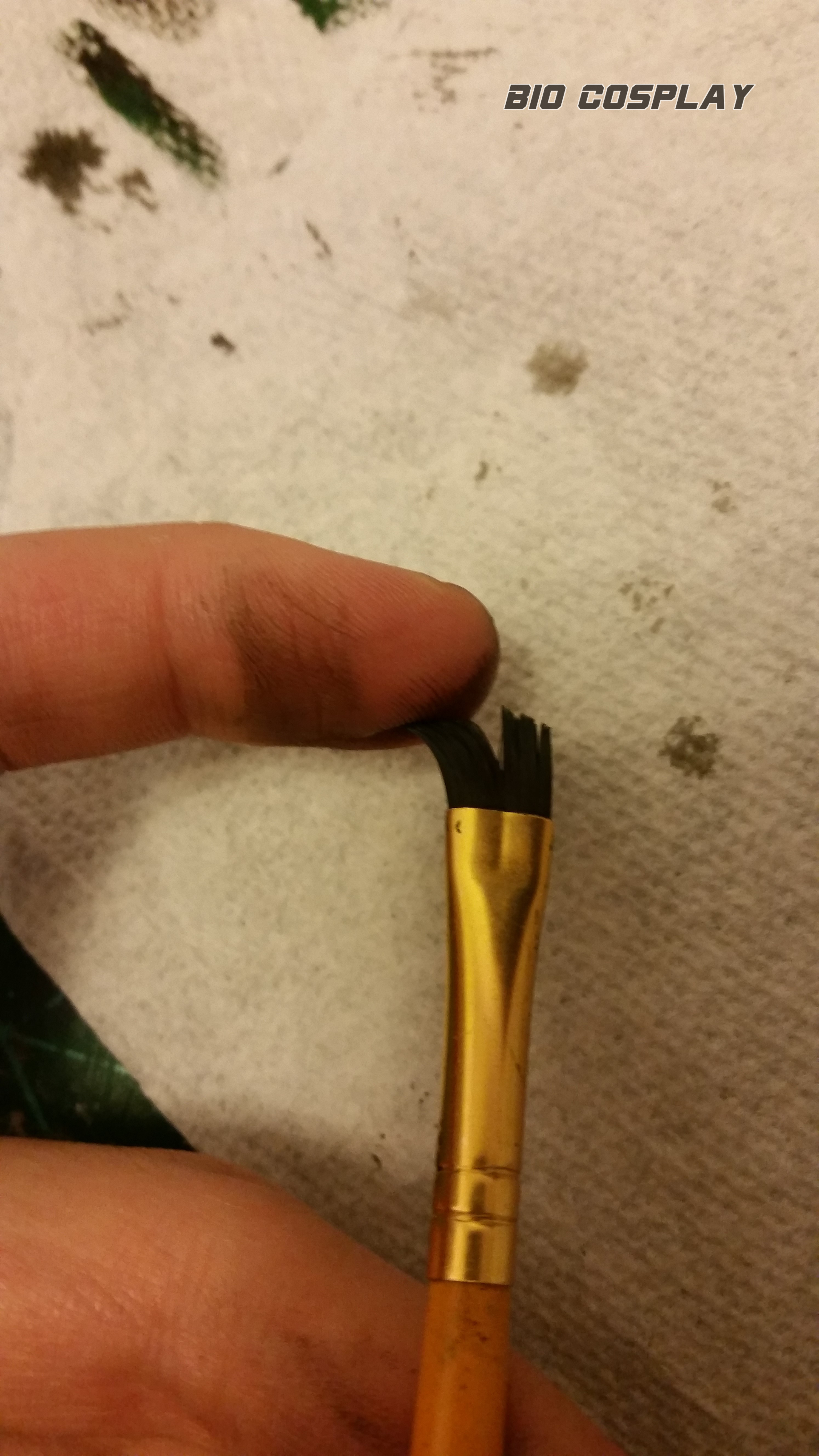

    After my detail lines are there I begin to do some shading. To do this, I dry brush layers of dark brown, light brown, and green. For dry brushing, get some paint on your brush, wipe most of it off on a paper towel. Usually I’ll put down the dark brown then lightly do some green, and finally light brown to highlight the dark brown and tone down the green. I will also sporadically go over my details with green and dark brown to give them a bit more depth (you can see the start of this in pic 9 and more in pic 10). Mainly, you want quite a few layers with varying colors. The layers will help give it more depth.

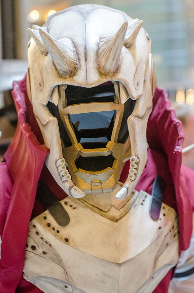

    11987055_10102270215986172_3804186672136742160_n.jpg 11822531_10102270216061022_463003818323120663_n.jpg (these two photos taken by Matthew Hale)
