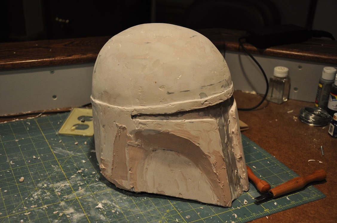

Well, I have been busy, not much time to update. I got the fiberglass working when I put a space heater in the room with it. I have also applied and started sanding the bondo filler on the outside. As you can see, I have sanded into the paper in a couple places. The only two ways I see to fix this is to go farther and then build it up again with bondo so that there is no paper showing, or to build up the rest of the dome, so I don't have to go into the paper. I am leaning toward going too far into the paper and building back up with filler. The inside still smells like resin, so I might put filler in there too. Here are the pics:
Yeah, I was thinking I needed less bondo, but it was kinda hard since it's so thick. As to the sander, I'm currently using my palm sander with 80 grit paper, and it's working fine. Should this be taking a whole quart-ish sized can of filler? Because I am pretty close to the bottom of mine.

I've used a palm sander with 120 grit, worked well also
I've used approx. 1,2 kg of bondo on my whole Stormtrooper helmet, and 110 gr of Milliput, (before sanding)

I've run into the same trouble sanding through the pep to get the right shape, it may be a problem if the paper gets wet and swell.

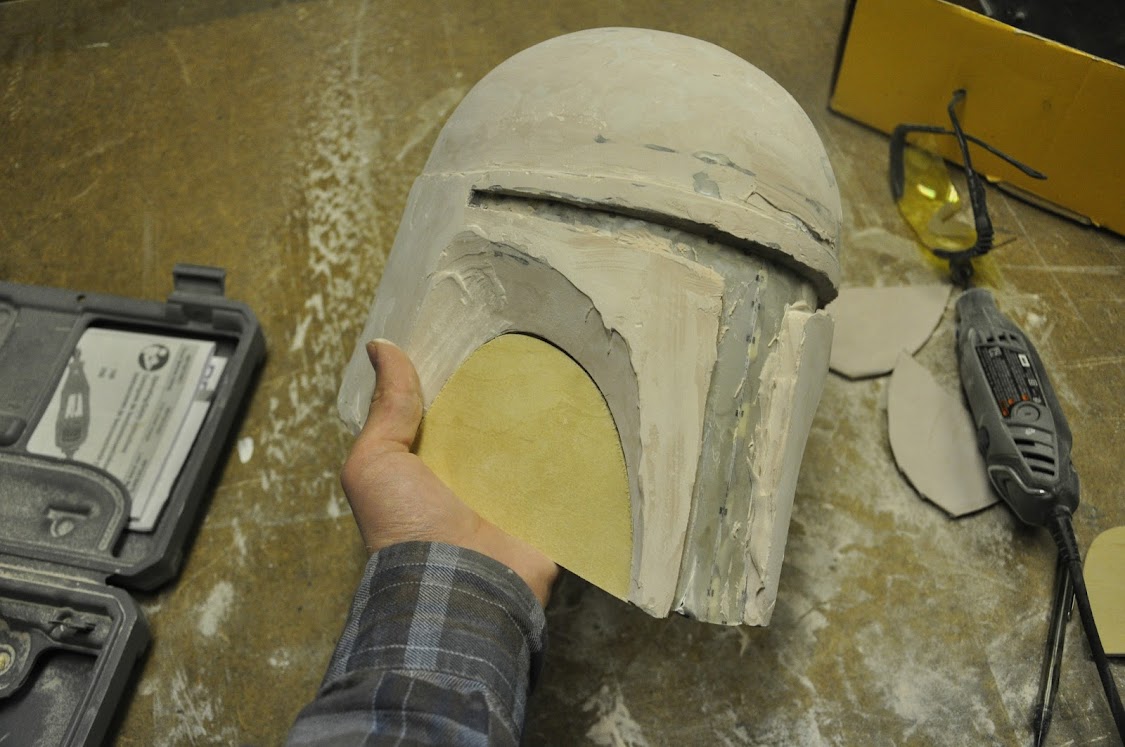

Well, I decided that the cheek pieces were not going to work the way I was doing them, so I cut out the lower cheeks, and made some wooden ones. I did this for several reasons: 1) it allowed me to get the shape of the cheek much closer to accurate, 2) it made it a helluva lot easier to shape the upper cheeks (black parts on the painted helm) and 3) the lower cheeks are sure to be perfectly flat. Any comments on the mandible/cheek shaping so far? Also, how thick should the 'hatband' be in relation to the dome? I am thinking of taking it completely off and making it out of something else, but that will be later. Anyhow, here are the pics:
You should have used multiple thin layers of bondo. Another thing is that you should sand it untill you see the seams of the paper (on the first and second layer at least. That way you ensure the roundness of the the shape you want to obtain. In other words you control much better what is round and what is sharp.
I used more than a can of bondo (more than 1,5Kg) on my trooper build so far.
Don't coat the inside you wont need to unless you have spots where the fiberglass isn't attached to the paper. And even so, I see you cut out the cheeks (best thing to do when its plain wrong) so I'm guessing this wont be for you to use on.
Its a good job!

Thanks for the feedback! As to the thin layers, I'll chalk it up to a learning experience. Maybe next time it will be easier. I wasn't using the paper as a reference point so much as a framework to hold my bondo. Perhaps not the best plan... The cheeks are a much better shape now though.

But good thinking with the cheeks. Way better than scrapping it when things start to get screwy.
You may want to build up the flare on the bottom. Right now it's a tad narrow while Fett's helmet is known for that wide bottom.

If you mean the distance between the bottom of the ears, I had noticed that, but I don't know how else to fix it other than a lot more bondo. Anyone have measurements of that distance, not including the actual ears?

Yeah basically the bottom of the ears to the bottom of the chin. Ill take some measurements of my bucket for you when I get home :)

Thanks! It looks to me as though I need to add another 1/4 or 3/8 of an inch of material. Do you think I will need to redo the placement of the inner cheeks after the ears are fixed? The distance between the inner cheek and ear might be to great after I fix the angle.

Thanks! As to accuracy, the only thing I noticed was that the visor slot goes too far to the left and right. Too close to the ears. At least that's what it looks like to me.
