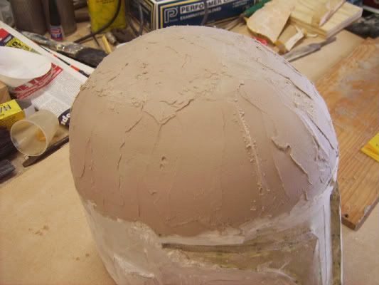

yeah looks on track to me rosskow the first bondo coat is always as "ruff as a badgers arse" but with each sand/apply it gets smoother and smoother.
id not try sand what you have in the above photos perfectly smooth just yet, sand it down a bit obviously so it feels a bit smoother but don't attempt to remove all the pits, leave those for the second coat of bondo to fill. i found myself sanding right down to the paper at some corners and it proved a pain later on in the build.
with each coat/sand it gets smoother and smoother, eliminating more and more pits in the the surface.
if it were my build id probably cut the visor area out just now so i could bondo it on the edges and then be able to shape the edges and eye slants with my sand paper/file. would probably help getting a better clean edge than trying to sand one into a shallow area. just a thought tho.
really wanna see this sanded down and smooth :eek:P should be a good one!

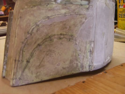

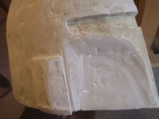

well after cutting and hacking at the crumbly/tacky bondo i got most of it off, the, it was mainly the left cheek and the back that was suffering from my poor workmanship.
i think i've got the majority of it sorted out though. as i've been sanding it i didnt feel i did much at all untill i looked at the previous pictures i had of it from the morning, so...
day 7
started off with cutting at it with a knife, peeling it like an apple to get all the soft bits. it wasn't really soft, but i will defonetly need to change my ratio looking at your diagram terra1, thank you for that, your right about the instruction on the tin, bloody awful
tried give a bit of shape the ear bit and cheek on the right side
still need to tackle the left cheek and ear
even though my bondo-ing was a rather big fail! im still hapyp with how its going, got to stay optimistic :)
thank you for your help and advice everyone

day 8
only a small update, tore pretty much the whole of the right cheek off, since it was like a dogs back-side, have to re-do that at a later date
sanded down the dome more and added some filler, think i for the ratio correct this time, feel tougher after half an hour than the right cheek did after 36 hours.
went on alot smoother this time as well, an old credit card works wonders along with the correctly mixed filler, great advice, thank you

that looks a lot smoother mate, sure makes a big difference when it comes to sanding :), you'll soon find that you don't even need to think about how much hardener your adding.
got some old cards in my drawer might give that trick a try in a minute (when i've got a quick 2 hr session :))
Re: pepafett (boba fett pepakura attempt)
yip filler looking loads better! hows it feeling now? it set nicely?
