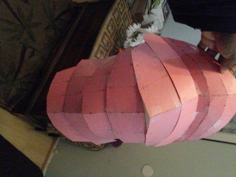

rsz_1rsz_11rsz_pep_helm.jpg modeled

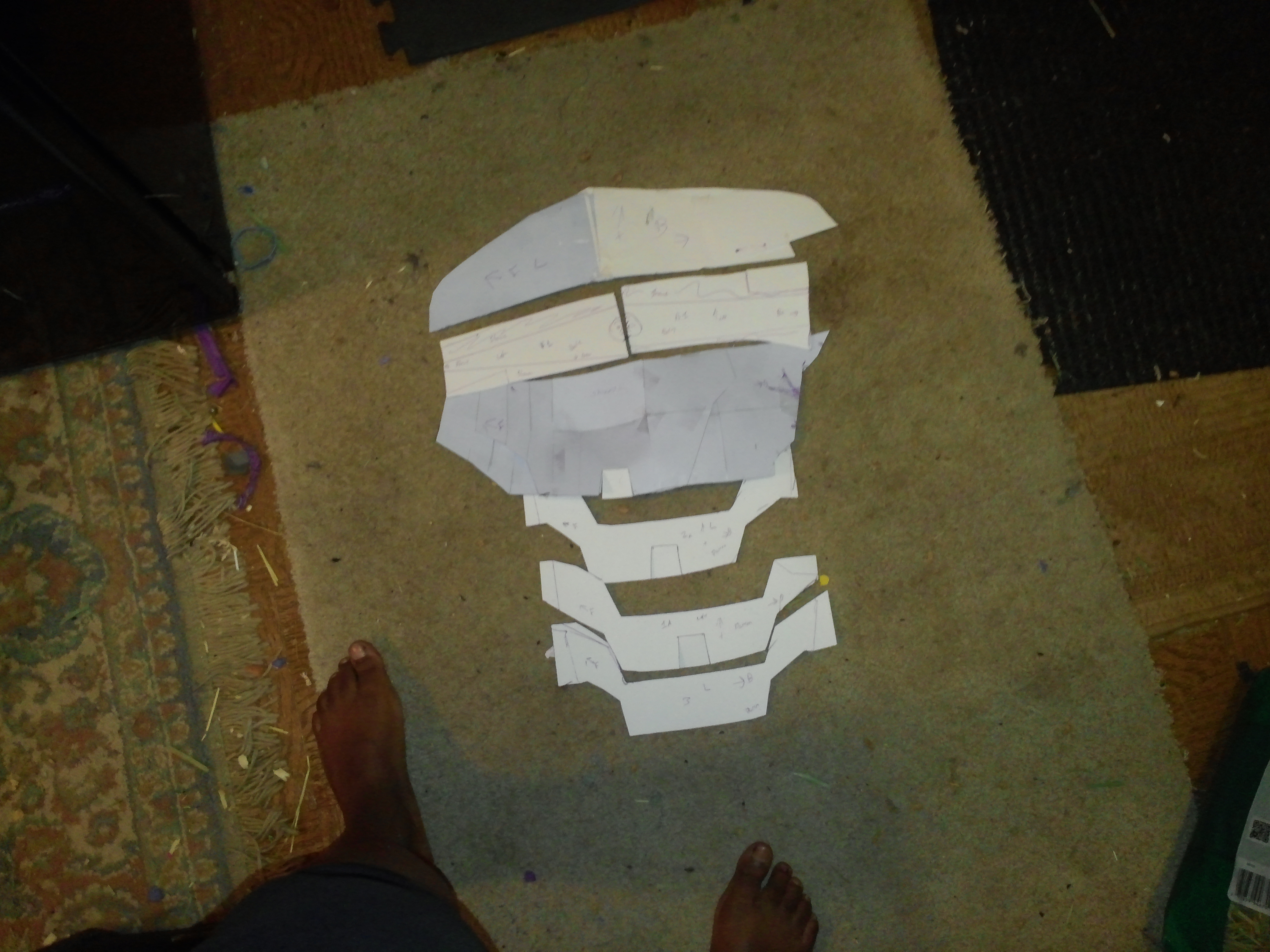

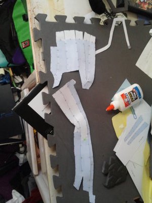

rsz_1rsz_pep_helm_2_foam_template.jpg cut the model to use as foam templates (your pep should be 1/2 in 1 bigger than your measurements so it will fit)

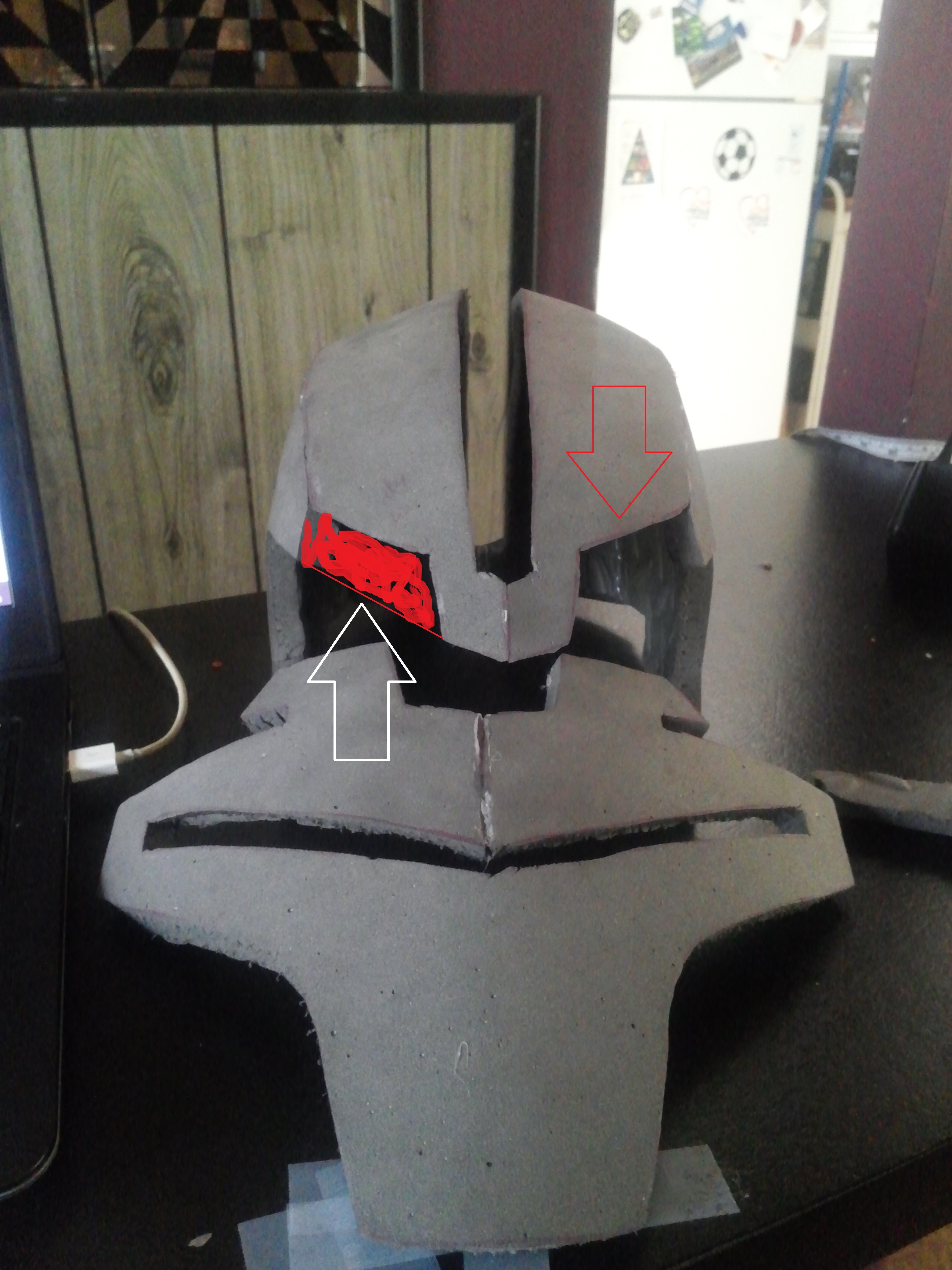

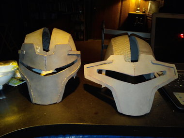

rsz_1rsz_pep_helm_test_model_1.jpg made a test model on some foam I bought for cheap to figure out if the pep would cleanly transfer to foam; it didn't, the cut-outs for the face plate leave you no place to attach it to the helmet. I extended the place where it cuts out for the "eyebrows" on my final model down to where it dips just above your nose to fix the issue foam helm eyebrows arrows.jpg (pep will give you the red arrow side, extend it down to where the white arrow is pointing)

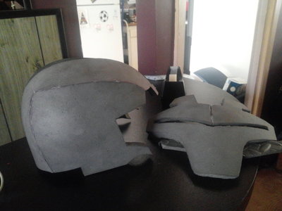

rsz_2helm_1_&_2.jpg test on left, and final model on right. I'm leaving the middle open so I can wear ti with my mohawk but I have the middle spine just in case. Lastly I'm still puzzling out how to make the respirators; when I know you'll know

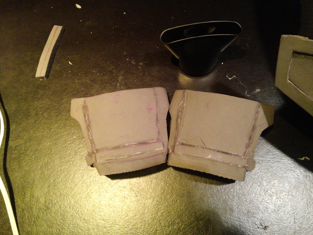

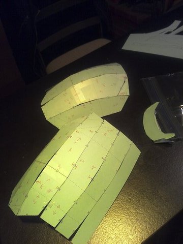

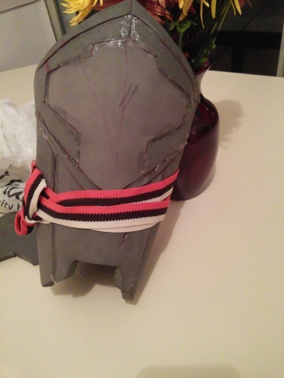

Shoulders were pepped rsz_message_1415555750161.jpgand as expected I nailed the test model rsz_nailed_it_shoulder.jpg
I'm joking it, it was not positive so I whipped out the dremel and sanded down the edges and things improved drastically.
Things you need to know: 1. BEVEL your edges on the bottom where you need them to over hang
2. Just get a dremel. You need 1 sanding tip and 1 cutting tip it will save you so much frustration

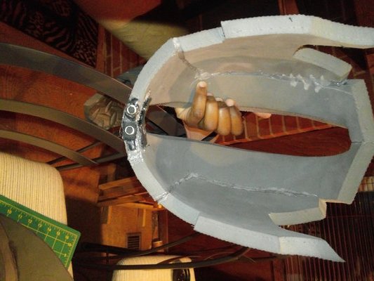

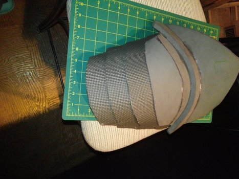

Thanksgiving put things on hold; though over the weekend I managed to get the other shoulder finished and started on the shin armor. I rescaled and pepped it but my calved are bigger than the symmetry of the 3d model permits (aka, if the shin is wide enough it's way too long or if it's the right length it won't close in the back) so I free handed some extra strips for the back. rsz_1rsz_shin_pep_2.jpg
This is the finished model rsz_1rsz_1rsz_message_1417565944528.jpg but it came out looking very flat. I plan to re-do later today and should end up with something like the one's found here http://www.therpf.com/f24/mass-effect-2-blood-dragon-build-112958/.
The mistake I made was that I wasn't really sure how far to stagger the knee pad. I also couldn't figure out which edges to bevel and which to just cut straight. Looking at the reference images found everywhere on google, what I made is exactly what it would look like in the real world following the game model but games and real life don't always see eye to eye. It's lacking the "finished" look we all go for, so remake pending... I'll be adding elastic straps and snap closures to secure it in the back like I did my helm for easier wear. I'll let you all know how it goes.

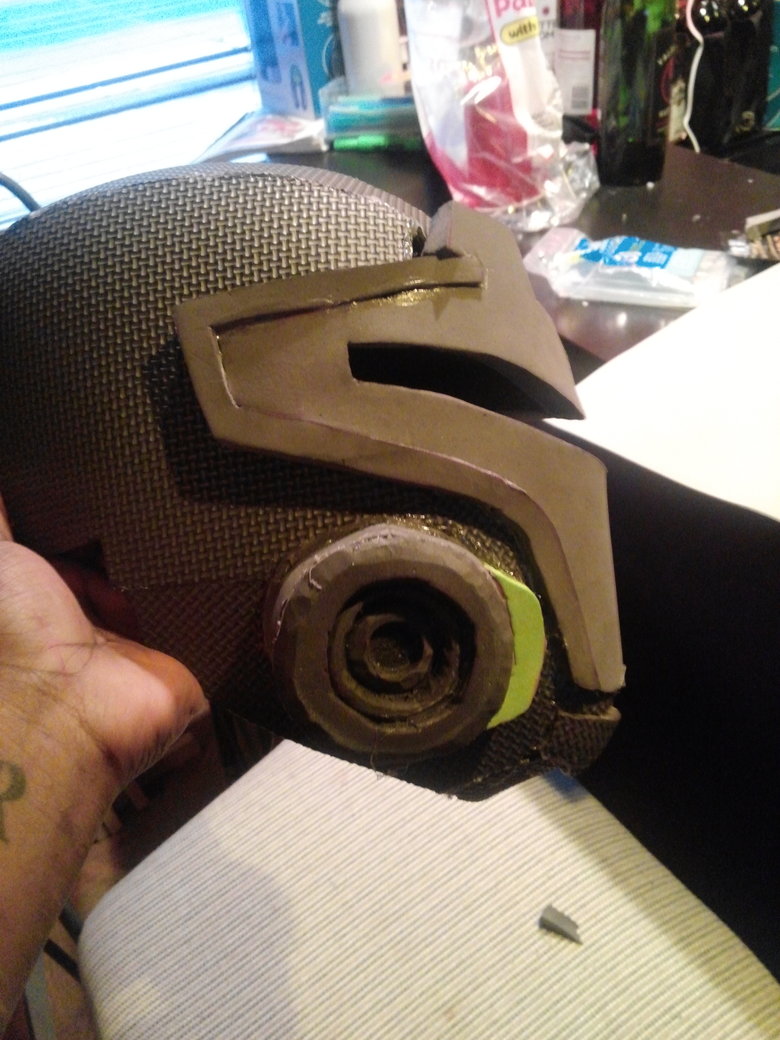

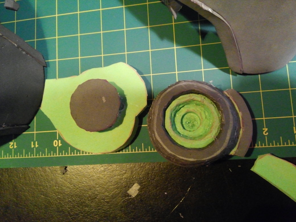

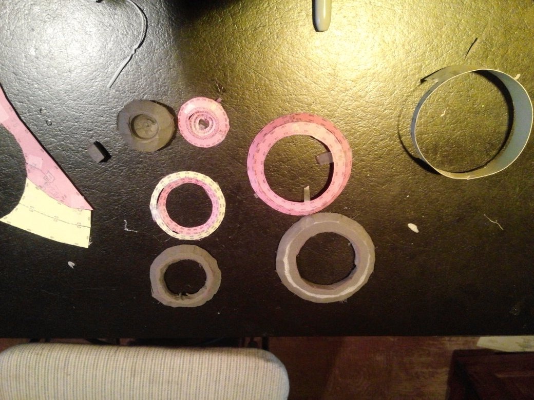

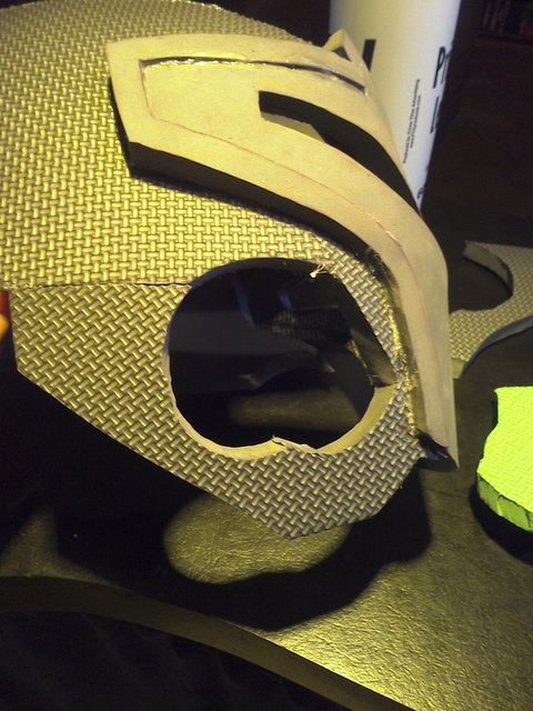

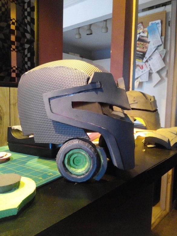

I ended up free handing the respirators by taking the outer 3 rings from the pep file, drawing, cutting, then sanding my 10mm foam into 3 4/5mm hollow cones; then glued them together and set them inside another piece of foam cut from the pep to be the outer casing of the breather. From there I pepped and cut out the lower portion of the helmet and kept the excess portion and glued a circular piece of foam to it to set inside the respirator to create the offset look for them and it made it easier to mount later. I bought a piece of accrylic and plan on building the lighting system later this week to complete the last aesthetic edit to the helmet before sealing it with plastidip and painting it. rsz_20141217_151833.jpg rsz_20141217_141700.jpg rsz_1rsz_20141217_155945.jpg rsz_img_20141223_133147.jpgrsz_20141223_153926.jpg

The shins need a lot of editing if your proportions don't match the ones in the pep file, if you need help with yours just message me and I'll go into detail about it but for this post, just know that it's a pain. Here's the shin. Build the to and bottom separately because the pep file for the knee is too small in relation to how you'll need to offset/ curve it. To overcome this either free hand the knee or pep out 1 size for your calves the rescale the knee bigger and pep cut and assemble.
This post is really streamlined and haphazard so if you have any questions just ask.

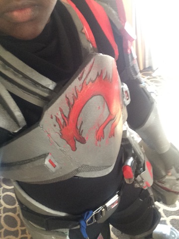

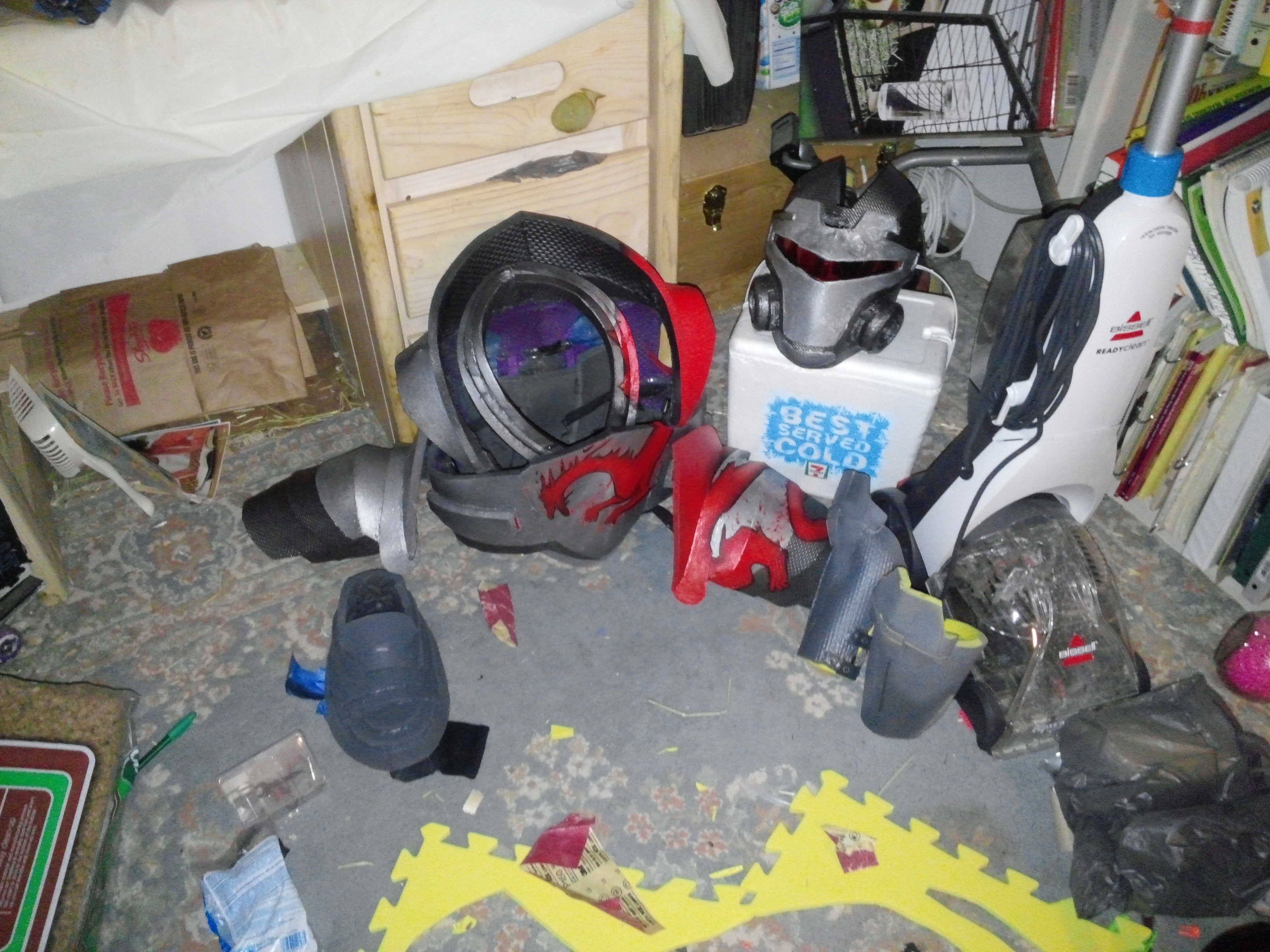

Ok so i stopped updating this; in short this happened. [A5TTACH=CONFIG]503686[/ATTACH] I'll have the hips built by Wednesday. Everything plastidipped, strapped, snd painted for con on Friday.

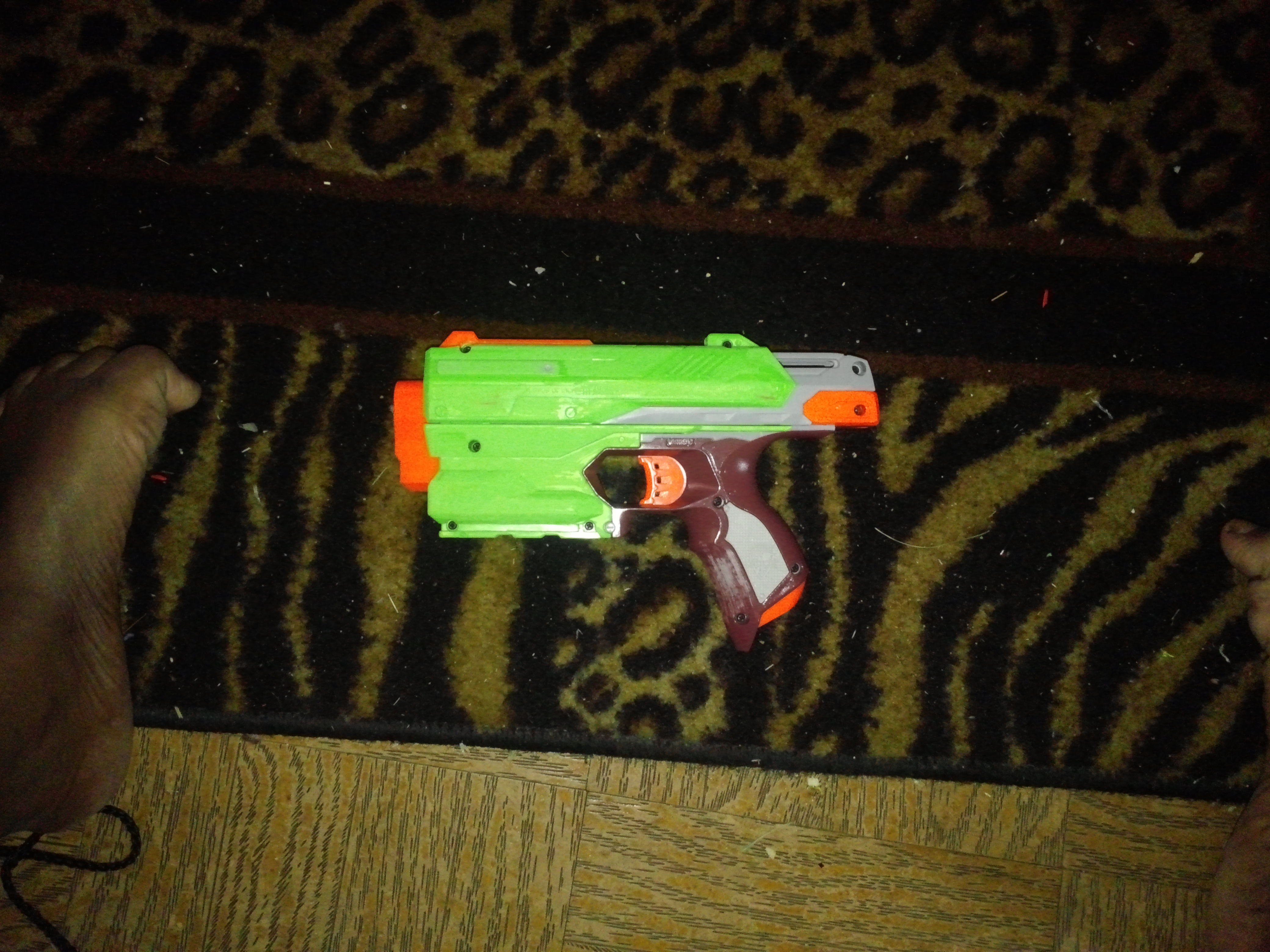

Here's the unpainted version or my modded nerf sidstrike, i'll update 20150715_161306.jpg later after i take a pick of the painted one
Hips pepped, assembled, and plastidipped. The pep didn't fit well so i used mending plates and binding posts to put a hinde in them so i can also sit. 20150721_203927.jpg 20150721_203803.jpg
In other news all the lights work. I have el wire inside plastic tubing tinted red using nightshades automotive tint20150721_220703.jpg
The plan is to finishing painting the shins boots hips and hand plates tonight, then strap everything tomo and on to con
Thanks! This was my first build, it turned out pretty good! I'm trying to get to your level, your suit is amazing. ^_^
