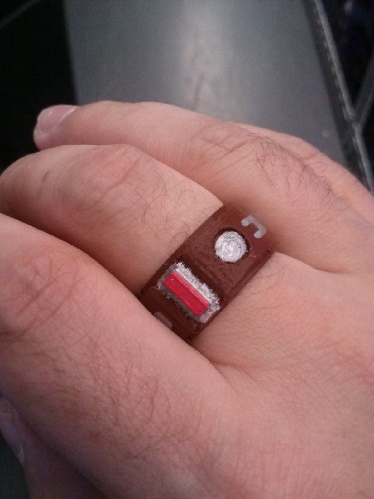

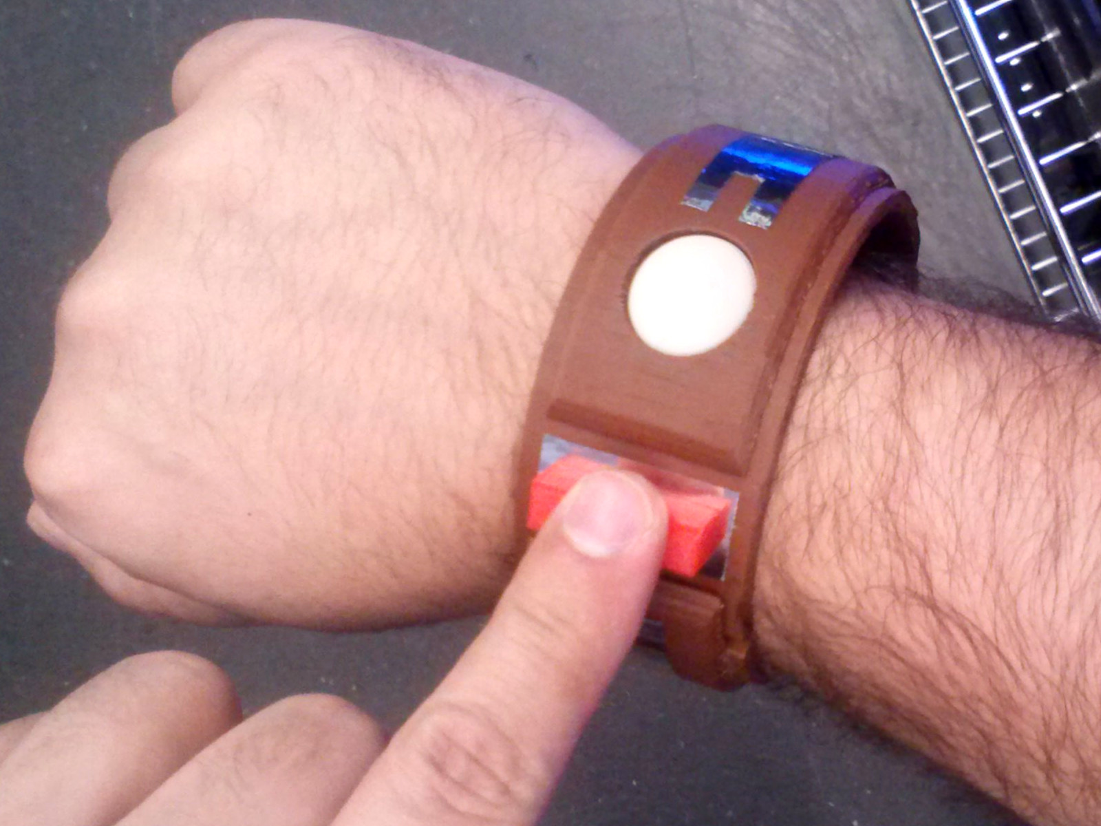

3D-printed Liberator teleport bracelet in progress, here's a rough draft:
And one sized down to a finger ring, just because.
3D files and build instructions will be shared freely soon, when they're a bit less embarassingly-modelled. :)

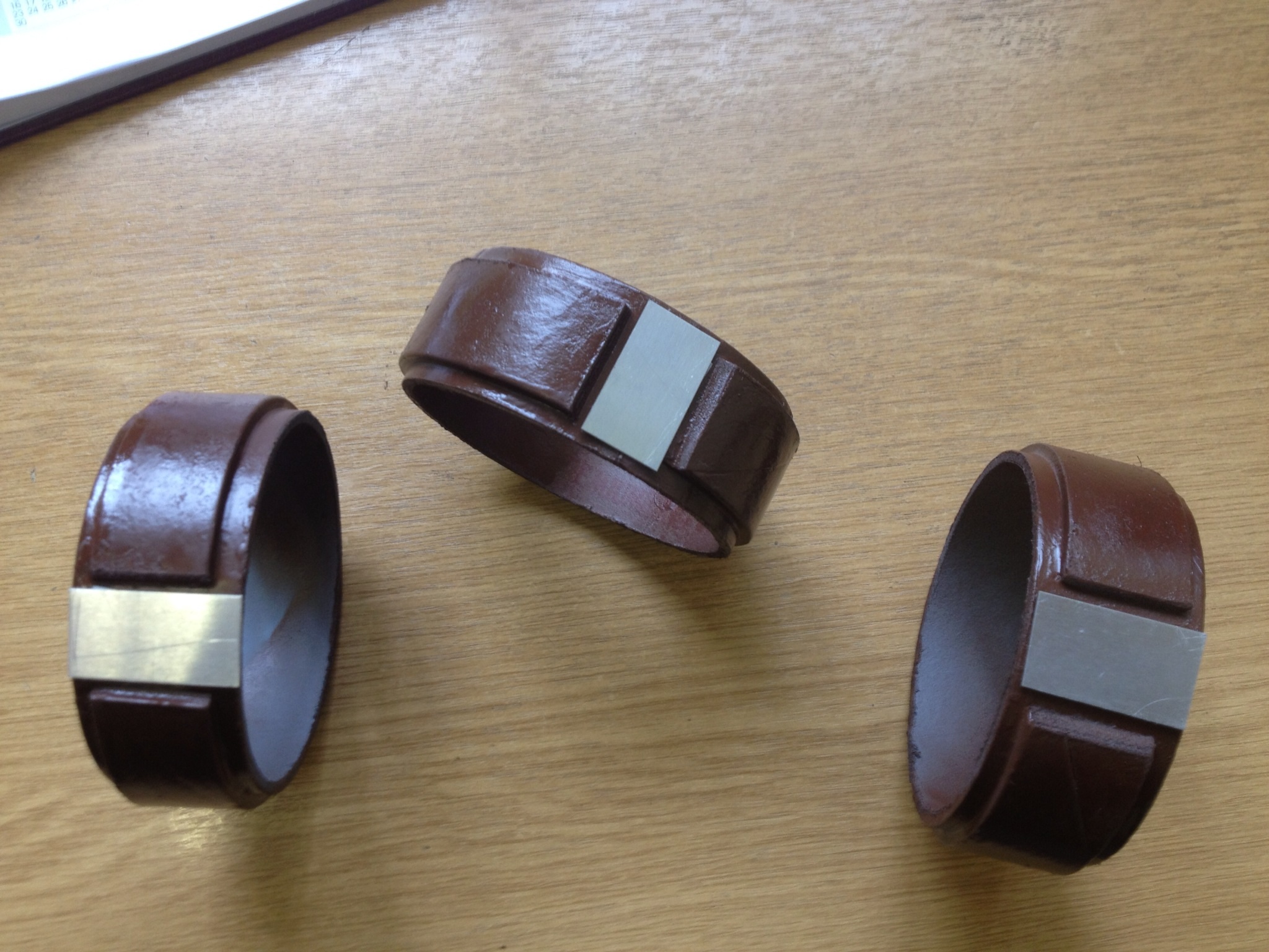

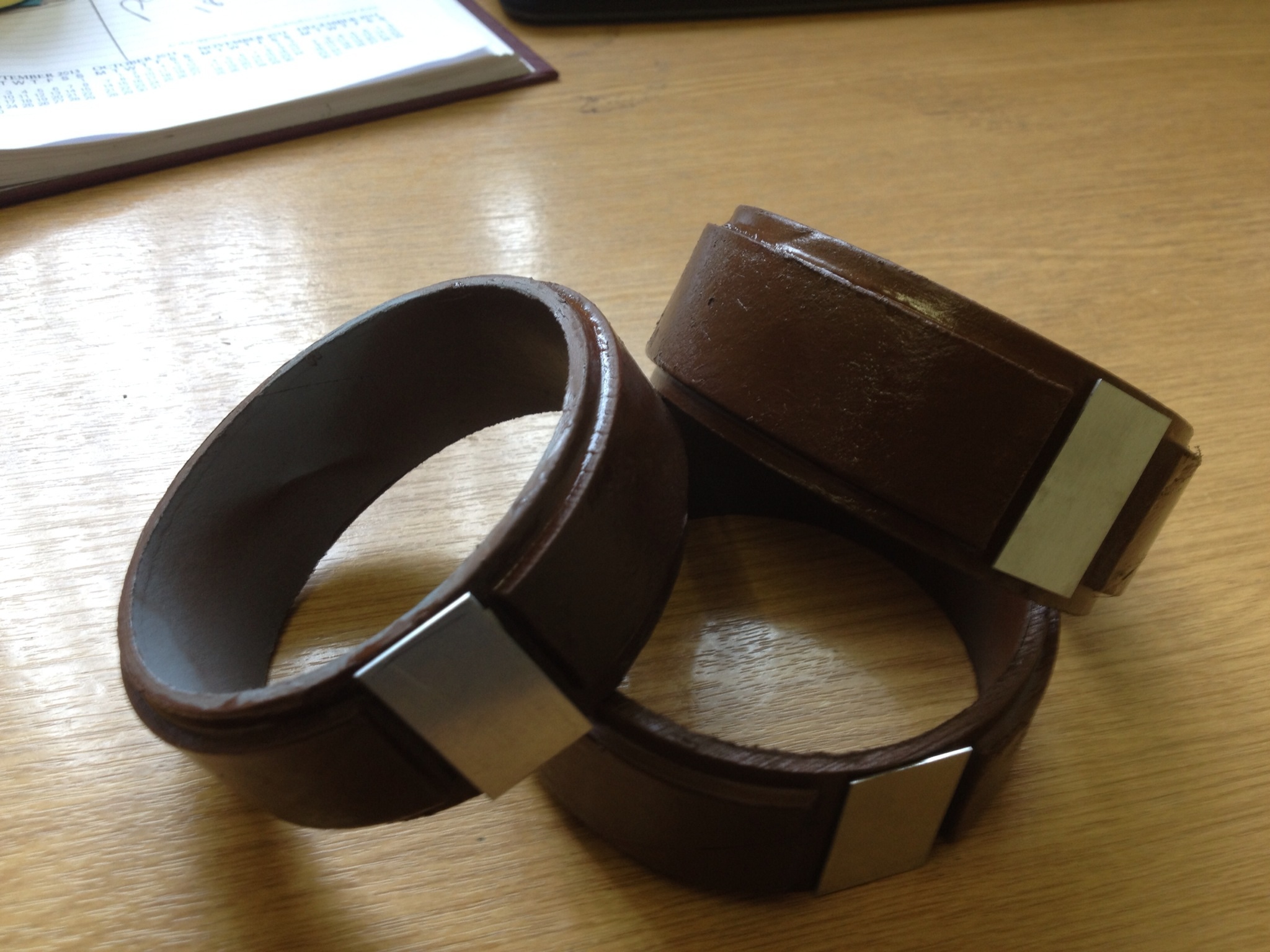

Just joined the forum recently, having made teleport bracelets in the past, when I was younger, Ive now started to make some again.
It's amazing what you can achieve in your lunch hour :)
This time I'm using old packing tape reels pva wood glue and Russet brown car paint over a grey primer and have more time to do them now
They aren't to any scale, however they're not that far off
I've used 0.7 mm aluminium for the Perspex to be mounted on.
I'll be hopefully posting more pictures as they get built up.
