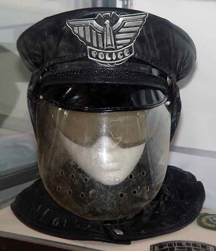

The only other photo I have is this one. I thought it was one of Karl's.

Hm, I dont know Mike.. It looks like it was taken at the same place, but it's not in my worldcon folder.. But great frontal view, thanks!
Yes Joberg, I noticed nobody made the helmet.. Well, mine won't be that accurate, but maybe it will inspire someone to make another, more correct one..
