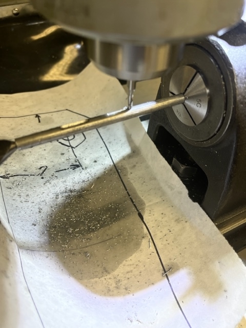

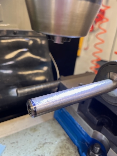

Started on working with my father's machine shop to build some parts. It's a little slow going since I am also learning in process with my father. So far we have made up an steel barrel and a we are halfway through making up an aluminum side sight. I have also have a friend working a milling out an outer handle frame out of aluminum. Here is some of the stuff we have made up so far. It's been fun doing working up the drawings and measurements to make everything. These are all still works in progress.

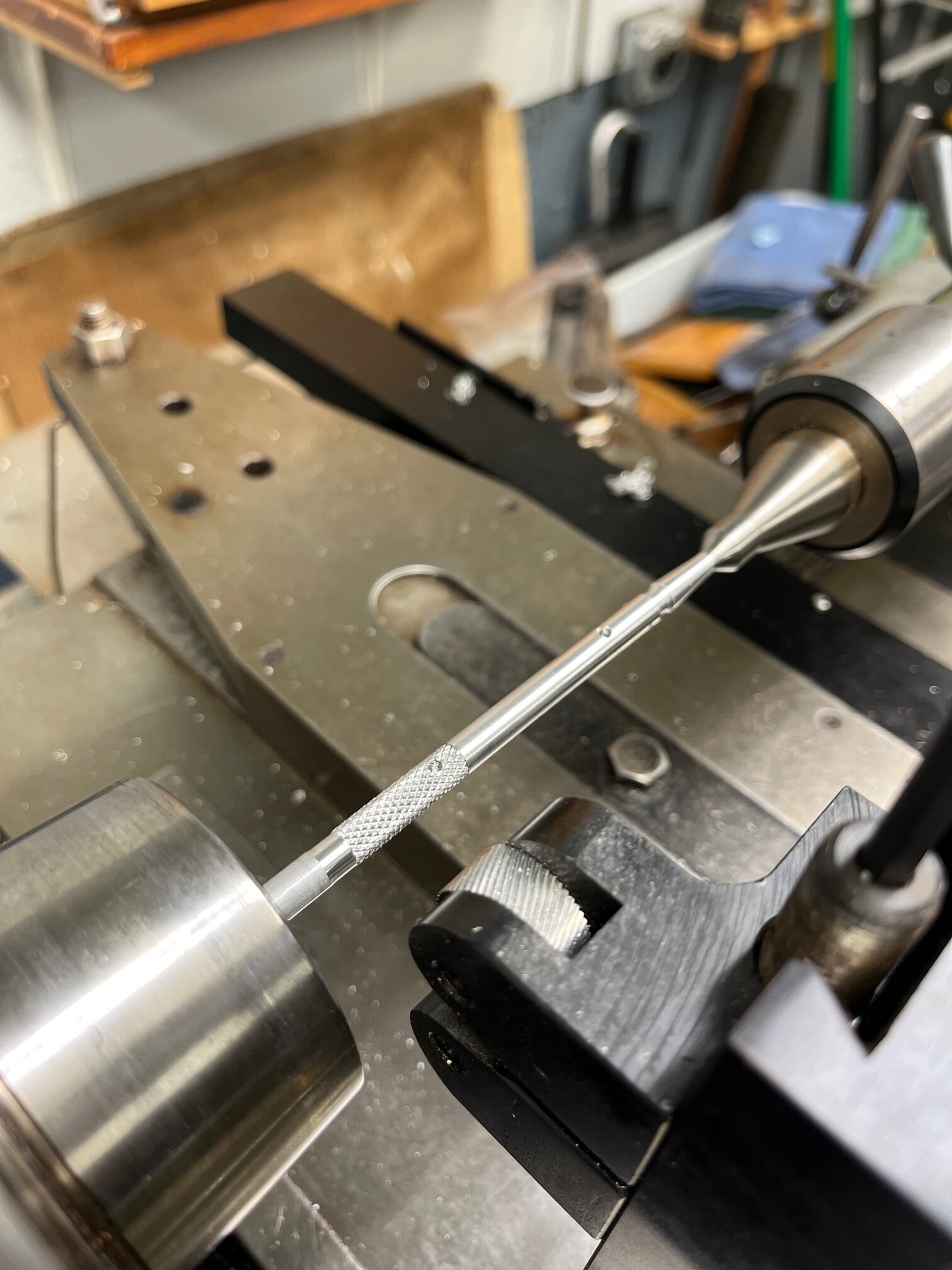

dcast
So finally finished the site rod. It only took 3 "tries" to get it right...lol. Hoping to start working on making of the bolt soon...just figuring out how I want to do the end rod and attach it to the bolt. I been fun...and definitely a challenge since this is my first attempt at working with a mill and lathe. Luckily, I have someone to bounce questions off of to figure things out before I start working my new cuss word vocabulary....:0P

Palantirion
That rod is a pretty sophisticated bit of machining, looking really good. Great that you can apprentice in the context of making your own project!

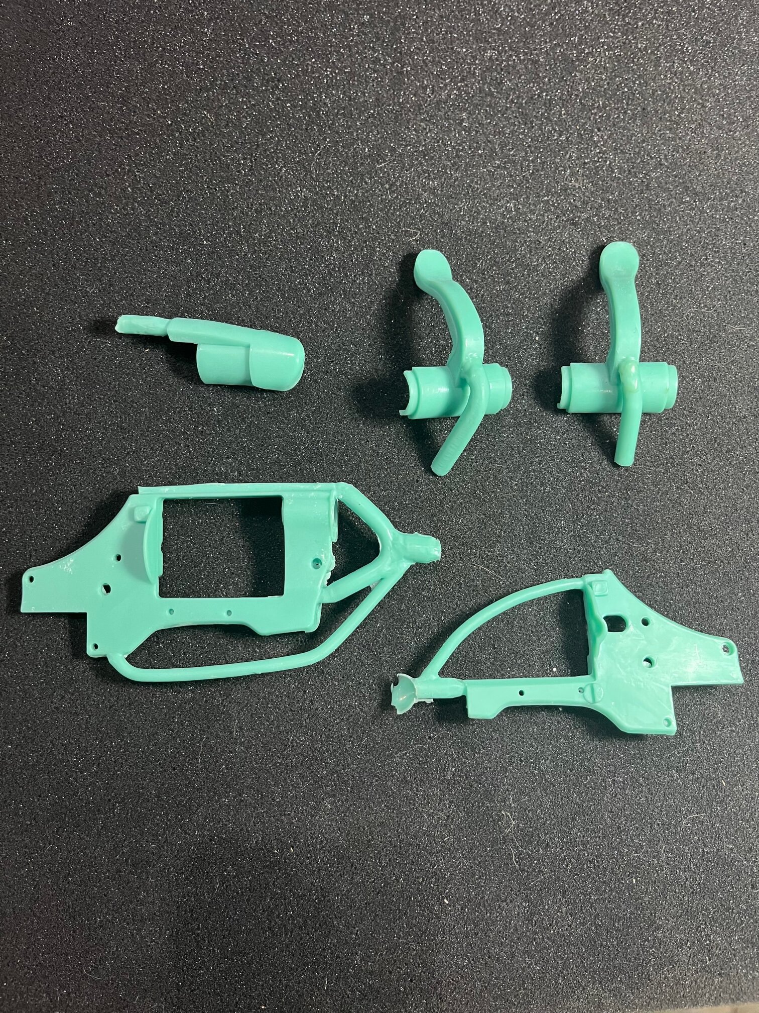

Thanks, I'm a little nervous about making the bolt since there are so cuts and angles on the shaft. But, while I'm waiting for the next time I'm in the machine shop. I got my wax molds of rear cap of the receiver, the chassis, bolt lever. Needing to remove any flashing, injection lines, and unwanted blemishes. Unfortunately, the casting company is gonna be busy for the holiday season so it might be a while before I get the casted parts till January. That will give me some time to work on the other pieces in the shop. :0)

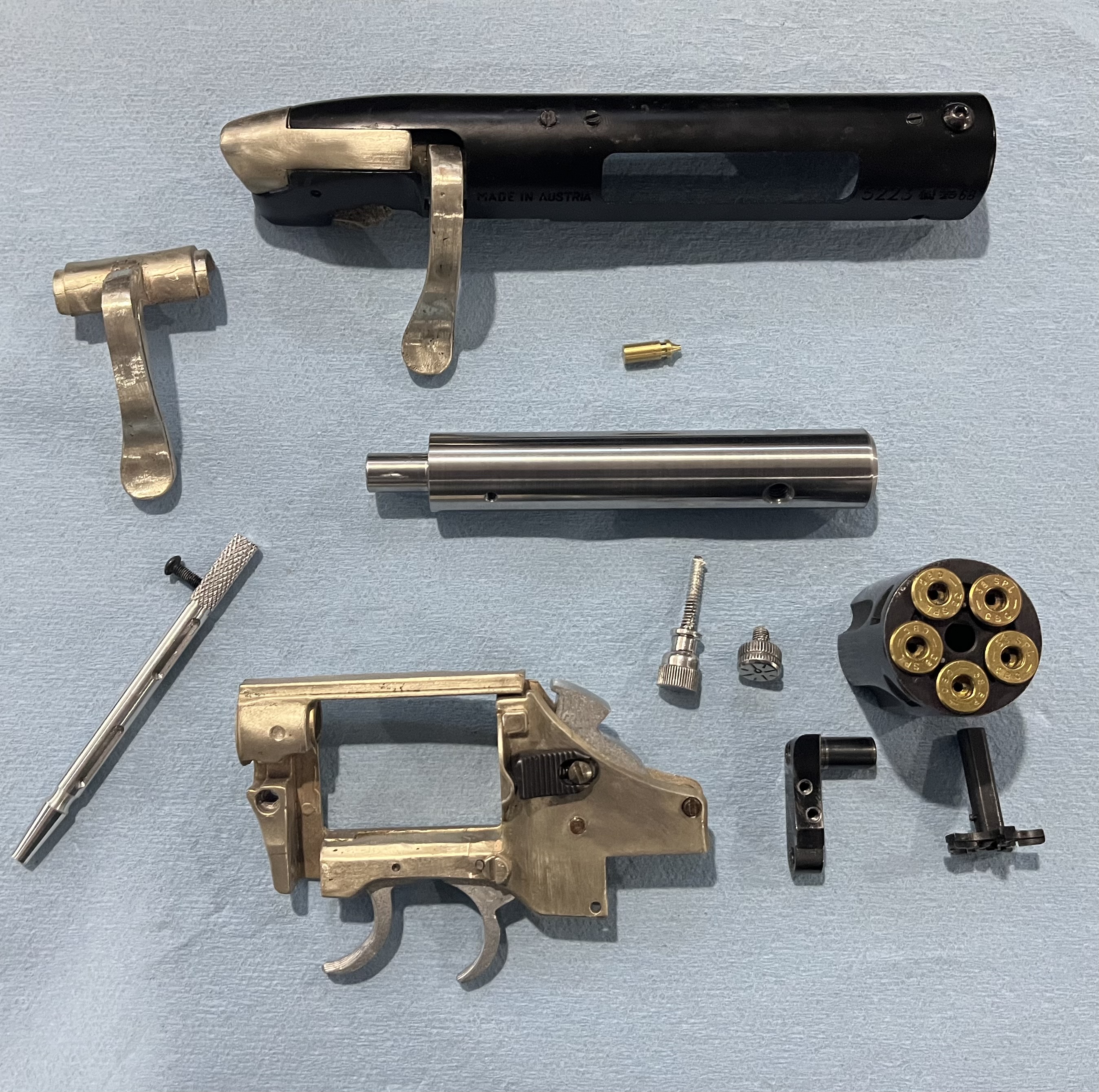

So I just dropped off the bolt, steyr front, both side covers, Cylinder, and trigger guard off at my uncle's...so looks like most everything is gonna be metal on this thing. Might take a couple of weeks to get everything done. Also we tapped the chassis for the screws. Here's what I have so far, they are coyle triggers, Cylinder, crane, and cylinder release are Charter Arms, Receiver back , bolt latches, and chassis are all caste in white bronze, Aluminum sight rod, brass bolt tip, and the steel barrel we made in shop. The binding post and weaver knob are from Tiptop workshop on Etsy...( nice workman ship). I'm planning on cutting off the plastic "knobs" and put those in place of them. So far everything is coming together pretty well. I do have some binding with the cylinder in the chassis, but hoping to machine that down in my father's shop. Fingers crossed...if not...I'll have the original one cast in bronze....not much of a size difference...but it's there.

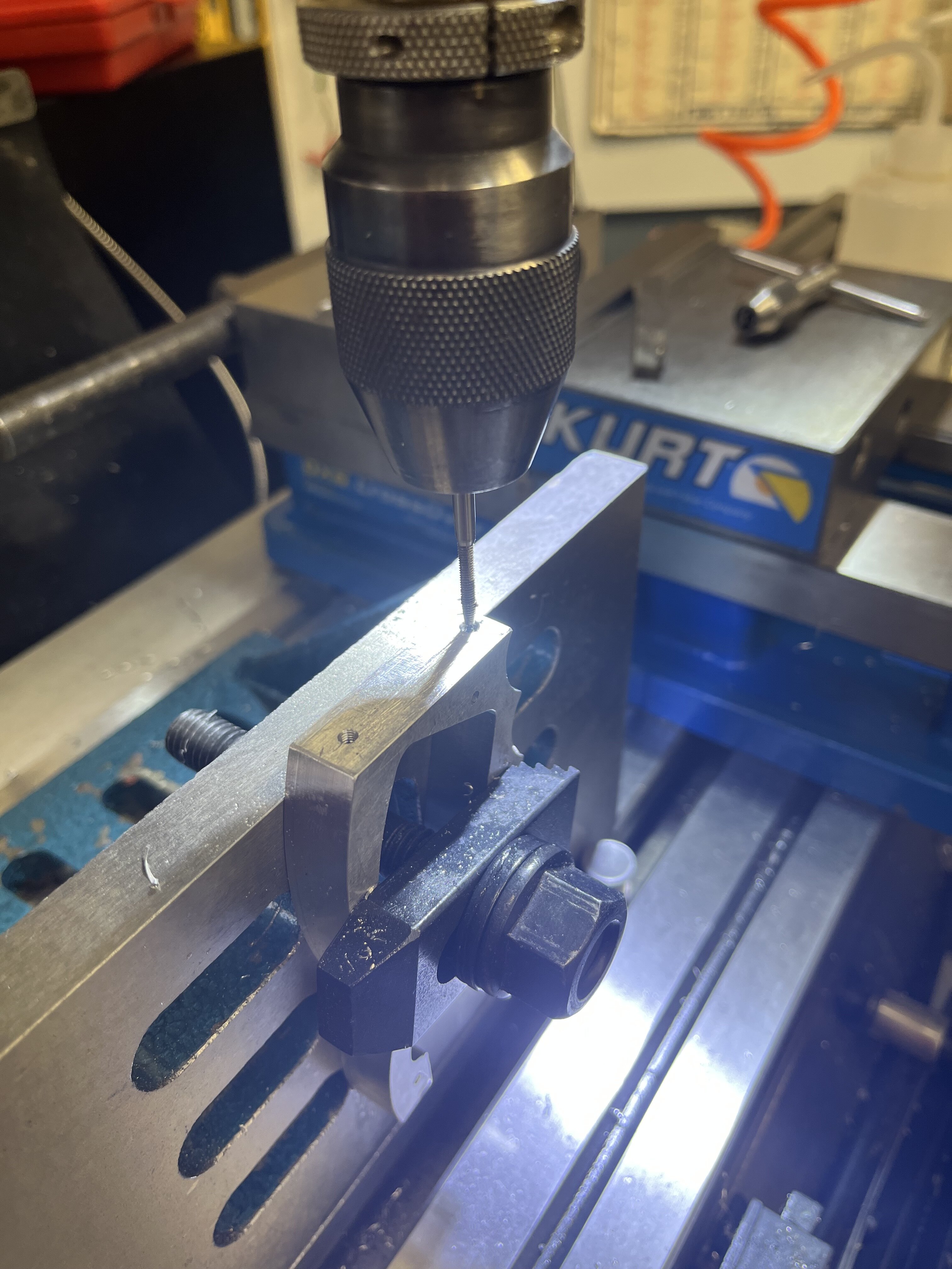

sorry, been busy with "life stuff", but I do have a couple of updates, I have cleaned up and returned the wax casts back to my uncle to have him cast those parts into white bronze( side covers, trigger guard, receiver bolt, and the cylinder (just in case). I'm sure he'll cast those in the next week or so when he has room to fit me in to his workflow. Also, I had a little time in the shop today, we were calculating that there was a 2.2% shrinkage for the chassis causing the oem Charter Arms cylinder to bind. So I need to do some measurements on where I want to trim down the inner parts of the chassis. Hoping to create a little clearance to use the Charter Arms cylinder. Also we started working on drilling and taping the outer handle for the handle butt plate.
