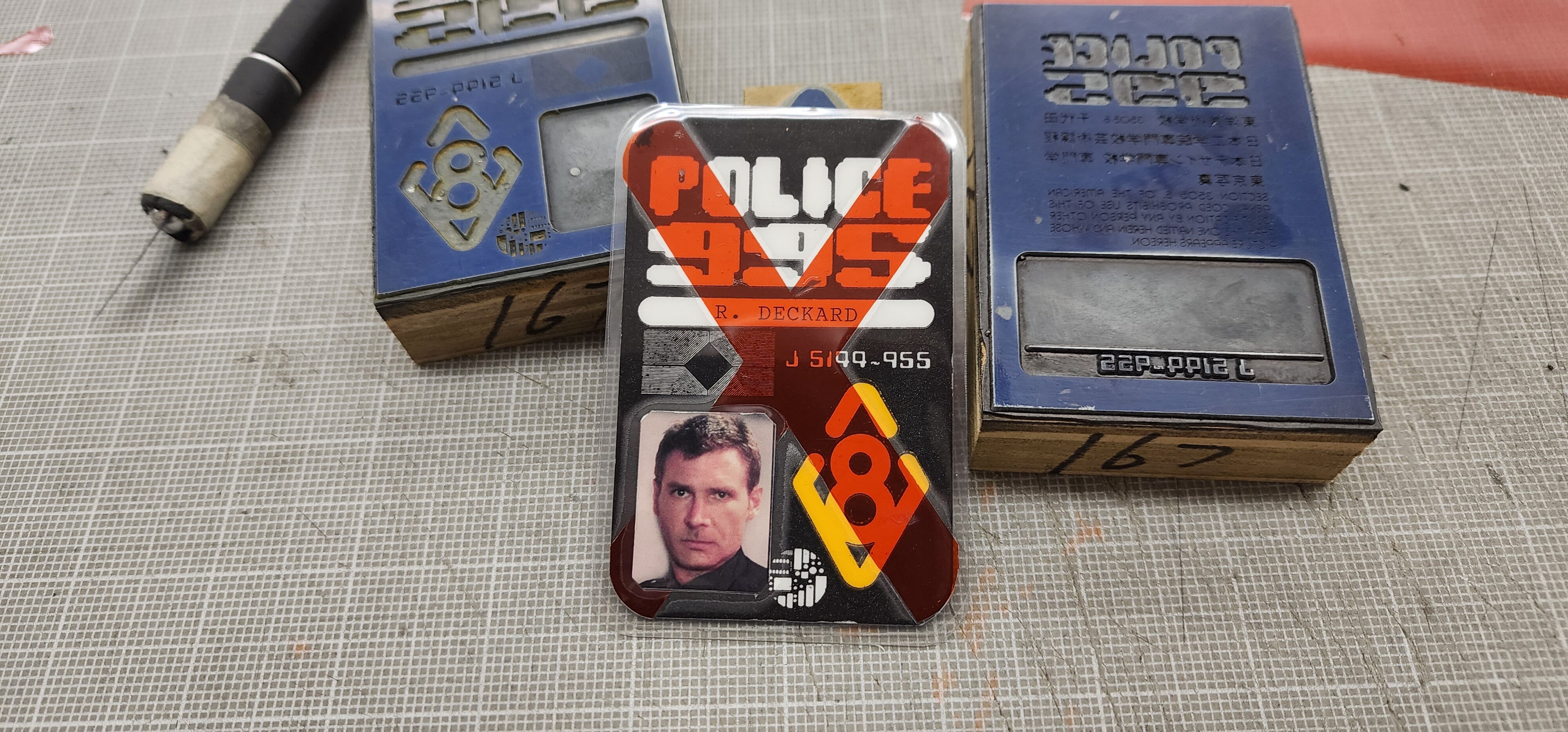

So is there a consensus as to what the ID card looks like? I've seen some cards with an "XV" after Deckards name, some without. Some with "Rick" some with just the letter "R"
I know this isn't the correct photo. But I had to make one.
I went with "Rick Deckard" for my badges, purely because the screen use badge is also using first name in "James Jacobson".
By the way, now that I'm on my computer, this is what I meant with the amberlith corners not being clean when not glued first, on the right:
the original badge has very clean corners.
I'm really loving the grain in the black and flaws around the letters on your try though! very cool to see those made with the actual process and see the flaws appear naturally :)
Cannot have enough of those in my life :cool: :cool: (y) (y) :notworthy: :notworthy:
