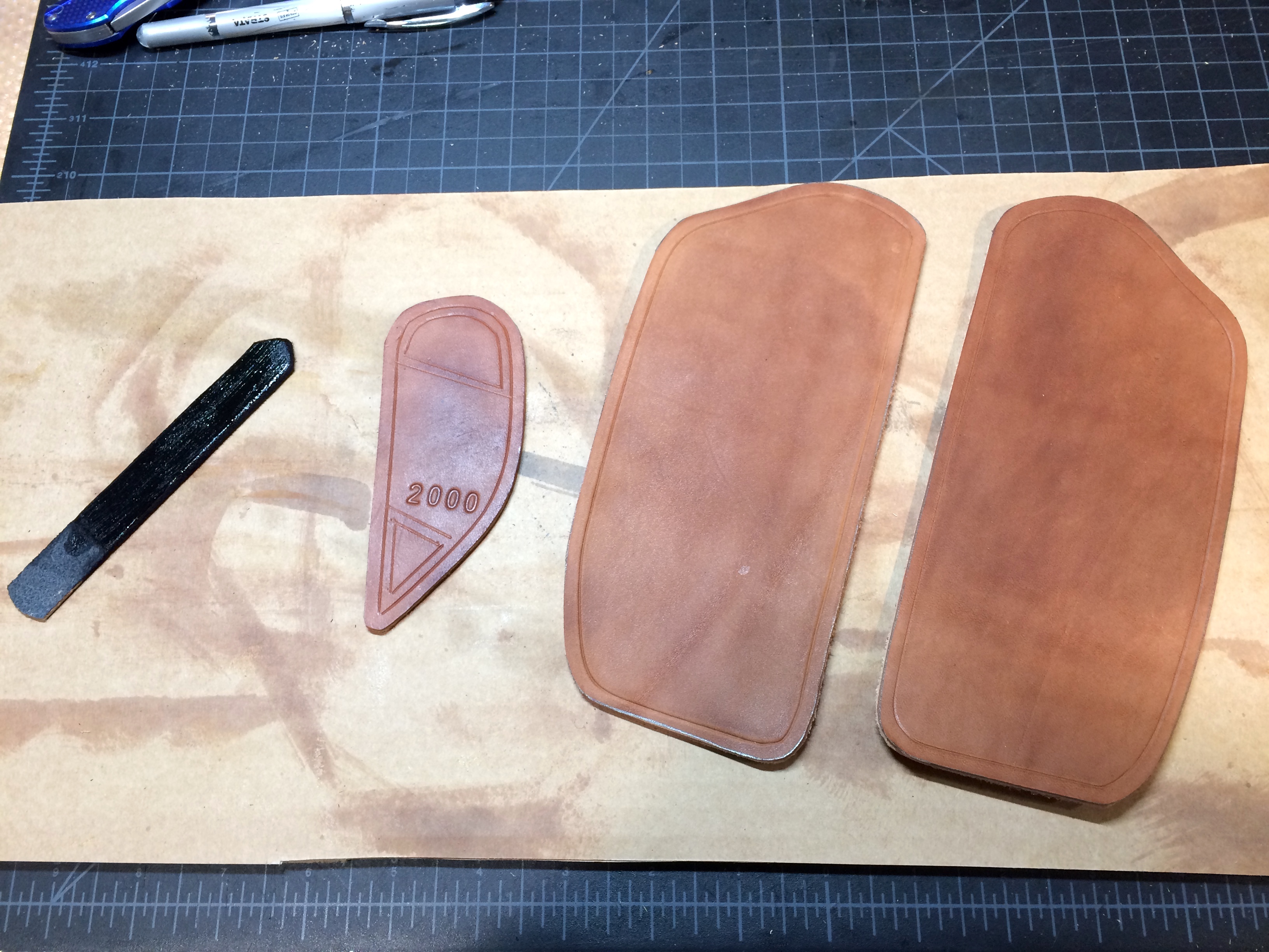

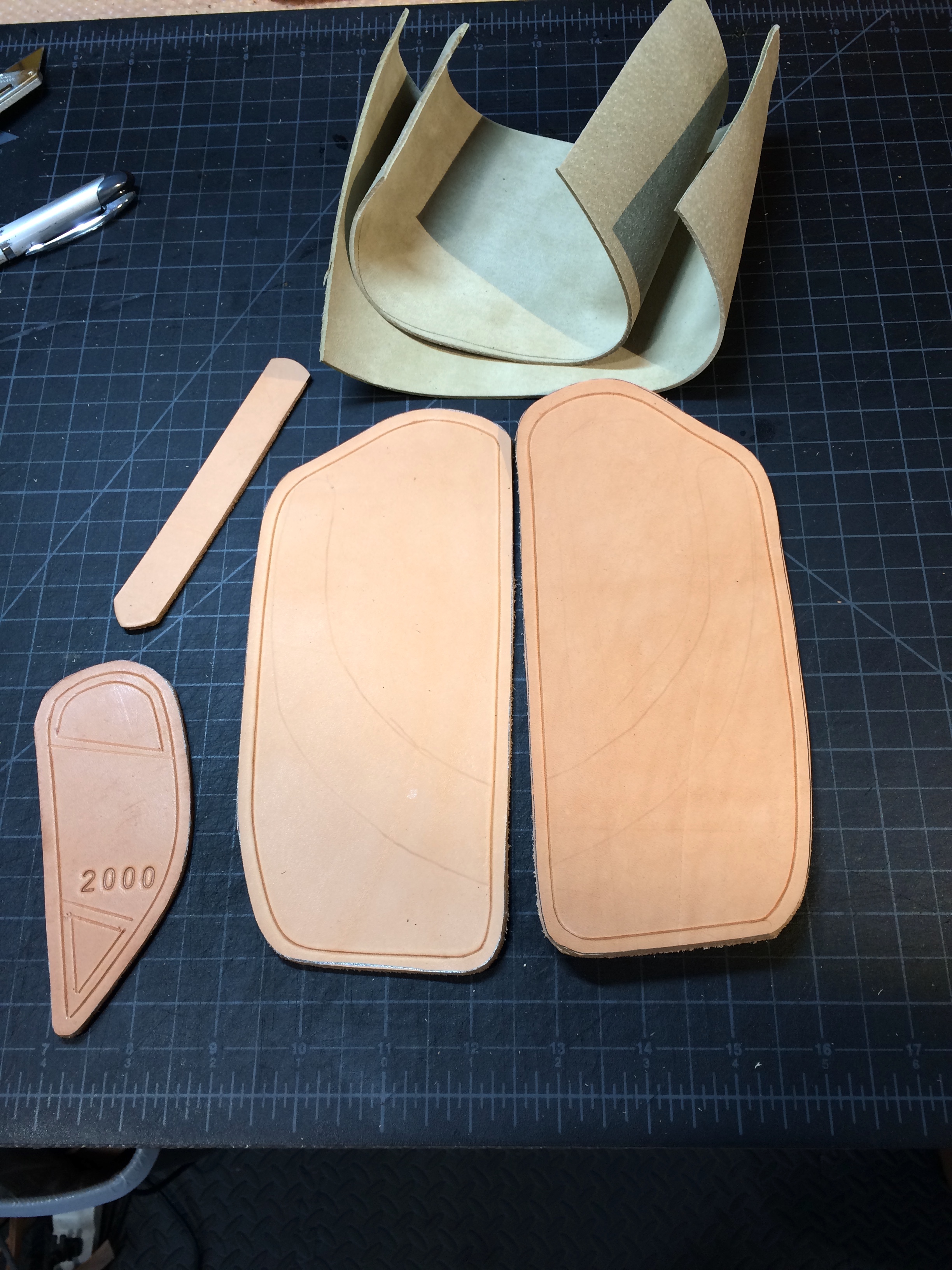

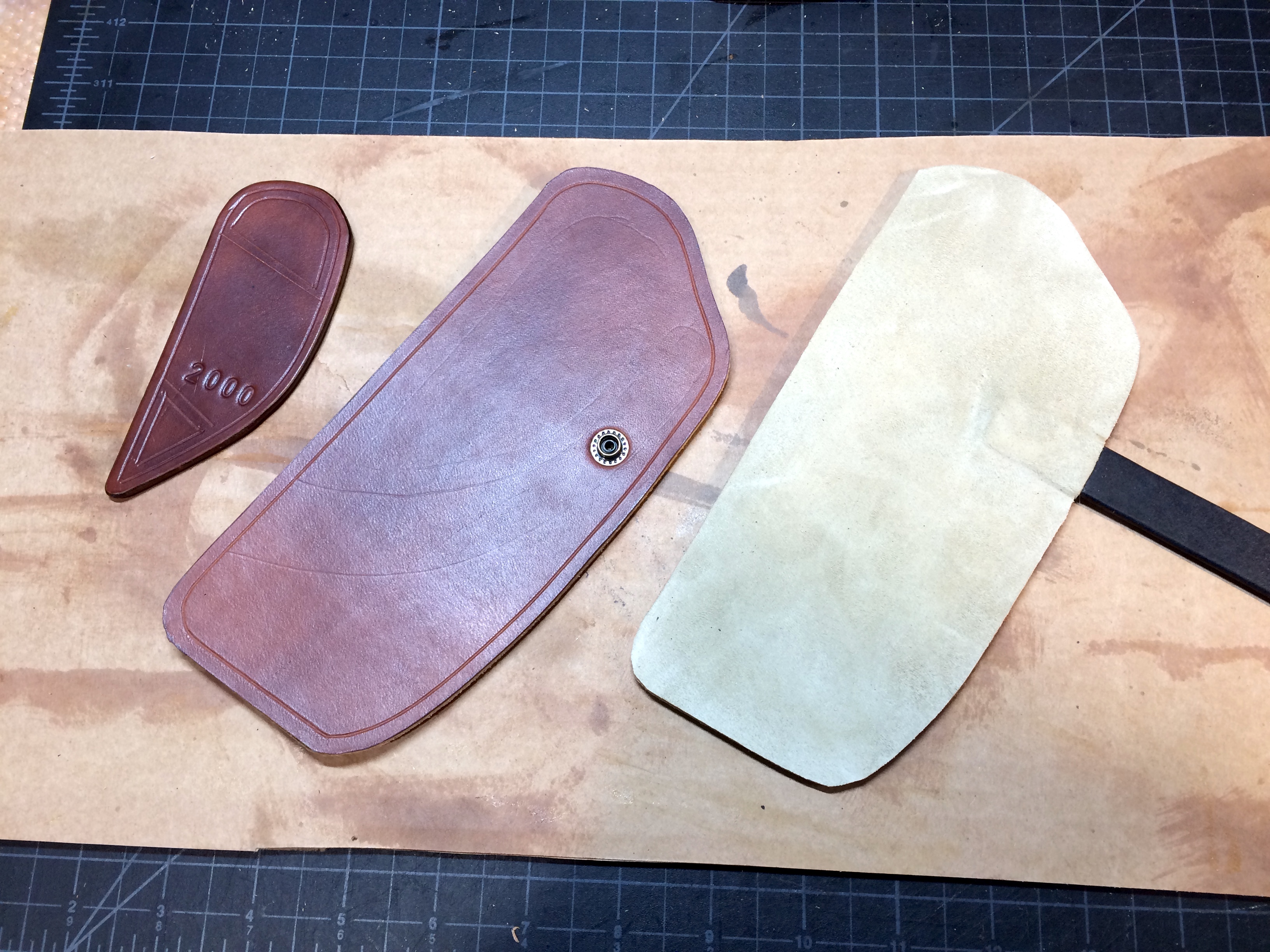

Here I've got all the materials cut out and stitching marks drawn on. I'm using vegetable tanned leather for the shell and a nice light green suede for the interior which is accurate to the original.

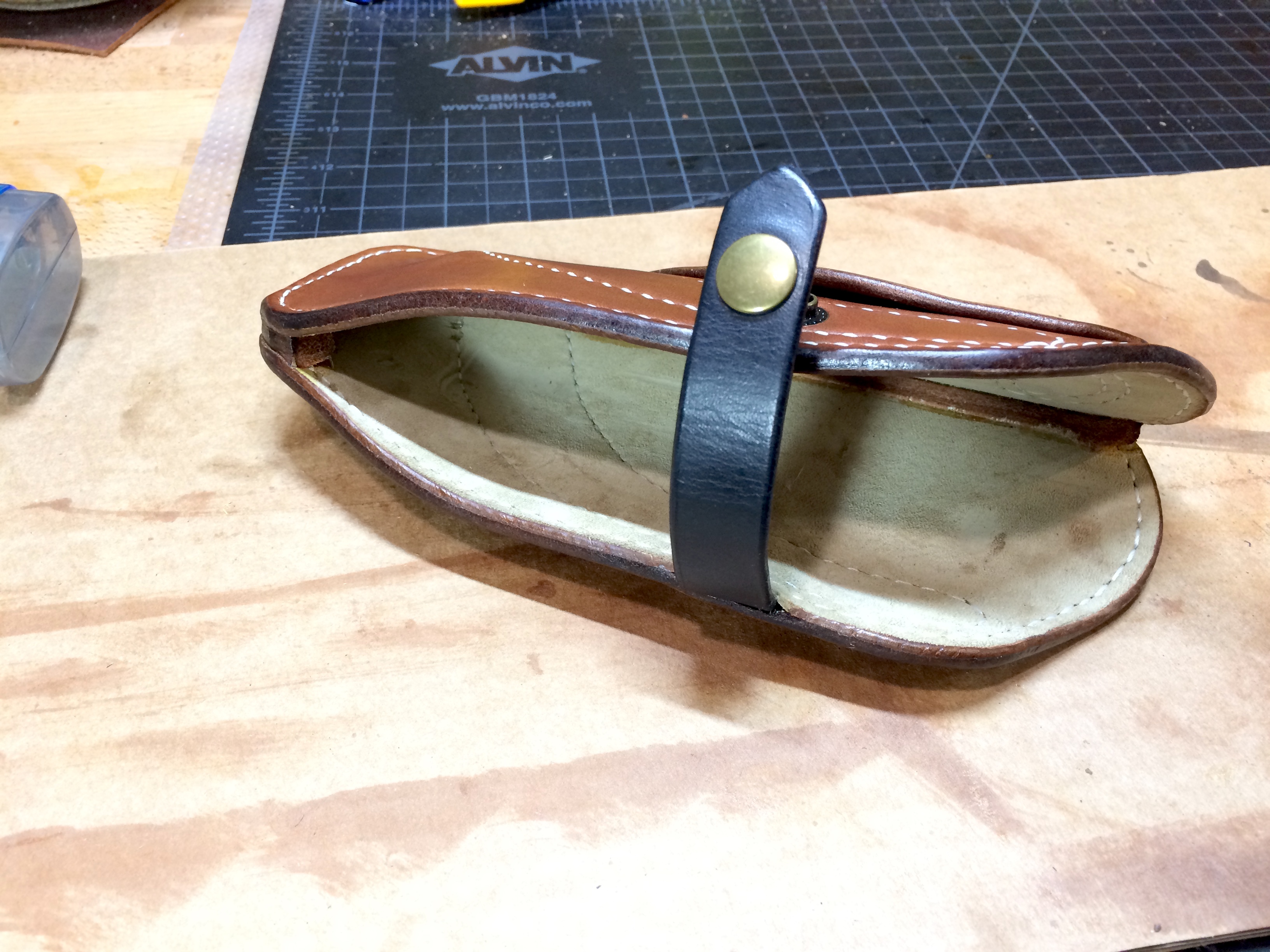

All the parts ready for stitching. Leather has been oiled and finished with a wax-based top coat. The retention strap is glued between the layers and the brass snap was also attached before affixing the lining so the metal won't rub on the gun.

All the holes punched and ready for stitching.

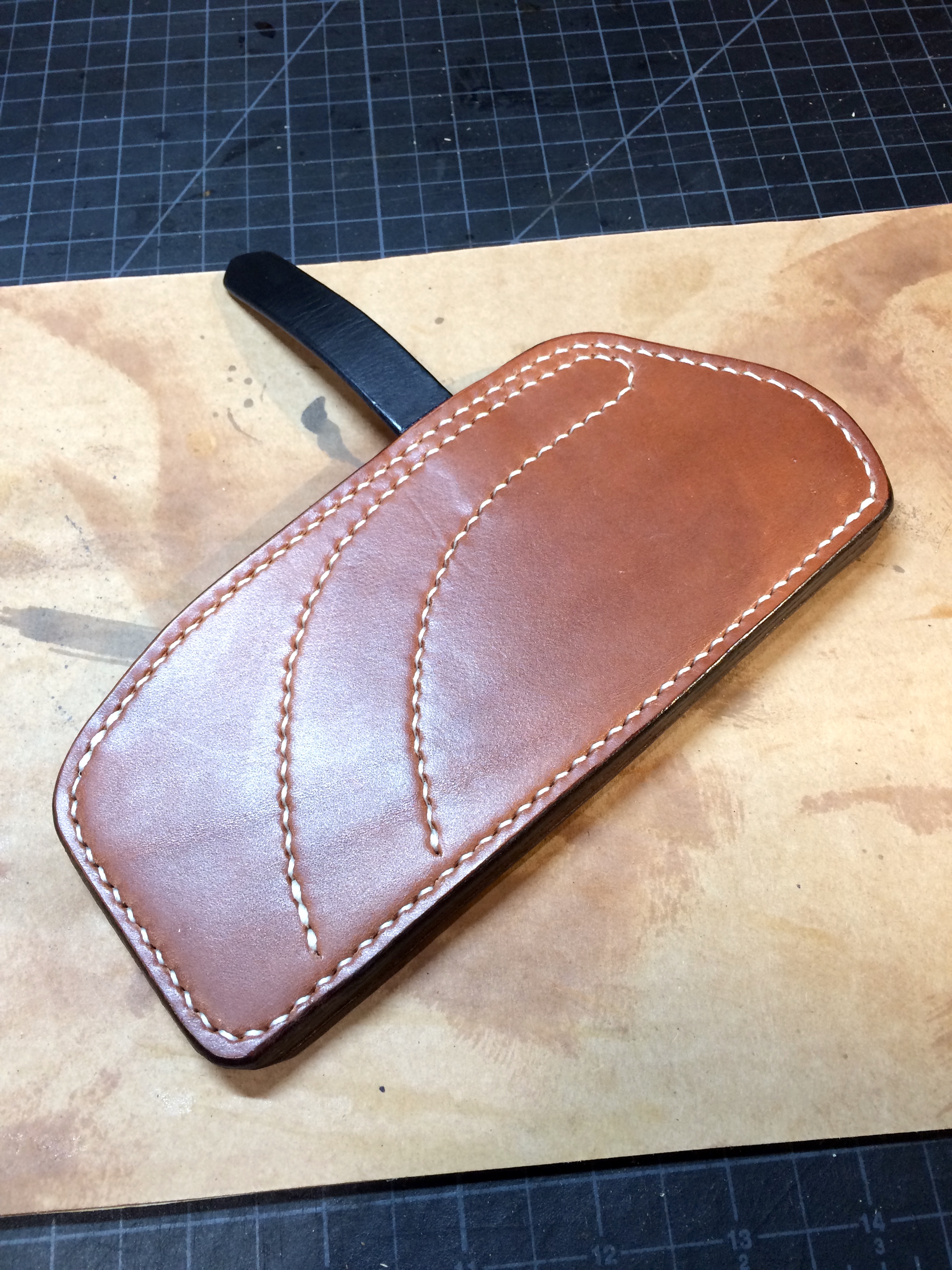

Everything stitched up on each half of the holster. Takes a bit of time to saddle stitch everything but it's not too complicated a stitch up. Mostly just flat surfaces. I also beveled, dyed, and burnished the outside edges so each half is pretty much finished.

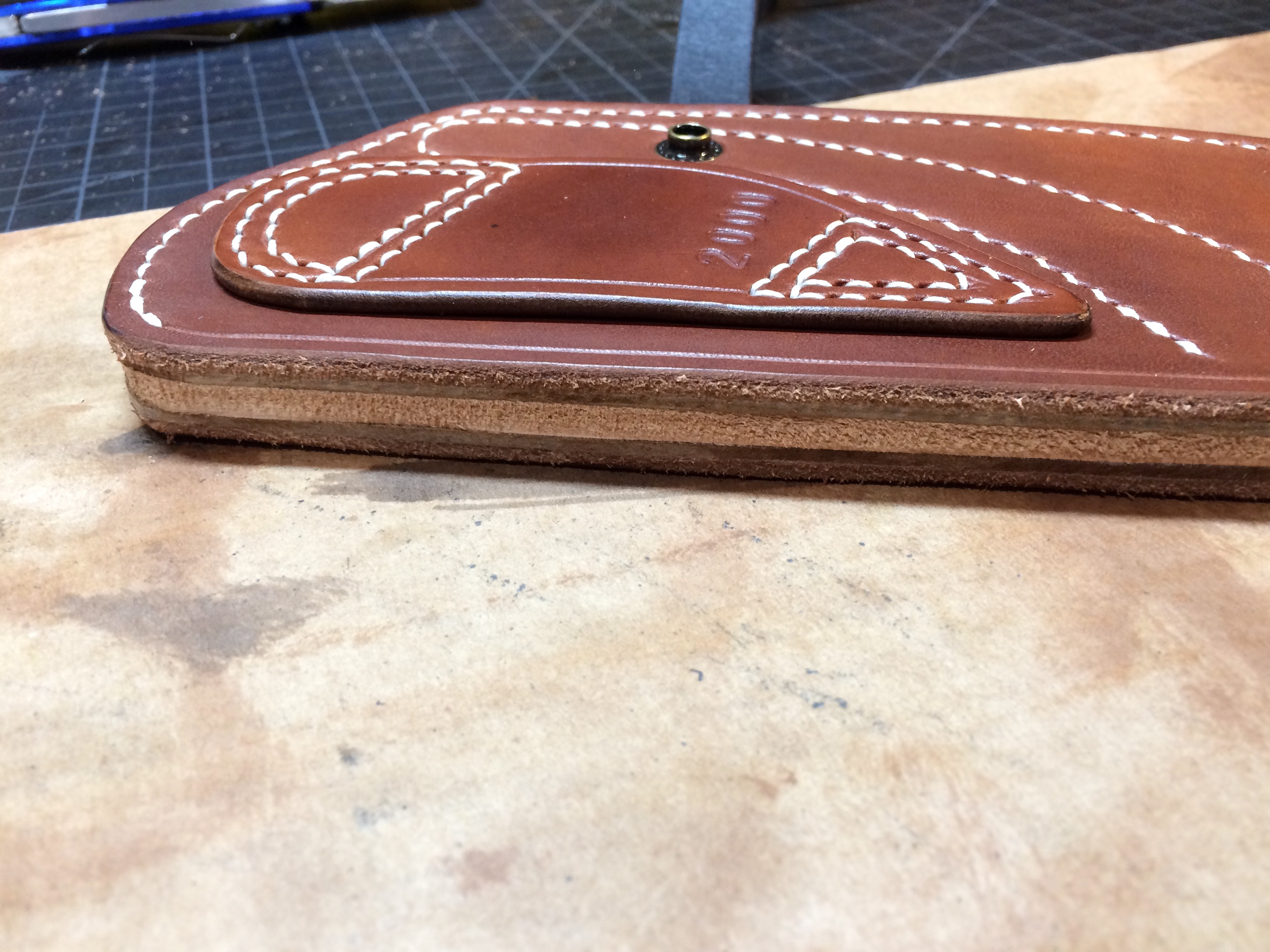

Now to attach the two sides I need to glue a welt between them to add some additional width to accommodate the thickness of the gun. I'm using some thicker vegtan leather for the welt.
Got the welt glued in, trimmed, sanded down and ready to be dyed and burnished.
Now I've got one flat looking holster. That's good for stitching the welt together but I'll need to shape it later.

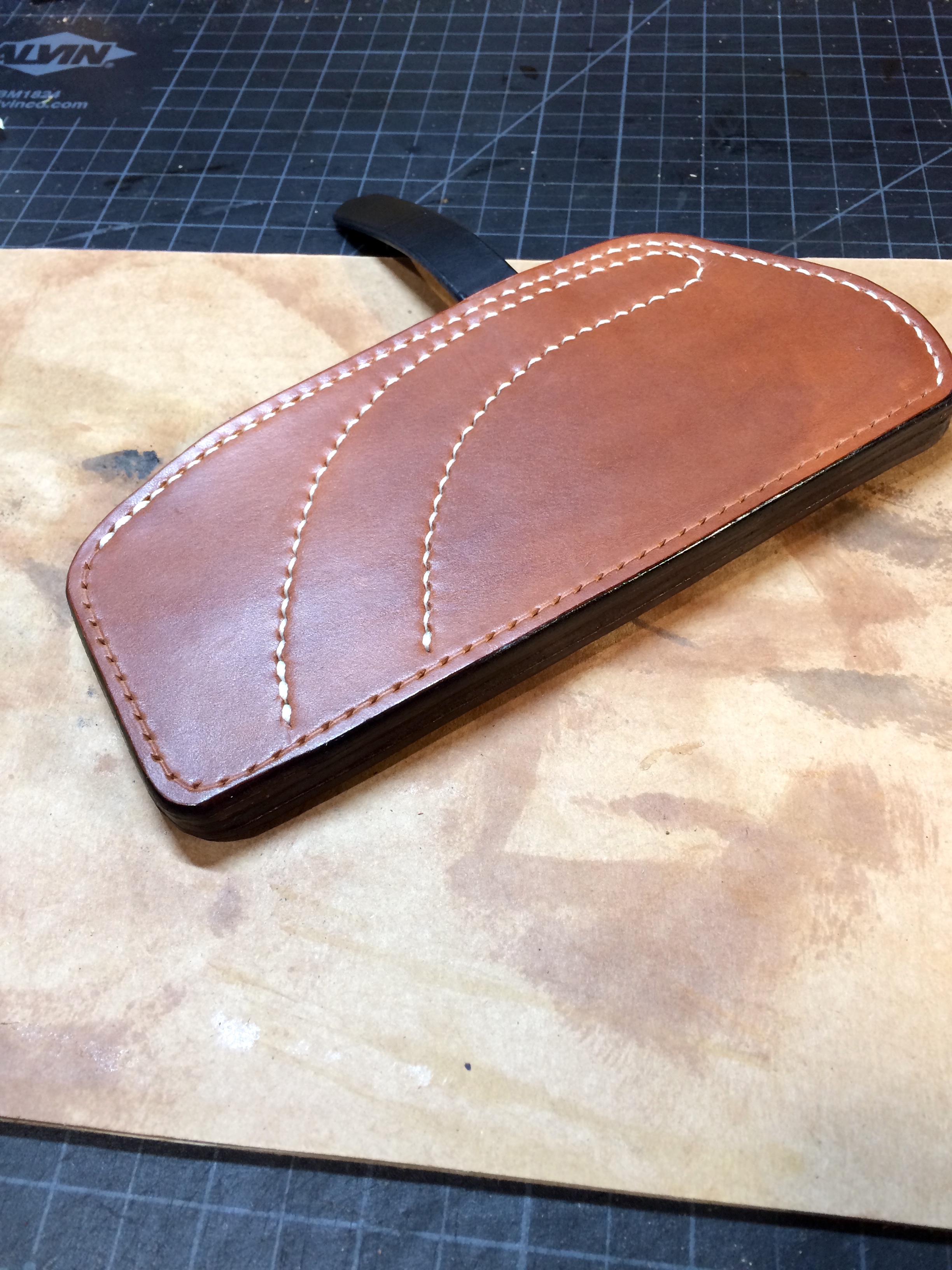

And got the welt all stitched up.
Since the welt made the edge so thick the stitches got a little off line on the backside but that's fine. It's not noticeable and easy to fix next time around and the front is nice and straight.

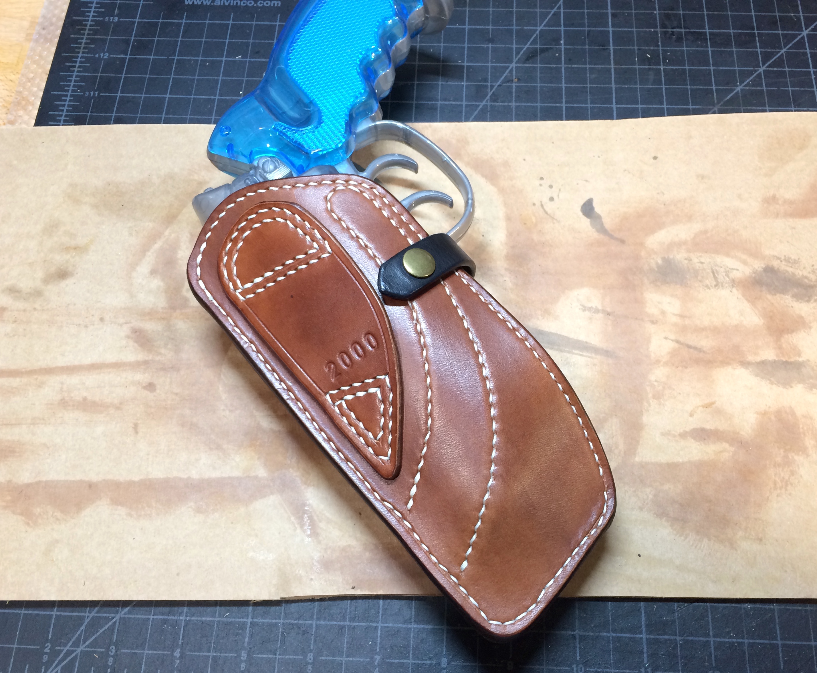

Finally, time to mold the holster to the blaster. Usually, I wouldn't recommend ever submerging a piece of leatherwork in water but since I was confident how this holster would react I dunked it in a pot of room-temperature water and then worked the gun into the holster. Installed the final snap once I knew exactly where it should go and snapped the gun in place to let the holster dry. Once advantage to using the water pistol is I don't need to worry about getting it wet.

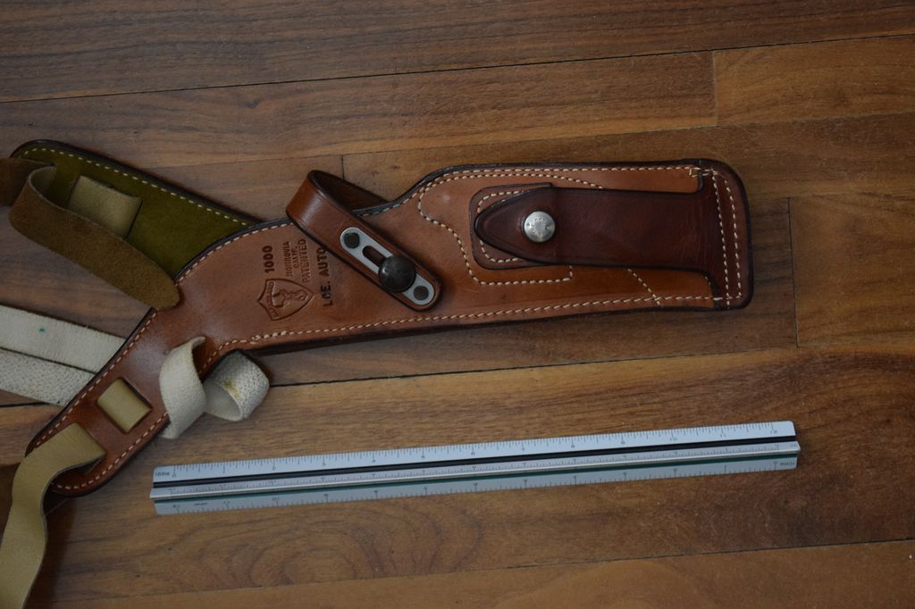

Very cool! Got any pictures of your original Safariland you'd share?
airhead

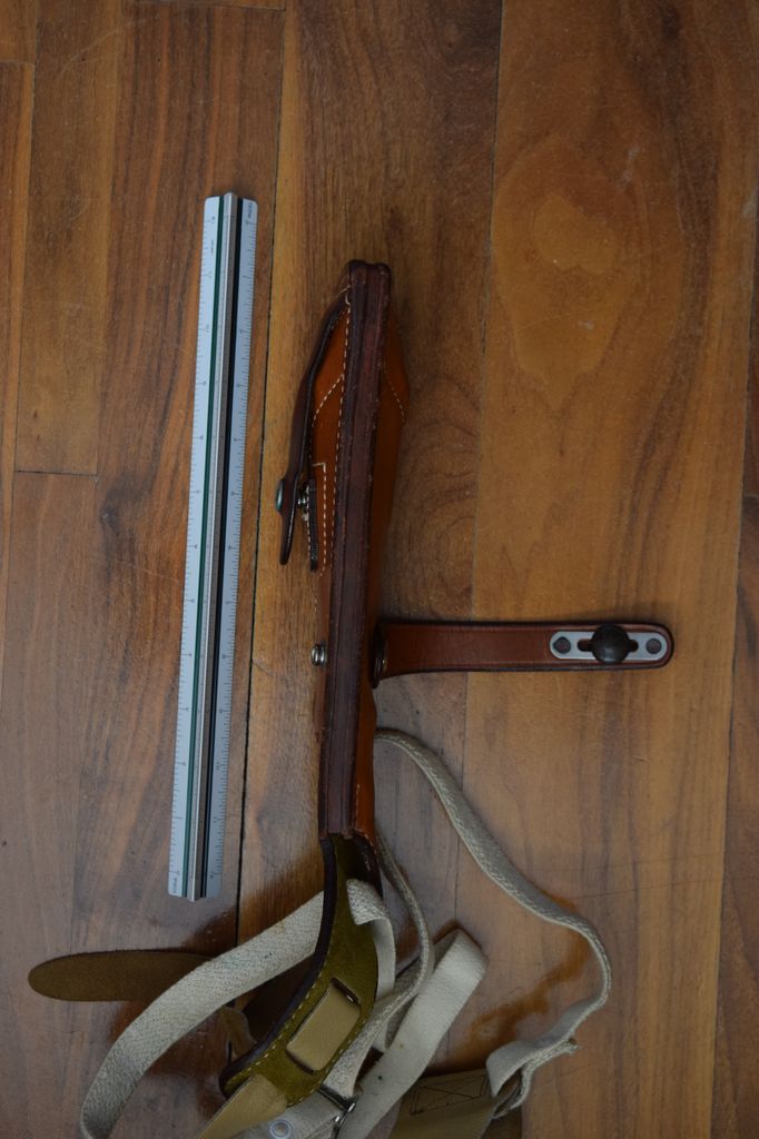

This is an older Safariland Model 1000 large auto shoulder holster Along with the spring metal clamp that holds things in, there is an adjustable strap for security and a snapped belt loop to keep it from flopping around. There's also a metal "guide along the back welt that helps keep the front sight from wearing into the leather (I guess). They are kind of quick pictures, but I think it shows the major parts. Front to back, I measure 3"; center of the keeper strap snap to bottom, I get 6.8"; the back welt is 0.6" thick.
