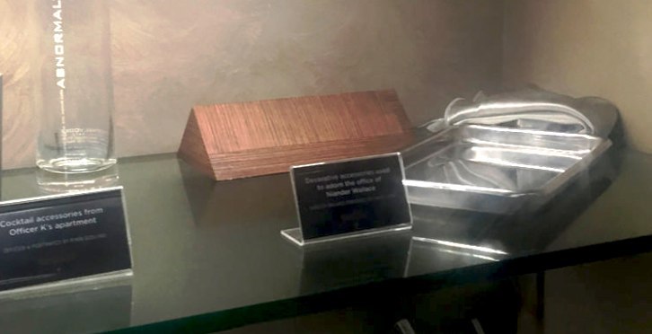

UPDATE: Found another reference!I noticed the box shows up in the background of the Tested video with Adam Savage and Doug Harlocker.

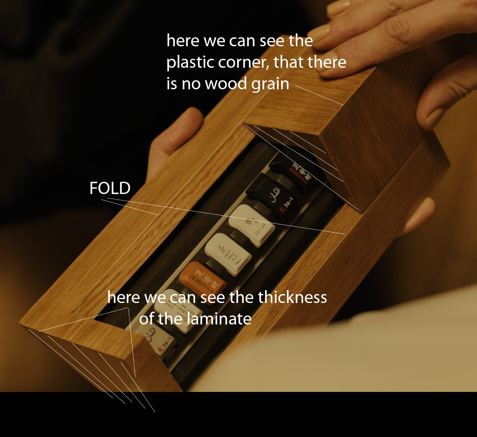

Hey, nice project. As I already pointed out in Elilay's run thread, if you want smething really accurate, the box is not made out of massive wood but of melamined venered wood. If you want to accurately reproduce the grain orientation and build of the bow, it will be the only way to make it. I'm even almost sure that the box is first constructed then veneered ;)

The lack of joints made me wonder if it was machined out of a huge block, or like you said, just a veneer. There would be something nice about making it out of wood, especially considering how rare it is in the world of the film.

here is an explanation of what I see, i put lines for the wood grain in the areas that show that is cannot be massive wood. on the sliding part, the grain is in diagonal, clearly a veneer. on the front part the grain is vertical, if it was cut in a big piece of wood, it would be end grain.

Seems that the main body is solid. Lid seems veneered or, by the look of it, painted by hand (faux wood). Inside groove on either side of the black insert holding the "chips" could be part of the mechanism holding/sliding the lid. Fast project?...not! Tricky little box that one;)

the main body is not solid, it's for sure ;) the end of the box would show end grain, there is shows the thickness of the veneers. all the angles are a bit damaged like faux wood veneer would damage. there is even a tear off at the start of the opening, in the corner. and for me the beveled edge don't look like what the grain would look like, it's the same as the top and it really looks like a folded veneer. Also, there is no reason they would make the sliding part veneered but the main part solid.
I noticed the box shows up in the background of the Tested video with Adam Savage and Doug Harlocker. Around the 16:30 mark. They never talk about the box, but at least it's sitting there next to some other objects for reference, and we get a better idea what it looks like without the orange color grading in the scene. I just realized it's not a rectangular box, but triangular!
I've started an Imgur album with reference images and what I've learned so far about this prop.

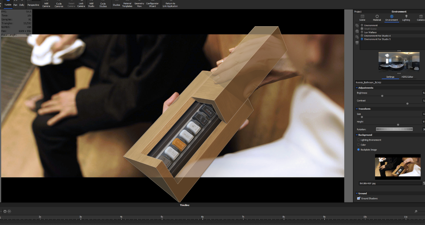

Finally had a little time to get back to this project. After lots of time studying reference images of this thing, I think I've managed to work out the overall dimensions. From there, I've been going back and forth between CAD and references to iron out the details, overlaying my 3D model onto the references.
I'm pretty happy with how it's shaping up. Pretty excited to get into building this for real.
CAD matched to still from the film

One of several reference images with a few known objects to help judge the overall size.

eethan
nice work, looking forward to see your real model. Have you decided between solid vs veneered?
