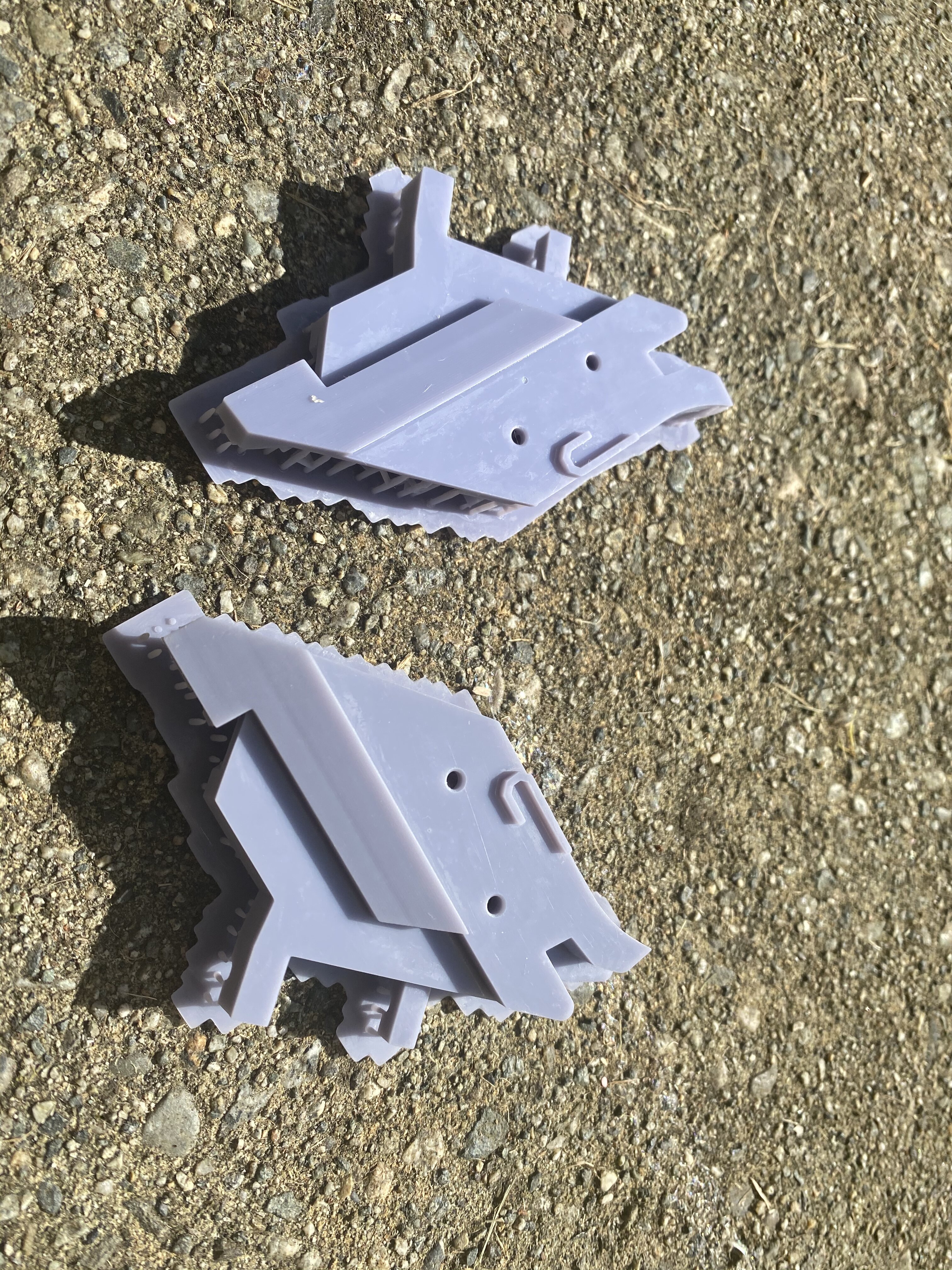

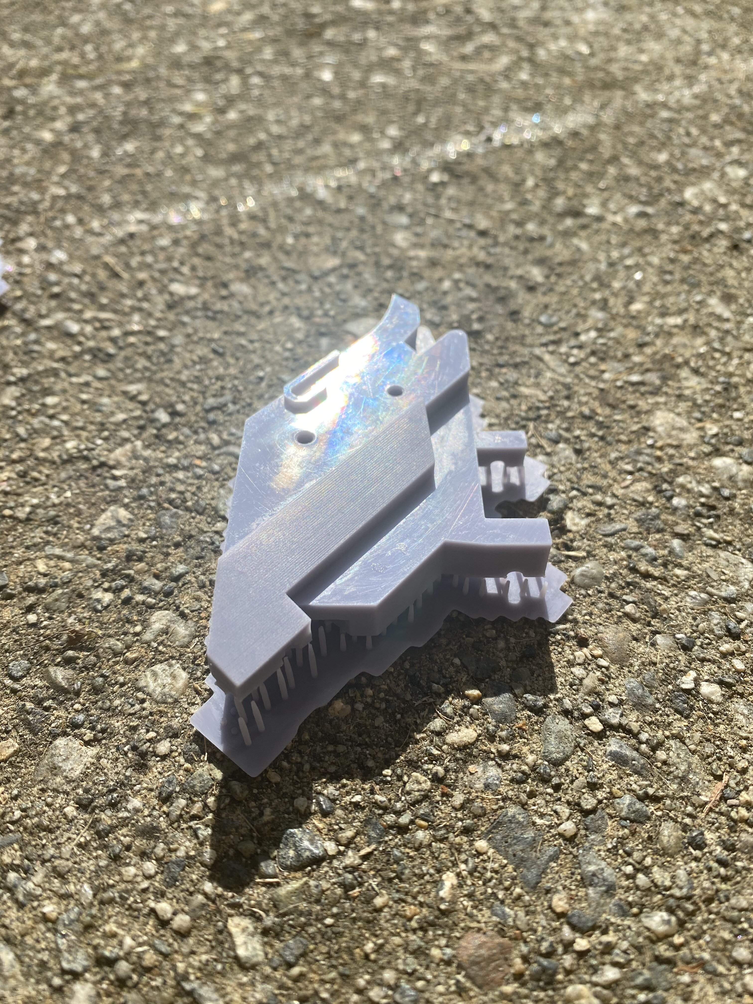

I’ve been focused on the action, i wasn’t happy with how they were turning out, so i had Boon alter the model. I’m working on the support structure for it right now, so it can print without failure. One it prints successfully, i’ll show photos of everything.

so i’ve been working on getting the action locked in prior to molding.
if you remember these from my last post...

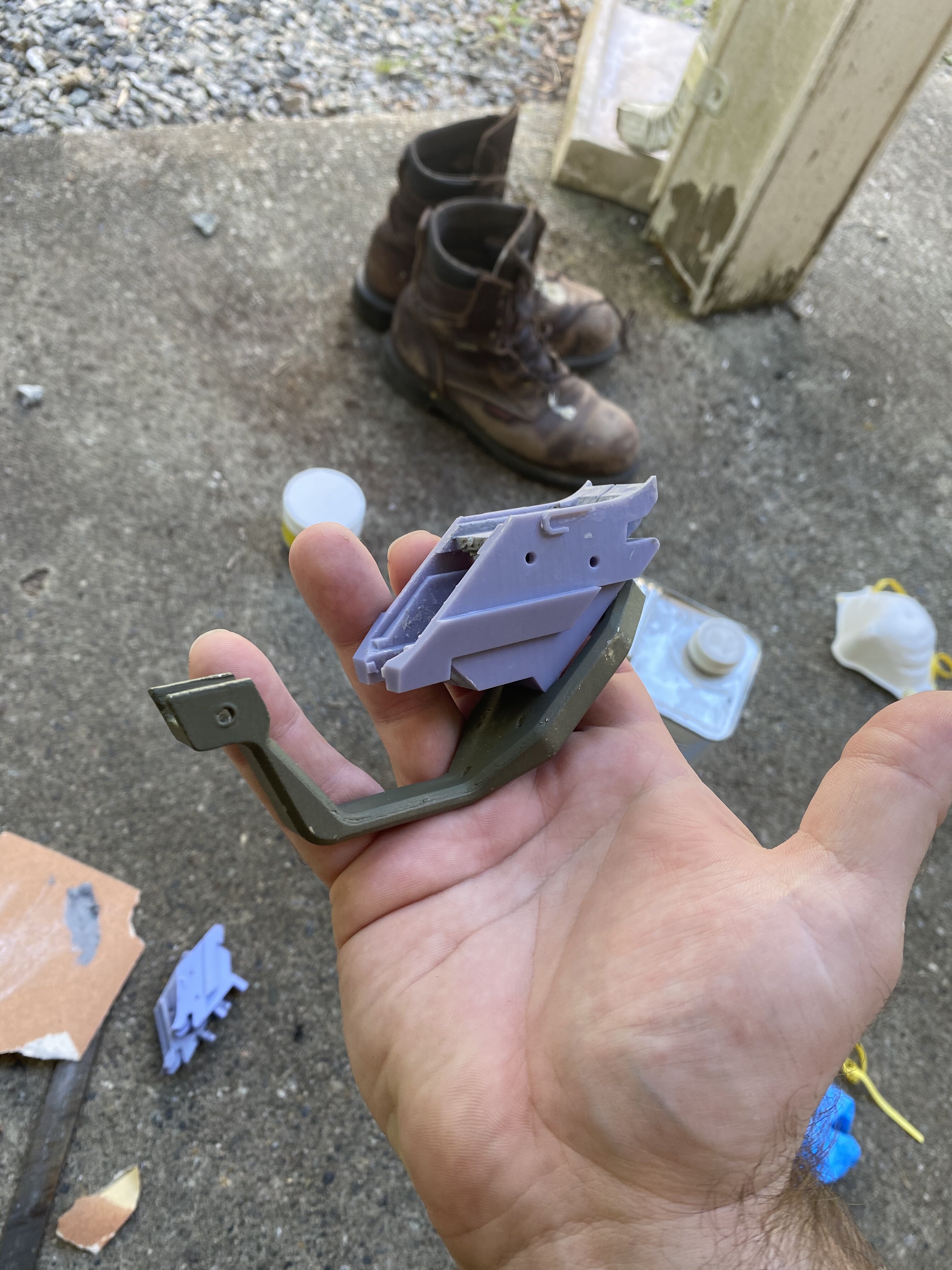

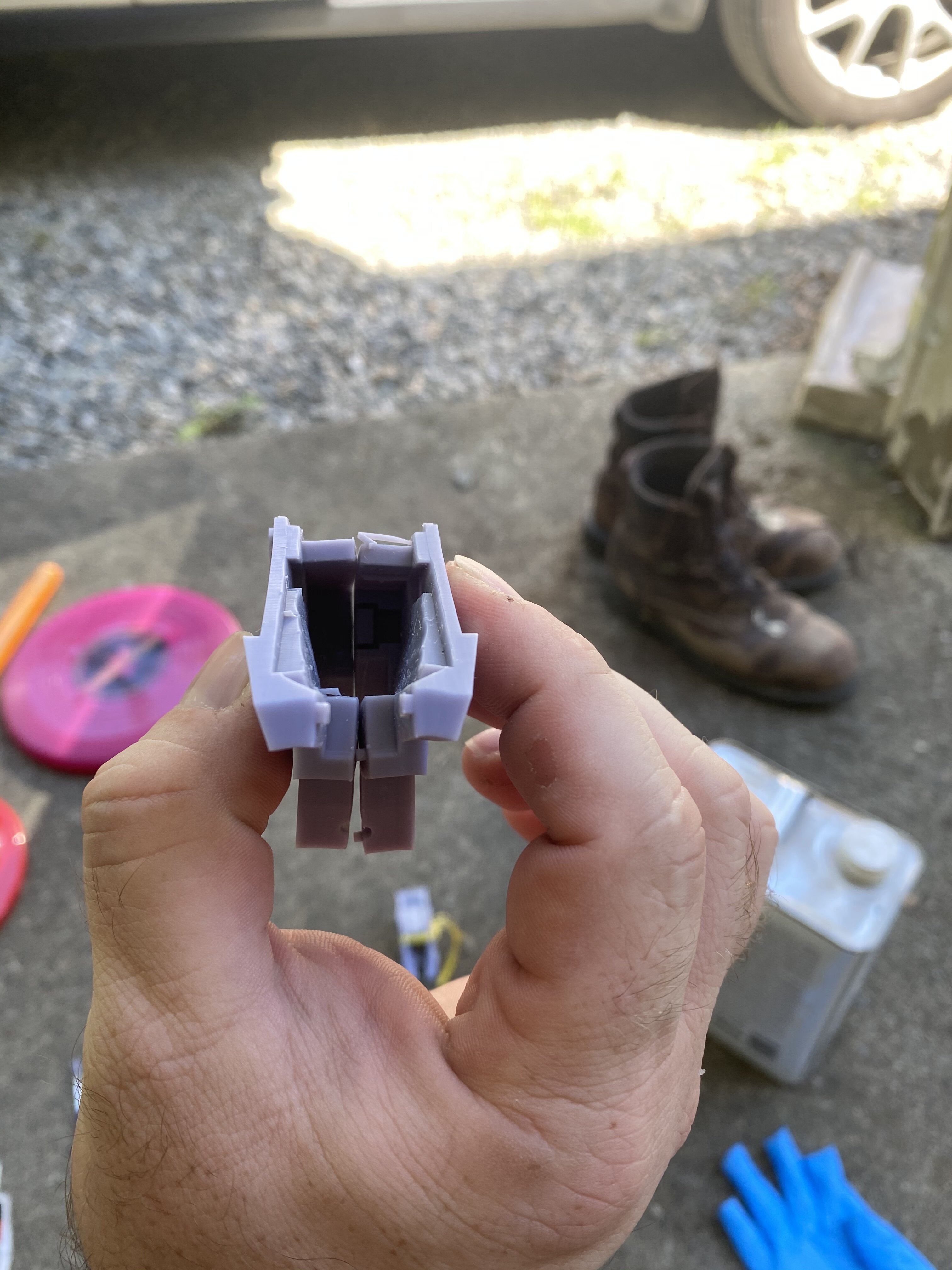

These prints looked beautiful, but when i pulled the supports off, this is what i was left with for fit...
so i went back to my slicing program and tried different orientations and support locations...
and after a week of what i call “learning opportunities”
The pieces weren’t perfect, but close enough that i could prep them to be..

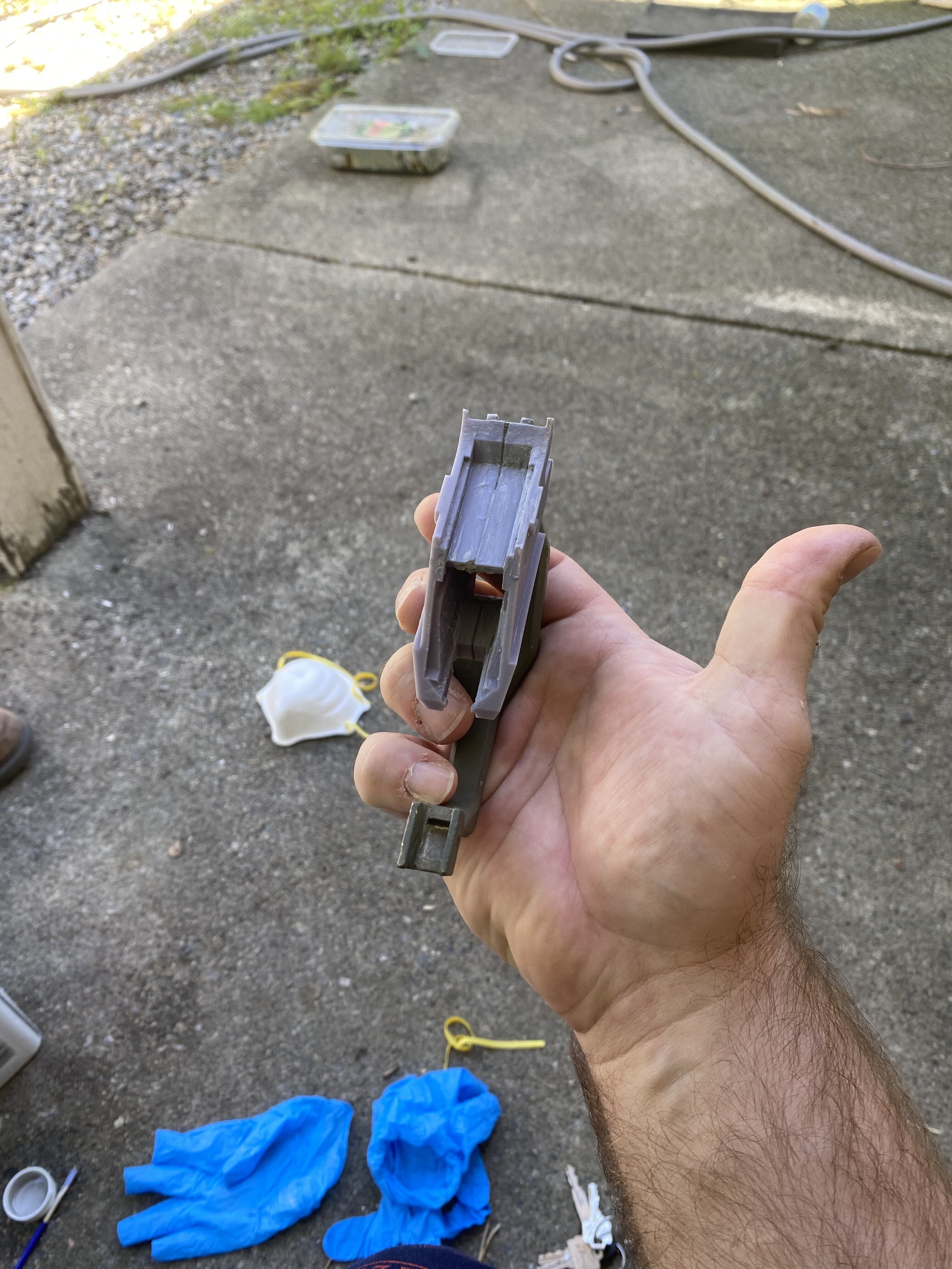

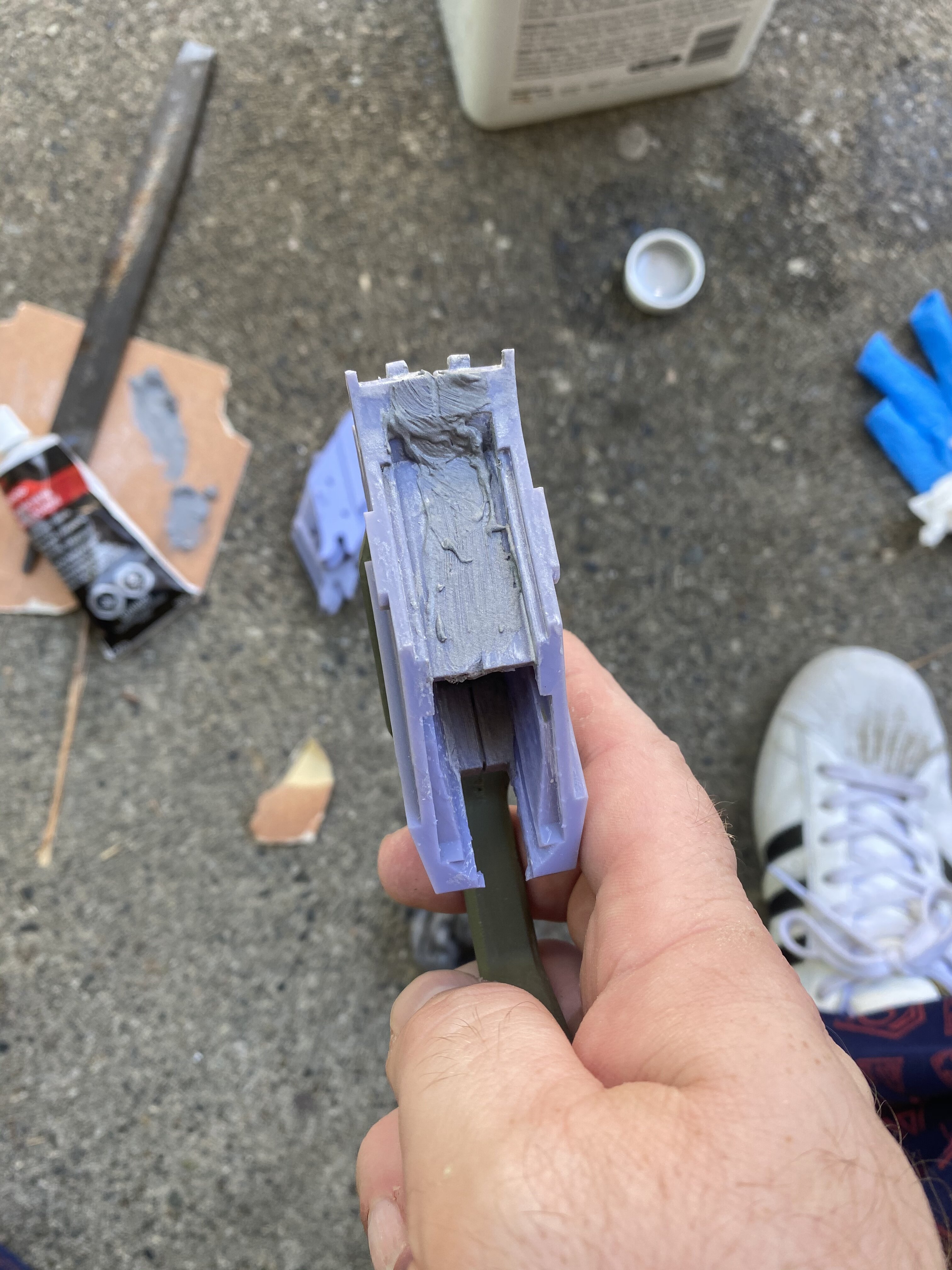

With a little bit of filing, everything fit well; but i still had a little bit of gappy gappy.
So i broke out my Bondo Plastic Metal, and applied liberally with a brush...
Then i washed it down with lacquer thinner and allowed to dry.
I
The process is repeated until i’m happy that i have a nice tight joint.
