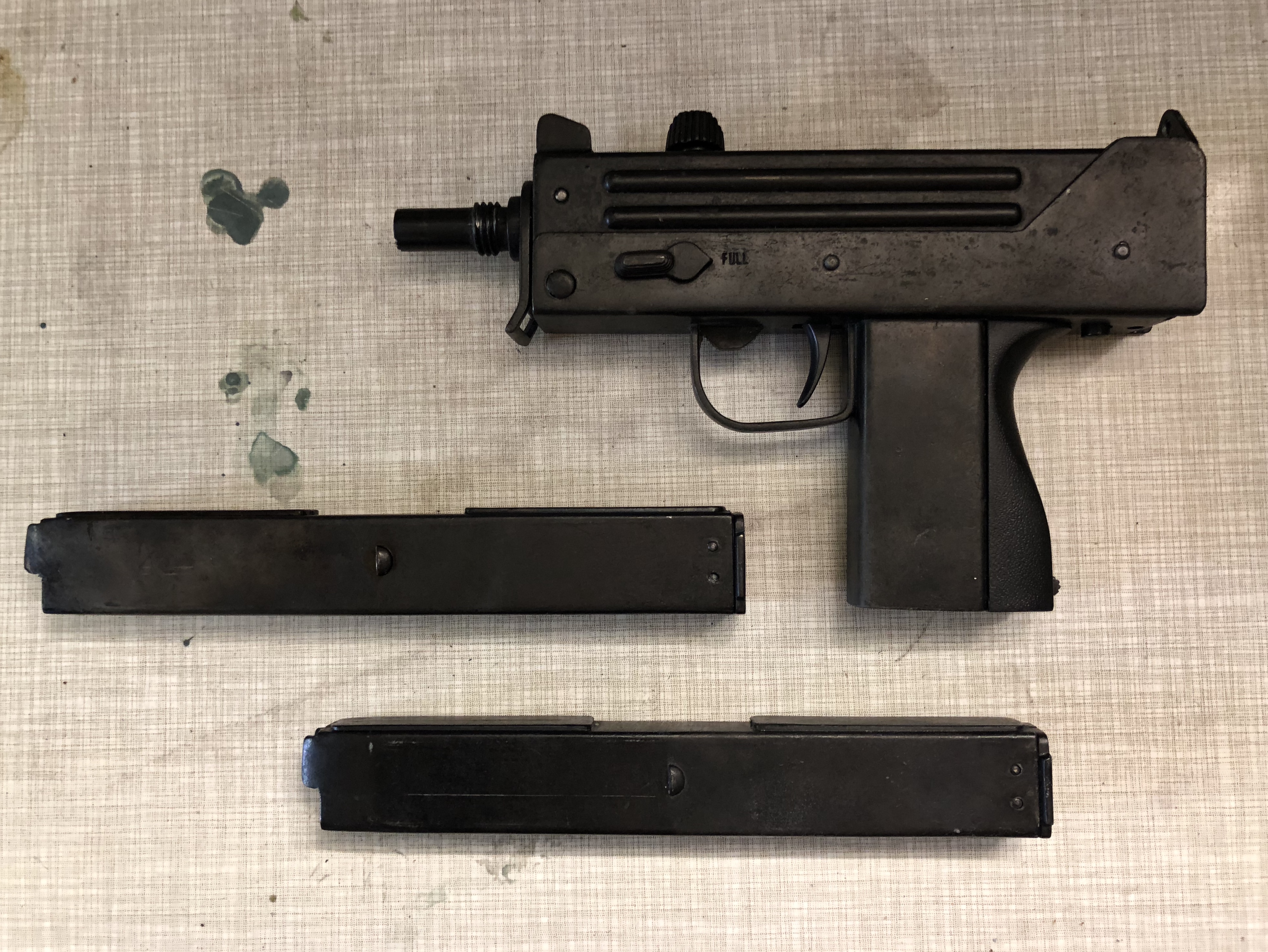

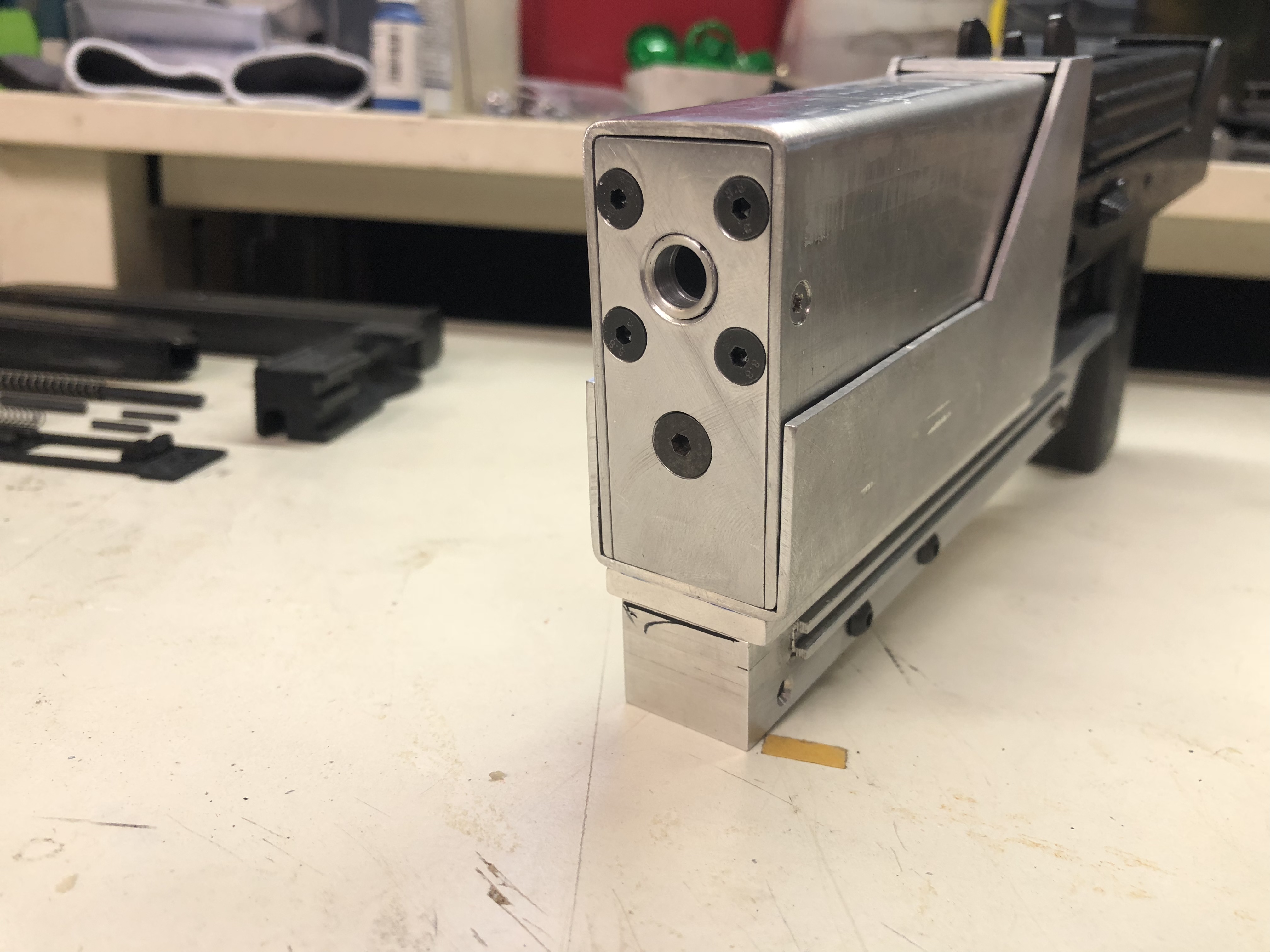

Here I want show another project of mine. The MAC11 MP from the first Blade movie.
It‘s based on the Denix replica model. I had to modify this on several parts. All additional parts are made from aluminium
I started with this. I managed to get an additional magazine. I wanted to build it with a long and a short mag.

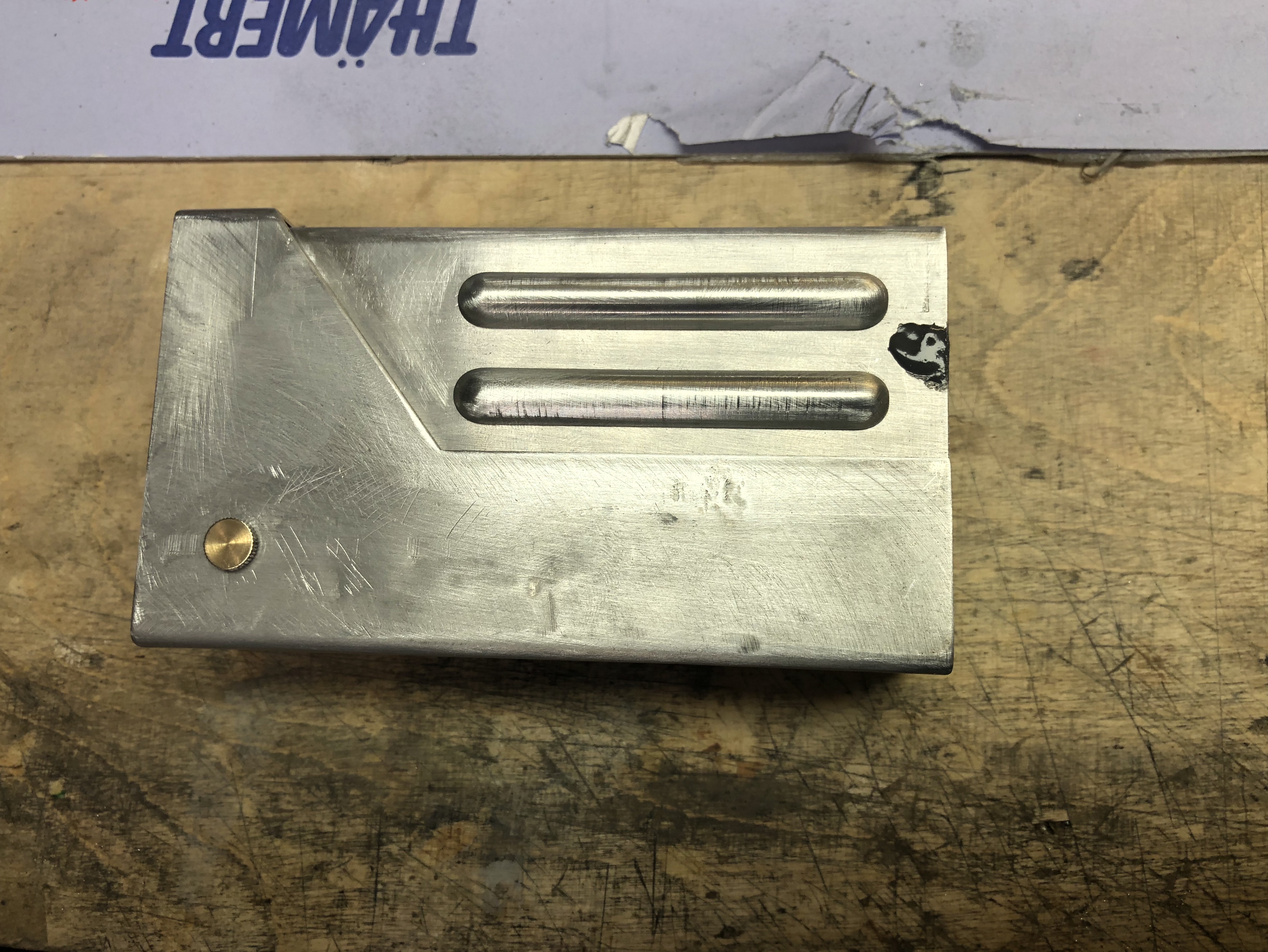

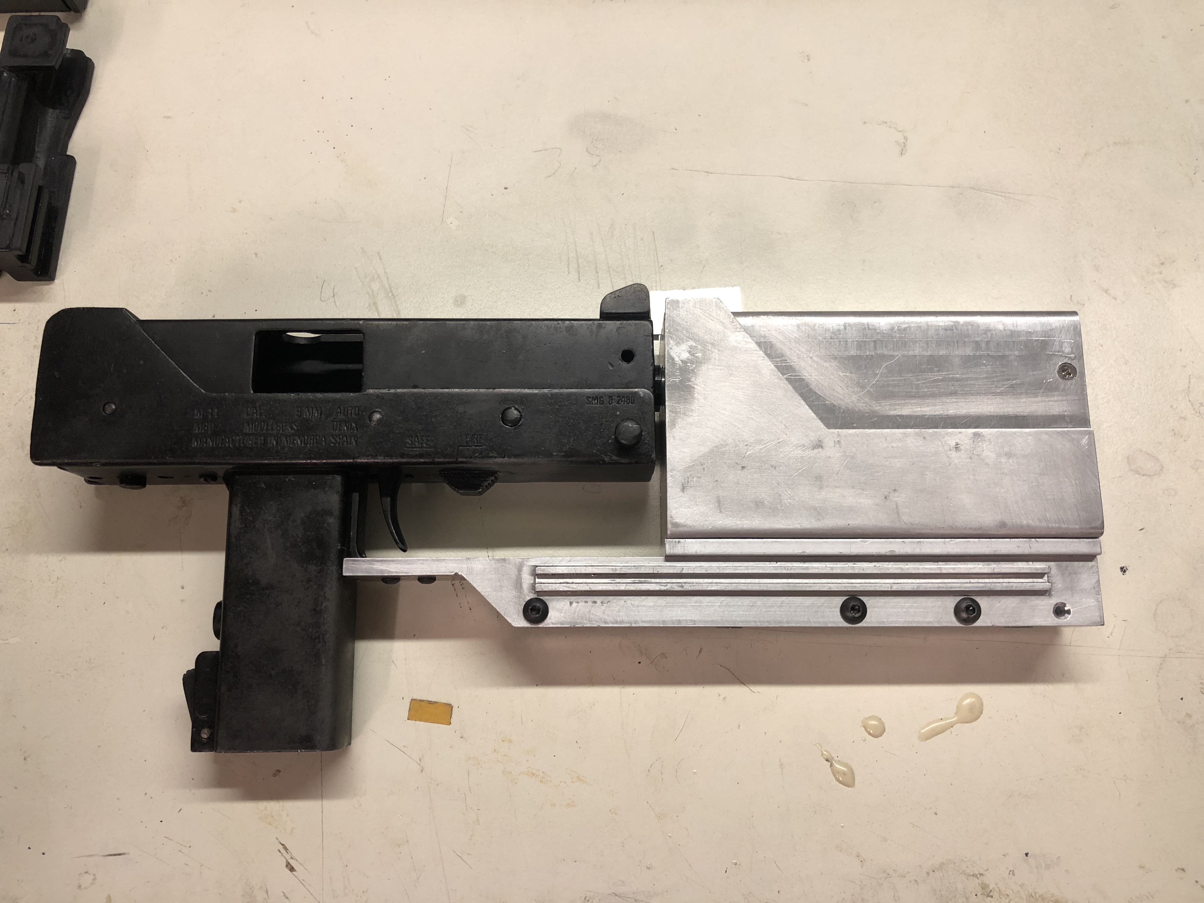

I made the housing from 2mm aluminium sheets, all the rest is milled

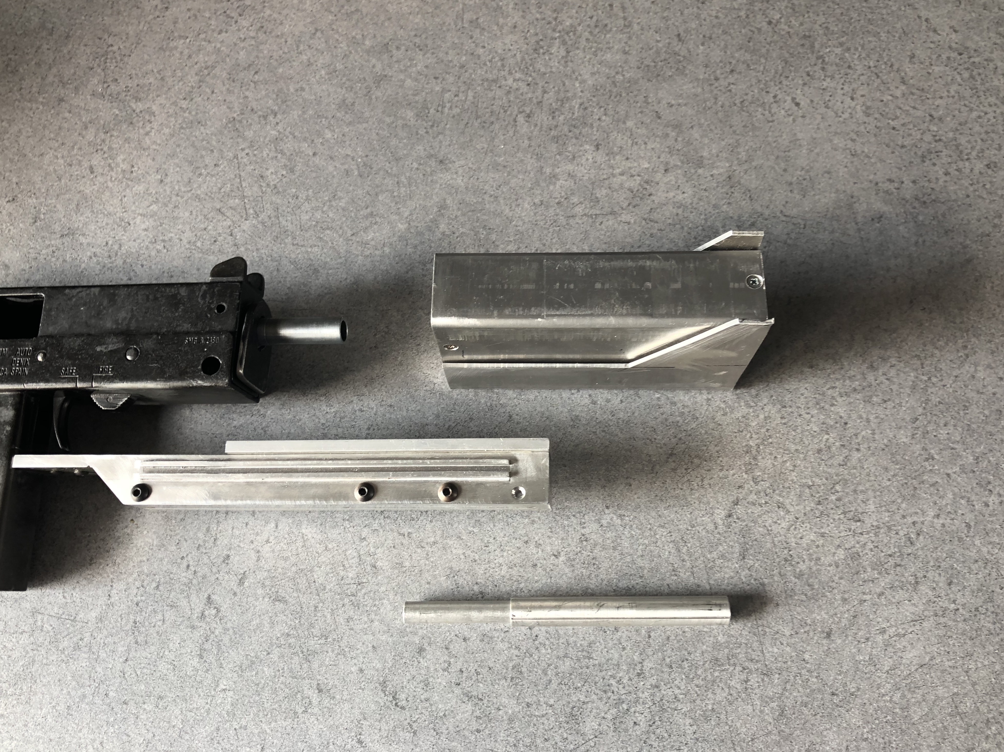

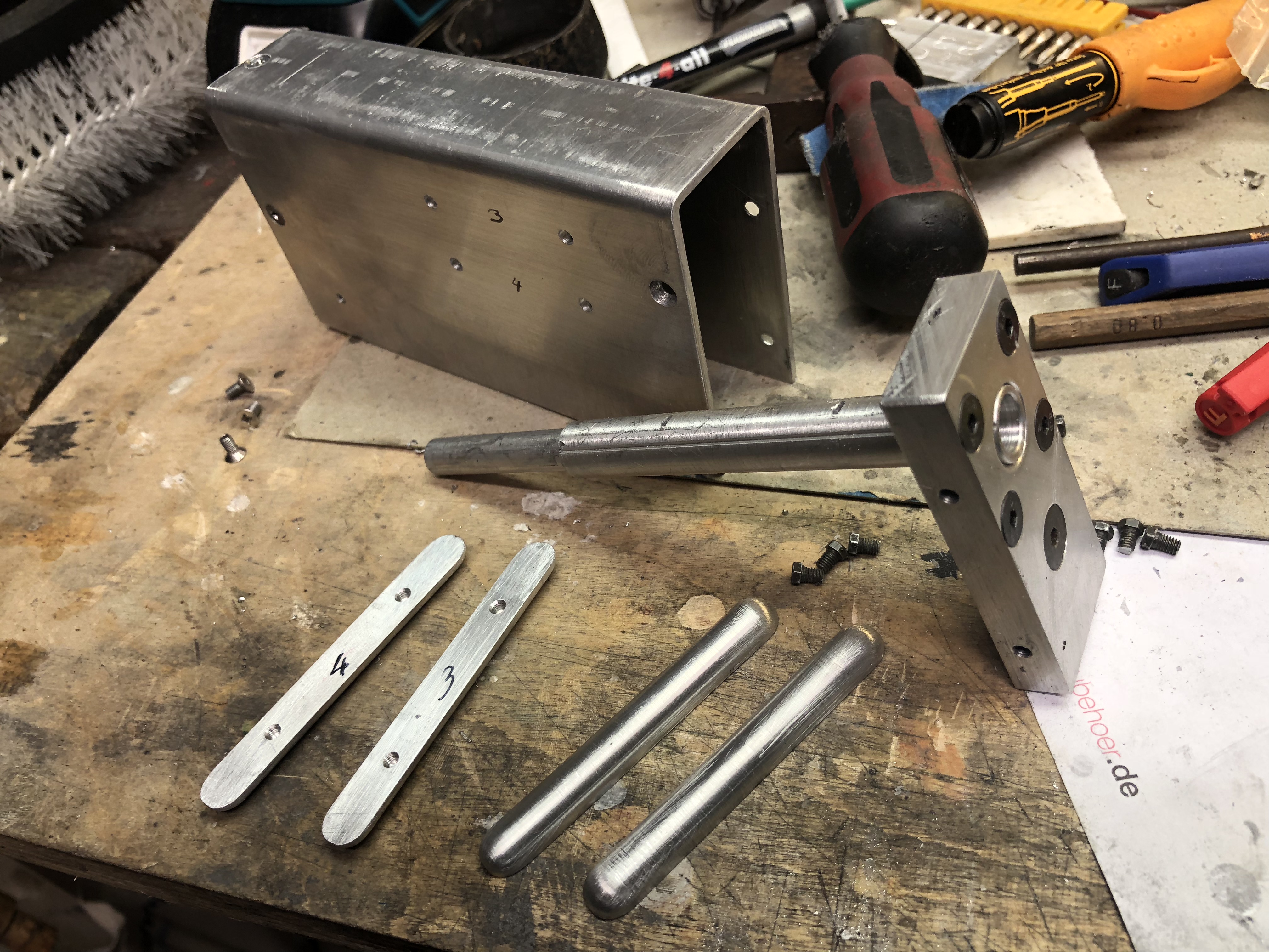

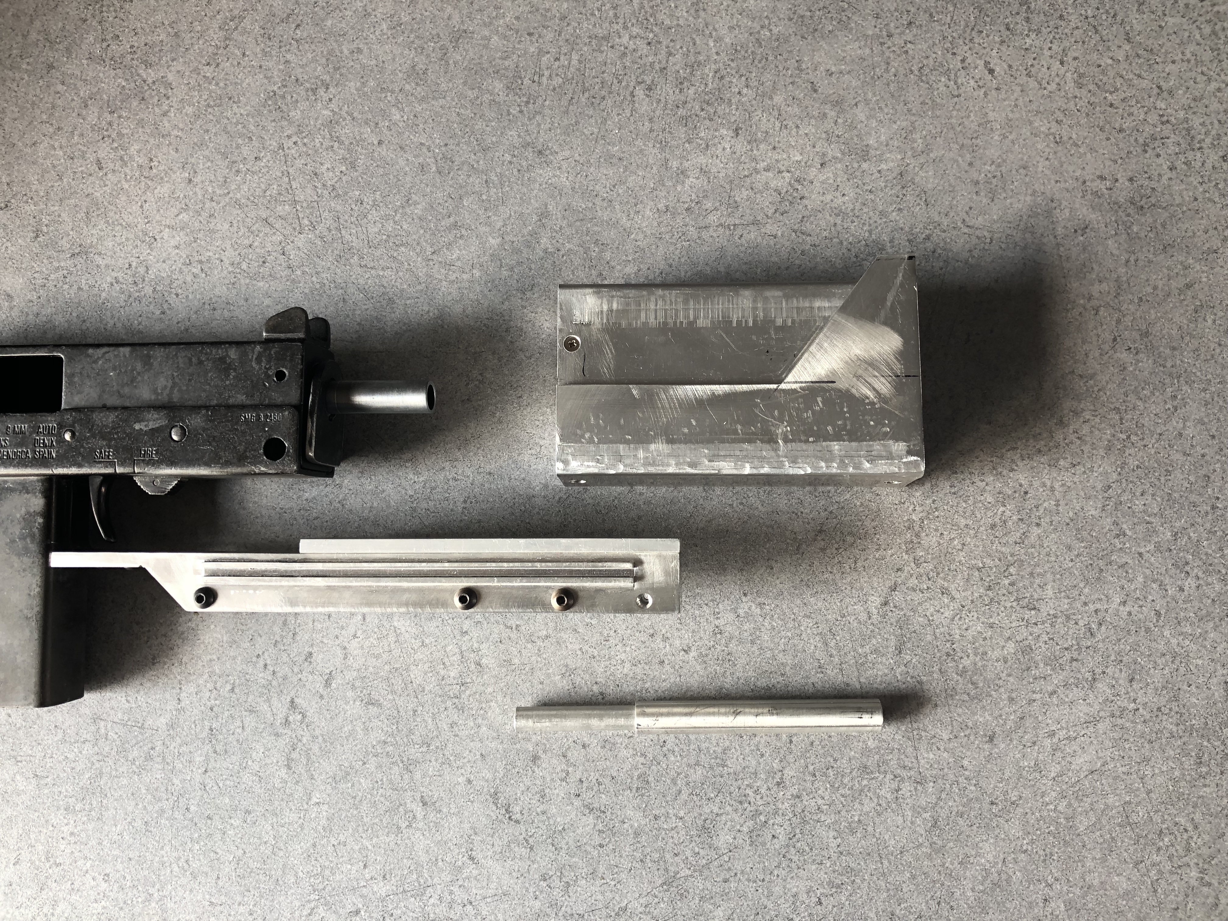

Here are all parts and a test fit of them.
The half rounded parts on the housing were a little tricky. I made them as round parts, cut them in half and milled the from the back. They are screwed to the housing.

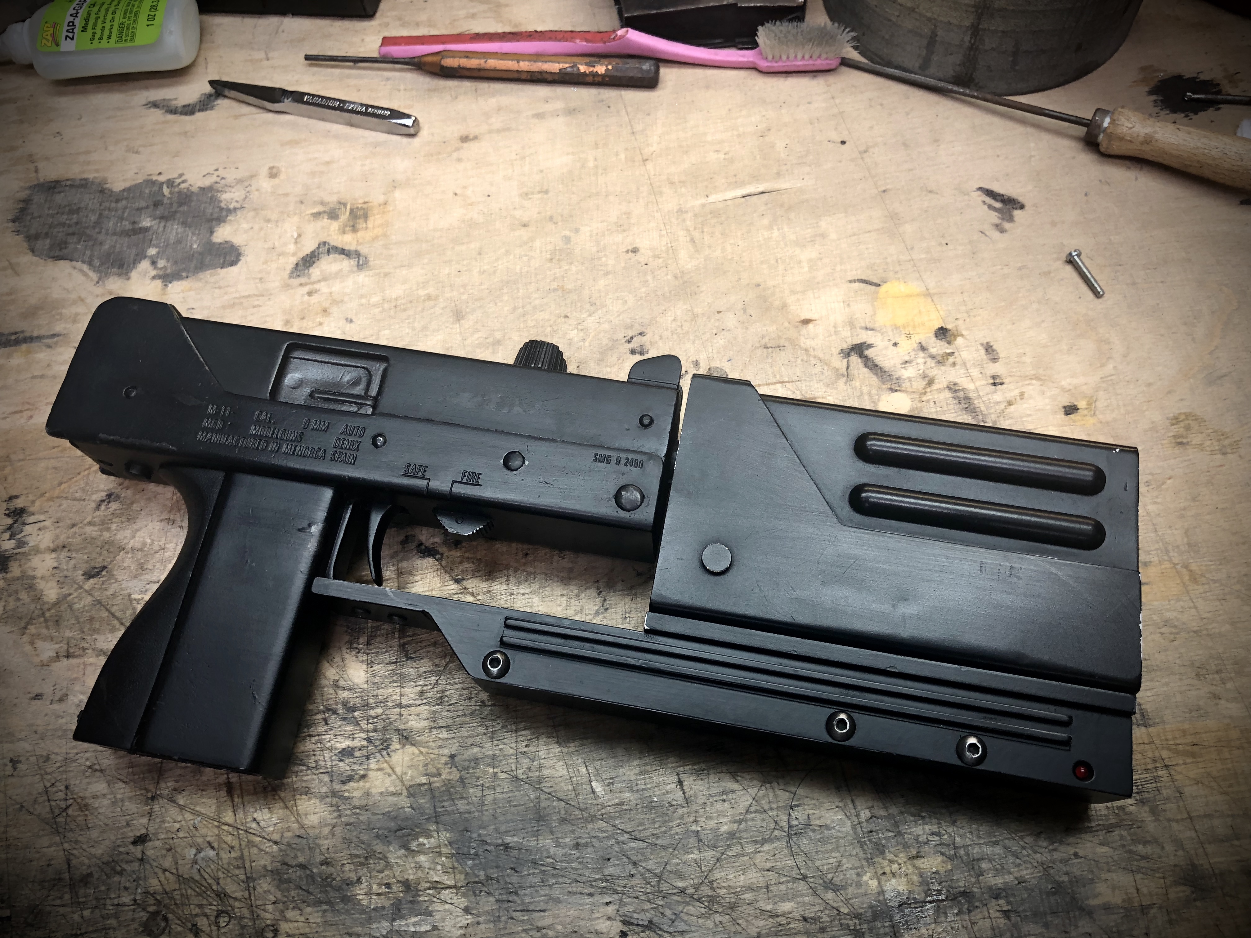

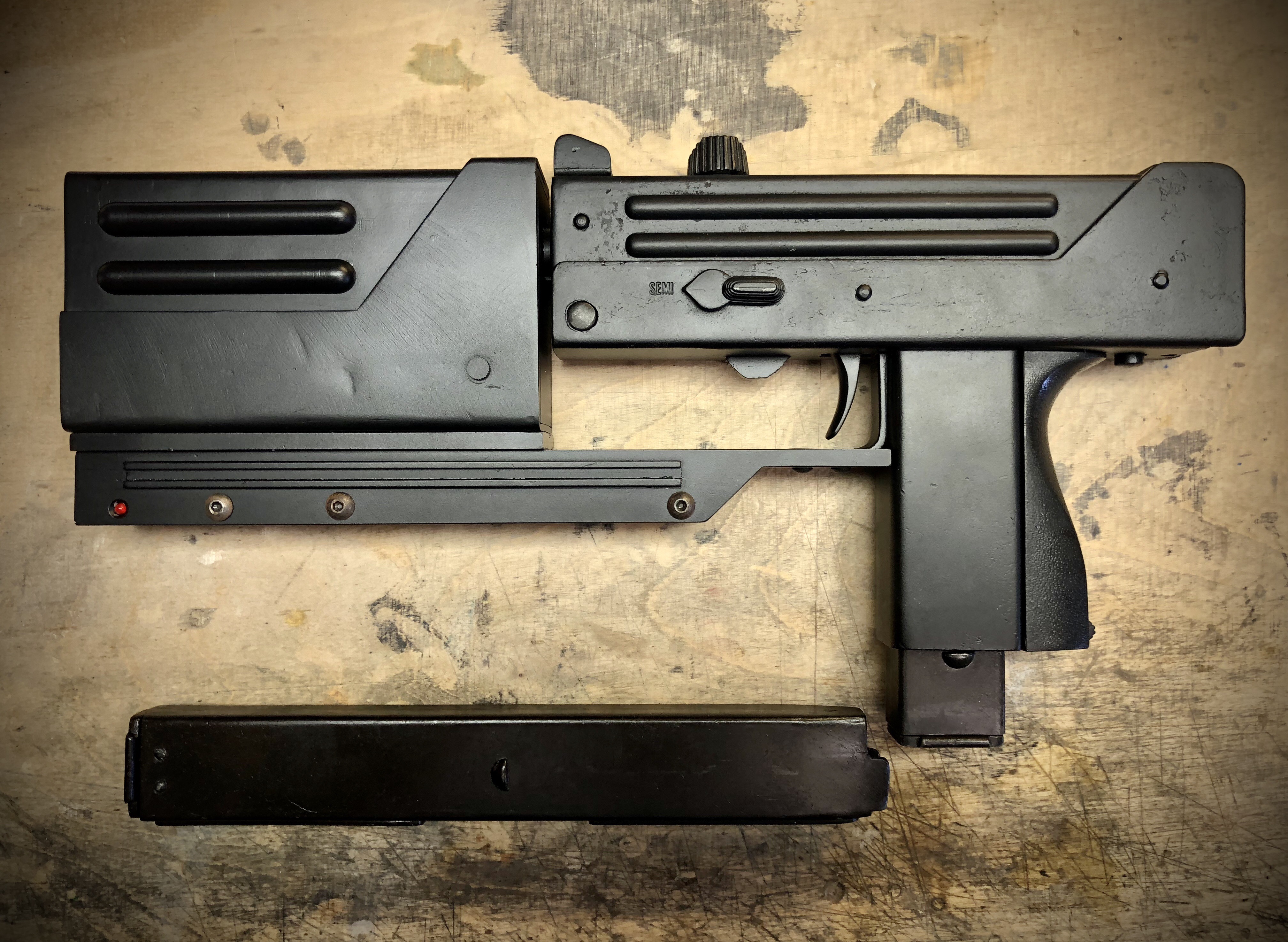

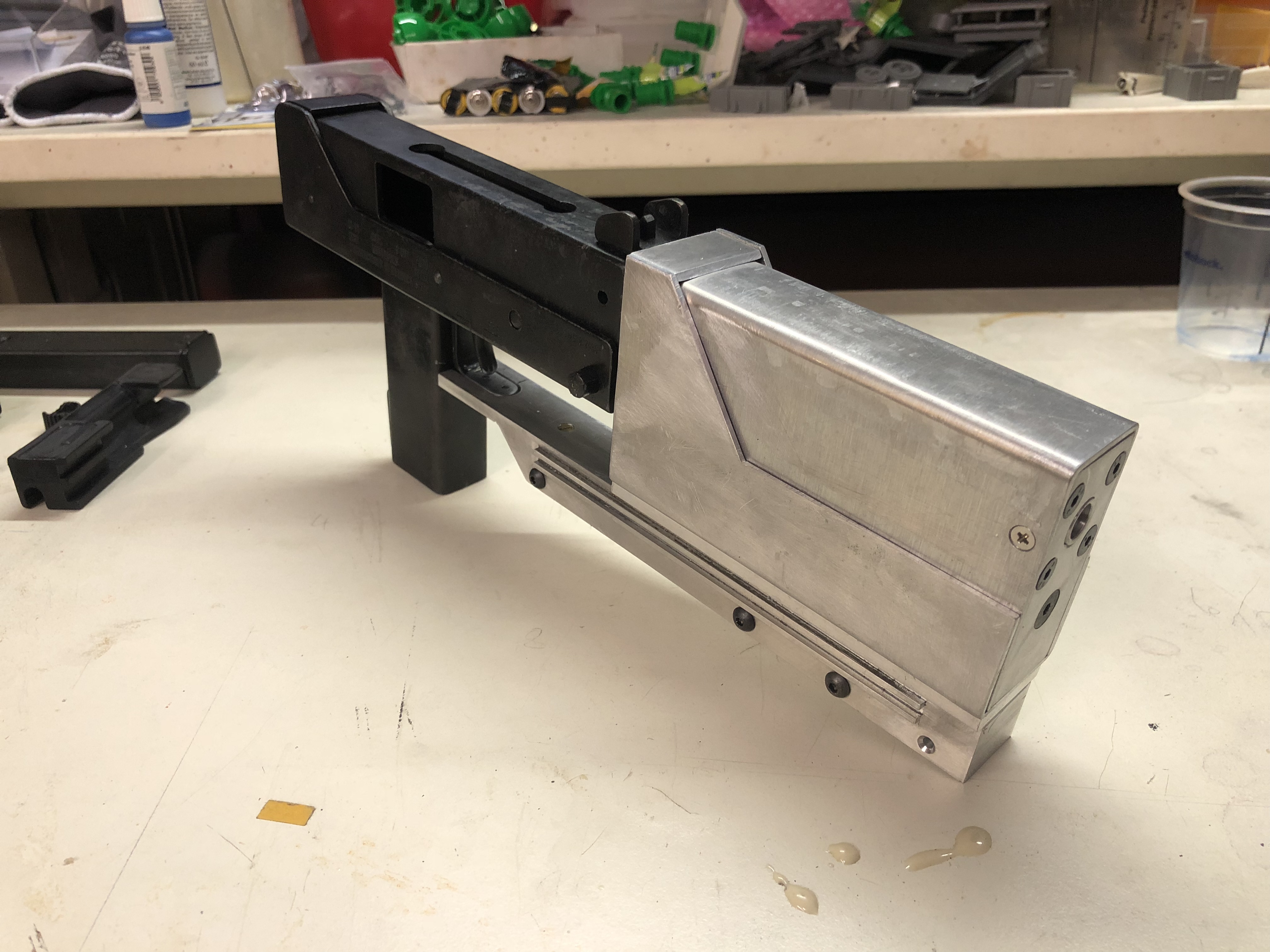

And here‘s the completed thing. I‘m happy how it turned out.
Please tell me what you think of it.
