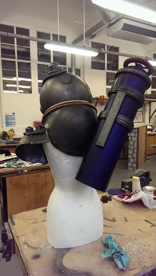

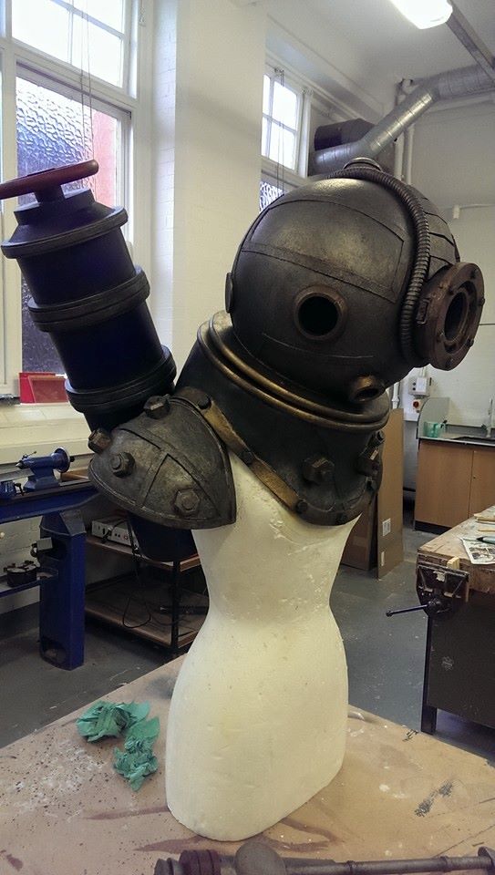

Okay so I'm making a Big Sister cosplay for the upcoming MCM convention in London in May and thought it would be fun to share my progress.

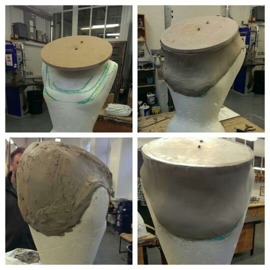

I first started off with the neck piece, I used an old mannequin and sculpted the neck piece shape and size. From here I was then able to cover the sculpture in plaster to get a mould of the neck piece which I then coated in resin and fibre glass to make the final neck piece.

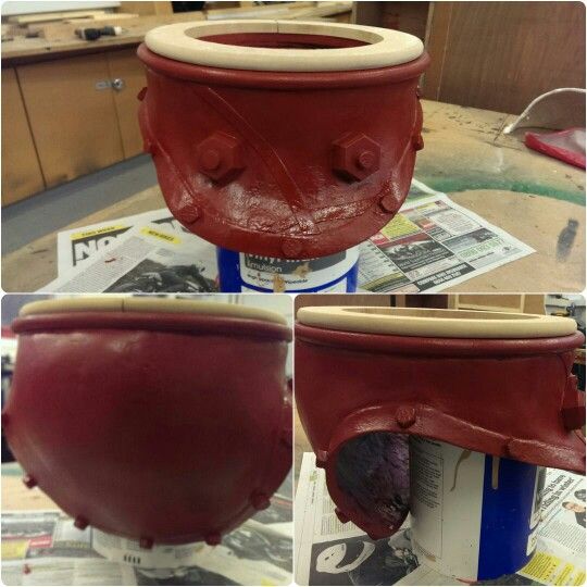

Once I had the neck piece I then sanded down all the edges to ensure there were no sharp edges and to neaten them. Next I added the first coat of primer i then sanded the neck piece again before applying a second layer of primer.

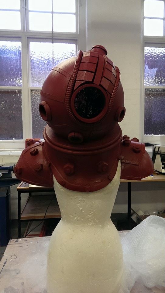

Next all of the trims/details were added, such as the bolts. The front two bolts were made out of wood and the smaller bolts around the ring of the piece were made using resin. It was then primed a final time ready to be painted!
