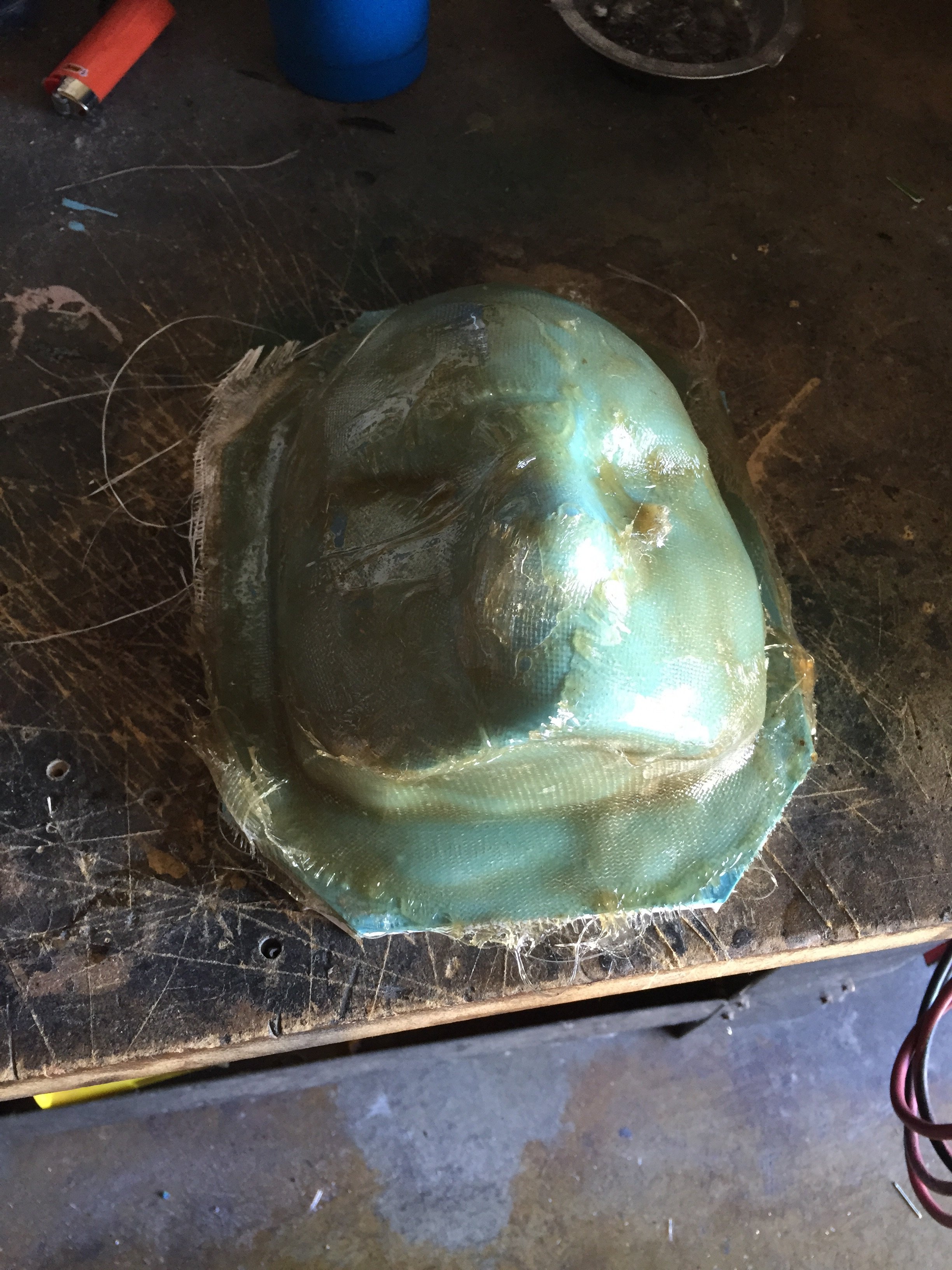

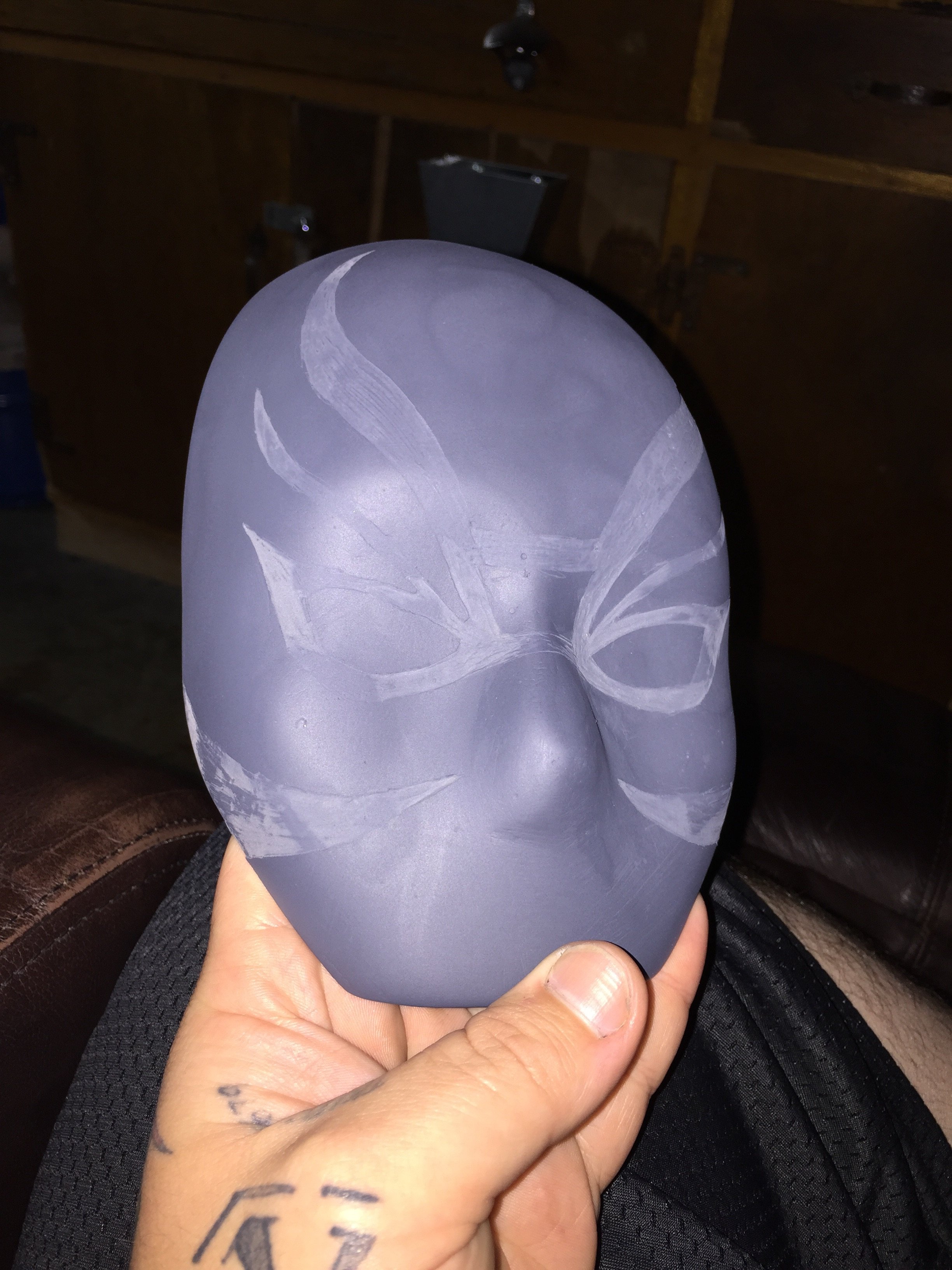

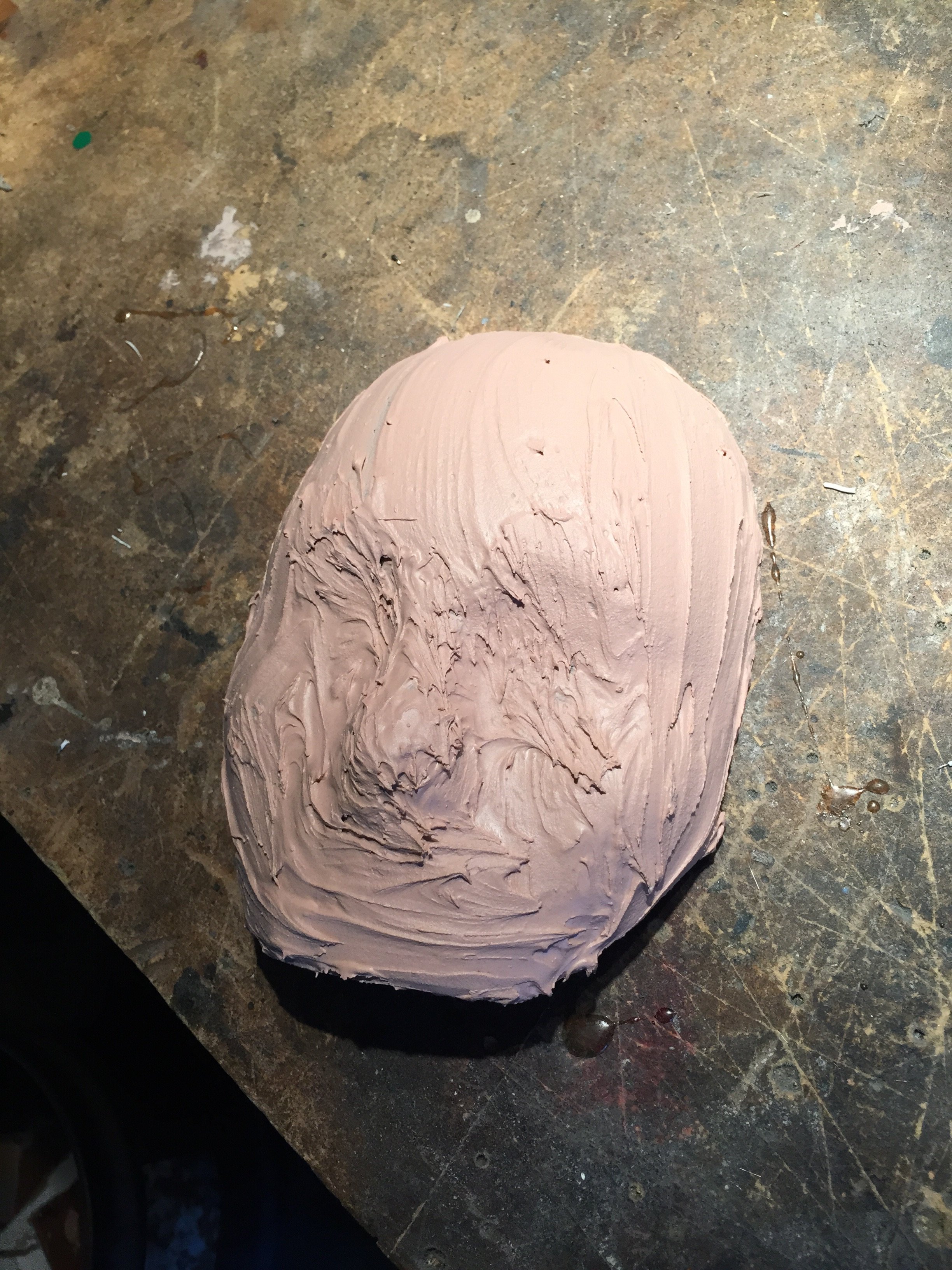

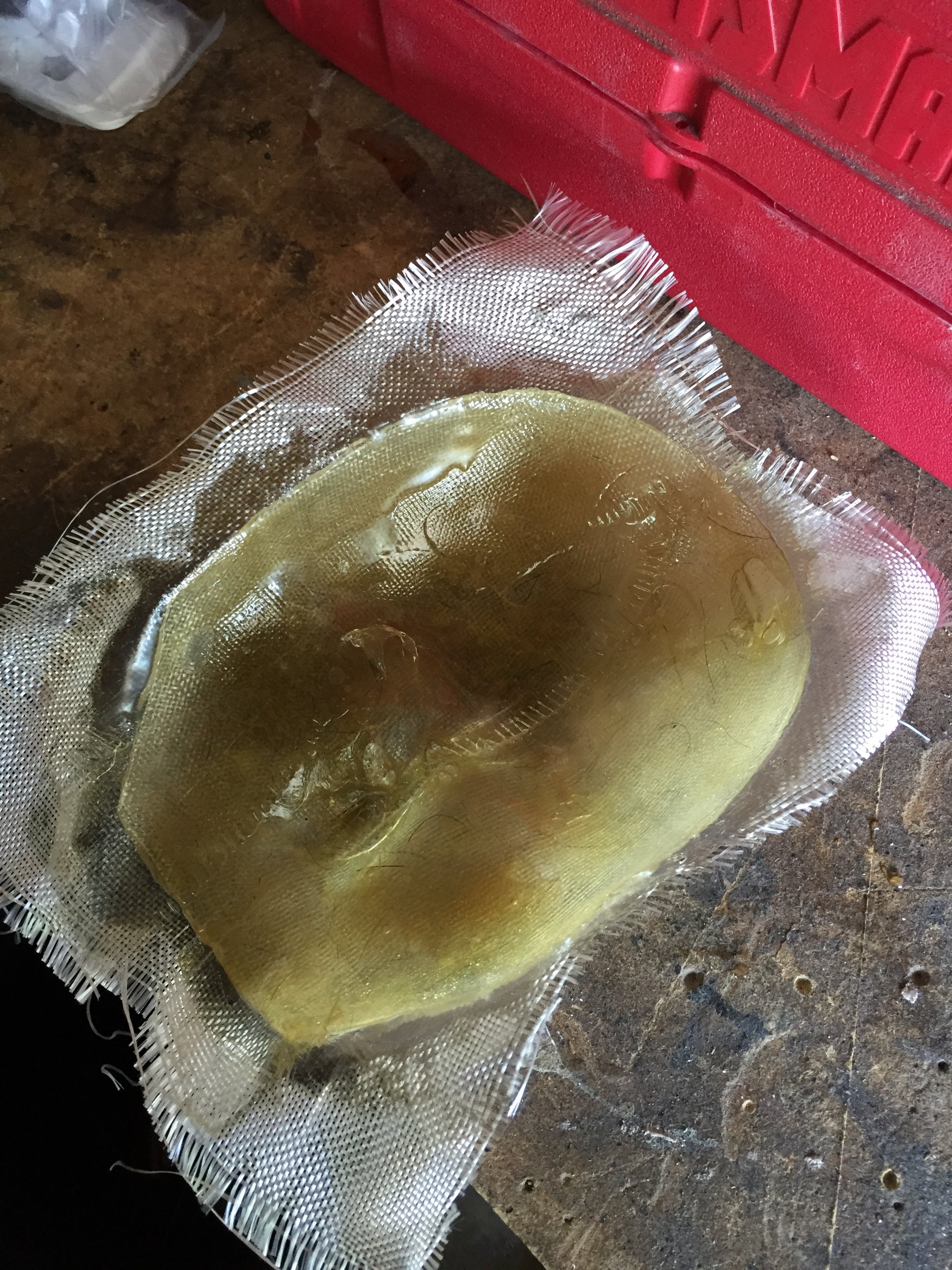

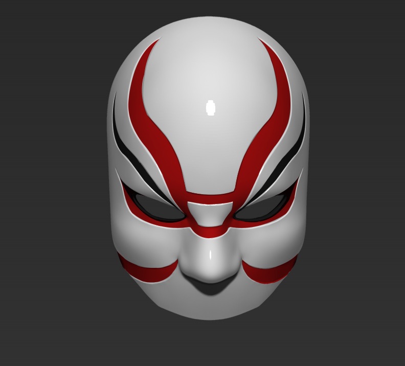

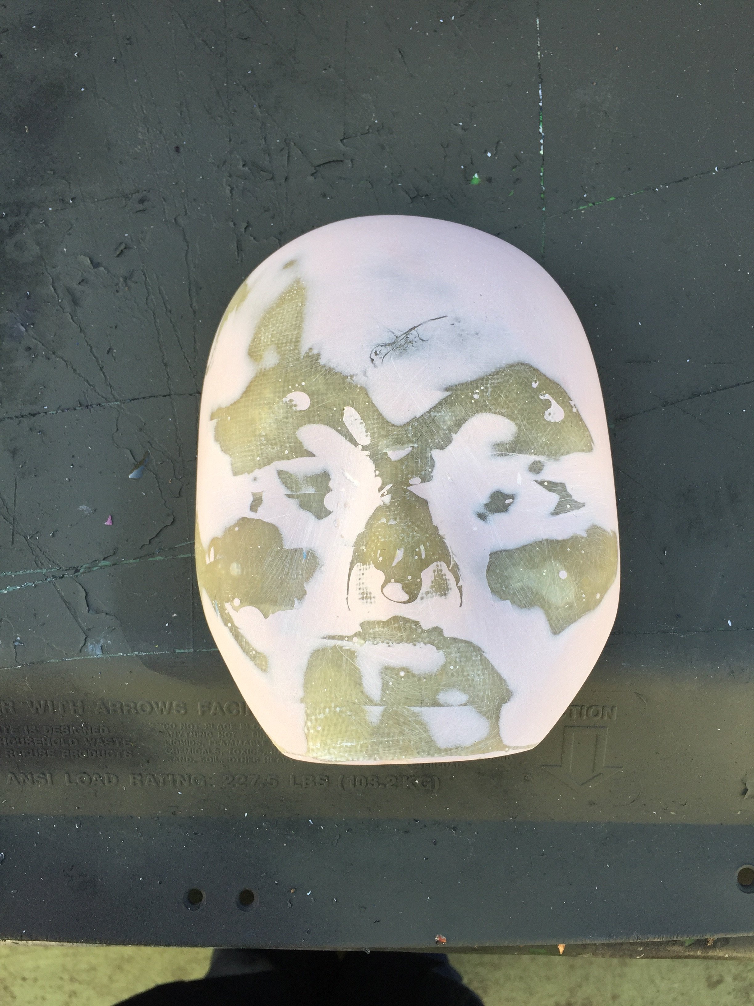

So I bought a white mask from Michael's and fiberglassed the inside trimmed it down bondo'ed it then primed and etched in the detail. My OCD kicked in and it wasn't "perfect" enough for me so I got in contact with santiclaus a 3D modeler here on the RPF gave him some reference photos and this is what he sent me

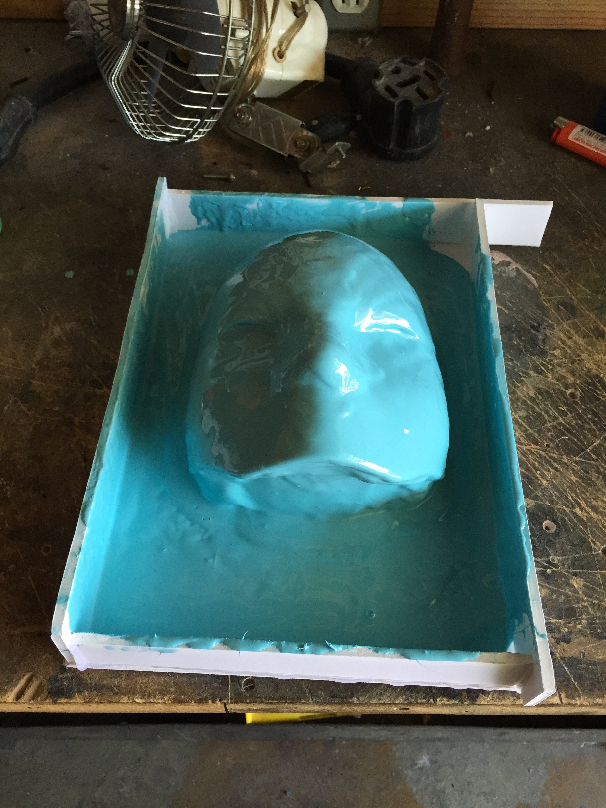

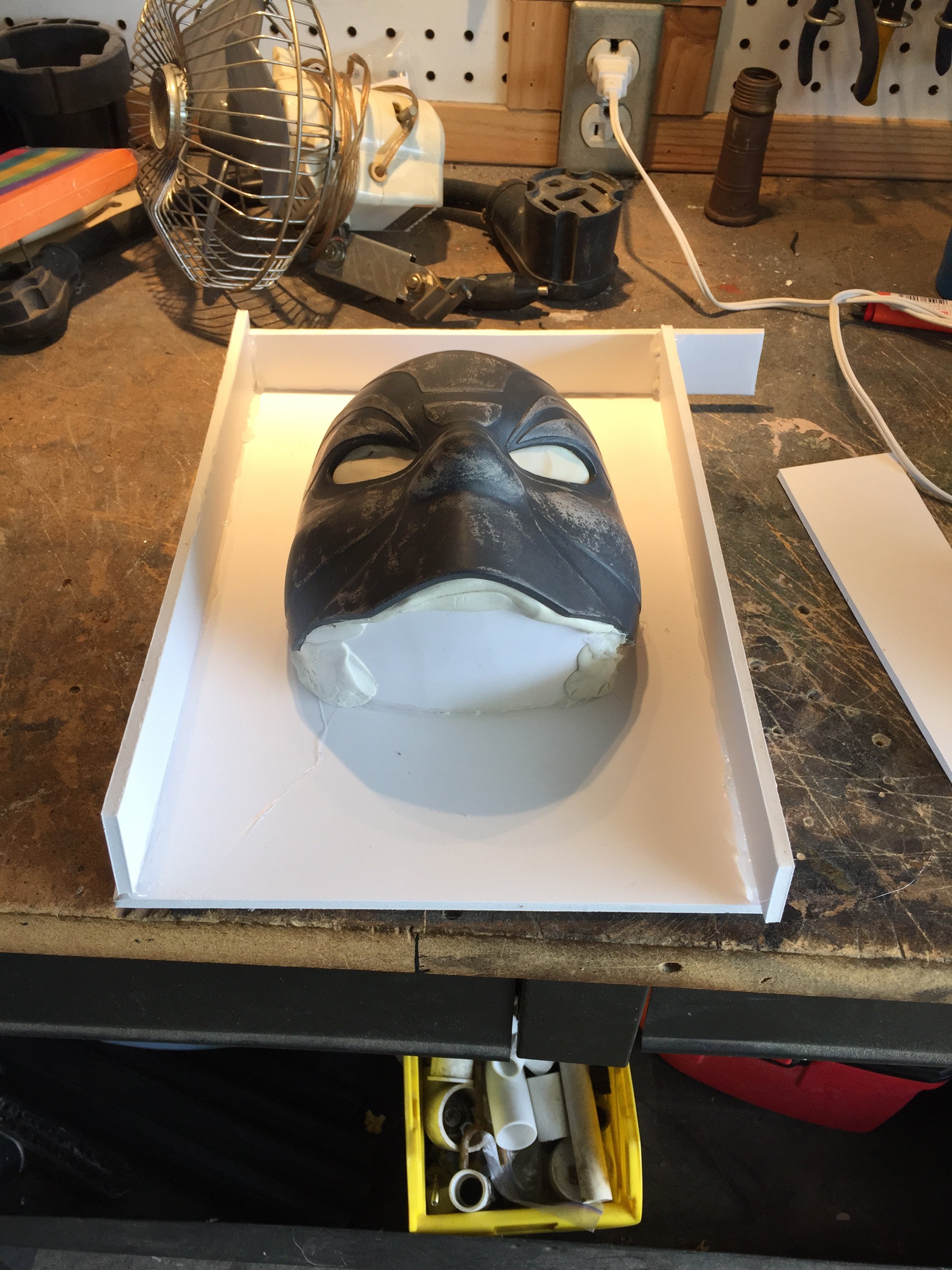

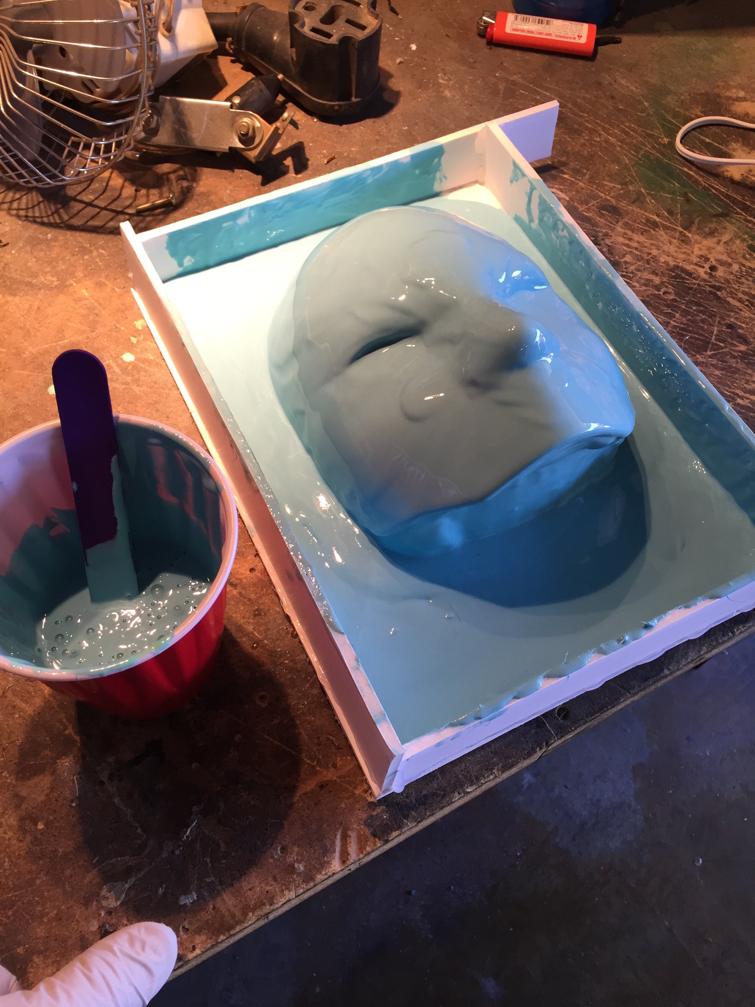

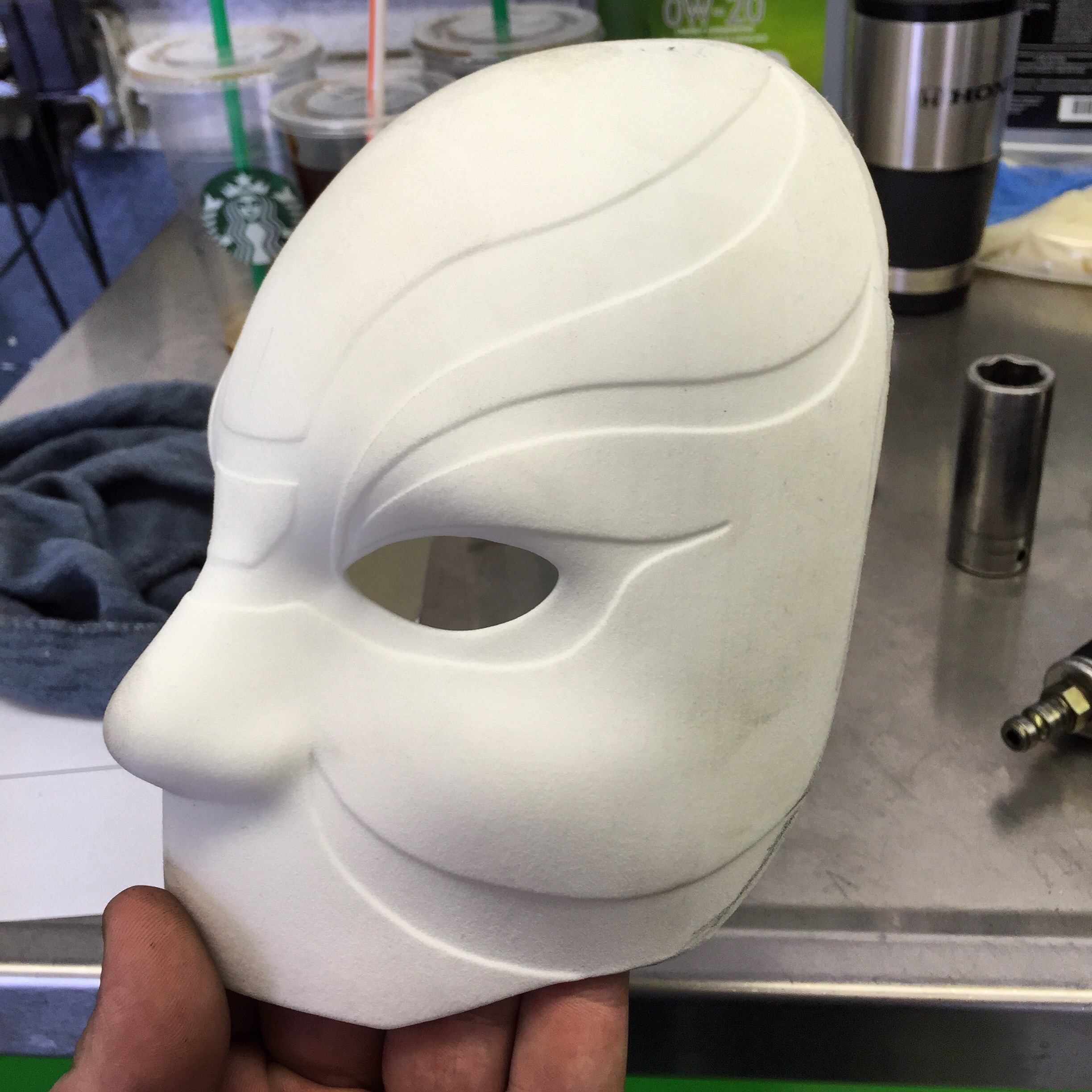

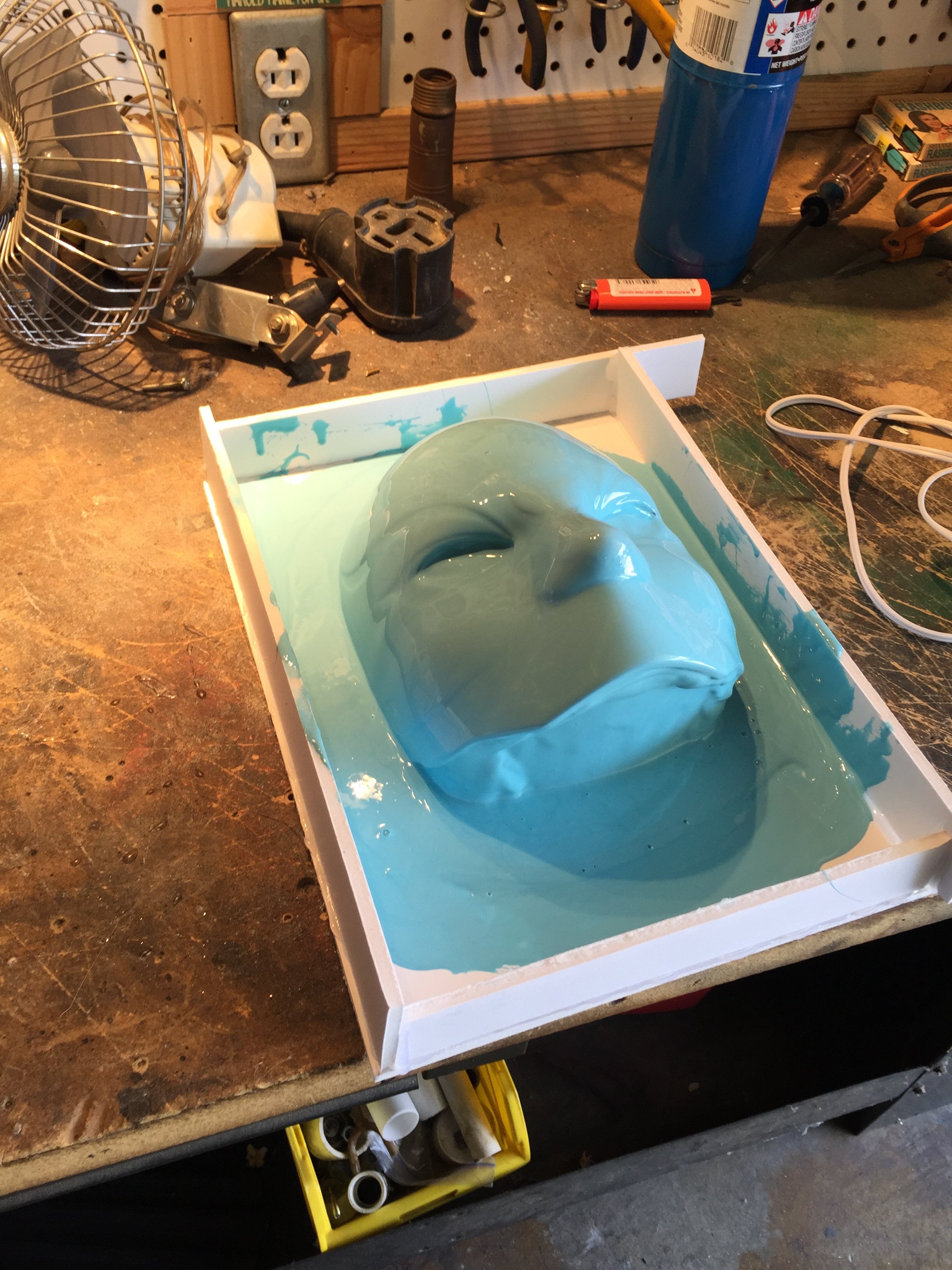

So I uploaded it into shapeways and had them print me one and when I got it I sanded it primed it and am in the process of molding it now .

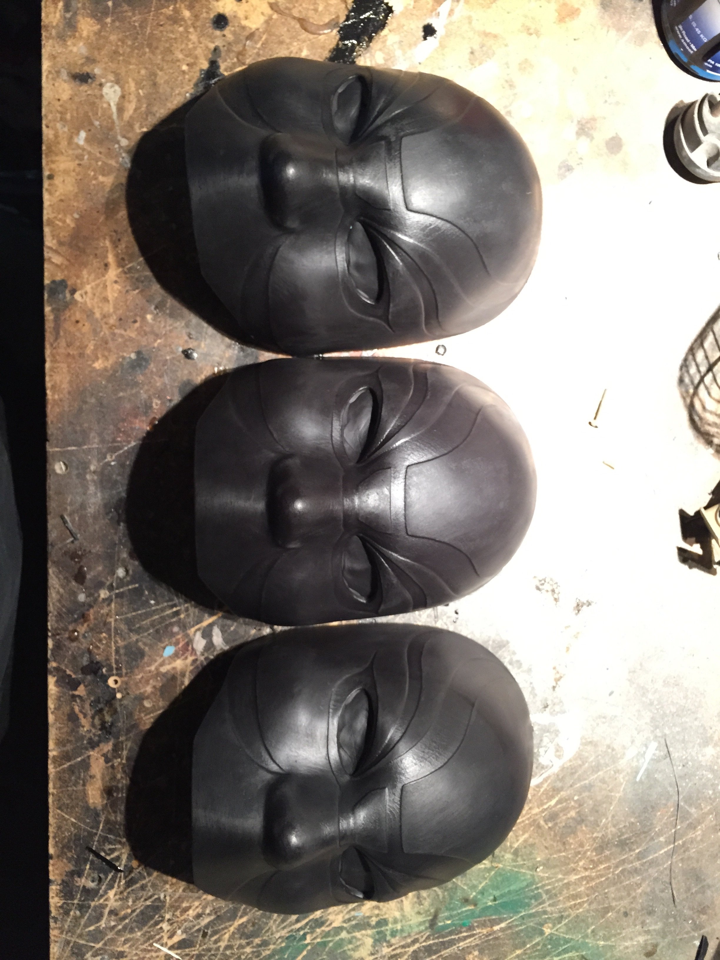

It takes a little bit to get the hang of casting but yours look to be coming out great! Looks nice and smooth!
Thank you !! The sides are a little difficult to get and equal thickness on but the third cast is a lot better .

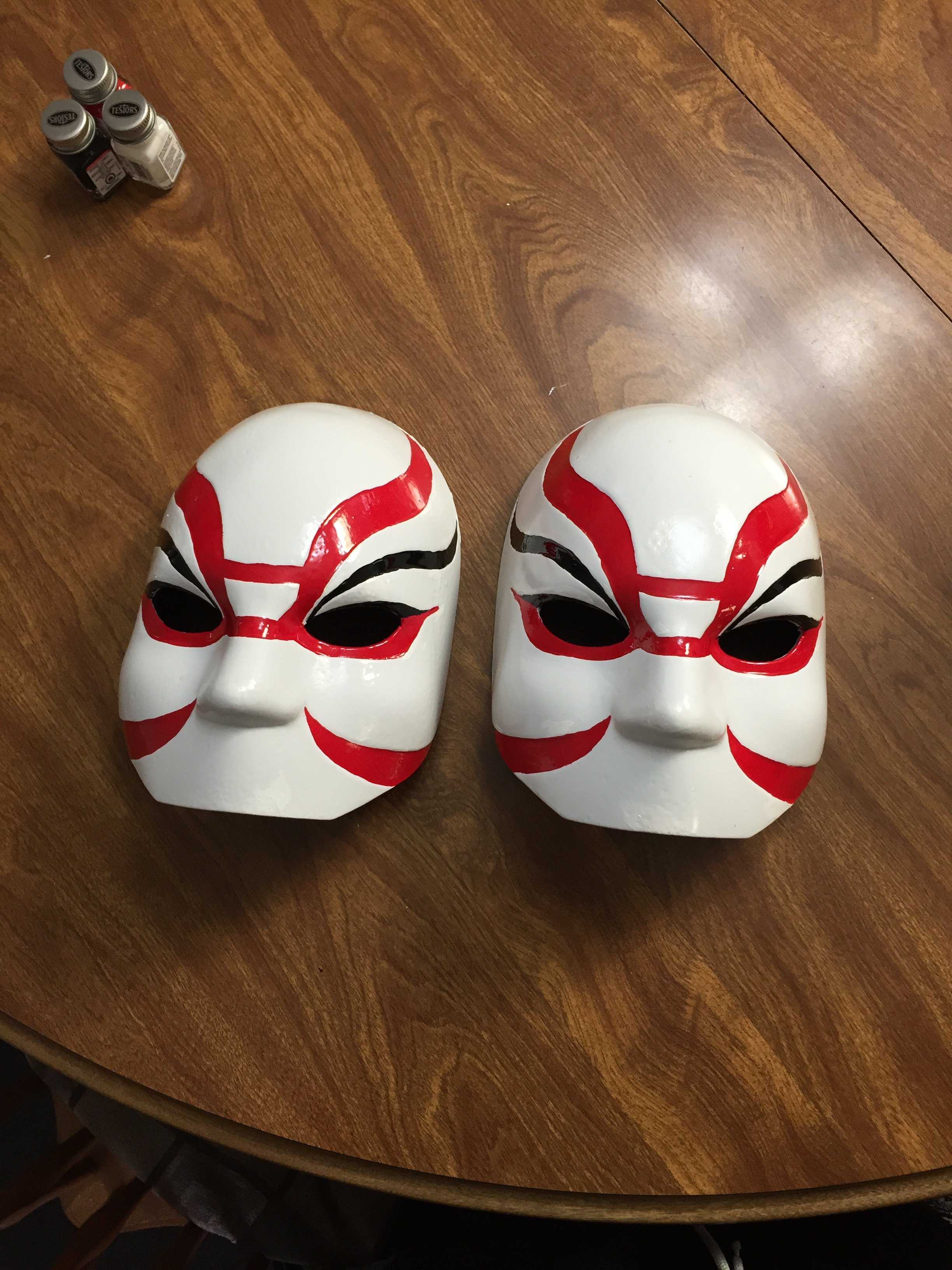

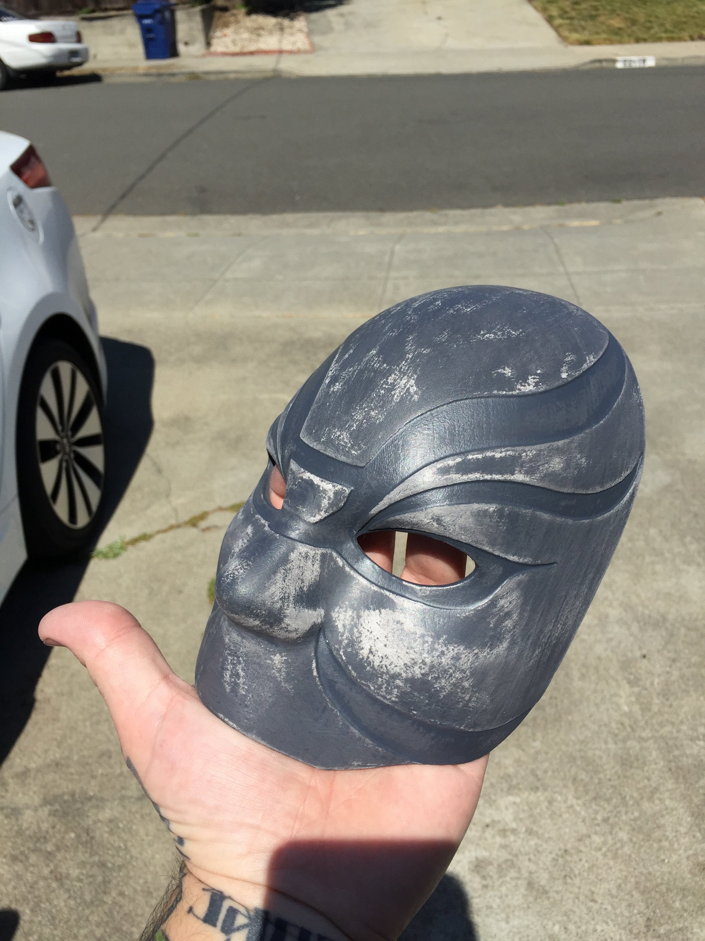

Finally got around to trimming two and painting them . Have one more still raw and waiting on more resin to show up .
really sweet! looks great so far. Cant wait to see a finished product!
Thank you !
