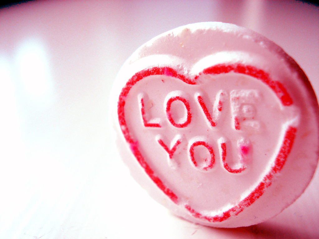

I'm making a love heart sweet, scaled up so it's about 9 inches diameter.
I'm working in polystyrene.
It's becoming annoying, everytime I sand back some filler, I dent another part, of ping off part of a letter.
Soooo... I thought, plaster would be more suitable to work with, and way better for the final piece.
But I'm not sure, can I just make a two part plaster mold of this? and if so, what release agent should I go for?
Silicone I assume will also work, but I'm looking for a cheaper way if possible, as the piece isn't finished yet, so really i just want this stage to change materials for me so it's easier to work.
Attached a photo of the piece, lots to do still. The back it the same as the front, but with no writing.
And yes, i know it's very cheesy! it's going to be a present for my GF if I ever finish it!

The photo is the master, so I'm looking to cast that into plaster so it's easier to work, and plaster would be more suitable for the final piece.
Polystyrene was definitely a bad choice of material, in hindsight I'd go with something denser that wouldn't fill my flat with tiny white balls, and probably get everything smoothed out before adding the letters.
Sadly, the letters have to be there for it to be an accurate replica of the sweets we have here :(
I think I'm stuck with a two part mold as well because there's the heart shape relief on the rear too.

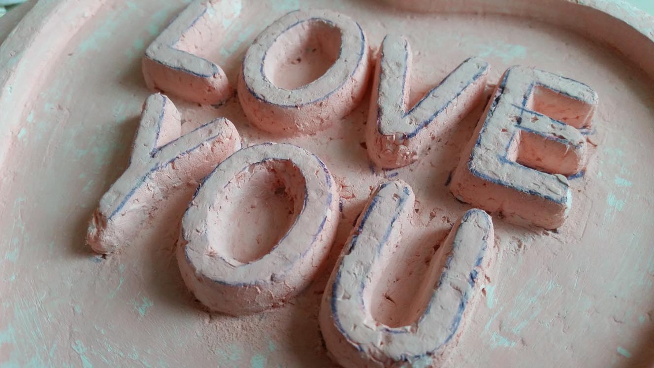

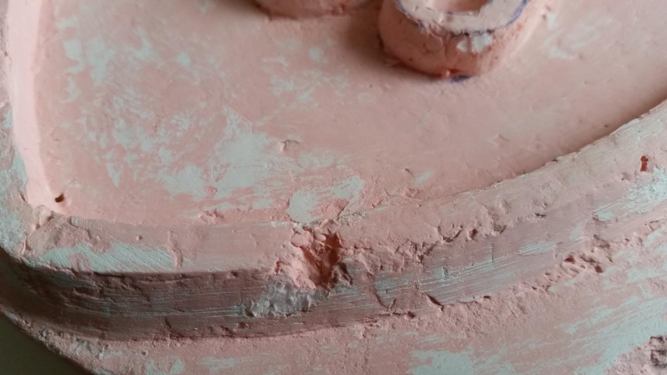

Thanks Jarvis - I was going for that bashed up look on some of the edges, but in the sweets I have, the space inside the heart shape is quite smooth.
The problem I've run into is by sticking the letters on too early, it's impossible for me to get that smoothness now - it's looking way too messy around the letters, I added some better pics to show what I mean.
Plus i keep knocking chunks out of it!
I also noticed I missed something when scaling up, although really it doesn't matter in this piece - the sweet is thicker inside the heart shapes than outside. Not sure how I missed it, but I'm going to try and address it in the remake.
I think I'm going for MDF until I'm happy, then cast in plaster or similar, and distress from there.
Not looking forward to cutting out the letters again! was hard enough in polystyrene!
