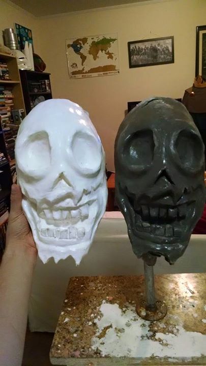

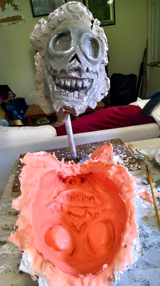

So I've finished with my mold of my Lich Face and am ready to cast, however the lich has very exagerrated features (deep, recessed eyes, multilayer mouth, etc), which I think means I'll have to slush-cast the mask (by hand, since I down own a slush caster and this is a one-part mold).
To get all of the detail, I'll probably need a longer pot life than the 3 minutes SmoothCast 300 offers--do you guys have ideas on what the best resin would be for casting this mask, given the postive and negative pictured below?
Thanks!

I made three pulls tonight---each one with progressive success. A lot of leftover WED clay came out with the initial pull, which is fine since the character is mangy anyway. The second and third pulls were nearly all white.
11167971_10101449373860383_629604153893418306_n.jpg1476435_364483170414896_7866365822095523879_n.jpg
I'm glad I started with a character that's disgusting and therefore a little more forgiving as far as discrepancies go, but now that I've done mold-making and casting, I think I can move on to more detailed characters now.
