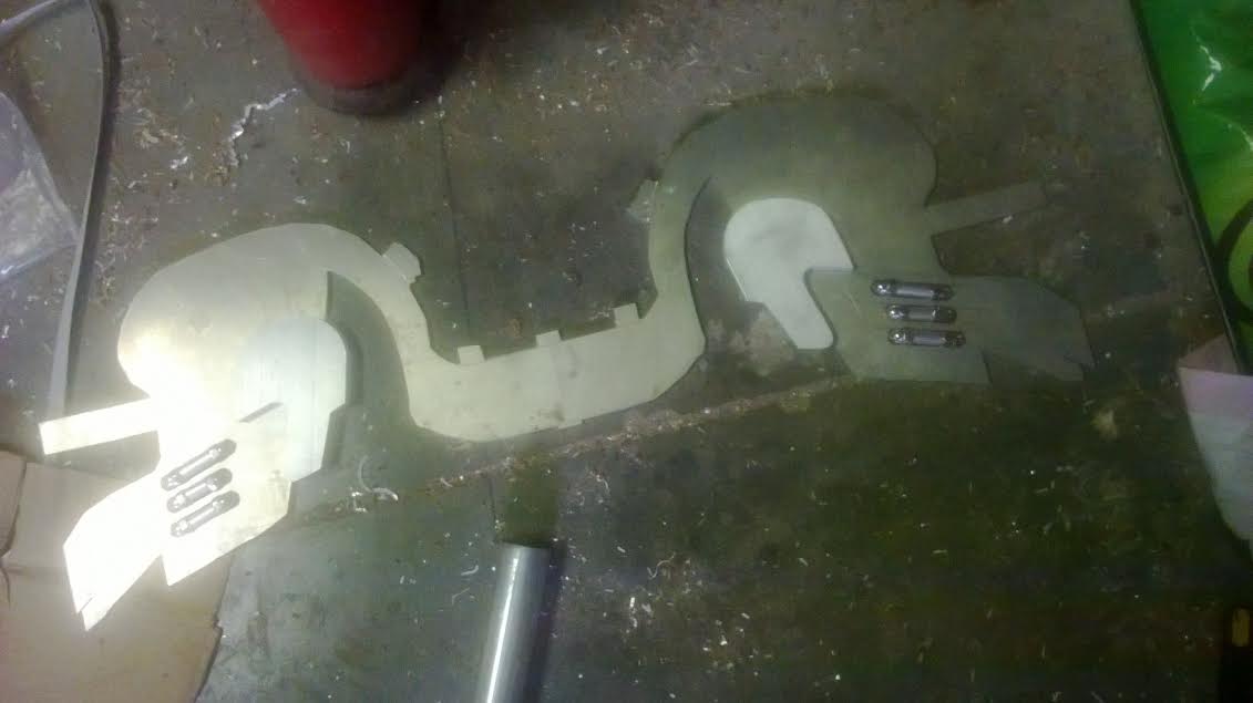

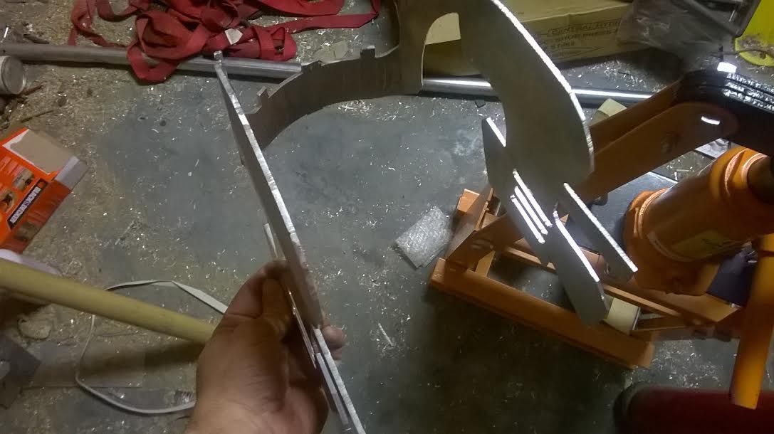

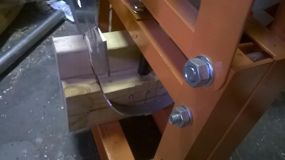

I bent some 1/8th inch aluminum, but used wood blocks and a 6 ton pressears.jpgbendbackhed.jpgbendd.jpg
