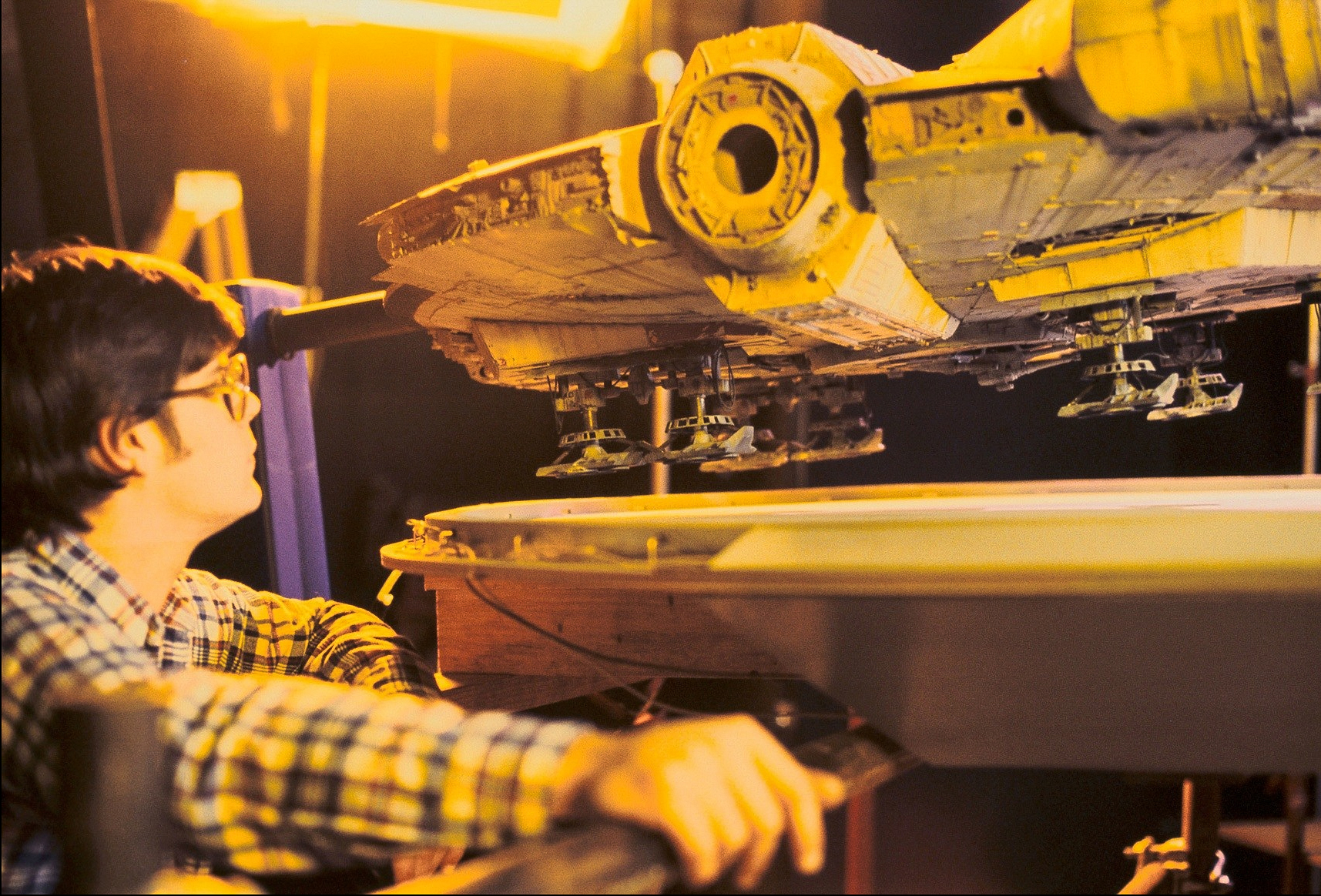

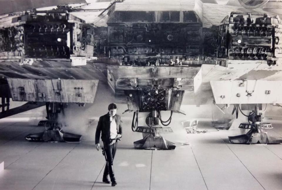

Here are a few more reference photos. Some are the miniature and some are the set.
