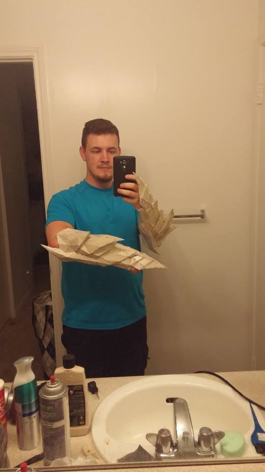

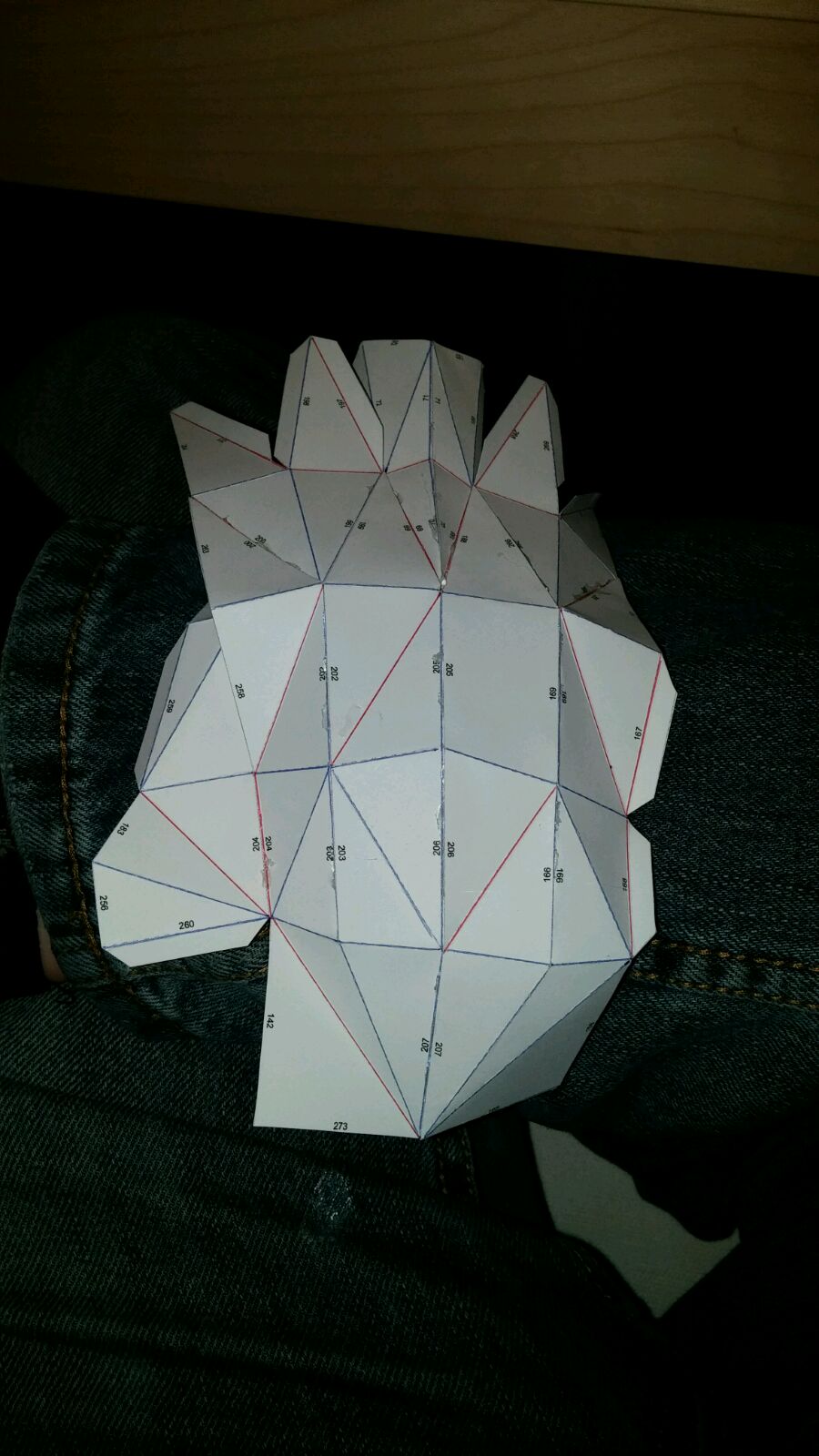

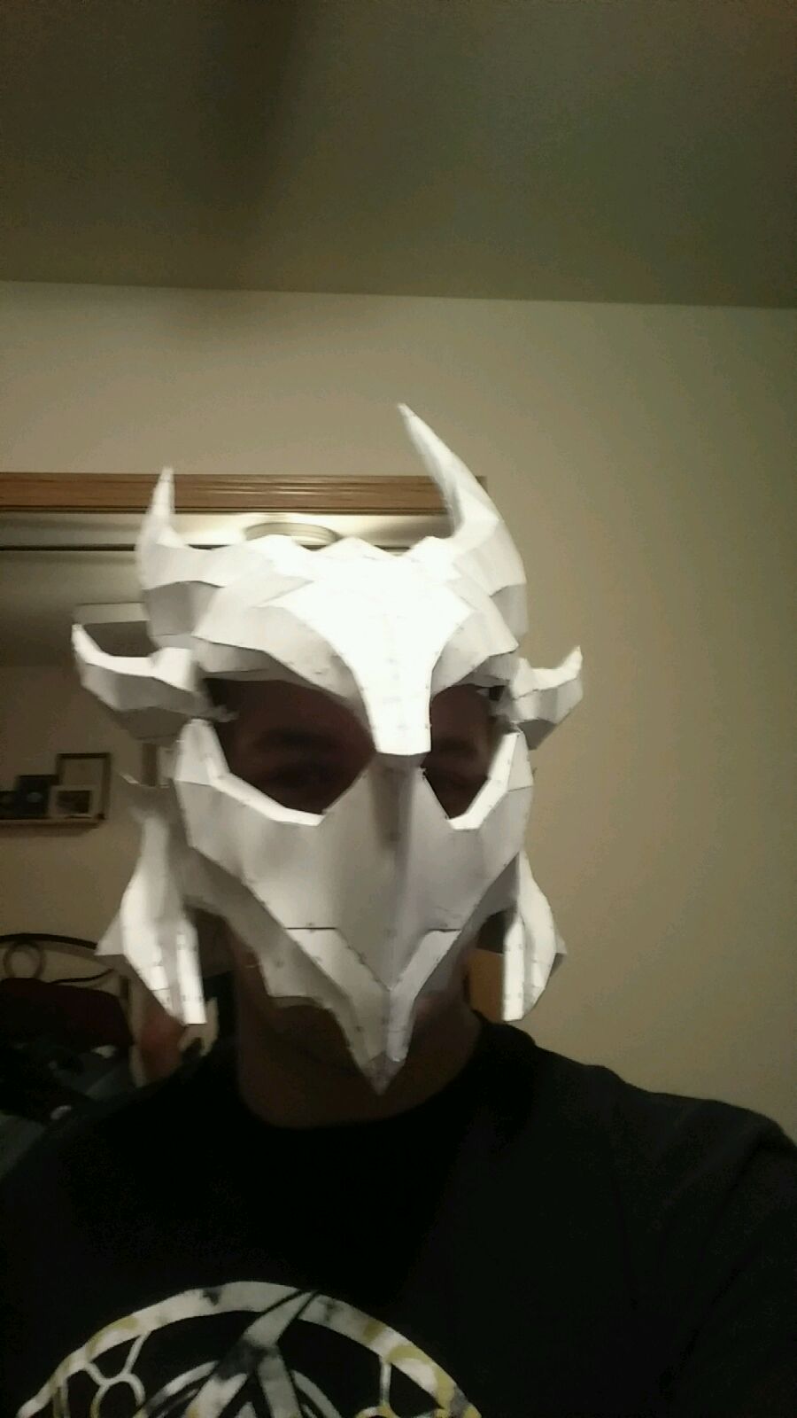

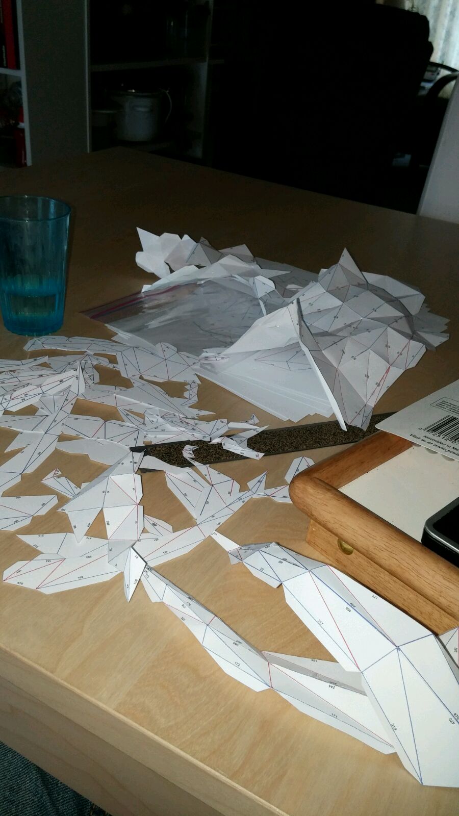

Well, since most threads are useless without pics, here's a handful!
Been quite a long time since I've pepped anything haha.
PART_1428907924068_0408151109.jpg PART_1428907922788_0412152331.jpg PART_1428907926098_0408150214.jpg PART_1428907928546_0407152233.jpg

View attachment 463758 View attachment 463757 View attachment 463759 View attachment 463760
Nice work ! Paperkura is for the patience.. lol.
As for Joining thick foam. This might sound strange But i actually I sew them together. Not over sew them in though. but just enough that im comfortable that they will hold together heres an example . Note though that under the foam itself I line it with Linen cloth via Contact spray glue so the foam wont be subjected to tearing.
