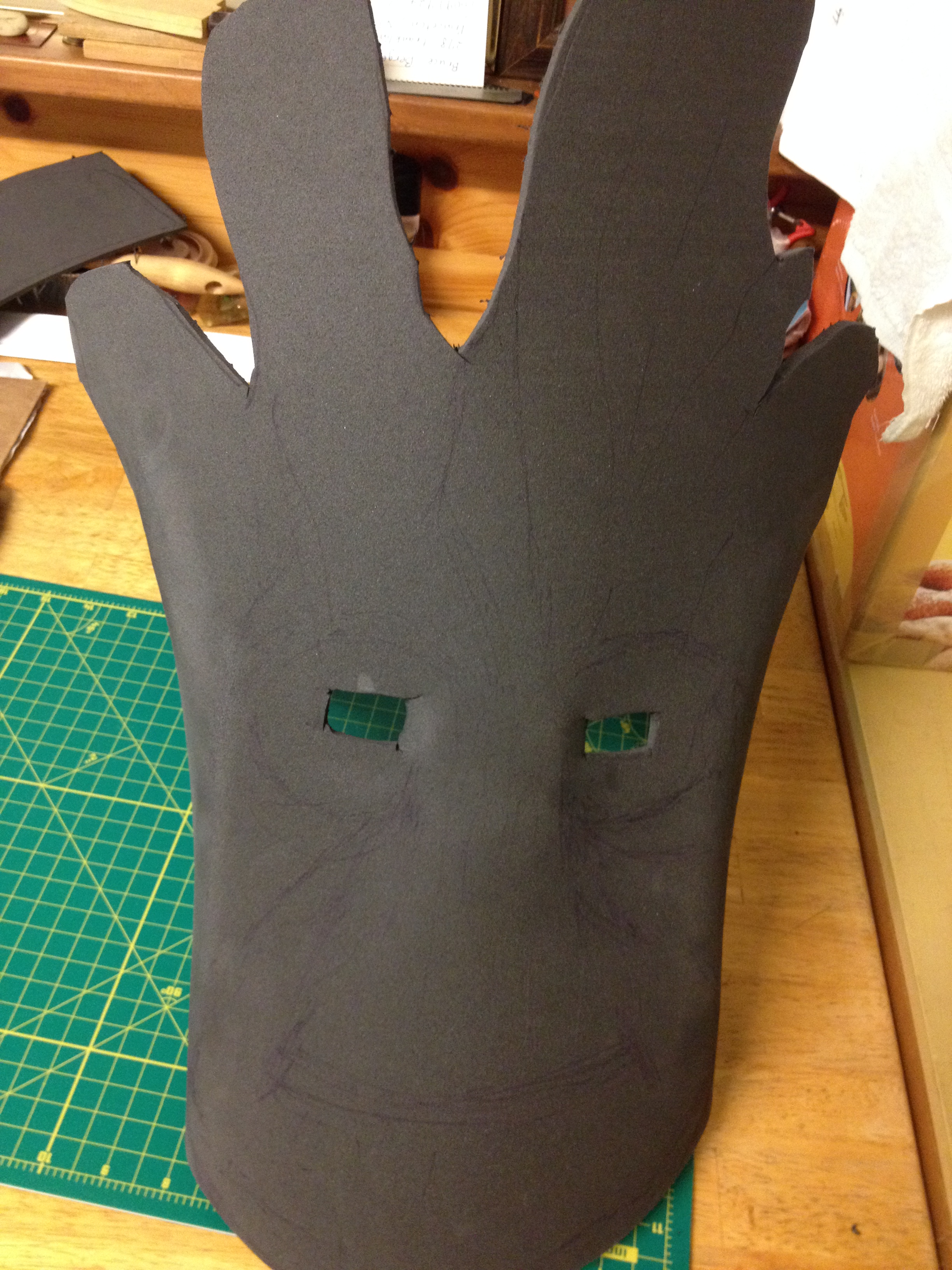

Groot makes an appearance! Yes this is a Star Lord thread but I saw many amazing groots on this forum and thought I'd give the head a quick attempt. This is the 2nd head I cut out of foam with a quick draw and cut. The first was just shaped horribly so I made a second improving on the first.

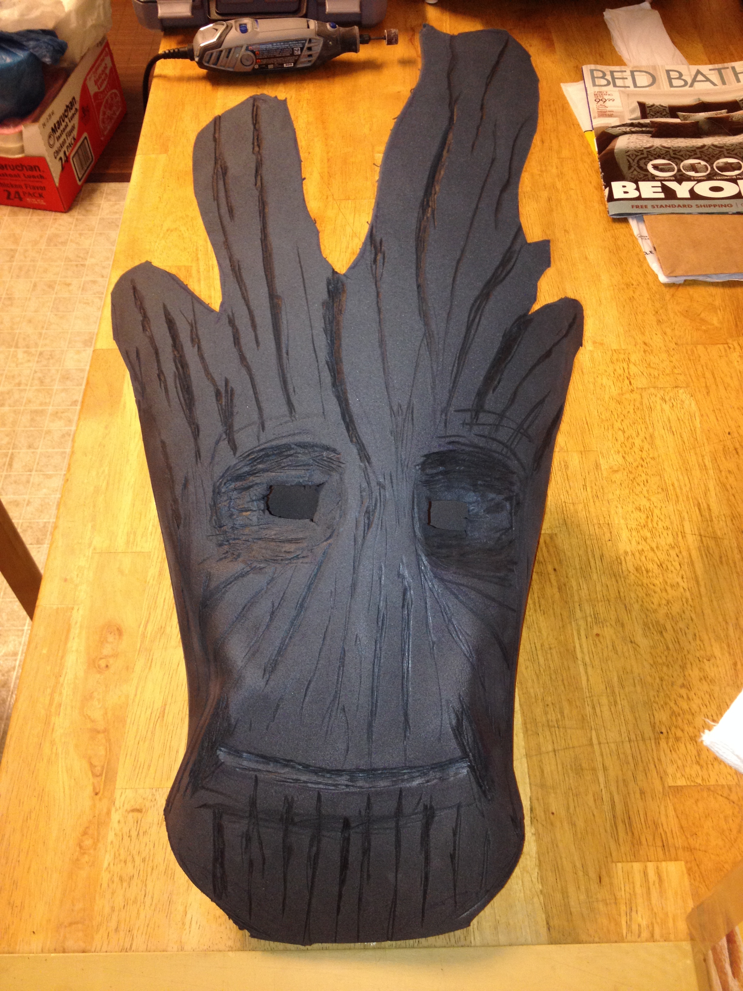

Took my dremel to Groot's head and added details. Also used a hot hair dryer to help shape the eyes and cheeks

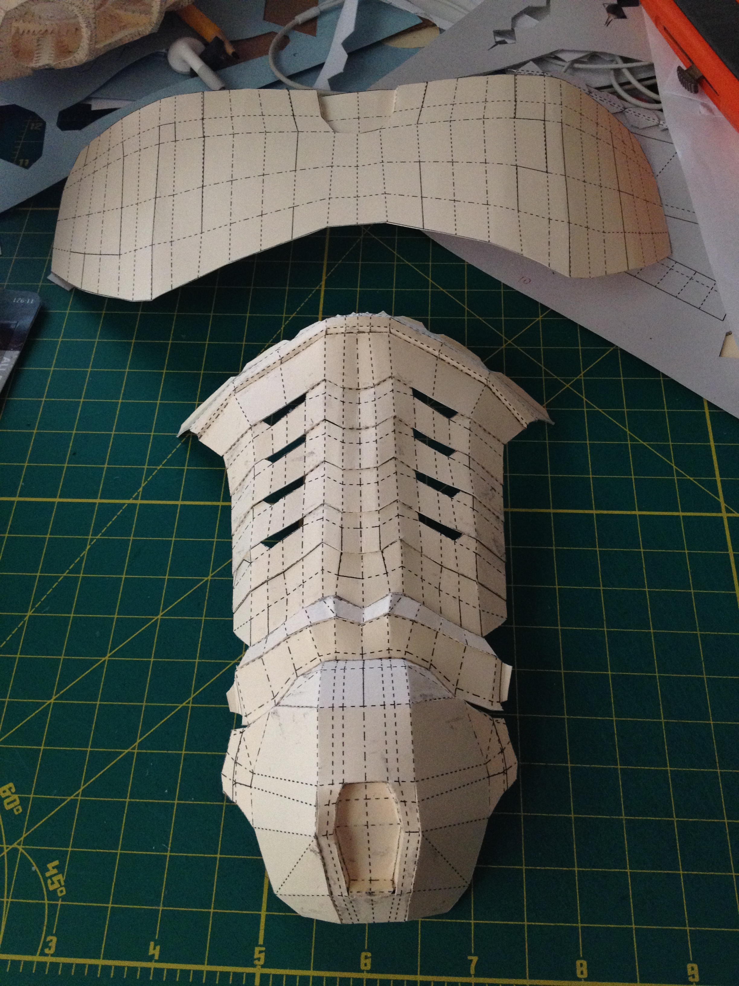

Ok ok, here's the start of Star Lord's helmet pep. I actually started the back of the helmet (no pics) twice. The first set of print outs, I eyeballed it against my head and decided it was "way too small" and sized up a 2nd set of printouts - more on this later...

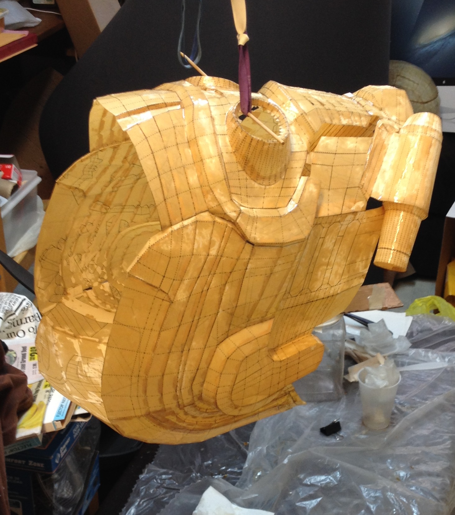

Attached the the mouth and first coating of resin. Because I did not add any supports to the pep, i ended up hanging it through the eyes to lessen deformation.

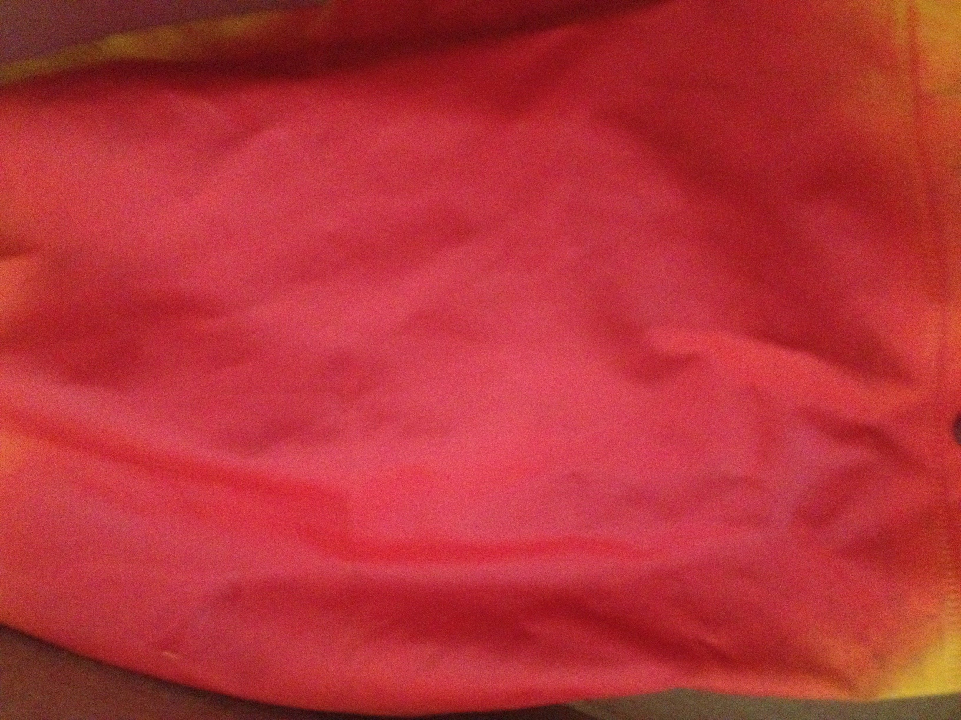

Now, I've been leather jacket searching for 2 months, stopping by many many local thrift shops/goodwill and have had zero success in anything that i'd like to wear as a Star Lord jacket. Finally in my sleep deprived state on this last panic week before Halloween, I decided to try to rubber paint a spare raincoat and see how it turns out. Here is the initial test of Rustoleum's red Flexidip. I decided that it was too bright of a red and suspected that the culprit being the bright yellow base coat of the raincoat.

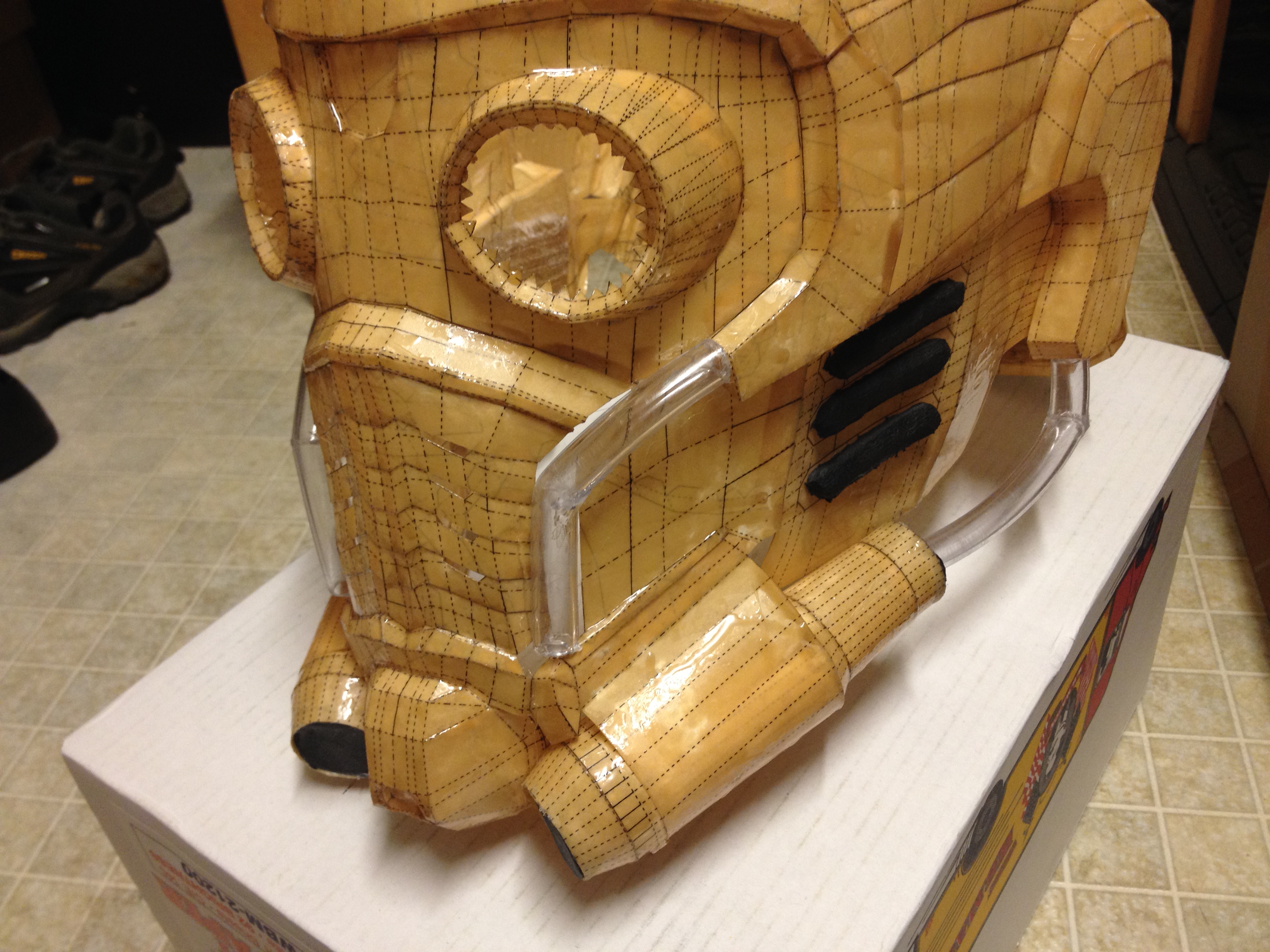

foam bits are attached and I spent the evening between Flexidip spraying to make the tubes on the helmet. They're 1/2" diameter tubing which I cut down to size with a utility knife. I cut out a deep and wide "v" groove to get the bend on the tube, and hotglued them to the helmet.

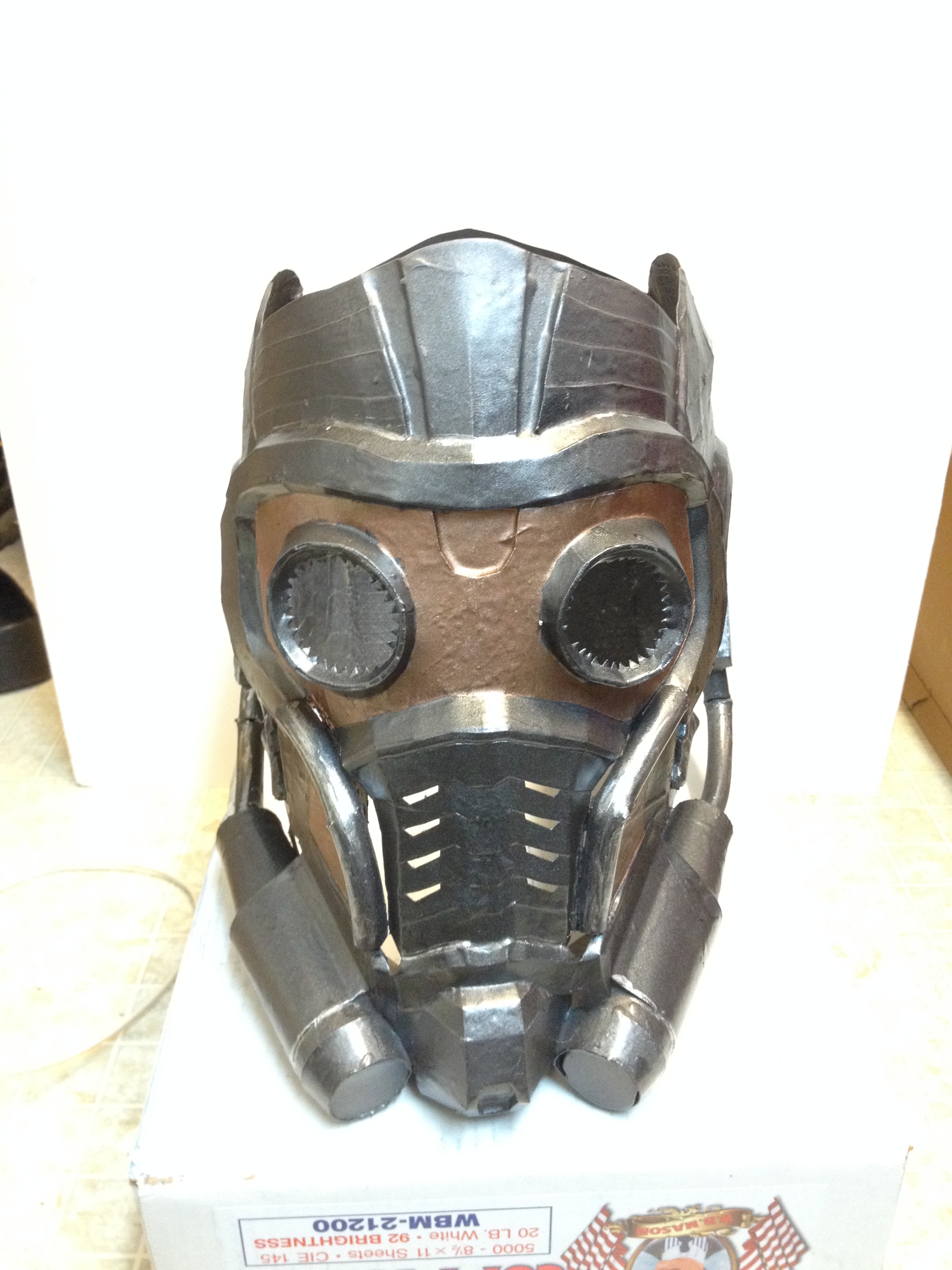

Panic mode. luckily I took the day off from work. I sprayed on a layer of the black Flexidip as an undercoat after ~3 layers of elmers glue seal the previous nights. Then I sprayed Aged copper in the cardboard box and then taking a spare bit of foam to hand paint the orb.
I repeated the foam/hand painting of the orb with Titanium Silver with a dab of Flat Soft Iron to darken it a little and this is the finished result.
Groot head painted with Flat Brown! Smile!
Helmet with the Aged Copper areas masked off
