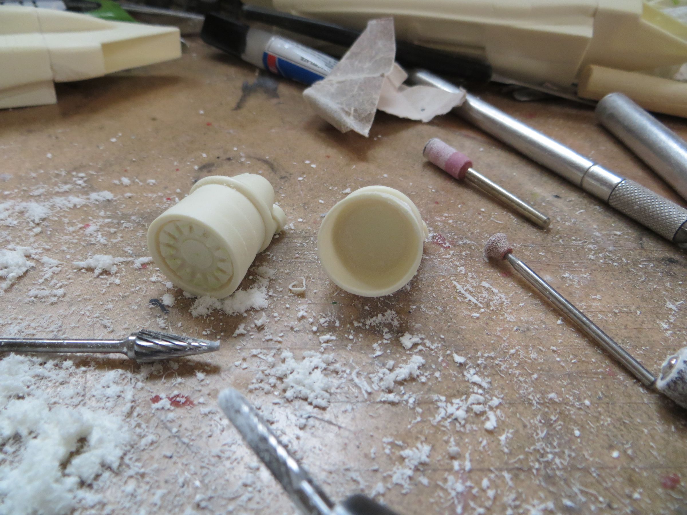

- scooping the main nozzles with the dremel.
The base of the bells, with shifted casting, are removed using a small photoetched saw.
As they are too long, I cut to the end ,so I 'll have to re-dig again the bells.
