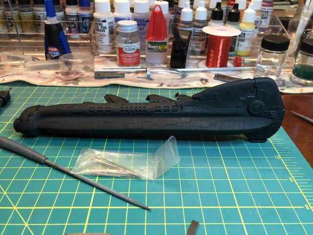

Drilling out the main fuselage holes. They are supposed to be square but I didn't have any real way (or patience) to make them square. No files I have are small enough. I may opt to use the photo etch as "armor" (really more like cladding) to square them off, but the PEs lack some detail so I may either add to them or cut them down. Another "up in the air" at this point.

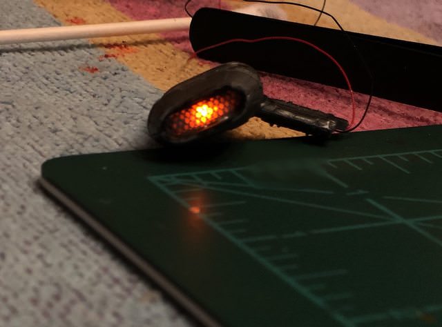

Not a whole lot to update. I've been working on the outboard engines and the landing gear. Here is a quick light test I did with one of the engines. I wanted to see if the LED would be bright enough for what I wanted (it's really small). It should be fine. I will have to filter it a bit so it's not such a point-source but that won't be a problem.

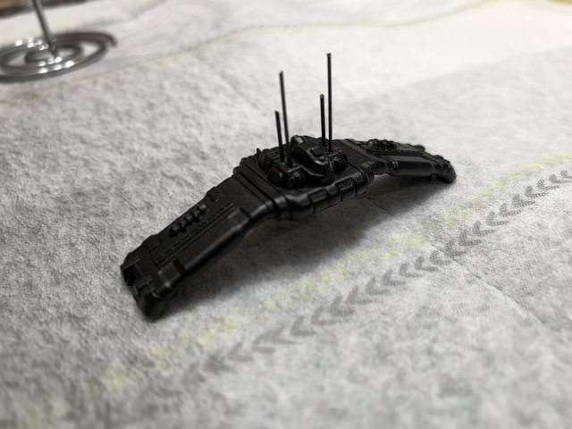

I added bits of wire as antennas to make the model a little more accurate, since the kit doesn't have them. Will be painting this and the engine blast shields this week.

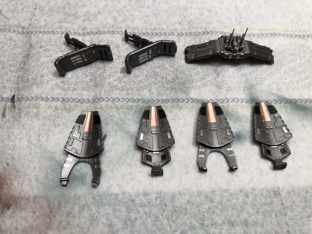

Quick update. Got the engine shields, rear arch, and the rear landing gear painted (mostly). I need to do some touch up and then they'll be weathered later but these are mostly done.
Outside of the shields.
And the inside:

As for the hotspot on the wide engine, there will be a photo etch grill in front of it. I've also added a small piece of wax paper painted with transparent orange between the grill and the light to soften it a little. It will still be hot in the center but a little more diffuse. Since the ship will be parked on a landing pad I'm just going to say that's what they look like when idling or powering up or down!

The diffusion is better now. I glued a piece of translucent plastic tinted orange to the back of the photo etch grill. The photo etch sucks, to be honest. I'm really tired of photo etch not fitting right. The space they are to fit into is slightly oval, while the PE is completed straight across the top, so there's a little gap. Which, okay, is no big deal. Easy enough to fill with a little bit of tulip for light blocking. But the rounded ends are also too big by just a little bit, so you can't close the two engine halves without crushing and bending the PE. And trying to file down the curved parts of a tiny grill is pretty hard to do without bending them all to hell. These really should have been made better.

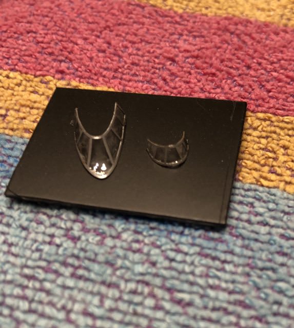

Photo etch for the cockpit and lounge windows. The clear parts in the kit completely suck and I won't be using them. They are way too thick and don't fit the fuselage openings correctly. I will need to add some sort of window film to these. Still mulling options. Any suggestions are welcome!

For the window film you could try Micro Kristal Klear
Thank you! I'm going to use Krystal Klear for the smaller porthole windows. The openings on the photo etch are pretty big. I guess I could try putting tape along the outside and see if I can fill them that way. Thanks for the suggestion!

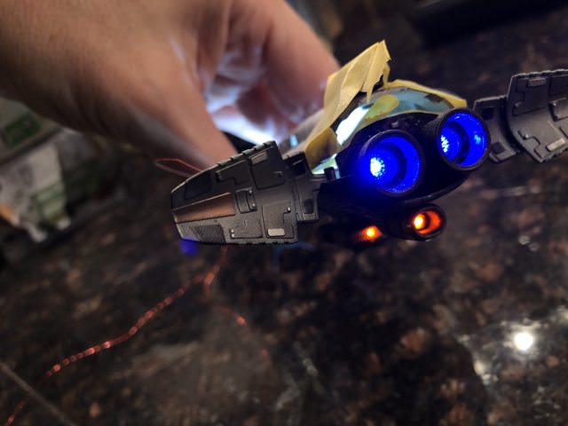

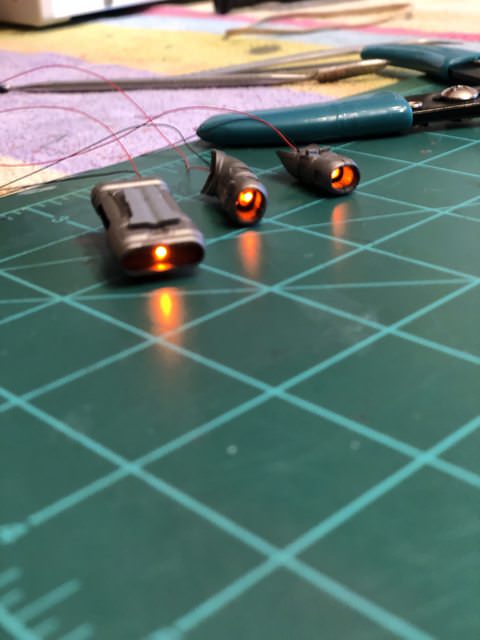

Another engine lighting test. Nothing is glued yet, just checking to make sure I didn't short anything as I move along.
Photo etch windows filled with Mico Krystal Klear. I did a test first to see if it would cover openings this large, and I was surprised there was enough surface tension in the glue. They are still not quite dry but should look good once installed. Now getting them to fit is another story.

Another quick lighting test of four of the seven engine lights. These four are all now glued into place.
I did some soldering in the lower fuselage today for the lights and wanted to do a quick check. So far so good!
