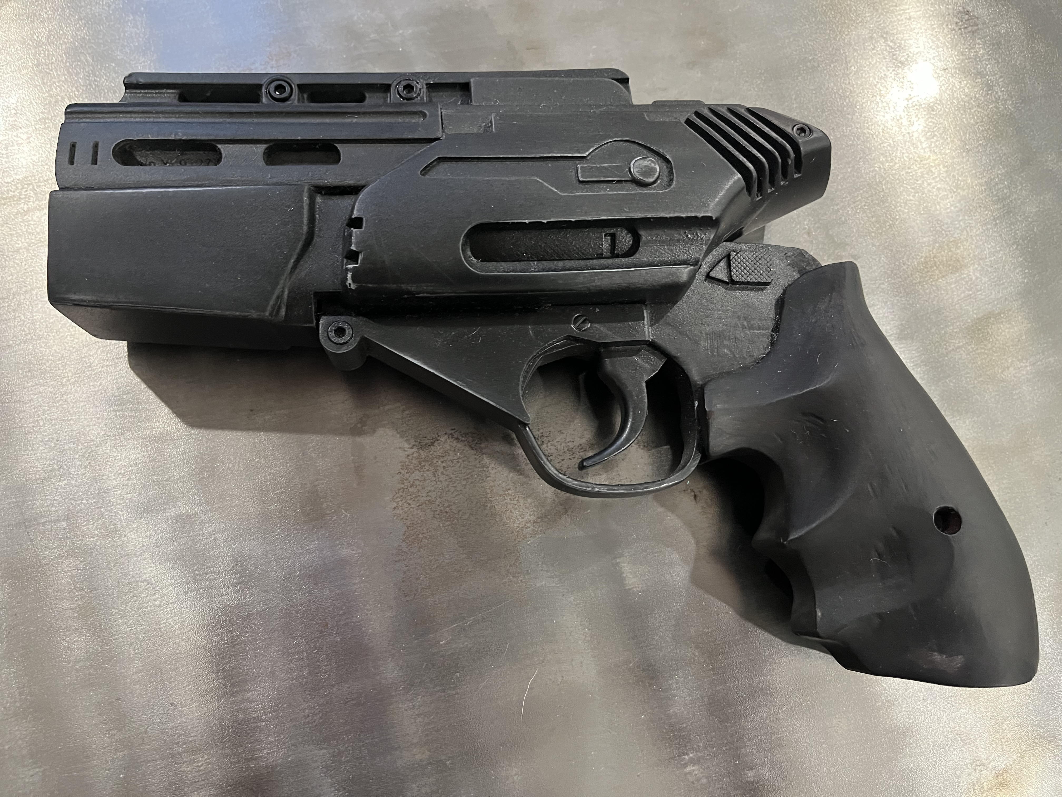

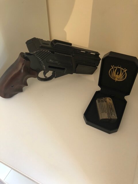

Hi all ! This is the first post of my own,
yes a little late to the BSG prop arena, but I rewatched the series recently and was inspired to have a go given the great content on here!

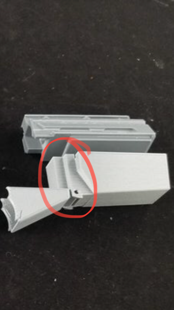

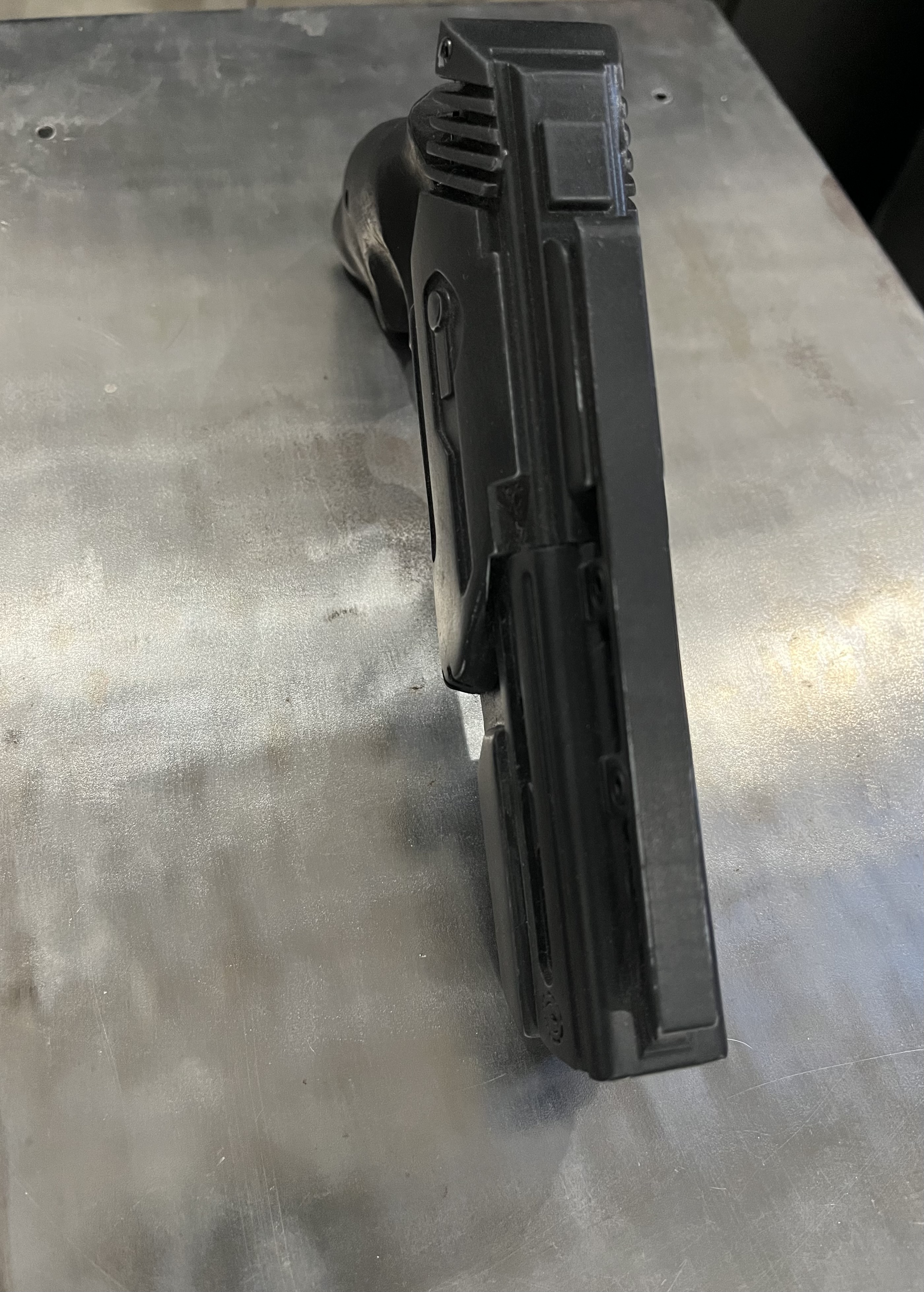

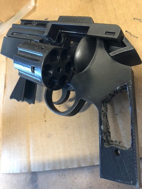

so I got a kit printed, not the best and needed a lot of sanding!! I’m a novice at this, my first build ever, ialso wanted to show what could be achieved with a little resource and no prior knowledge.
hoping you like the end result!!
Sanding was painful, I invested in a cheap dremel rotary tool, only to find the speed reached a point that it melted the plastic kit!! Lesson learned I refilled and went at it by hand.

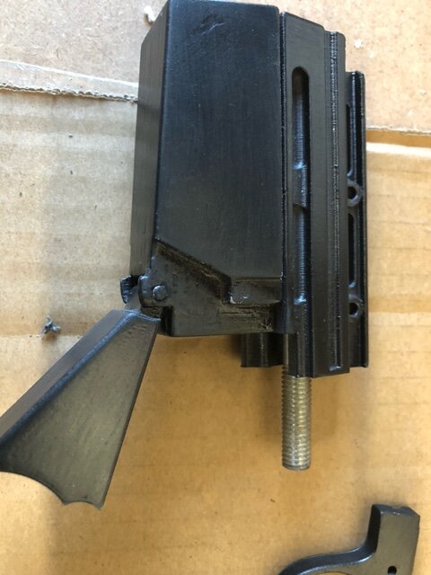

decided to paint the main body on Matt black following grey undercoat, then go for the graphite powder coating the finish with clear coat. Few rattle cans bought (no sprayer of my own)

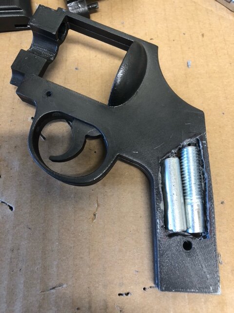

added some weight to the barrel with some threaded bolts I chopped to size and glued out of sight.

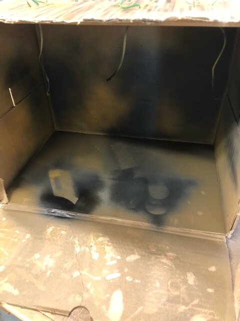

my high tech spray station of a cardboard box and garden wire to hang parts…yes I did invest in a mask and sprayed outsid
I decided to add more weight inside the grip so cut out some plastic and cut bolts to size.
Then assembled the rest of the parts…

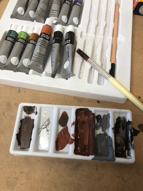

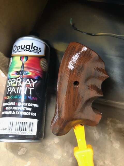

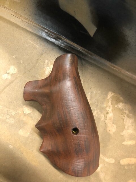

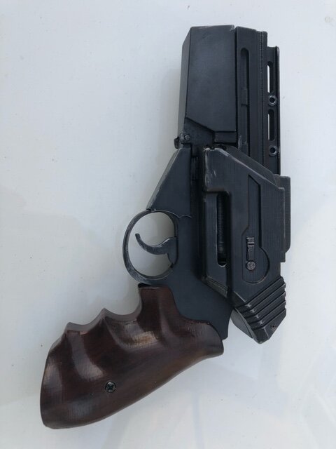

I bought some cheap acrylic paints various colours and mixes for the handle, first a brown layer then black dry brush to get wood grain appearance, then coated in clear
Finally set the handle and put some screws in for effect,

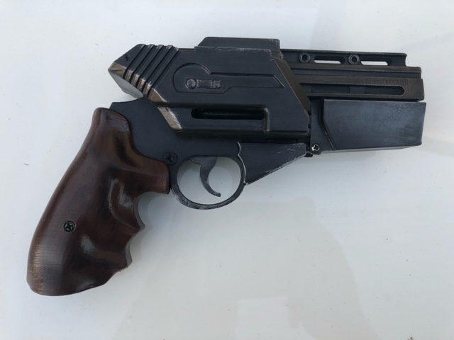

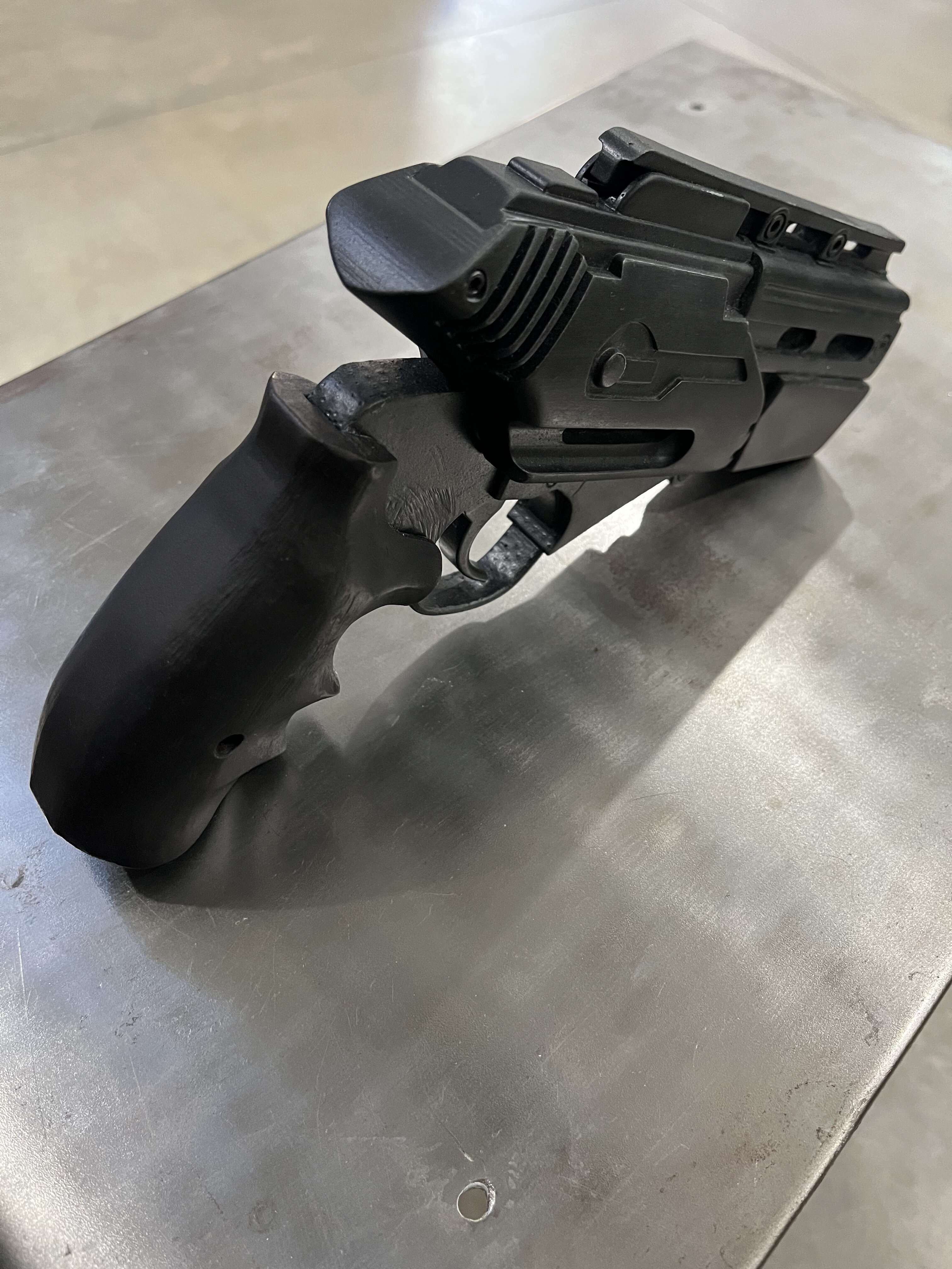

Finished prop with some light weathering chrome paint again dry brush approach.
and finally In it’s setting along with the lighter from the series
was a good project and a welcome distraction! Looking forward to the next one although I decided on what to do, enjoyed it
For a first effort you've done really very well. As you found out, a Dremel type tool has to be used with great care. it would be better to use one with a variable speed option. It also isn't the best option for sanding larger areas like on plastics, the foam sanding blocks now available are a much better option. Personally, I rather like your painting of the pistol grip. Do you have any way to lock the hinged piece so it doesn't fall open at inopportune moments?
Thanks!! I wanted that wood effect and I tried a few things, landing on the brown the black dry brushing, soft paper towel to blend it…worked out better than I expected. Especially given the only thing I’ve painted before is walls in a house

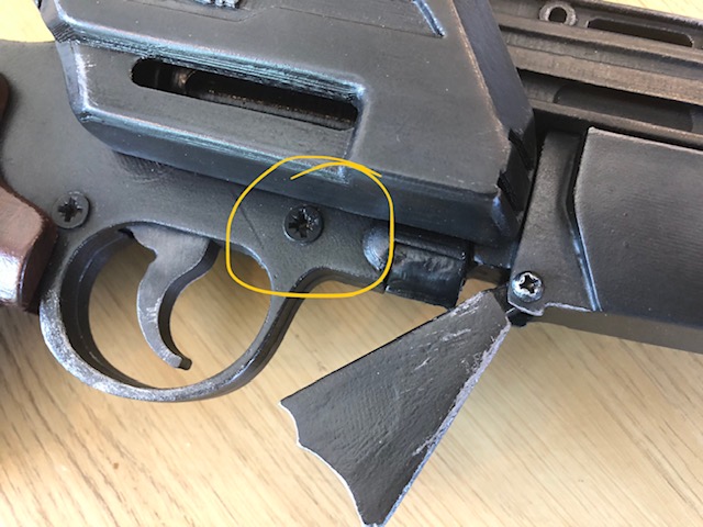

I cheated a little with the hinge, i placed two screws inset into the revolver frame (as I had seen this in other photos) and left the one under the hinge piece a little proud of the frame - you wouldn’t notice up close, but it’s enough to grip the side of the piece as you close it and hold it in place.

Nice simple solution, well done. My brain immediately went to rare earth magnets, something mounted on the trigger guard and the inside of the hinged piece. I tend to overthink and over engineer things and make them unnecessarily complicated. Does the trigger work?
Nice solution for a proper build, but as a novice I worked with what I had at hand, trigger works but it’s a printed kit so no revolver cylinder action and no hammer in the kit.

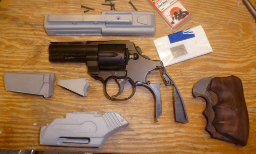

That looks like a Matsuo kit. I've done some research and he doesn't produce those anymore...unfortunately. It's a beautiful kit and probably the best kit out there. You might find one on the secondary market...."junkyard" or ebay. They do come up...but not very often. You can find kit that is similar on Etsy ( seller is PremierProps)that claims to use that Matsuo kit as a reference. So it has the cylinder, moving parts, etc. The print though...in the pictures...looks a little rough... but is most likely the photos. However, with a little elbow grease and sandpaper...I'm sure it will be fine. I just did download of stl files (from Esty seller DreamofProps) so if you don't mind a static prop...this is not a bad option. I did also print a new handle that was a little more accurate from Thingiverse. Here's my build of the DreamofProps file. Hope that points you in the right direction
The above pic on plywood was my Matsuo build from a long time ago. It was an early Matsuo kit and he revised later versions as more reference on the gun became known.
That looks like a Matsuo kit. I've done some research and he doesn't produce those anymore...unfortunately. It's a beautiful kit and probably the best kit out there. You might find one on the secondary market...."junkyard" or ebay. They do come up...but not very often. You can find kit that is similar on Etsy ( seller is Punished Props)that claims to use that Matsuo kit as a reference. So it has the cylinder, moving parts, etc. The print though...in the pictures...looks a little rough... but is most likely the photos. However, with a little elbow grease and sandpaper...I'm sure it will be fine. I just did download of stl files (from Esty seller DreamofProps) so if you don't mind a static prop...this is not a bad option. I did also print a new handle that was a little more accurate from Thingiverse. Here's my build of the DreamofProps file. Hope that points you in the right direction

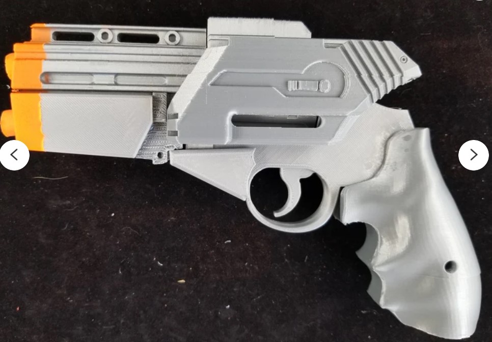

I have the Static Prop as well as was wondering what did you use as a Search Term on the thingiverse to locate the more "accurate" grip???
Hello dcast. Thanks for info. I found the DreamofParts stl's, but was unable to find the Punished Props kit. Would you be able to provide more info to help me locate?
Hello darkev2. I think the improved grip is this one: Battlestar Galactica Colonial Season 1 Handgun Parts by Retrogram
Hey there, my mistake, it was PremierProps on Etsy ( Punished Props Academy also did one but more for cosplay). Here is the a picture and a link BSG Colonial Blaster. For my build I used the the Retrogram handle it was a close fit. He recently upsized the the blaster to be more accurate...I believe 15%. I made my mine, before the resize, 13% bigger. The "upgraded handle was a little too tight so I had to do some sanding. So since DreamofParts up-sized his blaster by an additional 15 percent...you would probably need to increase the size of the handle also...I would guess 2 or 3%...since is almost fit when I initially printed it. Either way...measure the opening of the handle and then the back of the frame....that should get you in the ball park. Hope this helps.
