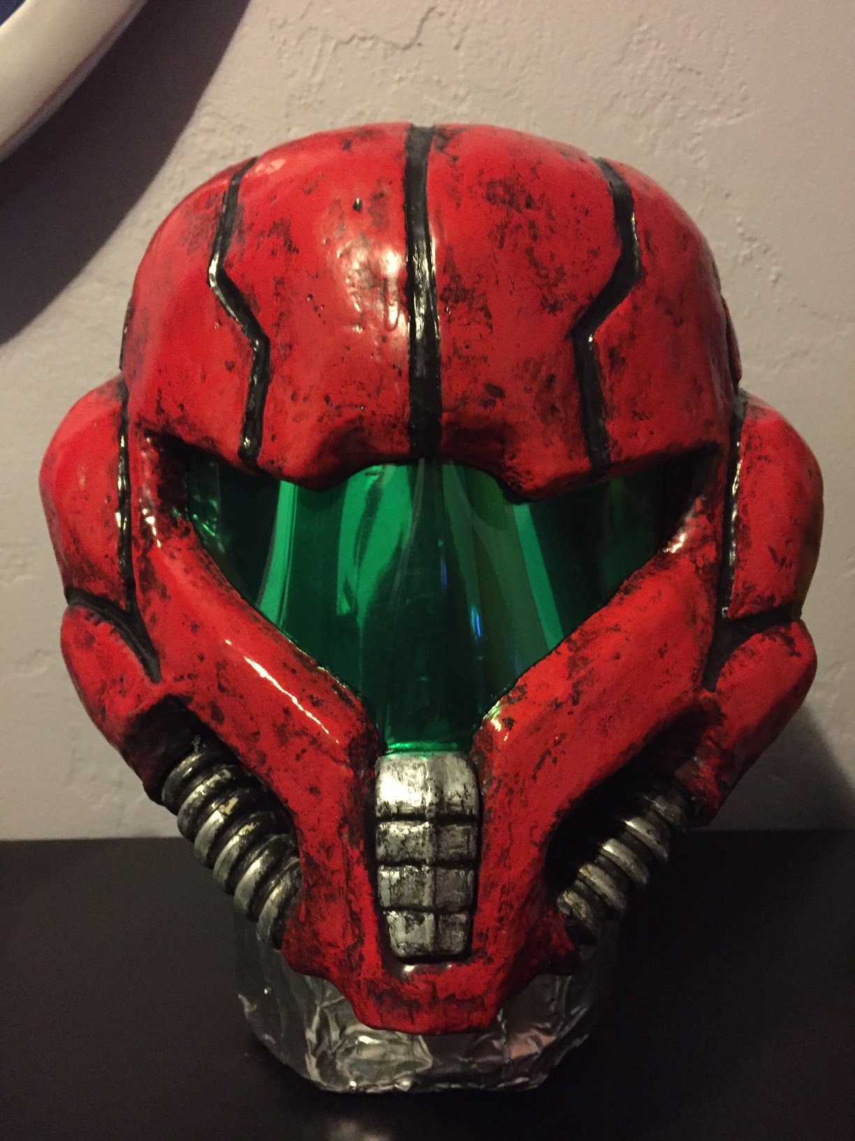

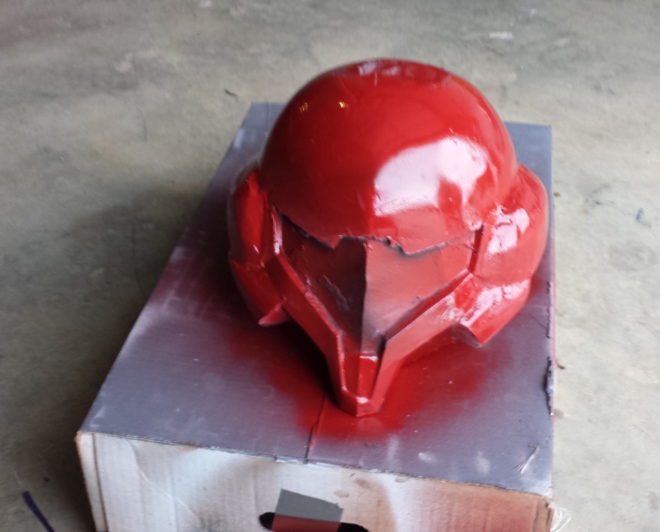

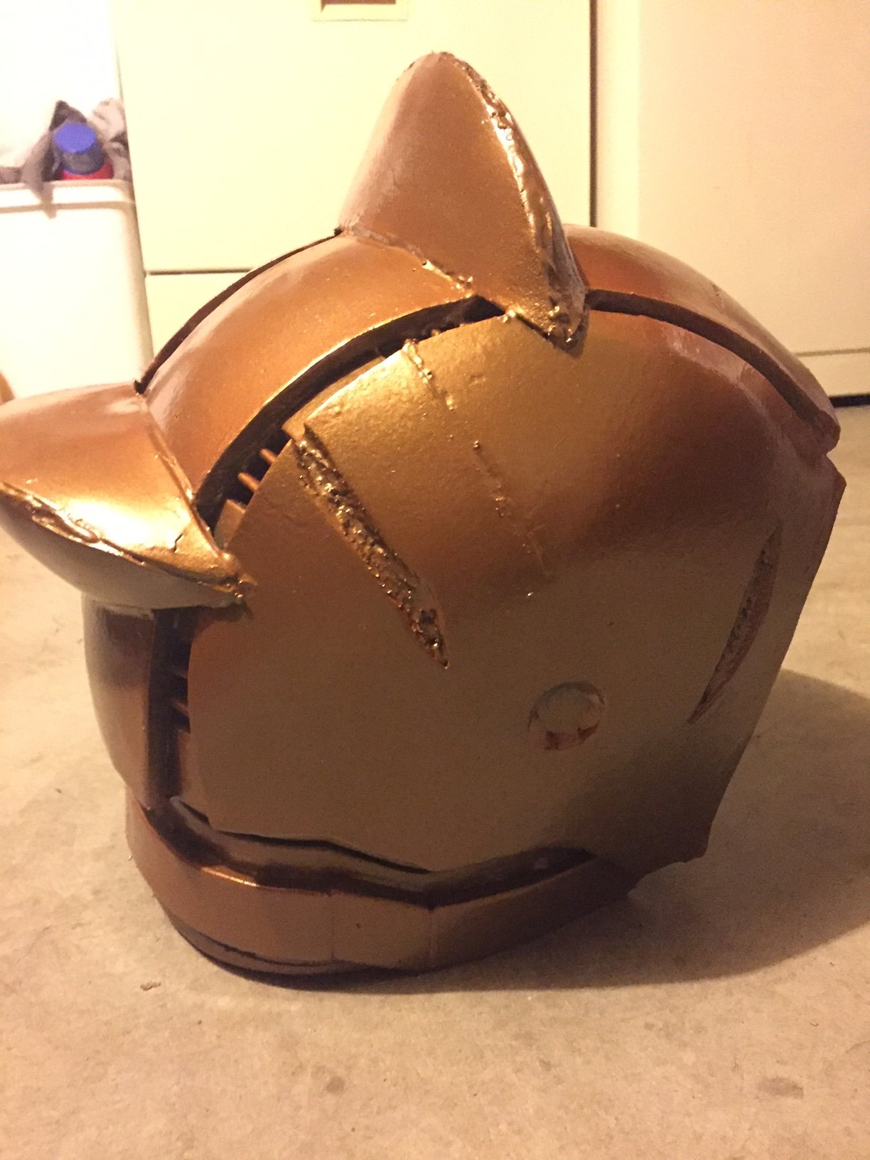

So far I've 100% completed the helmet. Tbh, at first I thought I wasn't going to wear the helmet out in public. I've always wanted either a Samus or a storm trooper helmet and figured it would be way cheaper to build one (and very rewarding). I might end up building a storm trooper helmet eventually now that I know their secrets mwuahahahaha.
What I might end up doing at ECCC is one day wearing the helmet and seeing how that goes while the other day I'll wear a wig and just carry the helmet as an additional prop. The helmet took me about two months from start to finish. I used a little bit a longer route that ended up giving me the result I wanted:

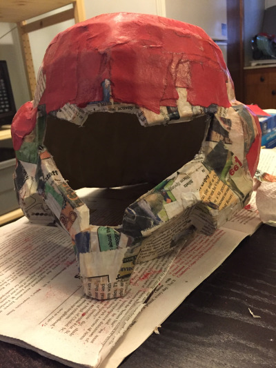

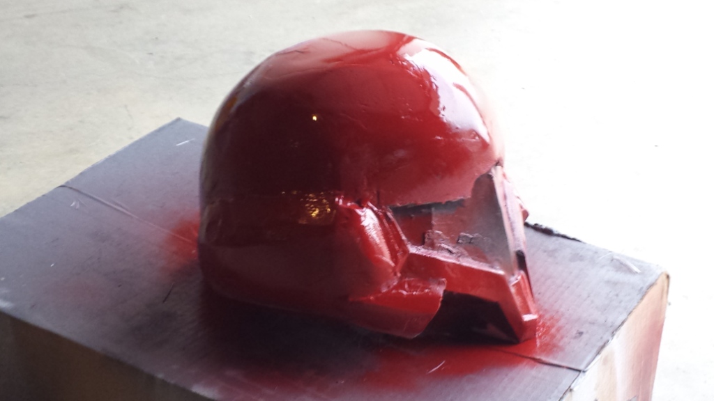

Helmet_Cardstock.jpgHelmet_Masking Tape.jpgHelmet_Paper Mache.jpgHelmet_woodglue and paper mache.jpgHelmet_Worbla and tubes.jpgHelmet_Wood Filler and Wood Glue.jpgHelmet_Paint.jpgHelmet_Damage Detail.jpg

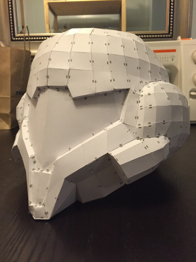

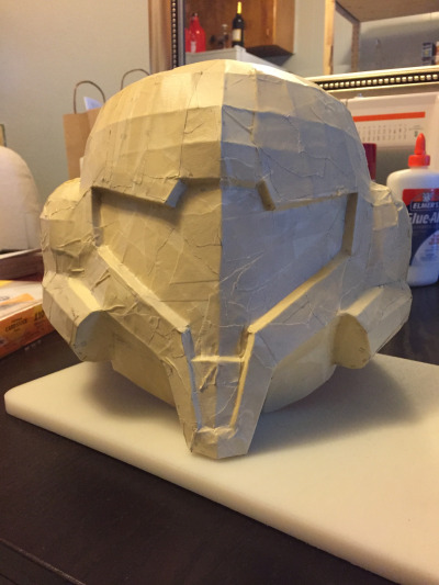

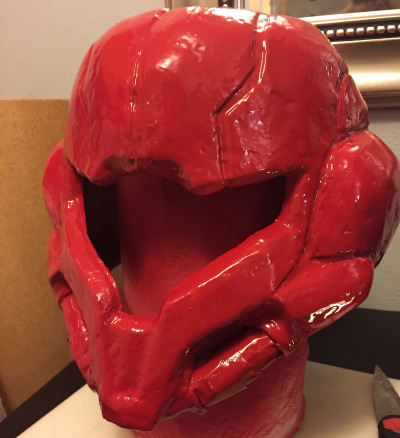

Starting with card stock, I used fellow member Talaaya's pepakura file. From there I layered with masking tape to prevent the paper mache (diluted wood glue and water) from warping the card stock. After layers of paper mache and sanding to even it out, I applied a few coats of wood glue, created my template and applied the worbla. To smooth out the worbla for paint, I used wood filler, wood glue, and a ton of sanding. I could have probably gotten a totally smooth finish if I did more sanding, but I liked the gashes that were appearing and so I used to my advantage. After red paint, I used black acrylic to fill in gaps and provide damage and wear on the helmet. The grill is made from worbla and the tubes are electrical conduit.
So after that long process. I'm onto the rest of the suit. I'm almost finished with the arm cannon pepakura. But I'm still trying to decide on if I should do the same process as the helmet, since this time I know what I'm doing and it'll move much quicker. Or if I should use fiberglass resin and bondo. It's been rather chilly in Portland so I'm a little worried about getting the measuring down. And the cold. Did I mention it's cold here? (I'm originally from Florida...). The pepakura took me longer than I anticipated. The helmet file only took me maybe a night and a half to complete. So I started the arm cannon file a little too cocky and now I'm really feeling the time crunch. I figured fibeglass resin/bondo technique would go a lot quicker, but I run the risk of ruining the pepakura... Aka dying inside.

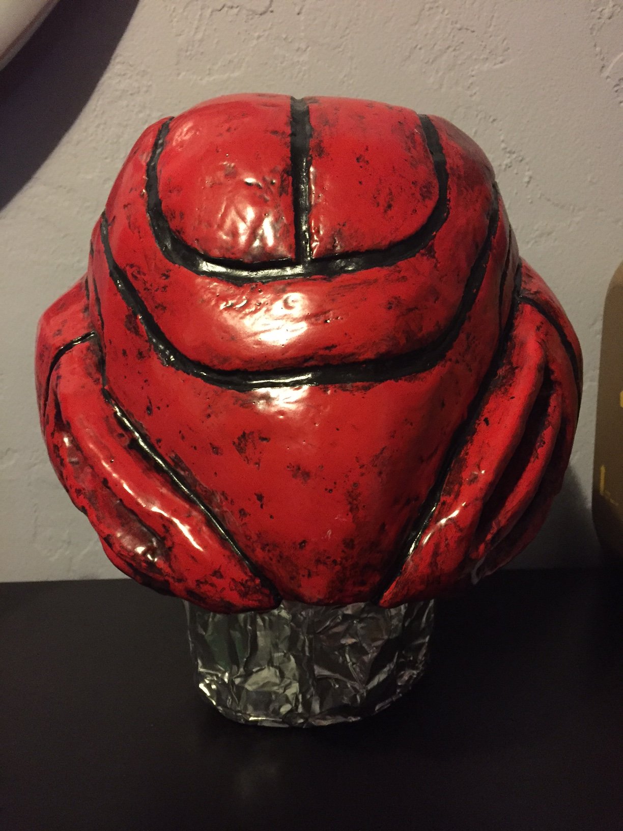

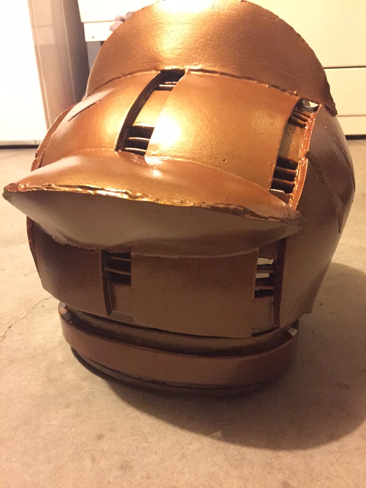

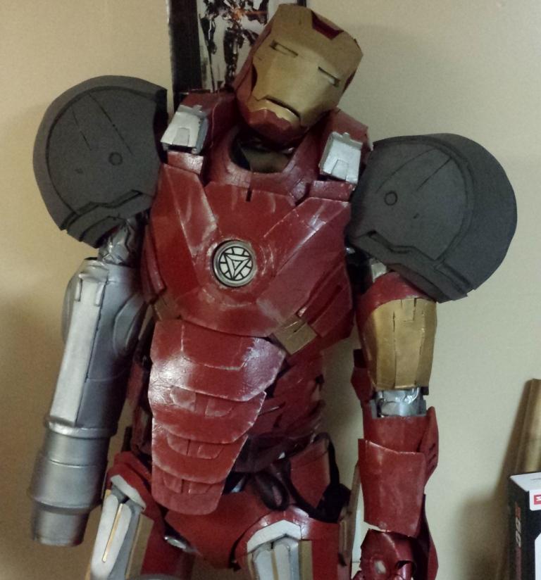

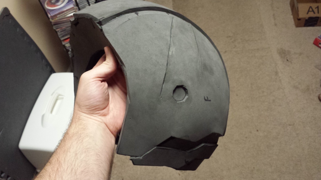

I'm actually working a Samus armour for my wife as well, I went the pep, resign, bondo, and sanding route with the helemt. The rest of the suit I'm using EVA foam or foam floor mats like I can get a Harbor Freights for cheap. I've built the arm cannon and one should out of foam and they turned out pretty good, and they are a fast build if you need speed vs strength. I really need to get a thread going as well, but I want to have more of it finished first :). Here's some pics of the helmet a shoulder arm cannon for reference.
20151213_153940.jpg20151213_153909.jpg20151201_220144.jpg20151201_220120.jpg20151128_115202.jpg20151128_115153.jpg20151111_135003.jpg20151111_134946.jpg
Those pieces look awesome! I wish I could get my husband to do my armor :p
Seeing your foam shoulder piece is making me lean toward using the foam instead of a full pepakura model. I enjoy building pepakura, but they take up so much time.

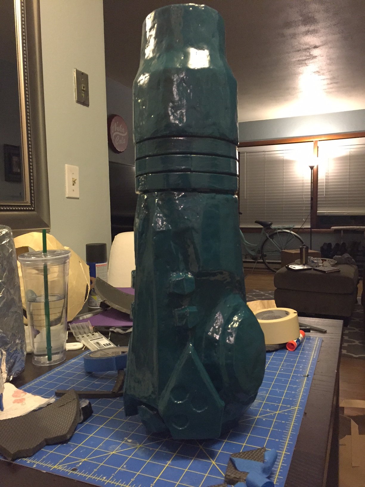

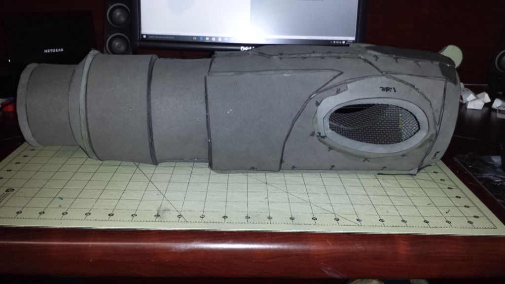

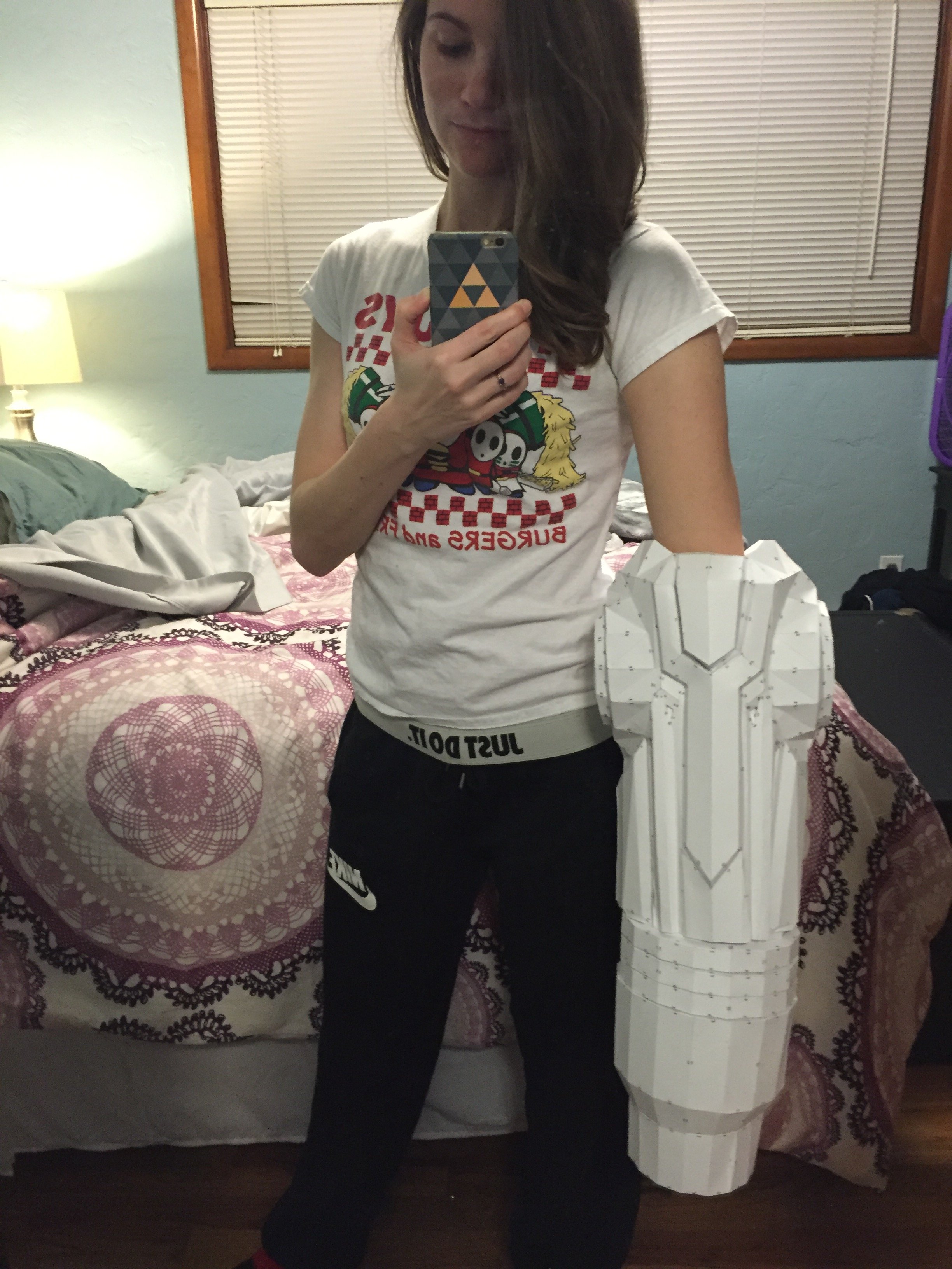

Here's a picture of the arm cannon. the three pieces aren't sealed together and I think that may be making it appear way bigger than it should. Either that or I'm small. I'm probably going to go back to it later and see how the other pieces look all together. If it still looks huge, I can still go back in and do some slice and stitching.

And that might have been a mistake to say because I have sooo many questions. Also knowing your arm cannon size would be great! I'm just worried that it's too big or maybe I'm just making it look bigger (I'm 5'4" if that helps). But I plan on putting that aside from now and just starting on the shoulder ball piece, the glove, and other pieces and see how they look together.
Haha yay!
My cannon is 18" long, about 6.5" across at the wide section near the back with the roundy bits, and the nozzle is 3.5". I'm 5'9".
Thank you for checking! So mine ends up being just shy of 22" length, 7.25" wide in the same spot, and the nozzle is 4.25". It's a little bigger so maybe we should trade? Lol.
I keep comparing to Metroid 3 screenshots and the way the arm cannon fits on me looks similar as far as length goes. When holding the cannon, the tip sits a few inches above my kneecap. But it might be a little too fat. I've thought about trying to cut and paste again and trying to make it more narrow. But at this point i might have to assemble it along with the other pieces and see if maybe it's just my body making it look way bigger than it should... It also doesn't help that I picture it 20x bigger in my mind until I put it on again and look in a mirror. And if it still looks too big I can always use it as a model for an EVA foam build.

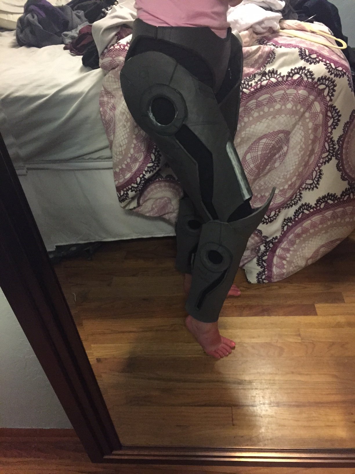

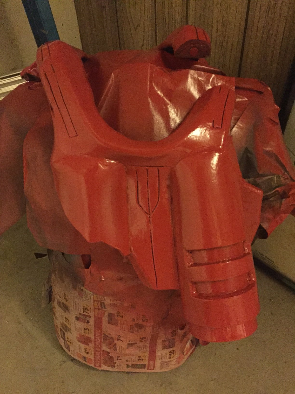

Sorry for being away for so long! Life has been a little hectic. And the cosplay con crunch hasn't helped either! Plus it's a pain getting photos from my phone on my desktop.
ECCC is less than two weeks away. But I still think I can make it in time. Portland is going to be sunny most of this week and next, which will be a tremendous help since now I have some daylight after I get off work to do painting and fiberglass work outside. I'll save the image heavy post and insert my most recent progress:
image5 (1).JPG image1 (4).JPGimage2 (2).JPGimage3 (1).JPGimage4 (1).JPG image4.JPGimage3.JPG
(Sorry that all the images keep appearing landscape?? But you get the idea :) )
Still need to construct the shoes, bicep, arm, and hand. As well as sew the zero suit portion and ribbing for the joints. If all goes according to plan I should have all of these at least constructed by the weekend. And then I can spend some of the weekend and the last week weathering and painting battle damage. Should be fun~
