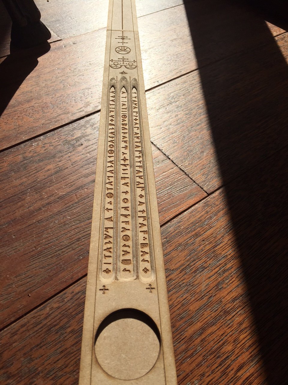

Alright, I've been working on this for a while now, but I finally have some decent progress done that I can start to show pics :
Everything was 3D modeled or drawn by myself, the handle was 3D printed on my form1, and the blade was laser cut in MDF wood (both sides have the engravings and details of course.).
The whole sword end to end is about 37,5", with the blade itself 27,5".
I tried to put as much details as I could in both the blade and the hilt, especially in the blade engravings. There is still work to do, mainly gluing all MDF slices of the blade together and carving the edges, as well as making the raised details at the beginning of the blade. That's why there is a hole there, so I can 3D print it and just insert it in the hole. Once the master is done, I'll attempt to mold it, but I've never made a mold for something that big and "thin", so it's going to be a challenge for sure. If somebody has experience casting swords, please do share ! Otherwise I'll just paint the master.
But I'm really eager to experiment, possibly with cold casting for this one !

Yeah sorry, the lightning was bad and with the watermarks I didn't realise it degraded the visibility so much. Here are some pics in better lighnting and without watermarks, hoping nobody is gonna steal my pics this time around though.
started to carve the grooves around the lettering with a dremmel, it's gonna need some good hand sanding to get that nice and smooth, then on to the other side.

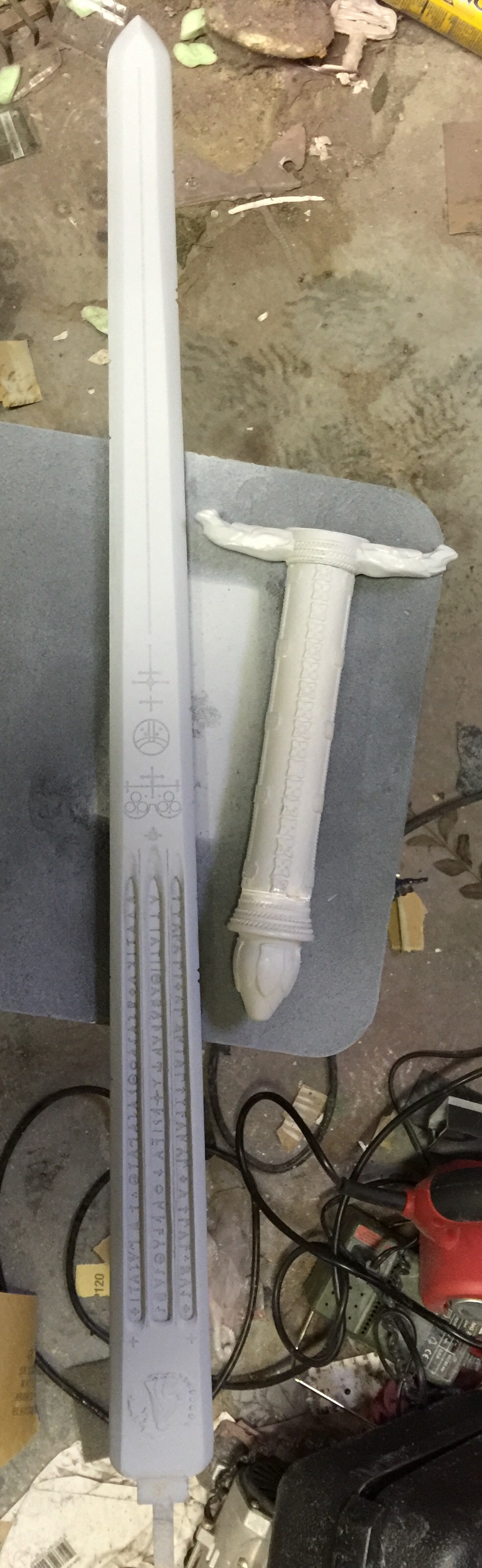

Got some more work done. Still a lot of cleaning to do, but it's looking a little more like it now.

Well thanks. I've been working a lot on it lately, even got a shoulder tendinitis from sanding it so much by hand. But it's almost ready to be molded. I got most of my supplies, my resin, my real iron and bronze powders, and half of my silicone. Apparently I've swapped a bottle of silicone for a bottle of vytaflex urethane rubber by mistake in my last order. That's alright, I ordered the rest of my silicone and I'll find a use for the vytaflex. Hopefully I'll have some exciting pics to show in the coming days !
