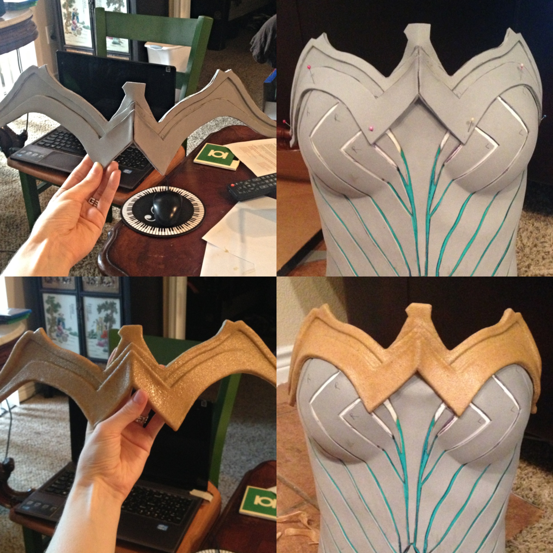

I started on the corset first. I decided to make the body portion of it from EVA foam:
I made the the golden eagle breastplate from Worbla. This was my first time using the material. When working with it, I make my base shape from EVA foam, and using a heat gun I then sandwich said shape with Worbla, trim the excess, and sharpen the foam details beneath with heat and sculpting tools:

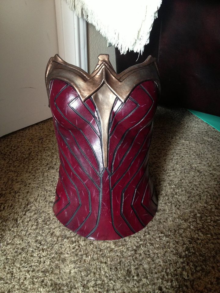

I then primed the foam body with Plasti Dip, painted and contoured it with burgundy spray coating for vinyl and acrylic black paint, sealed it with a layer of Mod Podge and two layers of Pledge floor care, and added light battle damaging/scratching with white acrylic paint. I primed the breast plate with 5 layers of wood glue (sanding between each layer) and sprayed it with a sandable filler/primer and sanded it once more before painting and contouring it with acrylic spray and liquid paints. I sealed the breastplate with an aerosol acrylic clear coat. I set grommets into leather panels and glued the panels to the underside of the corset in the back via contact cement for the lacing closure. This is the result:

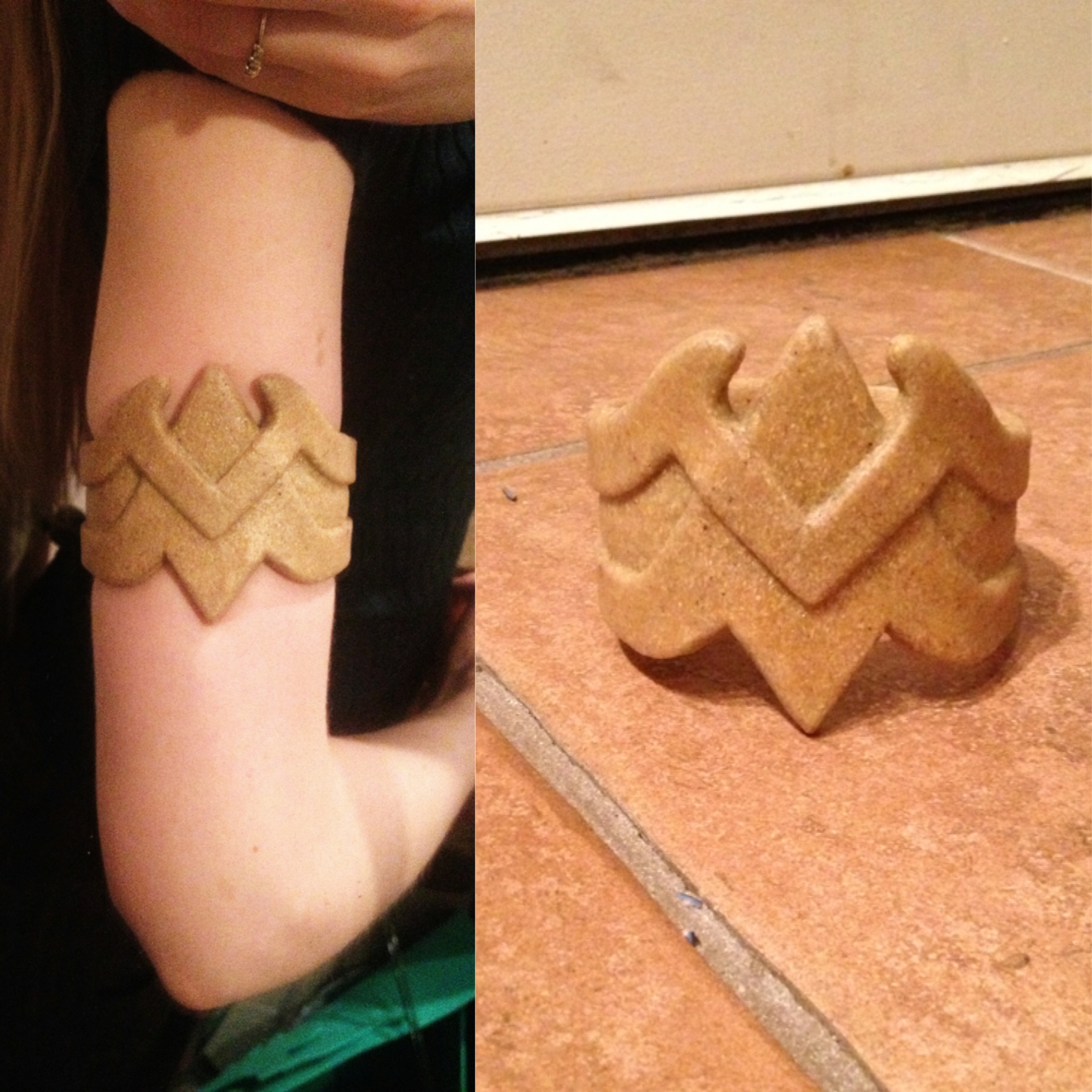

The pieces I have formed but haven't primed/painted yet are as follows:
photo 1 (15).JPGphoto 3 (6).JPGphoto 4 (4).JPGphoto (11).JPG1484700_931069170246433_2258860014372981262_n.jpg
The leg armor and bracers will be attached via leather straps/snaps. When I bend my knees, the leg armor bends along with them due to the way the plating is assembled.

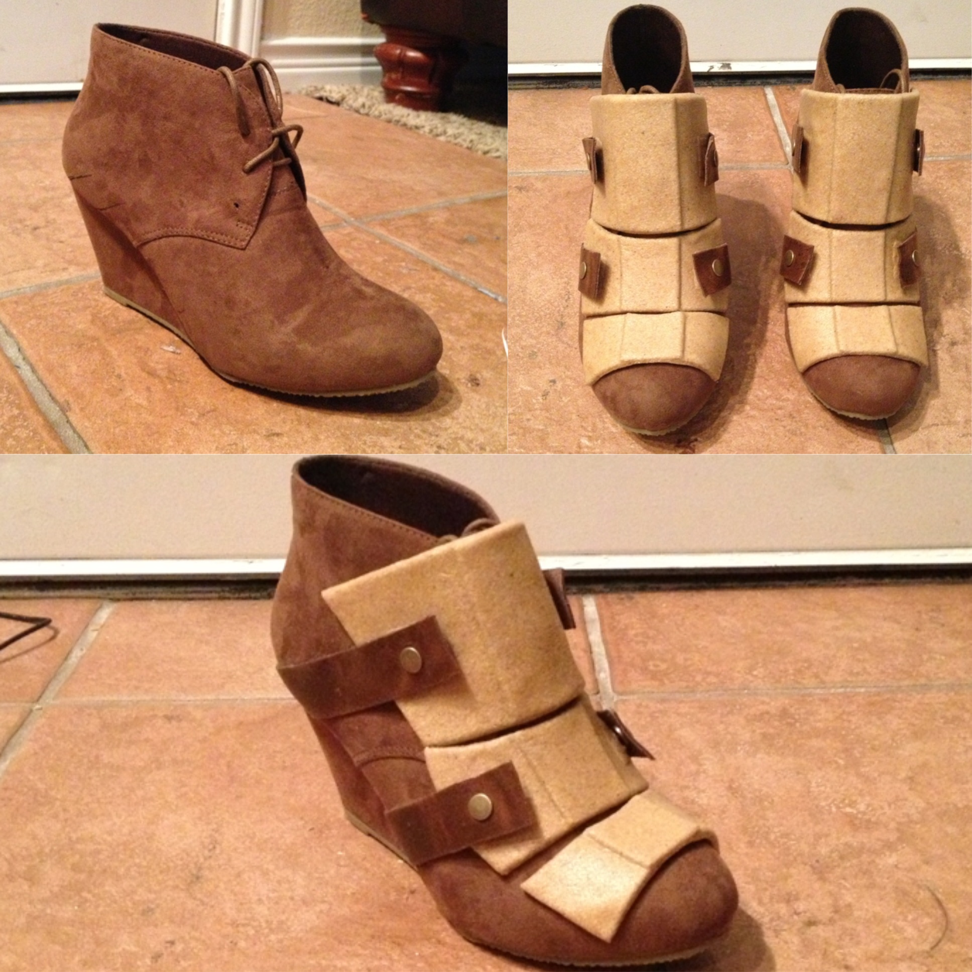

I have been working on snaps/straps for the leg armor and bracers this weekend.
I set the snap studs into small squares of Worbla and attached them to the armor using a heat gun and sculpting tools. The snap sockets are set into leather strips cut to size to make the straps.
The leg/shoe armor has 16 straps and 24 snaps in all (including both legs).
The two bracers have 10 snaps and 4 straps in all.
