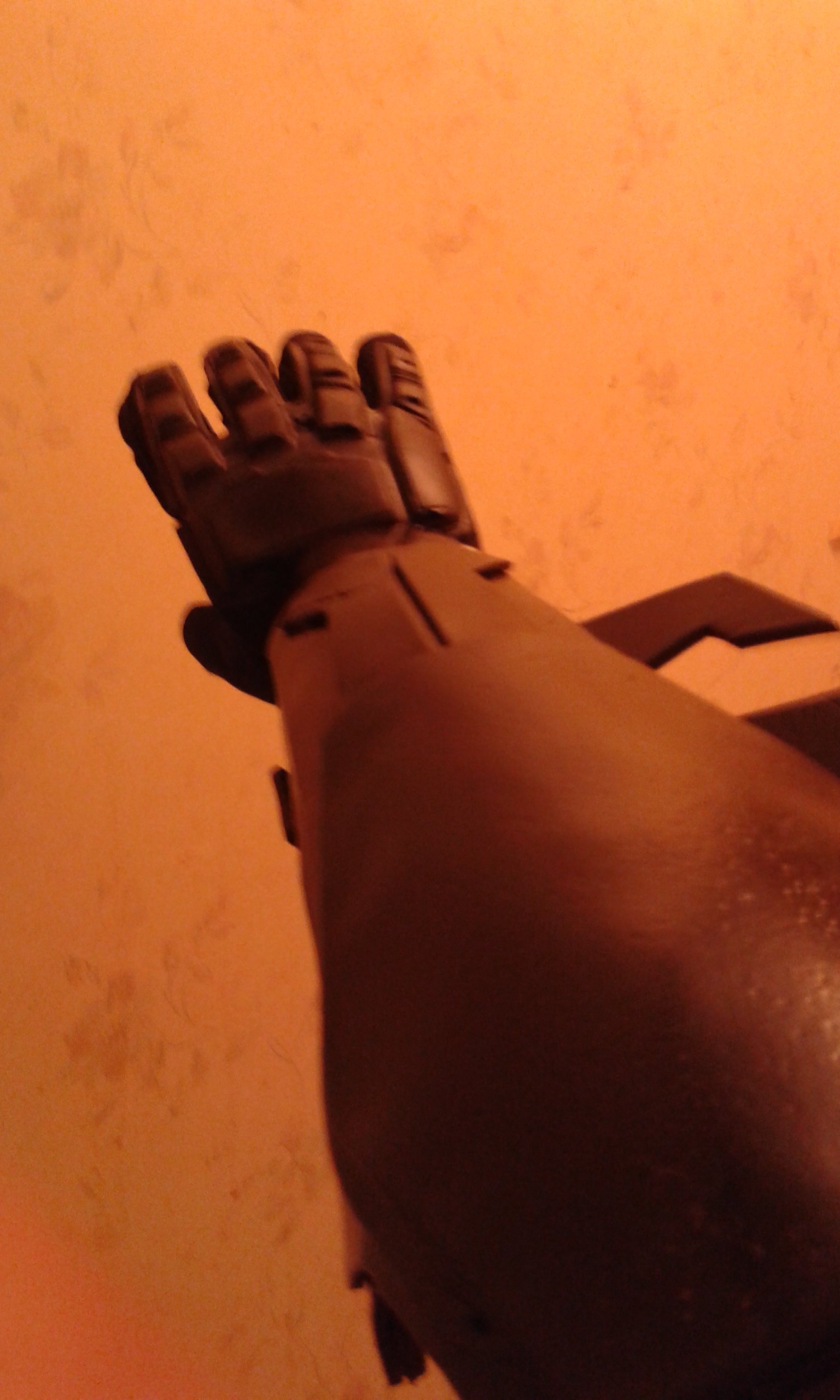

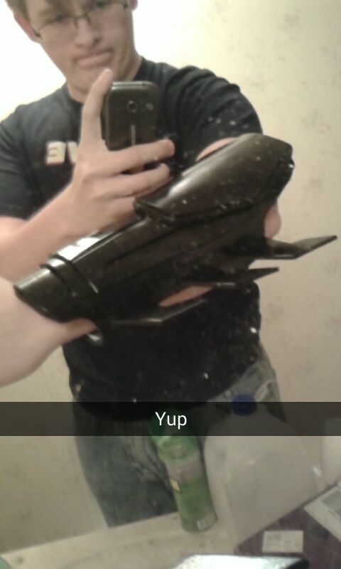

I know it's odd, but I started with the gauntlets for the suit. They're built with 5mm and 3mm foam, but I'm going back to make a bulkier underpiece instead of strapping them.

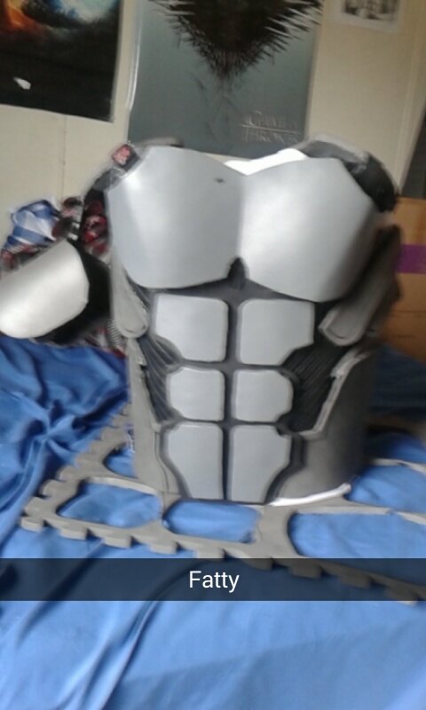

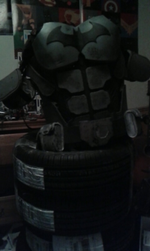

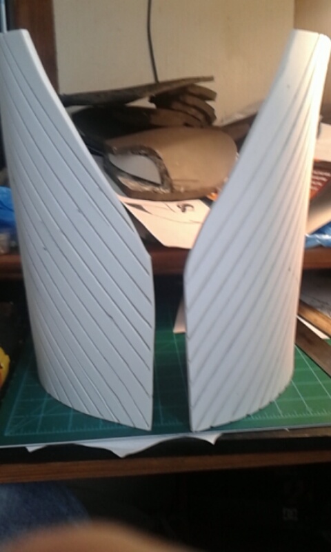

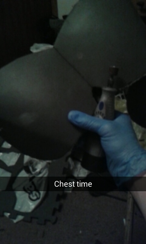

For the torso, I cut one piece out for the chest, did an undercut to separate the pecs and then glued it down to another piece of foam by the middle and edges to add more contour and shape to the chest. The abs I just took a look at a few Origins threads on therpf for reference and I really really looked at Reznor9's Origins thread a ton. For the ribs, I took two sheets of 5mm foam and drew straight lines using a ruler for every centimeter and then used my woodburning tool to sort of engrave them in. Then, I placed everything on top of each other to see how they'd look.
Snapchat-8903056444282912055.jpg Snapchat--1687866008765266923.jpg Snapchat-1247304743218496226.jpg

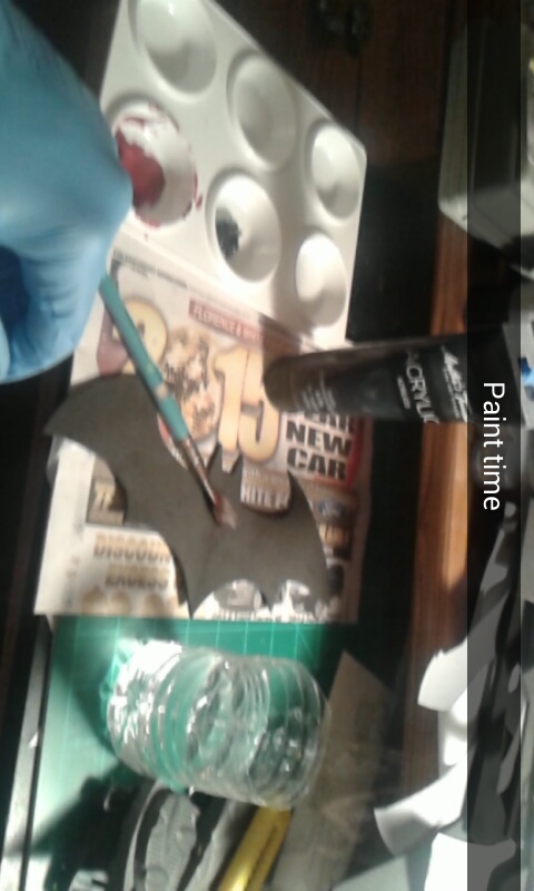

Next, I assembled an entire foam piece to span across my waist and connect everything together. I added some more detailing pieces to the sides to make it just a tad less simplistic. However, they seemed to make the sides a lot more bulky than I had hoped. Losing weight could also probably help this... But the bat symbol was hand drawn onto 2mm craft foam and hand painted with permanent black acrylic. Then just slapped onto the chest with some hot glue.

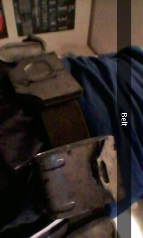

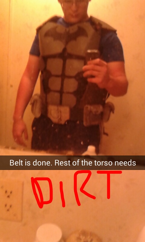

Next step, the belt needed to be done. I used the Foamcave's Origins belt template for this but it's needs quite a few modifications before I'm happy with it. I sprayed it with Rustoleum 2x primer first and then a metallic silver spray. I wasn't happy with how it contrasted to the suit so I mixed black acrylic with water and painted along it. I dabbed it with toilet paper every few seconds and gave it a really really dirty look.

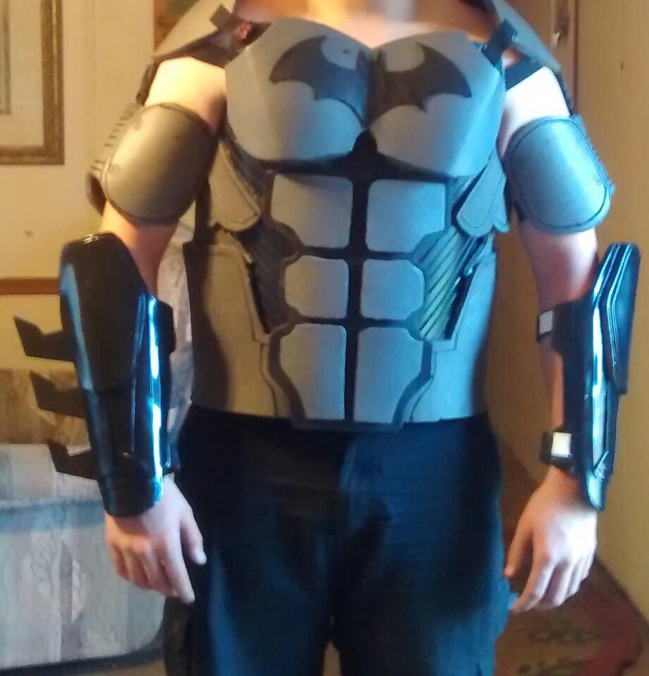

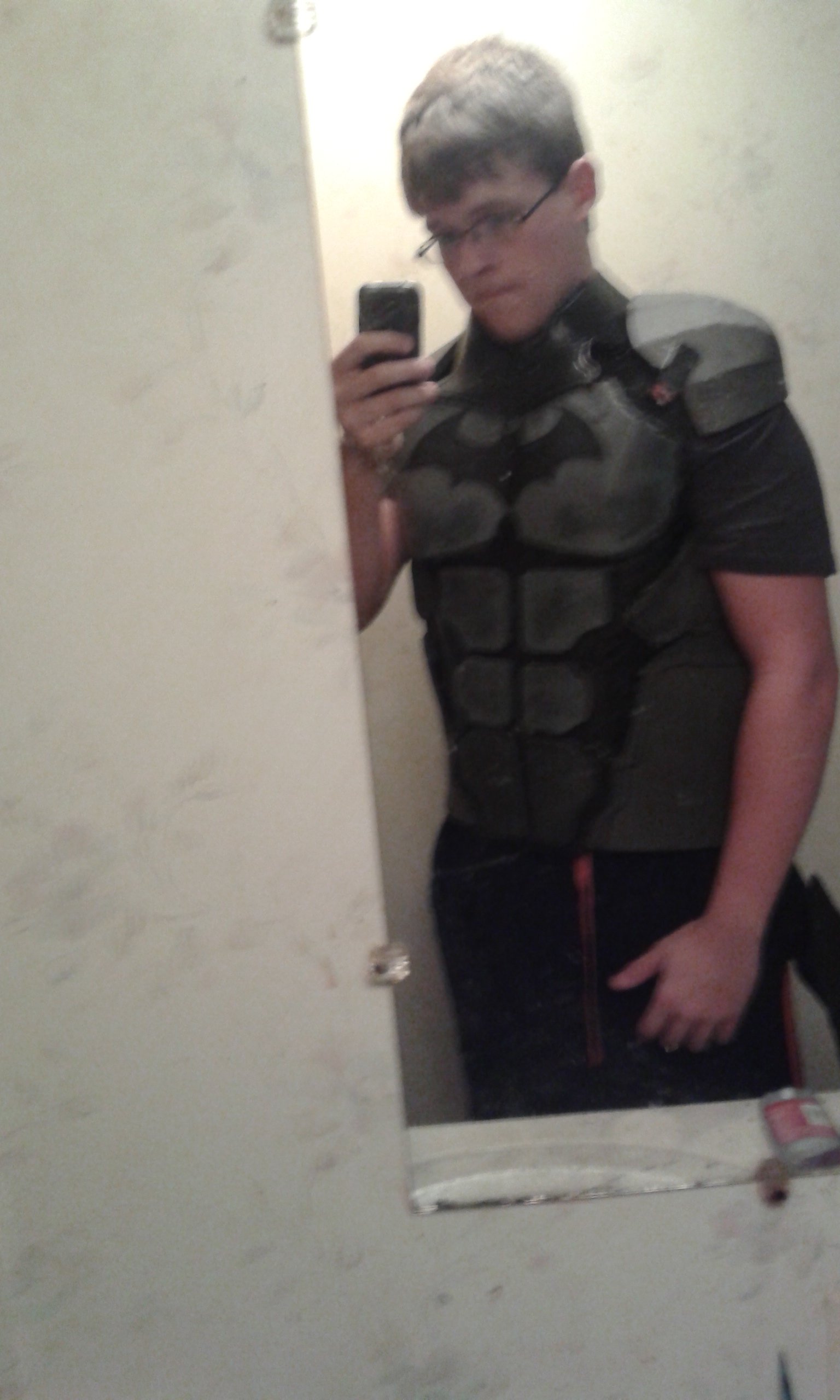

Finally, this is what I came to last night. I know the lighting isn't the best but I gave the abs, chest and biceps the same dirty/weathered sort of effect as the belt and assembled it all back.

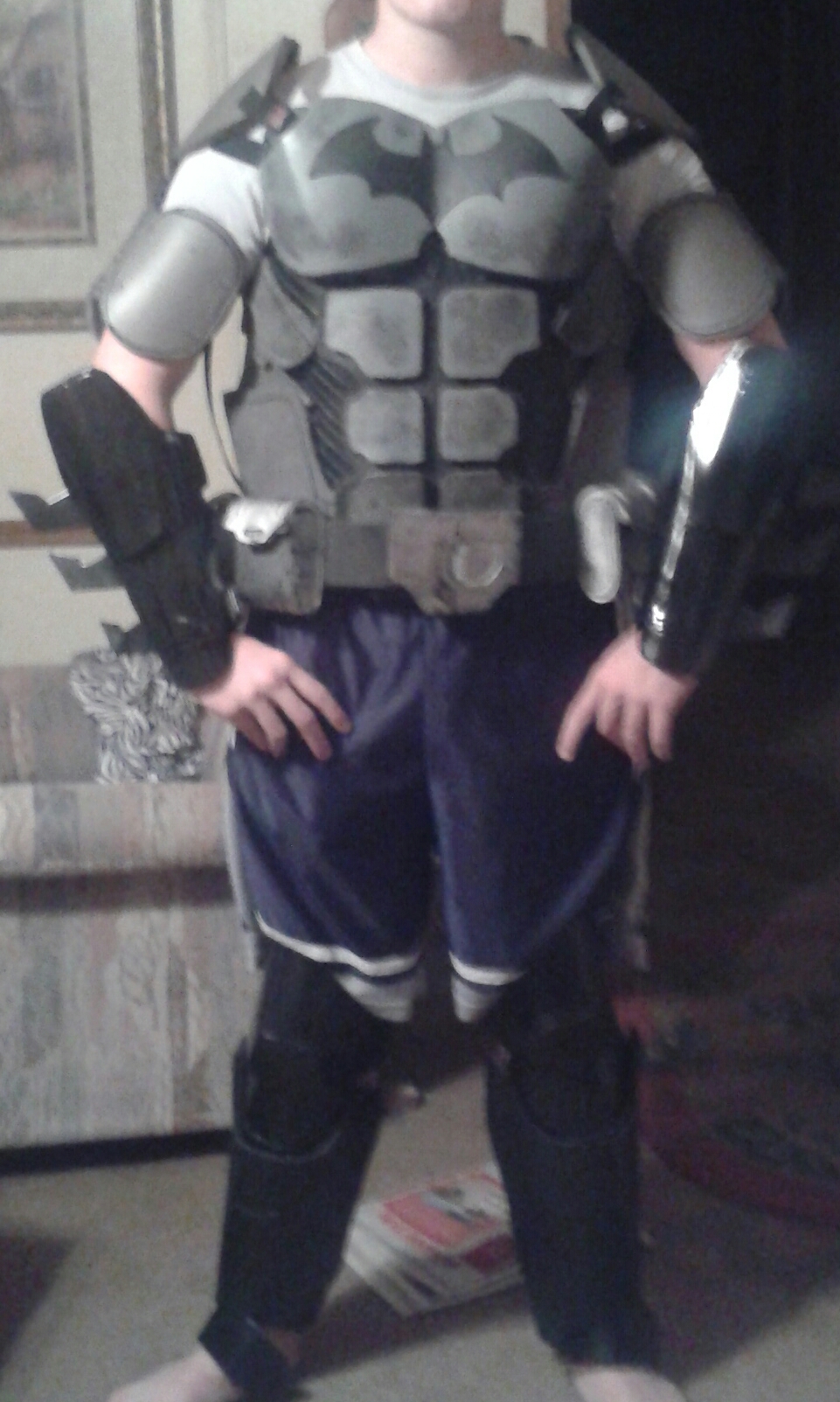

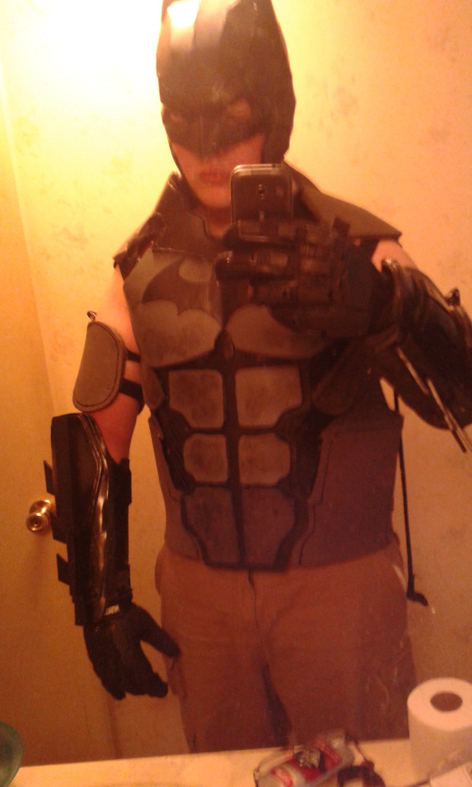

And these are the two test fits I've actually gotten pictures of so far. Right now I'm trying to figure out how to connect the neck piece so I can start on my fourth and hopefully final attempt at a cowl for the suit.

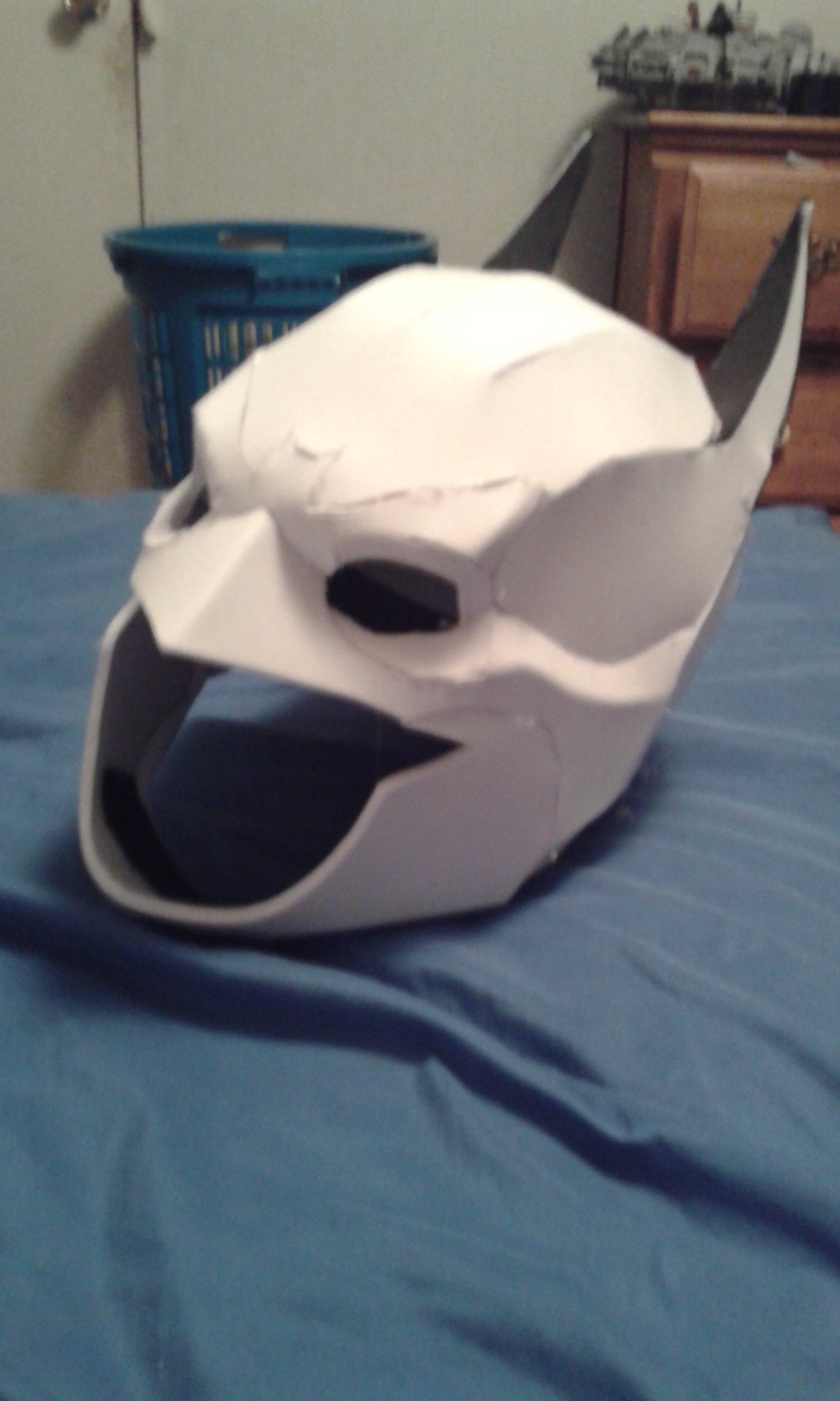

Finally made a little more progress. Built one of the thighs but not quite happy with it just yet. And i also made headway on the cowl. Foam portion is done, now it's time to fill the gaps and seams.
uploadfromtaptalk1429801572521.jpguploadfromtaptalk1429801640725.jpguploadfromtaptalk1429801666143.jpg
Great job on the cowl! I also made some progress on my Origins build. Will update my thread soon. What are you going to use to fill the gaps?
I'm testing out a few ways right now. My favorite so far is Kwik seal. I'm pretty sure it's a kind of caulk. I saw another foam builder use it and it's pretty good looking after paint.

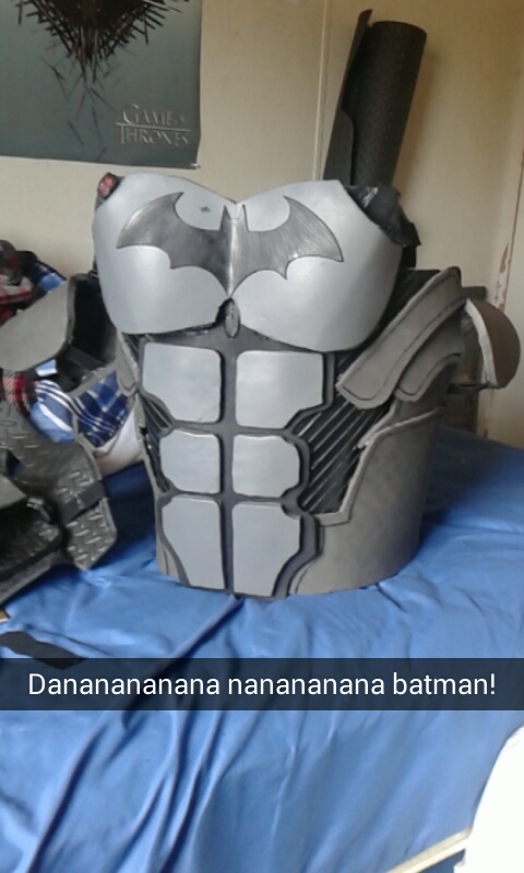

Hey guys! Finals are over and car repairs are done. So the suit has been under repairs. My new pup jumped on all the pieces so i redid the underside of each gauntlet and fixed the torso. Now there is a new shoulder attached and the neck piece is attached but I'm not quite happy with it still.
