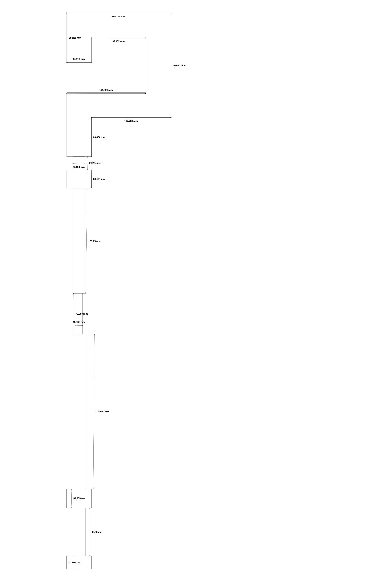

So I’m going to the May 2015 London MCM Comic Con and I’ve decided to Cosplay as The Akham City version of the nefarious Riddler.... The first thing I wanted to create was his cane. I started off by measuring the cane that comes with the Batman Arkham City Riddler Action Figure I then measured the figure. After I compared it to the height of Nigma noted down in the Guide Book for the Game. By doing this I was able to work out the scale...
attachment.php
Here is the drawing/blueprint of the design. I then proceeded printing out the design (actual size) and tracing it over a piece of MDF. I cut out the head of the cane and then was able to use that as a new stronger template..

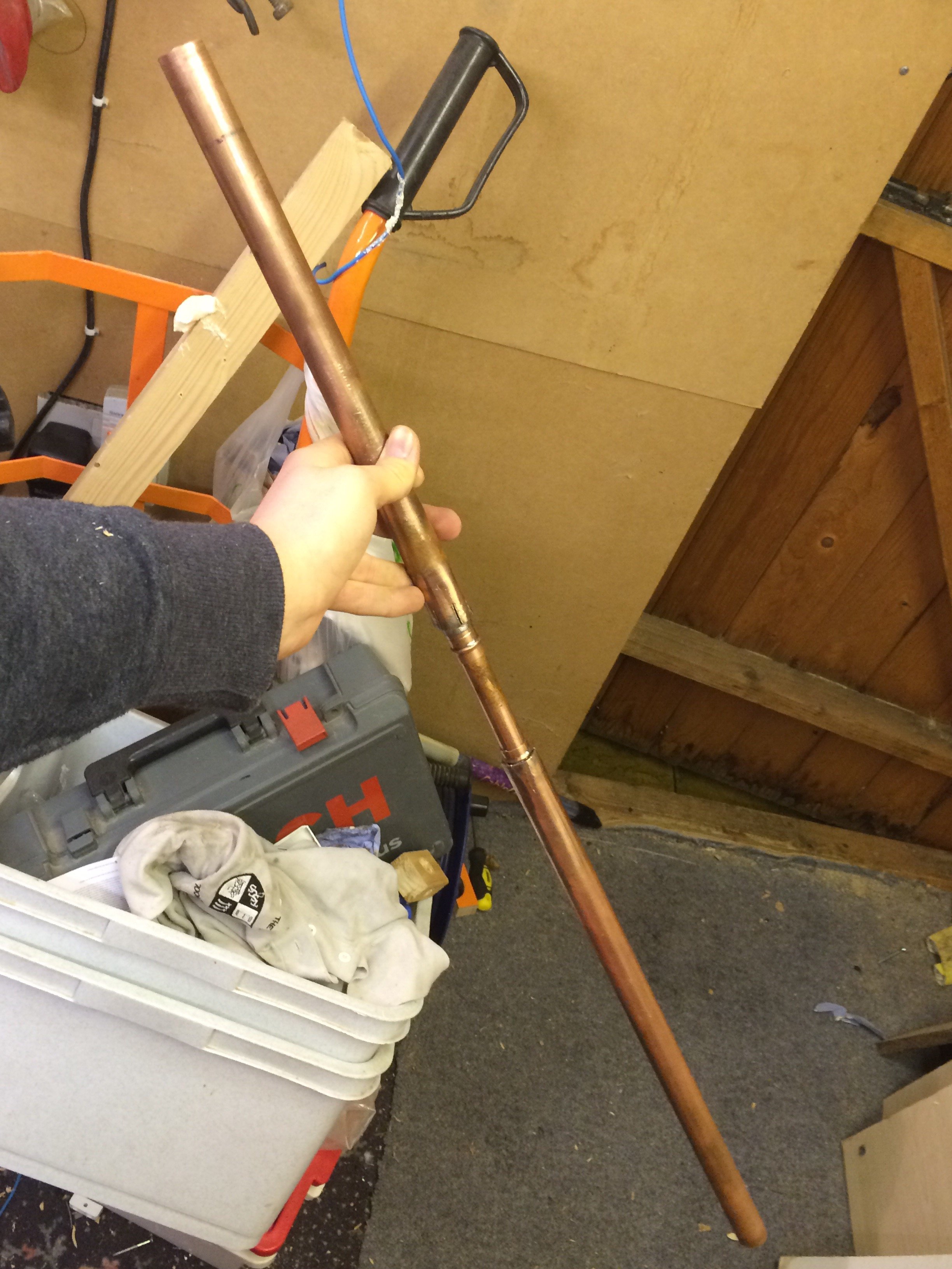

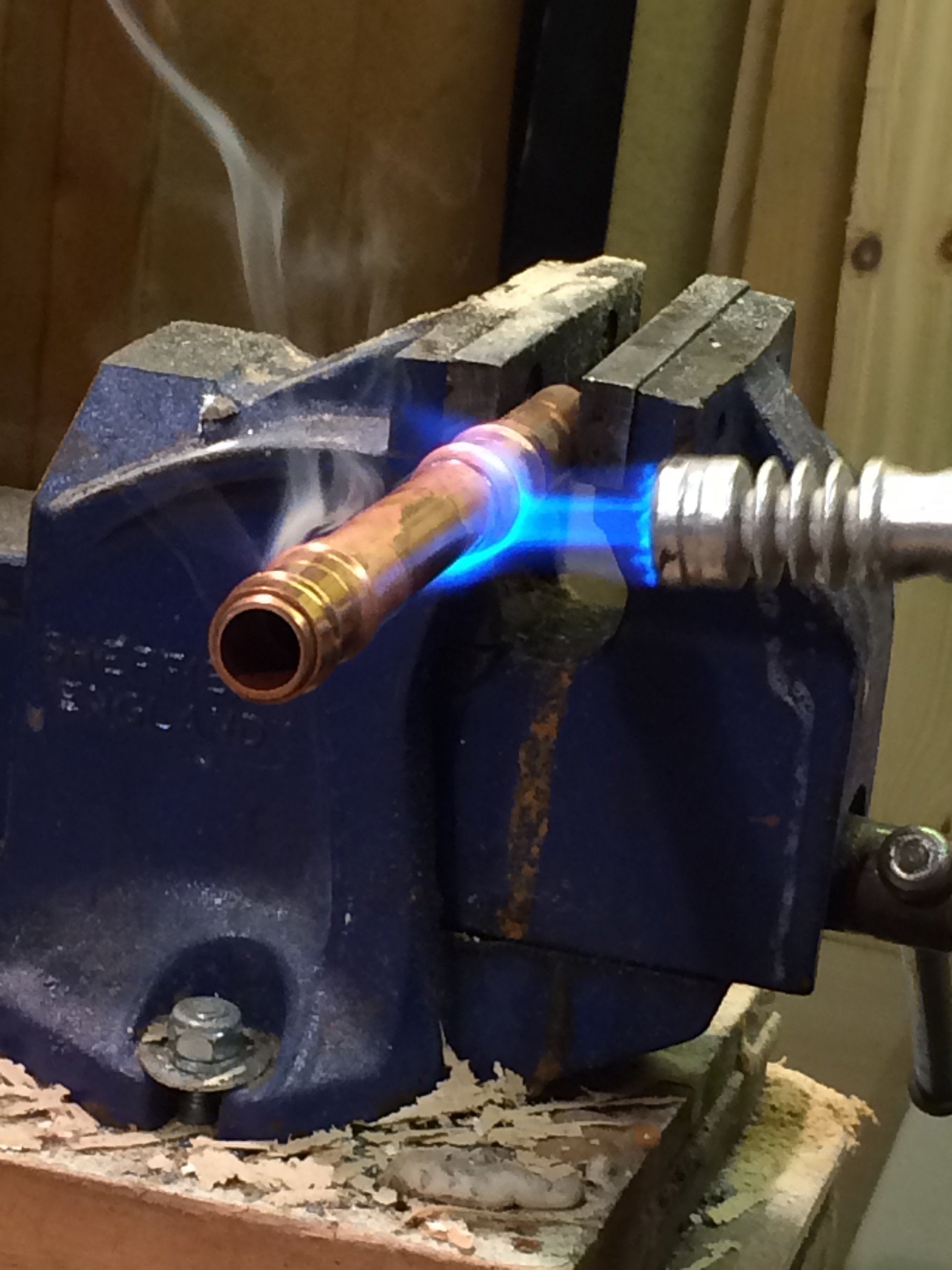

I cut thoese out using a mixture of a Band Saw and a Jigsaw. The next thing to do was weld/solder the coper handle together... This was fun by the way lol... Using plumming pieces I was able to create a handle that dipped in at the centre. This was also very strong...

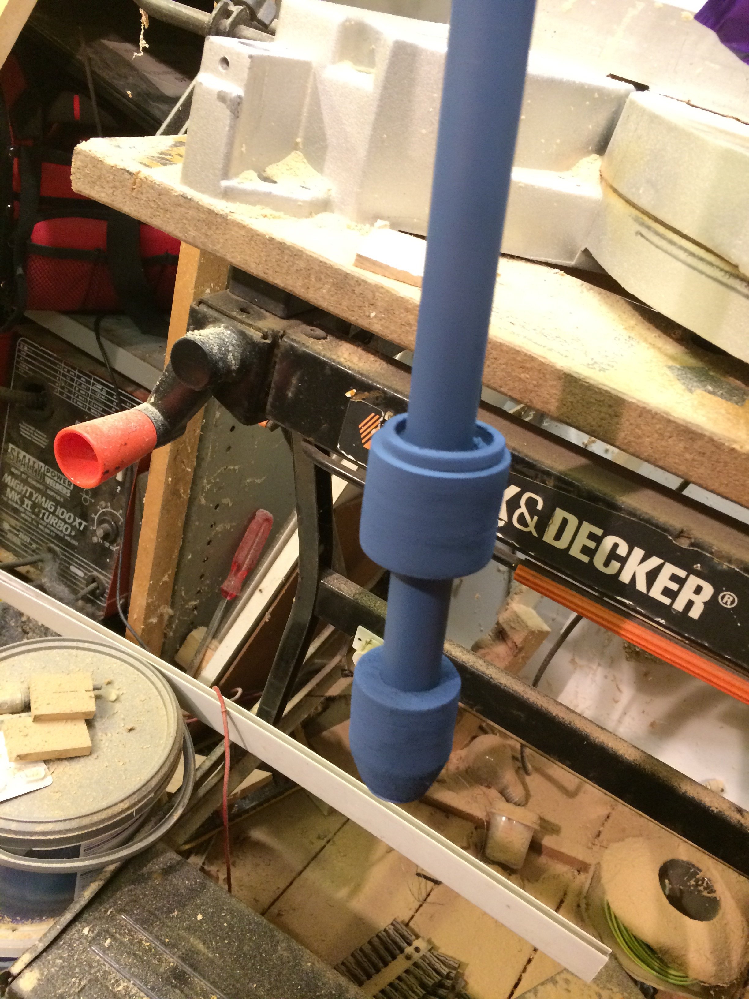

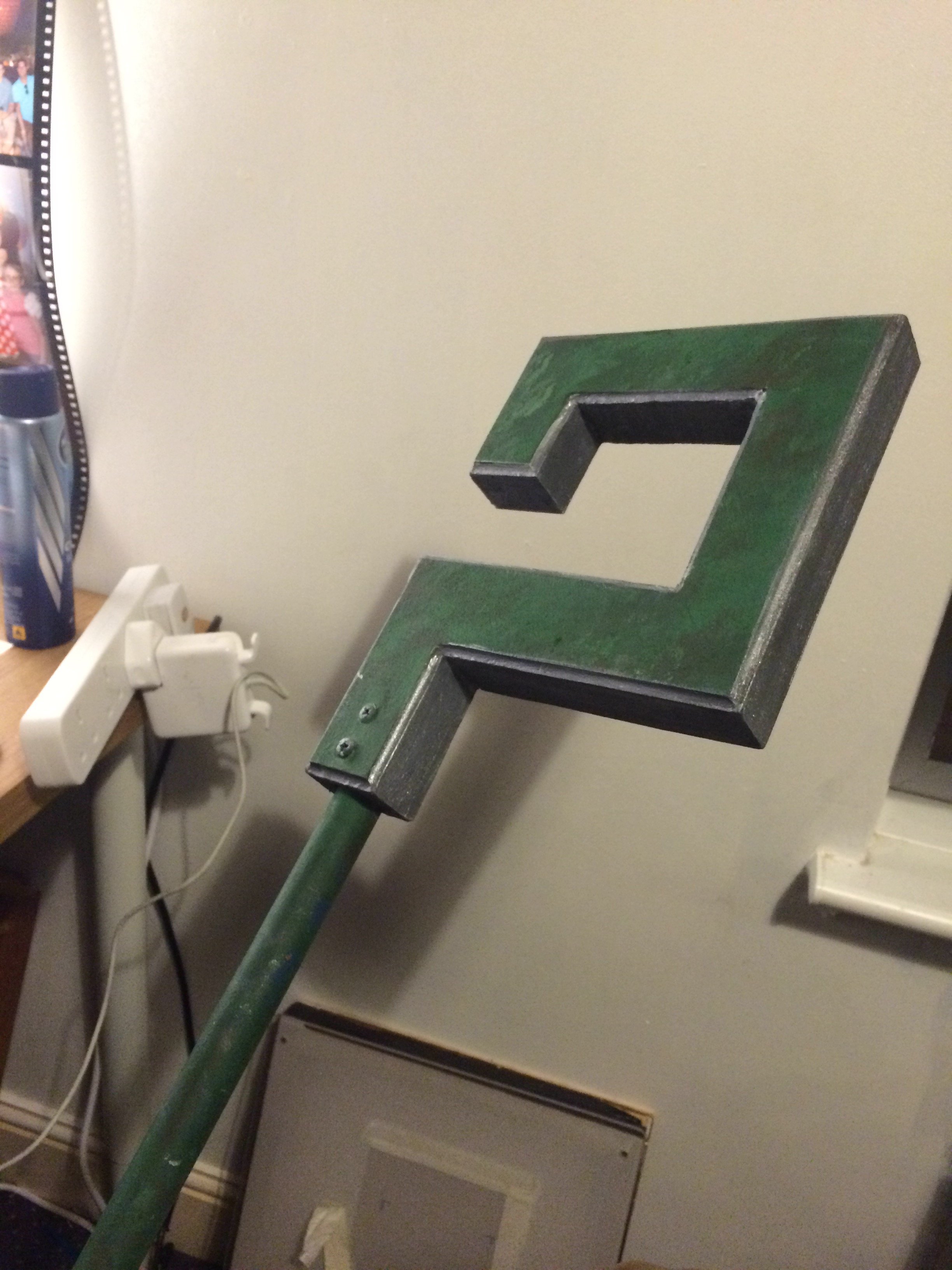

Next I drilled into the head of the cane (making sure it was straight the whole time) and fixed in inside using a nut and bolt. After I gave the whole thing a spray of primer.
attachment.php
attachment.php
attachment.php

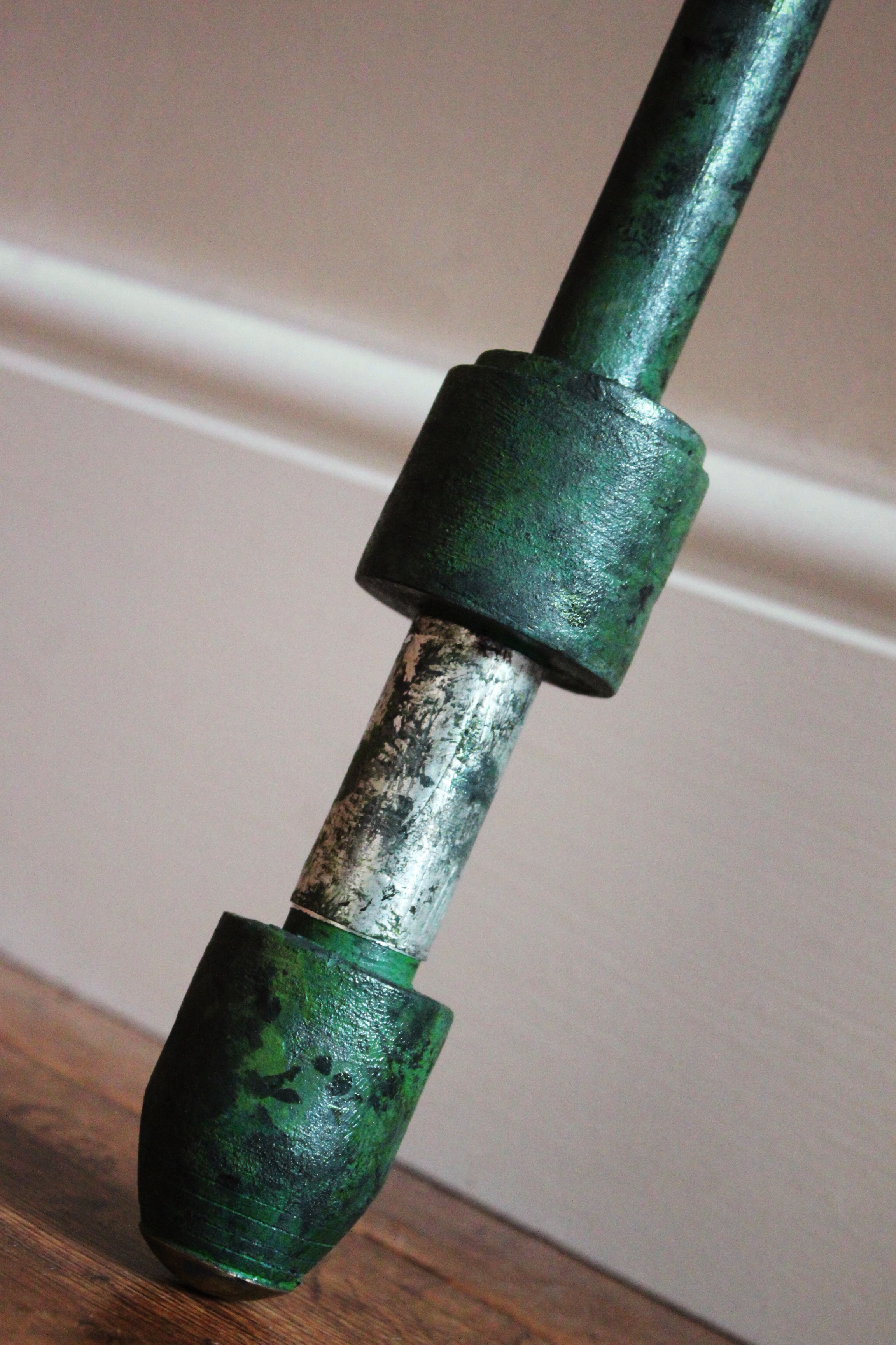

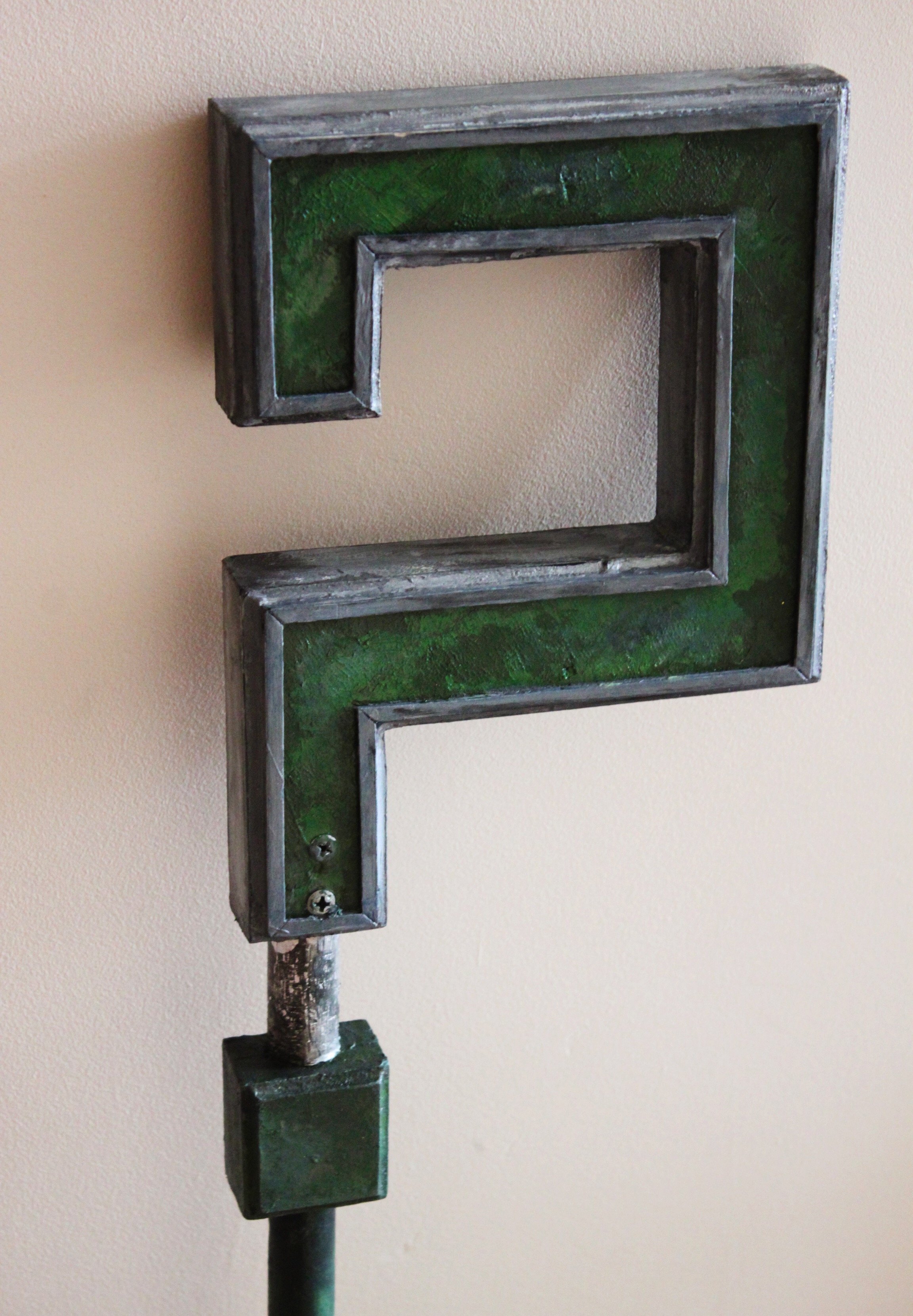

I also added the bottom pieces aswell. They were made by drilling into the MDF and shaping them with the sander. I painted the whole thing green exept the handle and the edges of the Cane’s head. They were a metalic silvery grey.
attachment.php
I wasn’t particuley happy at this stage as I felt it was missing something. Y’know those wooden sticks you get at coffee shops to stir your coffee and what not. It turns out they make great edging strips for a Cane Head.
attachment.php

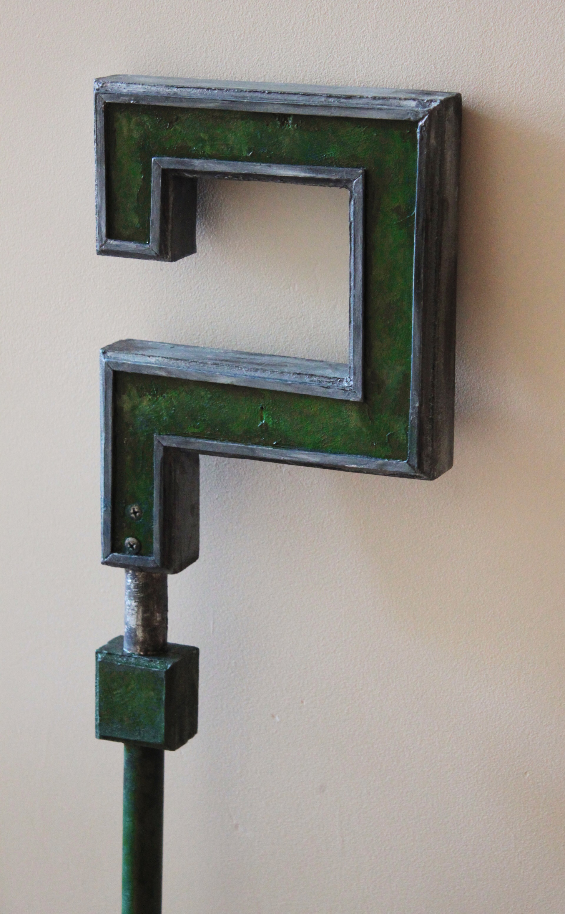

I next painted that silver and finished painting the rest. Let me also add, I used silver metal tape in between the Dot of the Question Mark and the Head and also between the two bottom pieces. Everything looked far to new so I battered the tape a little and scratched it. I also added a mottled painted texture to the cane and stick and attatched a metal dome onto the end of the cane so that it gave out a nice clang when you hit it on the floor.

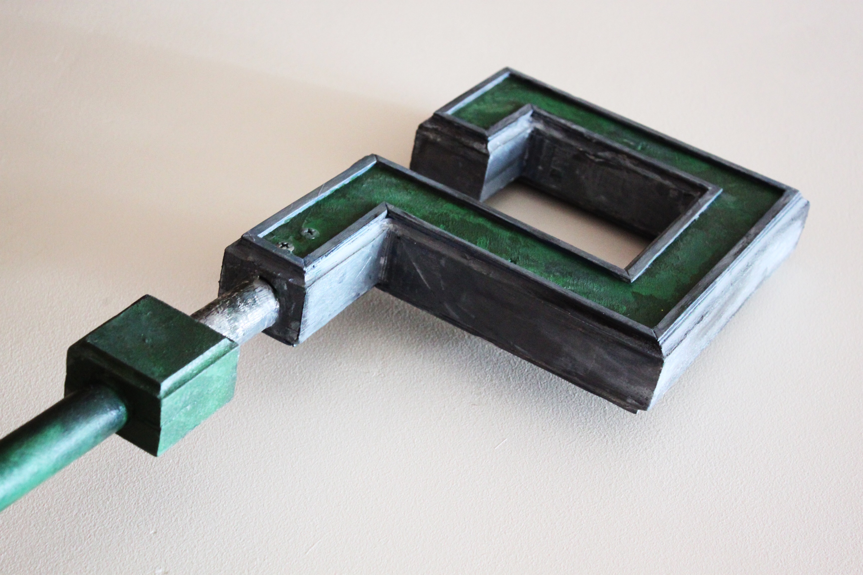

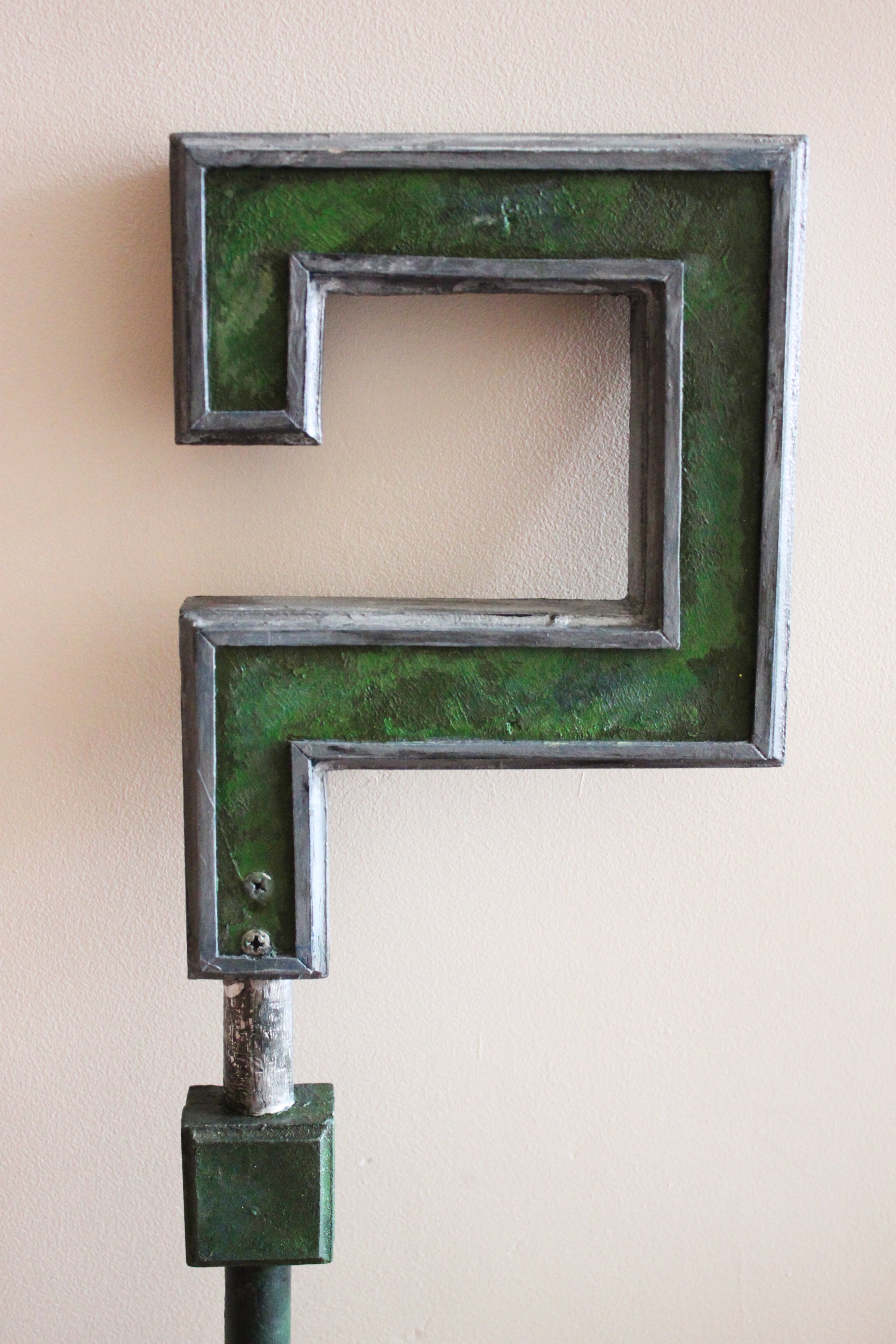

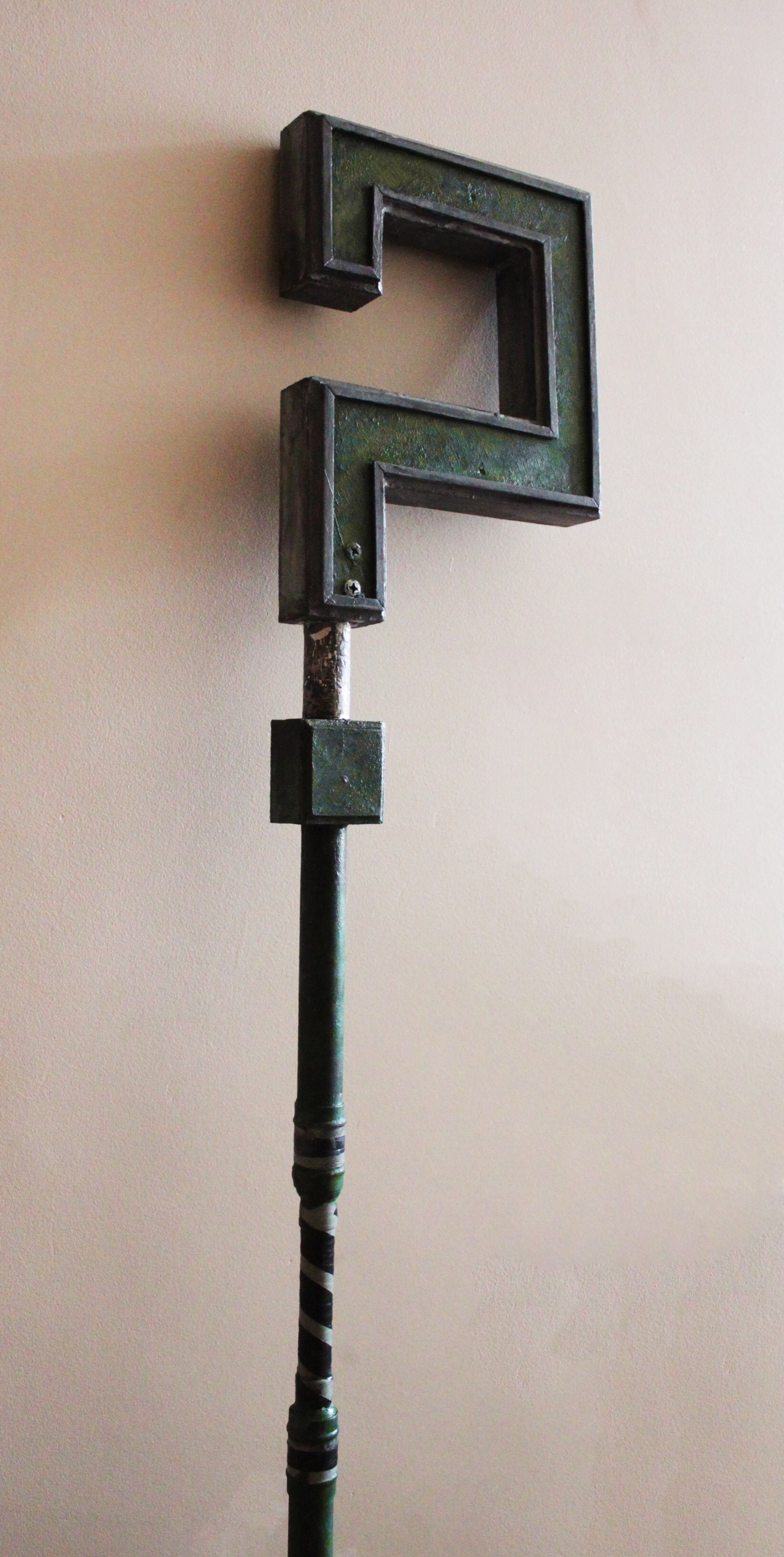

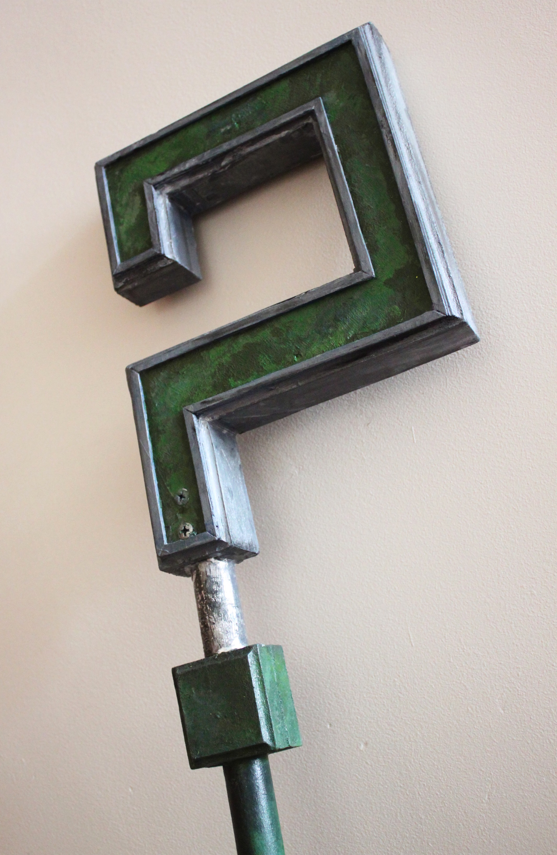

So here’s my finished Cane... What do you guys think? I’m still working on the cosplay itself but I think this turned out pretty well :)

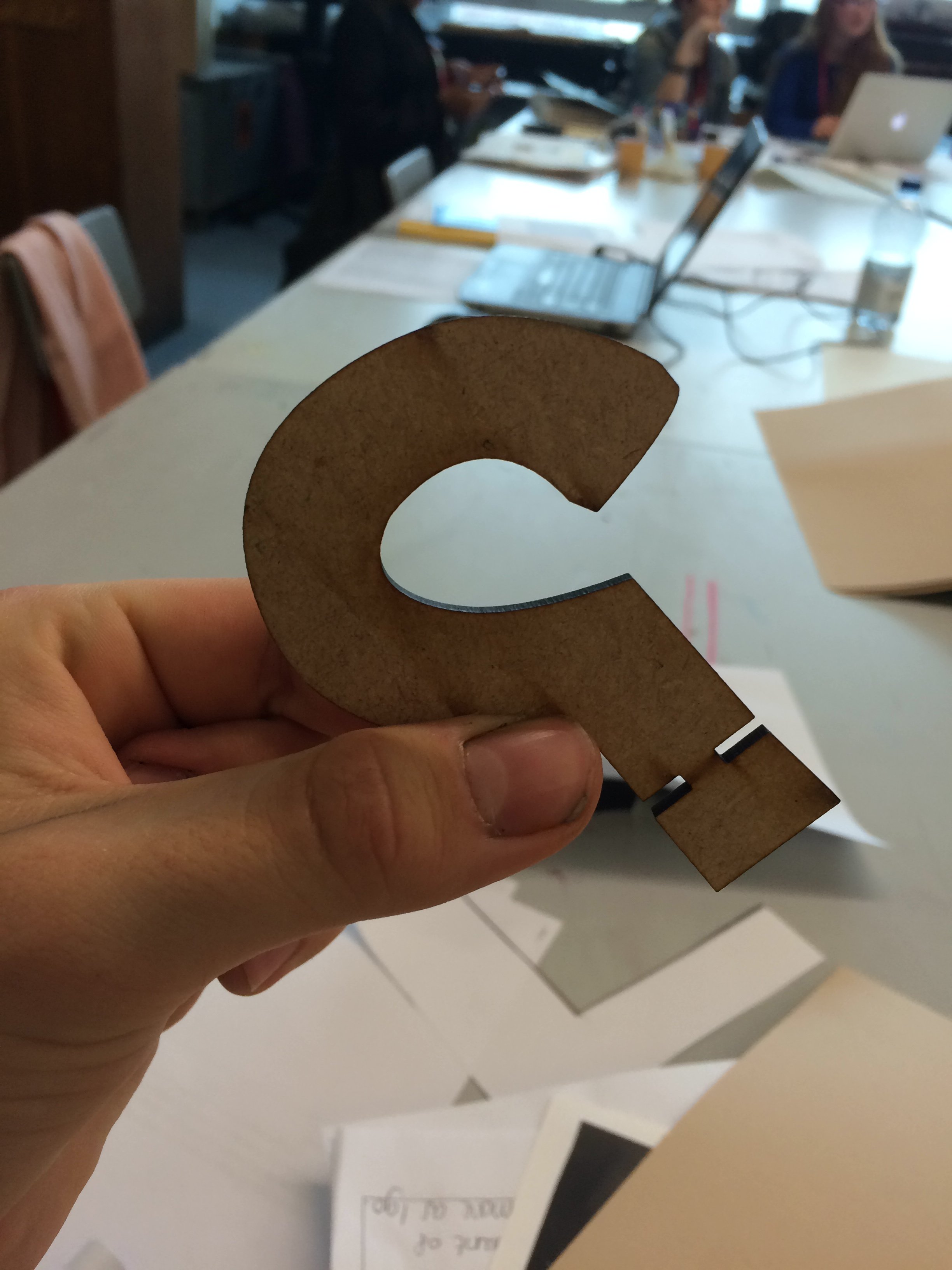

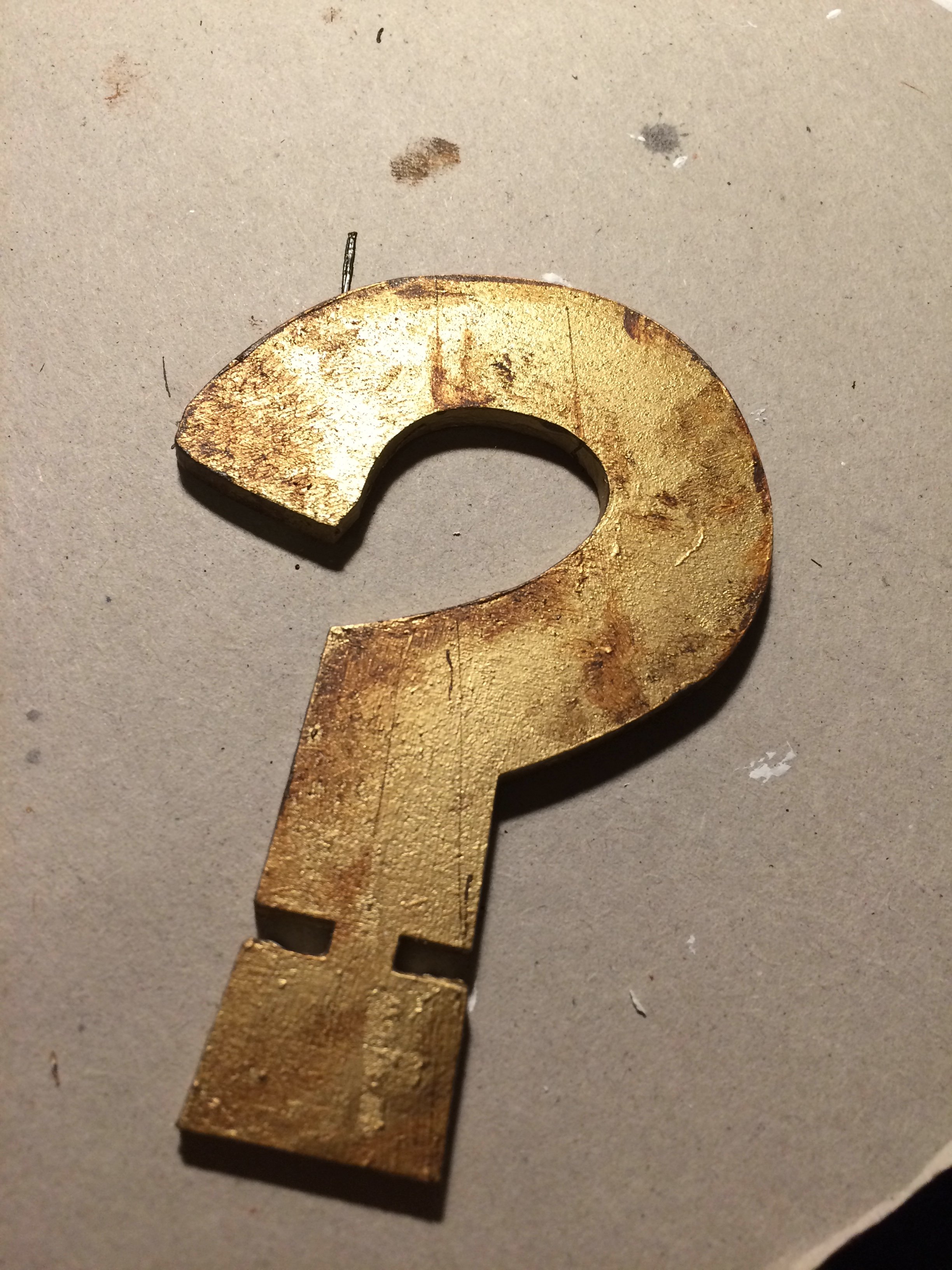

I got very excited when this was printed/cut.... I got the tie pin laser cut! it was cool to watch and the end result was awesome (Geek)....
attachment.php
It’s not quite finished yet but I love the way it looks painted... I did this by priming it white, then sparrying it gold and after mixing black an’ brown acrylic with water. I dabbed the paint on with my finger, blending areas with a clean finger. I also flicked paint on which gave it a scratched look to it.

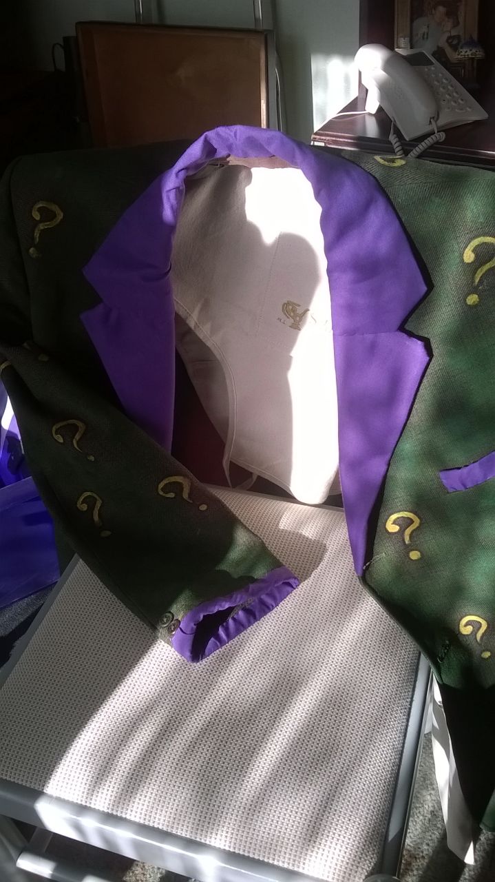

Okay so, I found a Suit Jacket, Online (because even online was tough to get one that looked right and was the correct size.) this of course was after I searched in every charity/thrift shop in my town and the two sorounding towns finding nothing. It said an Olive green. I thought, “yeah sure I can work with that..” The trousers/pants I had bought also said olive green.. no no no these were two different colours when they arrived lol. The jacket was dark and the trousers were light. I wasn’t going to change the colour but it turns out that acrylic paint works well as a dye when mixed with water.
Screen Shot 2015-05-16 at 08.45.21.pngSo this is the jacket
... and this is what the trousers look like now, I painted them so they had a mottled texture to them,apart from still being too light which I am yet to correct I think they came out great. Oh I need to sew on some buttons too.

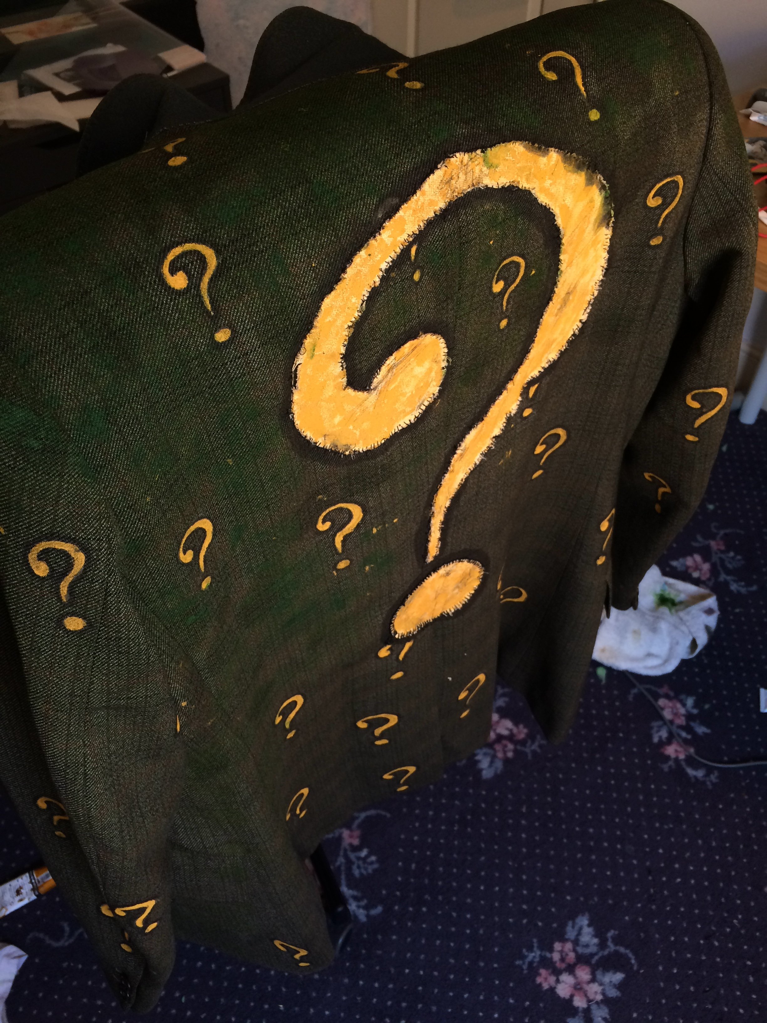

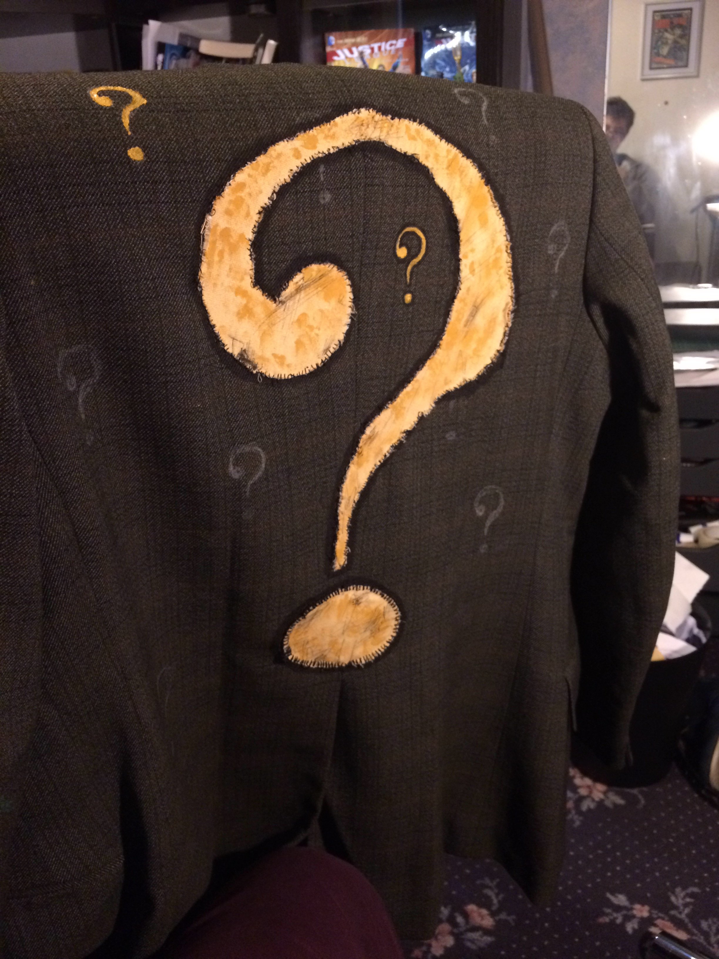

This was me paitently handsewing the large question mark on the back.
I found painting the smaller question marks on by hand worked best, mainly because they would all be unique and I wouldn’t have to spend out on iron on paper or sewable patches. After I’d finished painting them all on I went round each one with a black marker pen. It outlines them nicely, don’tcha think? :)

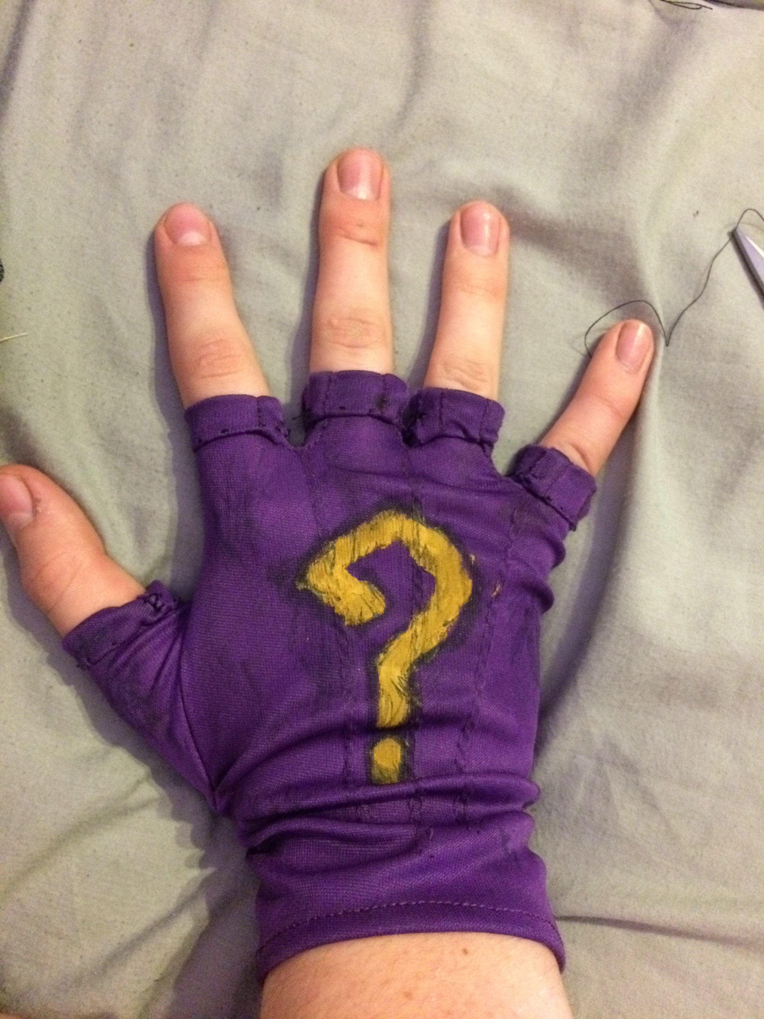

Next was the Gloves. I’d been umming and aring on how to do them when I found these - http://www.amazon.co.uk/Purple-Spandex-Velvet-Costumes-Accessory/dp/B005F6O140/ref=sr_1_fkmr0_1?ie=UTF8&qid=1431762822&sr=8-1-fkmr0&keywords=purple+riddler+gloves
I cut off the fingers and sewed round each finger. Then I used the acrylic dye and soaked them for a few hours. They came out a duller purple and all I had to do was paint on the question marks...
I really like em :)

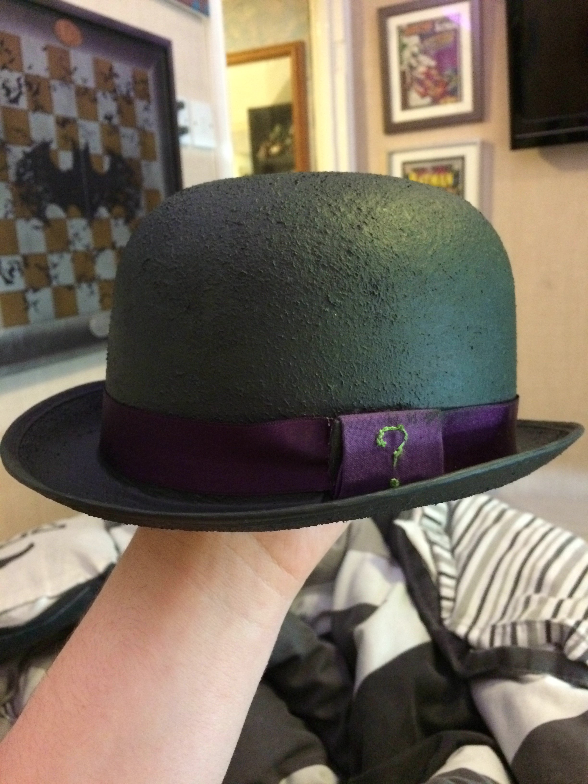

My Bowler Hat I found in a Fancy Dress shop, I just spary primmed it and painted it a green to match the jacket, (Slightly off but hey ho)...
Just added a ribbon and a lil question mark and Bob s’your uncle.
